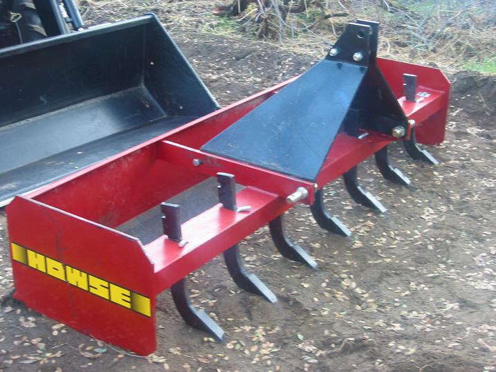

It looks like the Bee has the same retaining method as my Howse. Those pins fit in front of the scarifiers. The scarifiers have notches on the rear and then there's room to put the pins in. The pins are held in place on the bottom with a small hitch pin. I found this a pain to remove as it takes a pair of pliers (for me) to pull out the hitch pins. I found the hitch pins (not the retaining pins) get bent and then are a real pain to get out. Some hitch pins have been knocked out of the retaining pin during use too. I also have some damage to the box slot on the top front lip where the retaining pin has been has been smashed into it. I'm in the process of modifying my Howse to use scarifiers with holes in them instead of the notches. They are much cheaper to buy than the Howse scarifiers.

That is an excellent explanation. Thanks.
I'll still post pic soon for clarity purposes, though.

</font><font color="blue" class="small">( Can you take a photo of showing the pins? And how do they lock in place? Do they just slip down in there or is there some sort of lock that holds them in place?)</font>
Here are a few pics.
This is from the top
BIG PICTURE
The scarifier showing the notches.
BIG PICTURE
I tilted the thing against my shop and took another picture to show a bit more.

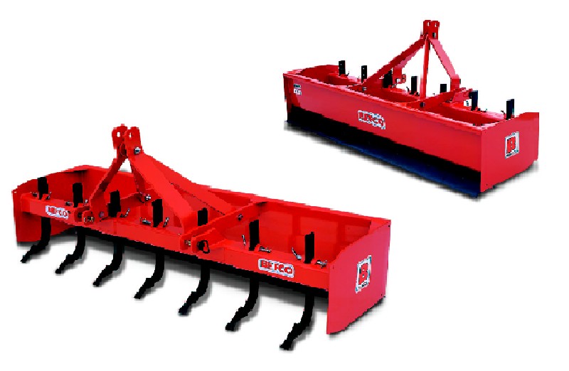

Here's a pic of the BEFCO box blade

Befco is my favorite brand of mower and cutter. I would be nice if you could post some more detailed photos of the box blades. Especially showing how the scarifier teeth are held in place, etc. Can the scarifiers be adjusted with gloves on? Without the use of tools? Is the rear of the box curved or flat? It looks like the side plates are rectangles, as opposed to trapazoids. I prefer the tapered shape of the trapazoid as I feel it is superior.

Assoon as I get a chance I'll get more pics of the box as well as all our attachments up here for you. Th 4x4 crossmember is slotted and the shanks slide in them. The shanks have 3 positions and are held in with a bent hitch pin and a pin. They can easily be adjusted with loves on. The rear is curved for reinforcement. The side plates are rectangles for the most part. The front edges have a little shaping to them. Just out of curiosity, can you PM me about your thoughts on the endplates? I'd love to hear your opinion on them.
