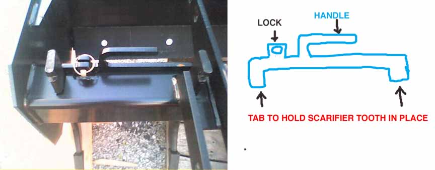

I wish someone would post a close-up photo of the Woods scarifier lock.

Jerry,
I'm not the best artist but maybe this will help?
   / BOX BLADE :: PHOTO comparision of brands #33
Thats Bob. That wasn't to bad. It answered all my questions, but one. Does the tabs go down in the holes?
#34
Yes, the tabs goes down into the holes behind the scarifier teeth. They push the scarifiers forward so that the notches on the front of the scarifiers lock them against the square tube that they are captured in.
It is quite a sturdy system.
   / BOX BLADE :: PHOTO comparision of brands #35
Thats again. That is what I wanted to know.
