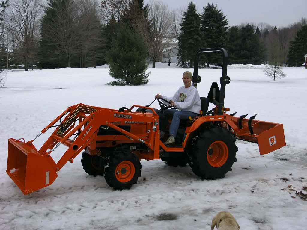

Bob;
Knowing your fondness for Befco I thought I'd add my Befco Box Blade pic. Just like the RFM, the blade is heavy,strong and well built. Scarifer adjustment is easy with gloves and the scarifer locking pins are captured by verticle plates on both sides of the pin. My only complaint would be the need for more slope on the side plate lower edge to prevent it from riding on the material.

Merlin1 . . . I do like the Befco products a lot. On their box blades I like the fact that they reinforce the lower link pins all the way to the back of the blade and then reinforce those weld points along the top of the back. Befco doesn't do anything cheaply but they sure do it right. Thanks for the addition of the picture.

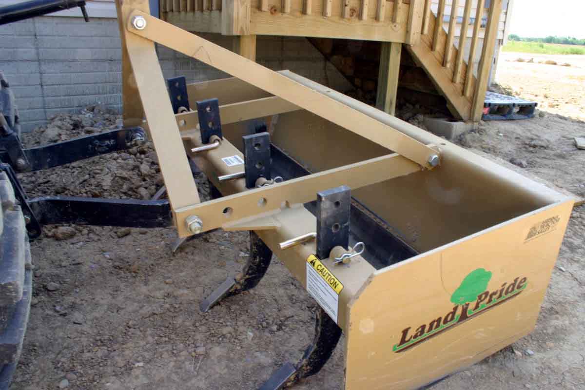

here is one of the LandPride

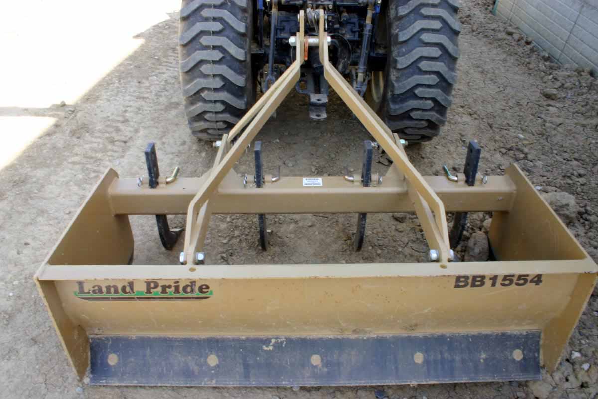

and another

Great photos of the Land Price box blade.
I had not seen a "15" series box blade in person. That is their lighter duty series. It appears that the 15 series is a nice basic blade. I'm familiar with the "25" series box blades, they have the captured lower link pins with reinforcement that extends to the back of the box, as well as a heavier A frame assembly.
I know they make 2 or 3 series of box blades, plus they also make 1 or 2 heavy duty series with retractable teeth. Many of the brands have various duty levels like Land Pride.
