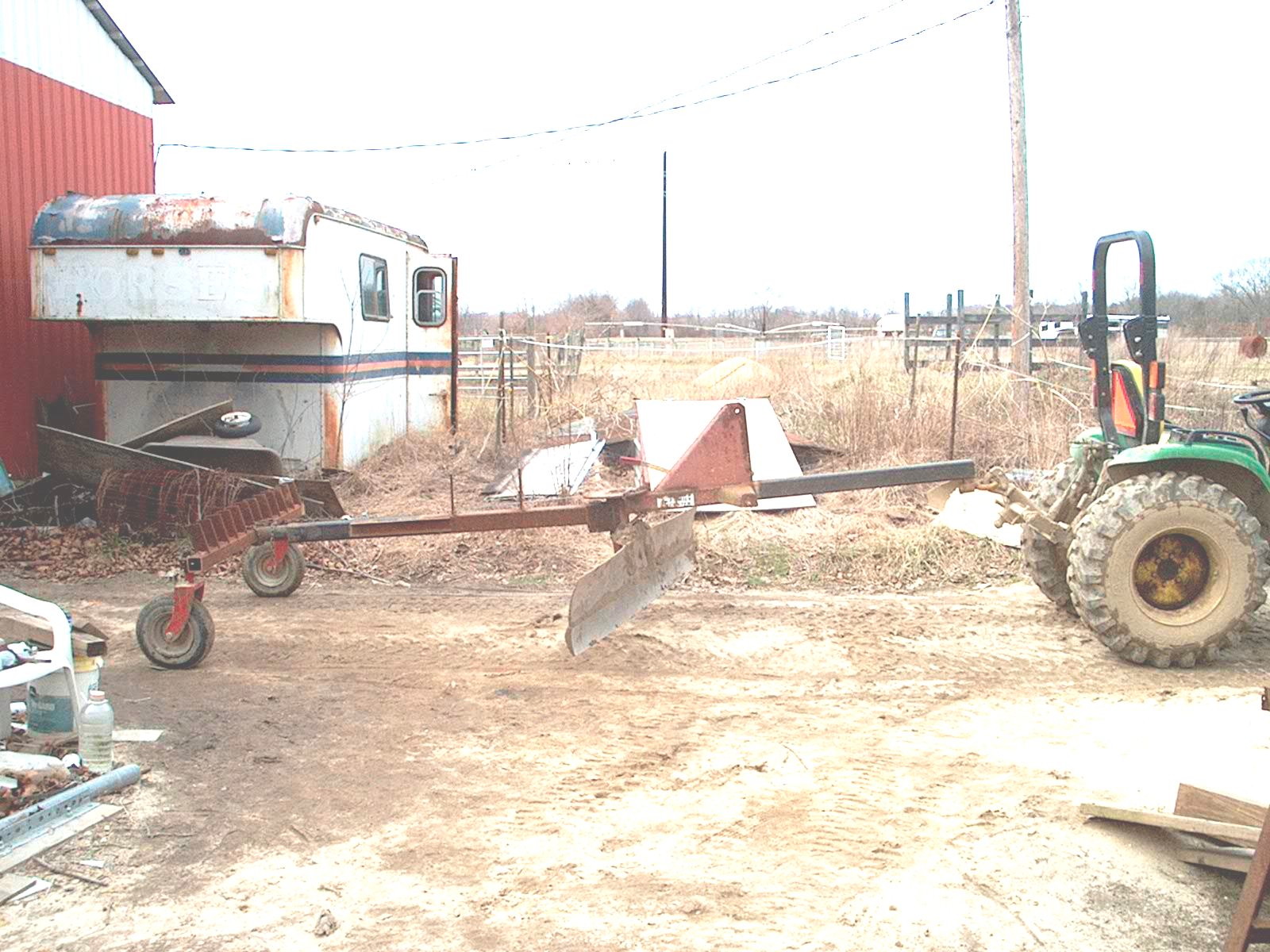

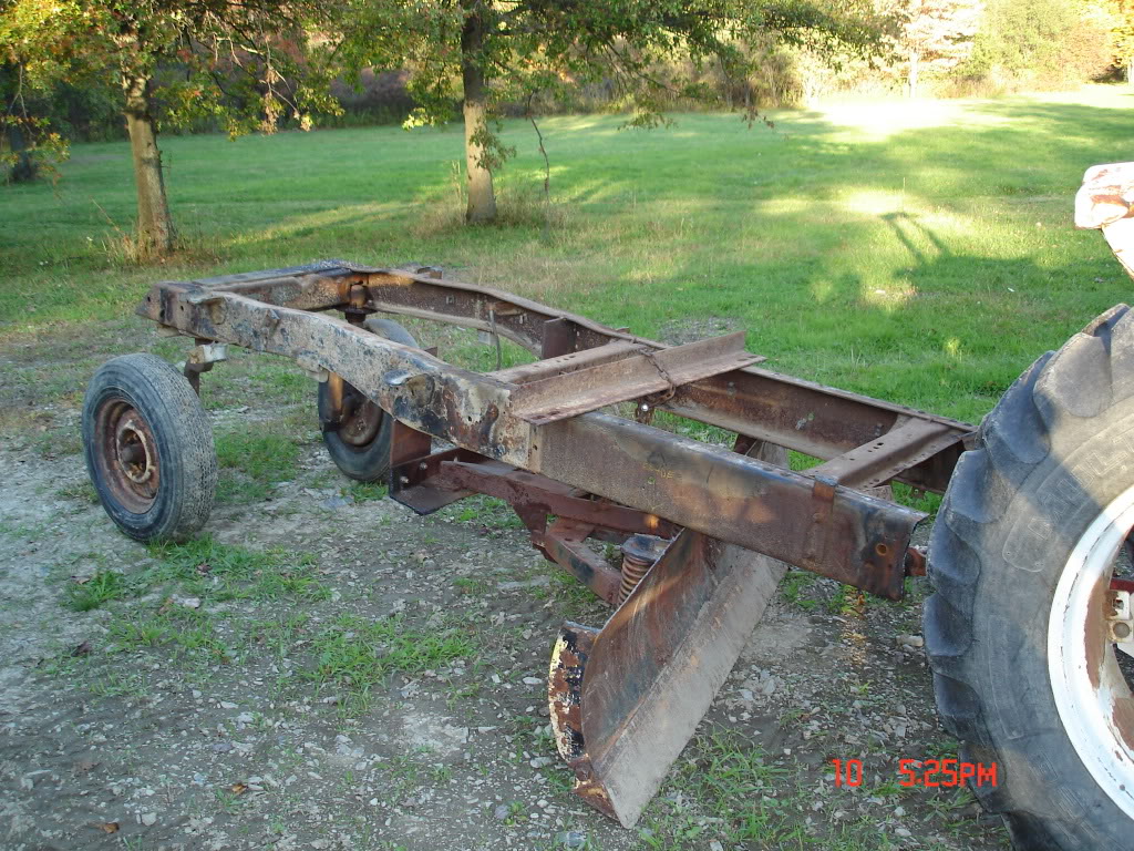

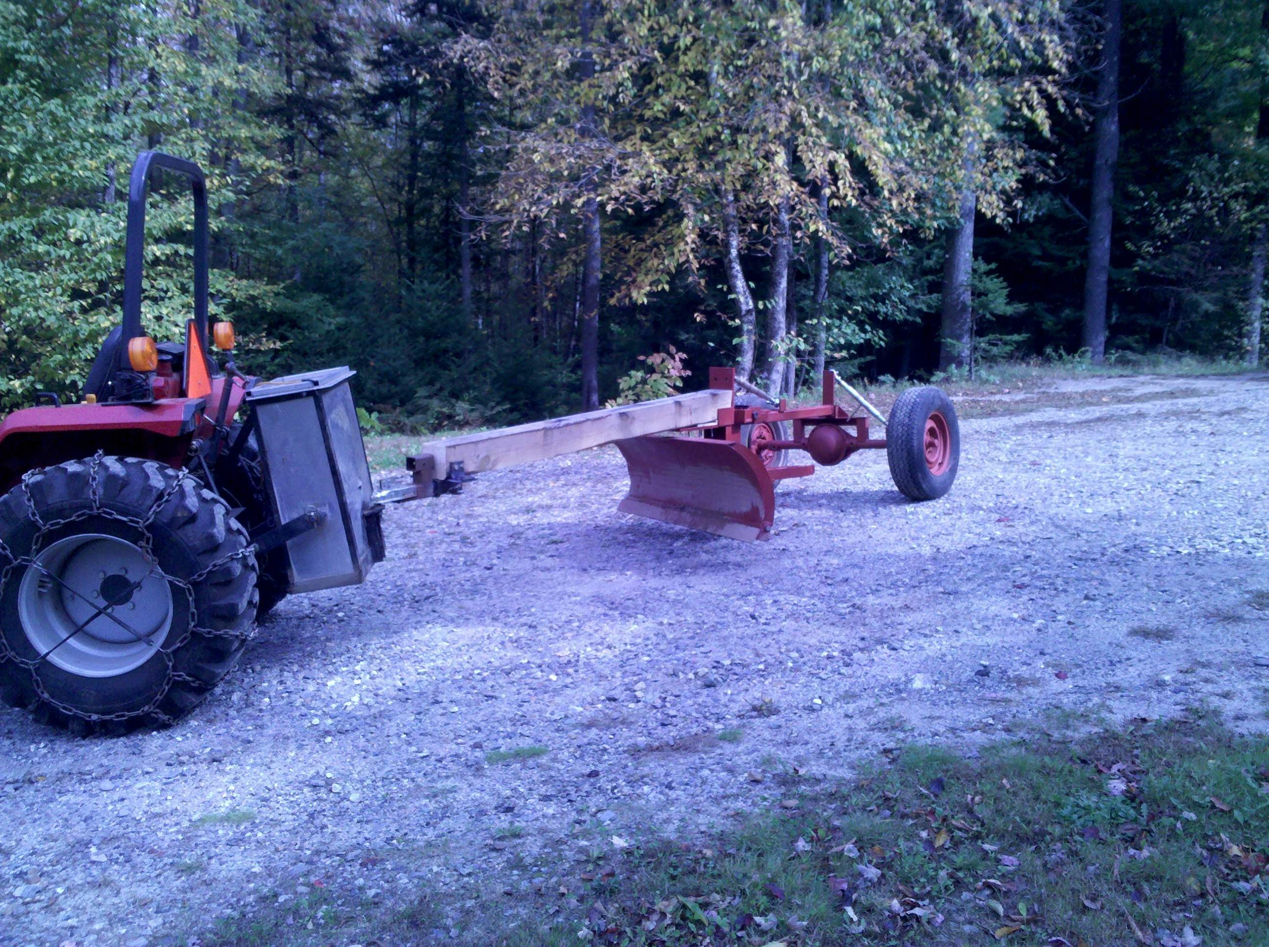

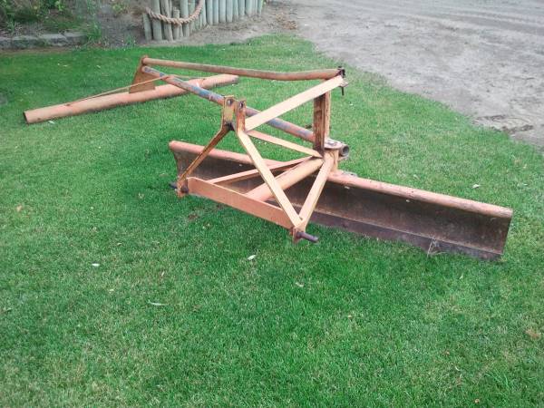

Some improvised long graders:
Old truck, later in the video:
https://www.youtube.com/watch?v=Dpeg9yTPuEo
Some photos, probably from TBN.
Beam-Diff1.jpg rearskid1.jpg View attachment 433619 truckframe1.jpg truckframe2.jpg Tongue-Wheels1.jpg

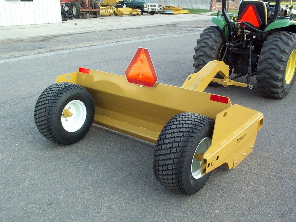

This is an example of a pull type box blade where the depth of cut is controlled with the 3PH.
