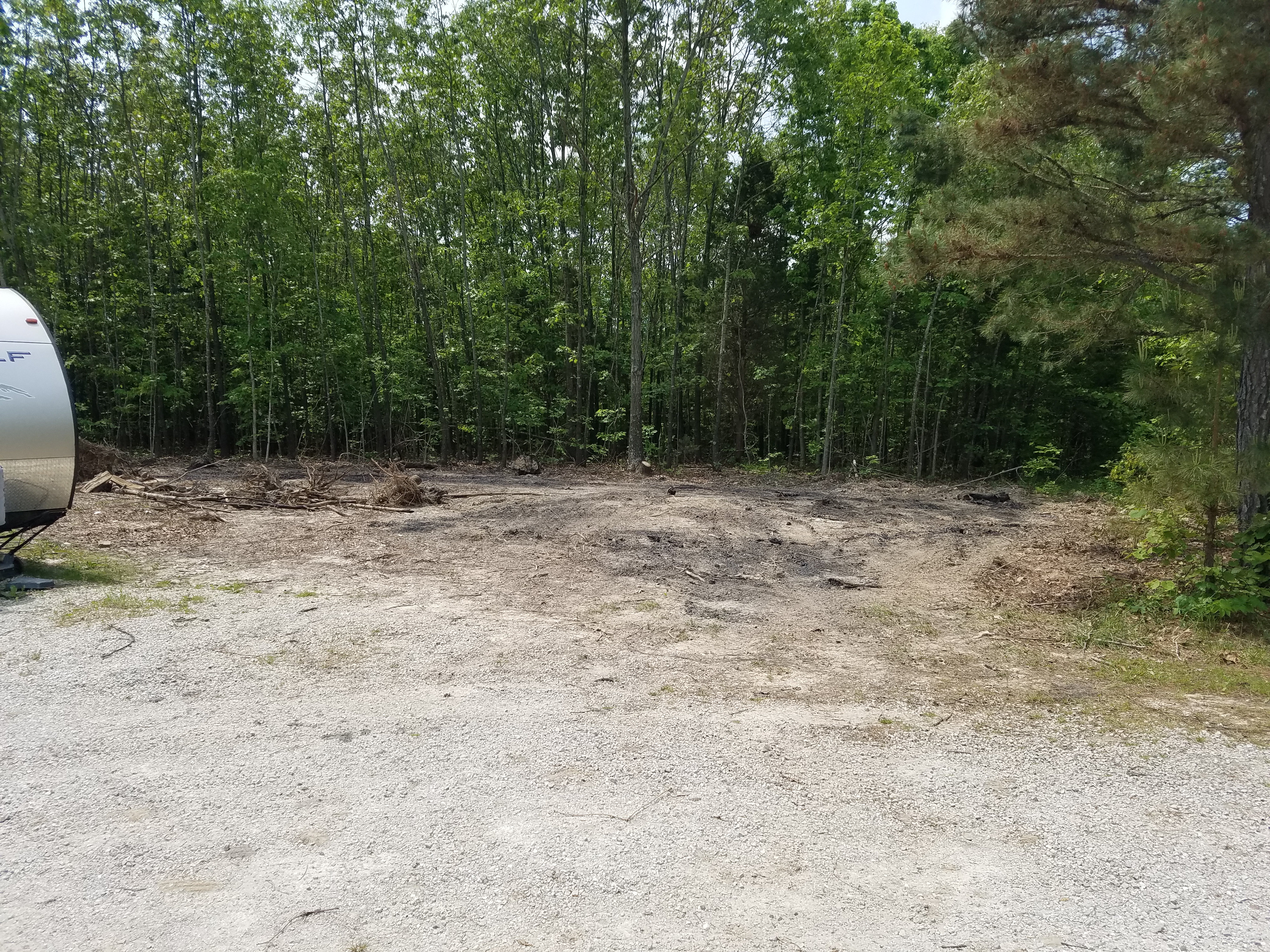

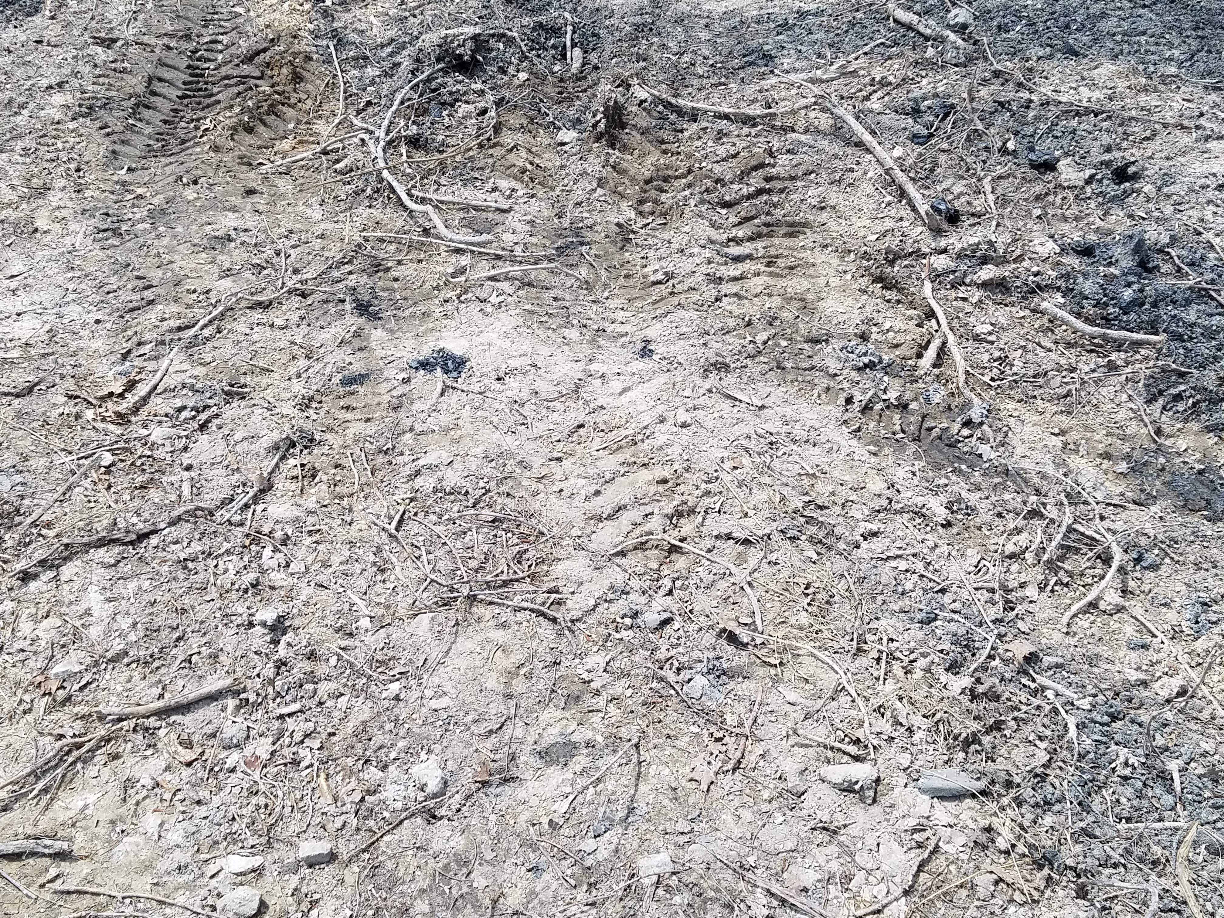

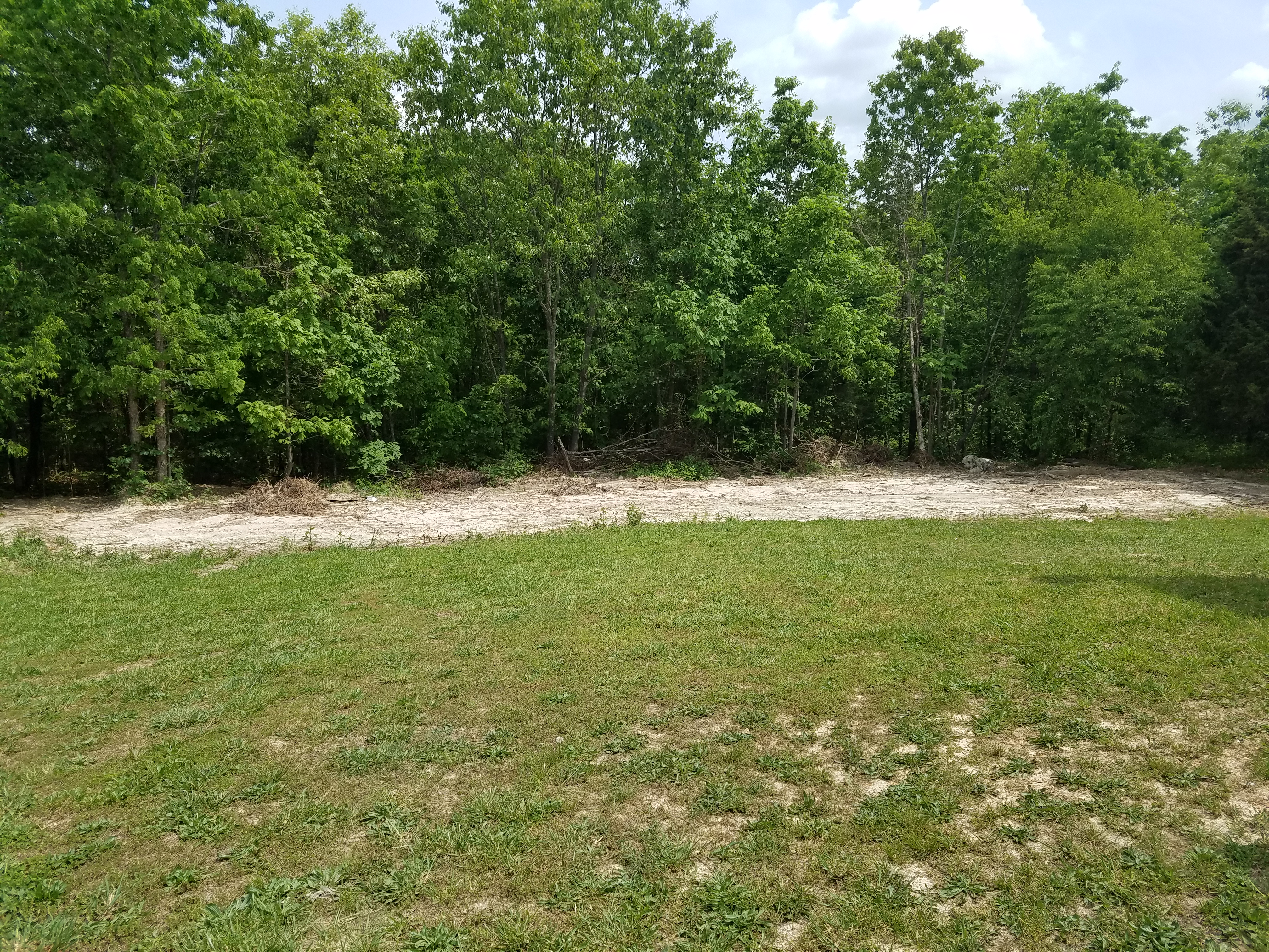

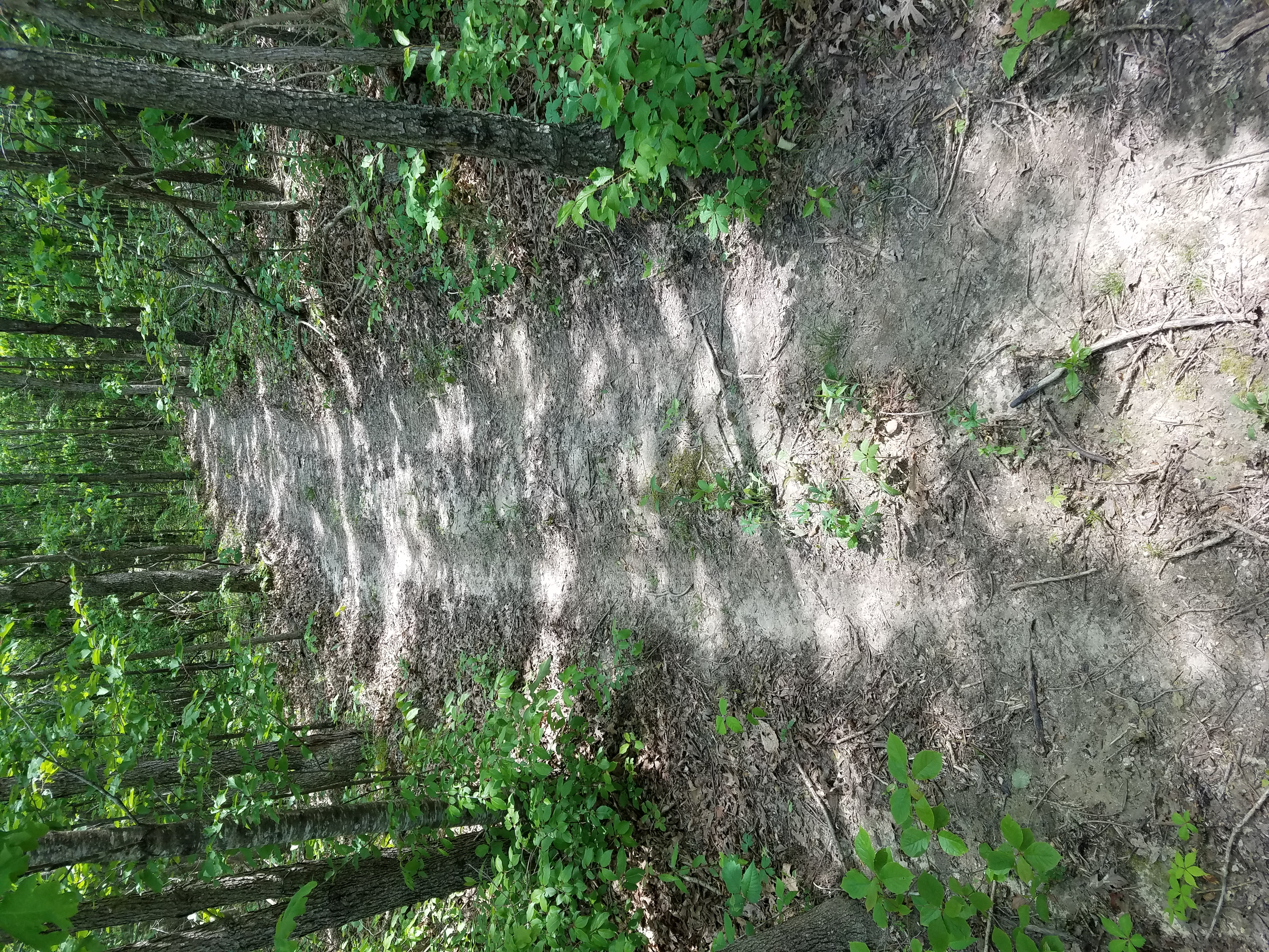

I sure hope it can do what I'm wanting it to. I have never used one so I'm not exactly sure what to expect. Here is the ground I currently have to work. Not huge areas, but kind of a lot of left over thin roots from when I cleared it with a mini excavator.

The rippers are adjustable. I would start with minimal ripper ground engagement and adjust, according to your needs, from there. The area around the camper looks like a good spot to practice. Drop on the edge of the high spots and drag through toward the low spots. You'll probably find that you will constantly be working/feathering the 3 point raise/lower with your right hand while getting a sore neck from watching what's going on lol
I usually set my box blade to be slightly lower in the rear and adjust side to side angle if needed.
You'll get the hang of it. All the advice in the world doesn't add up to a few hours seat time.
