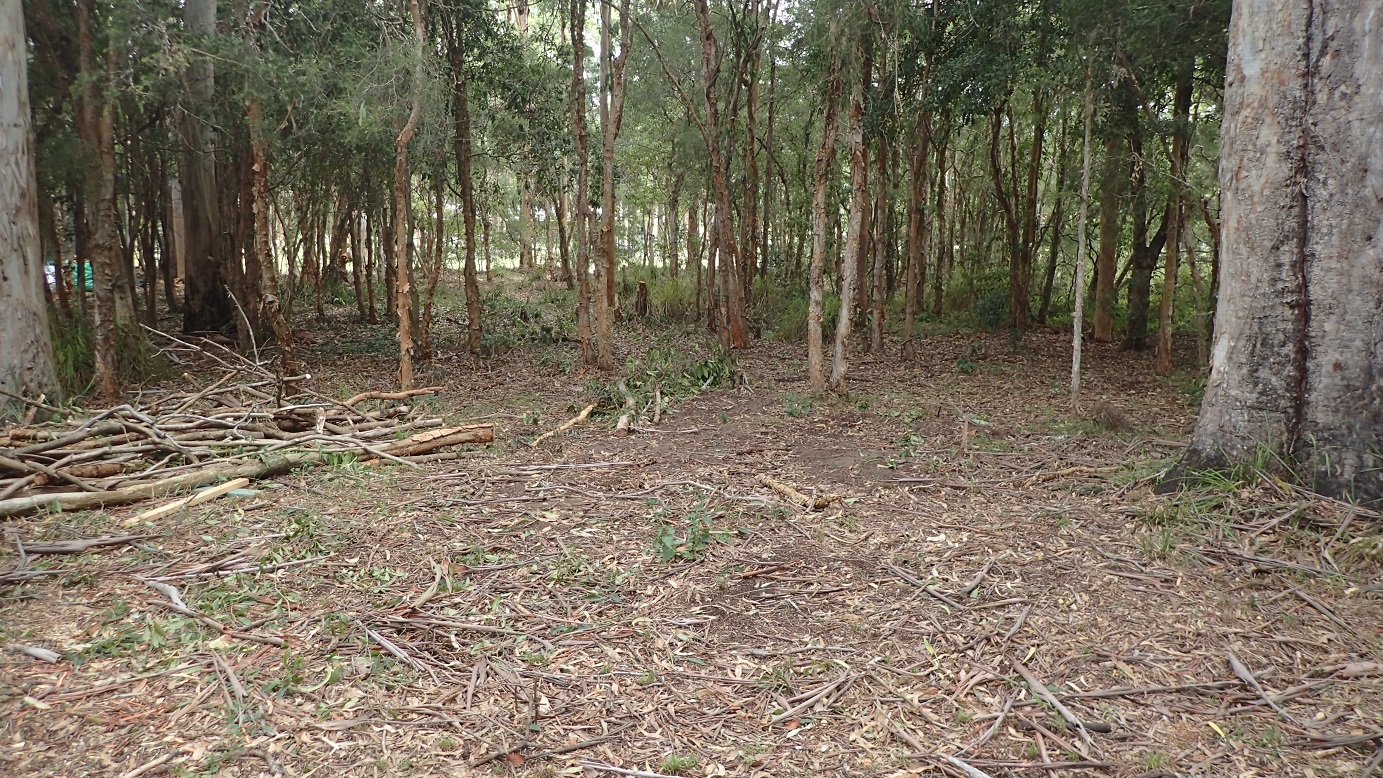

Hey Folks,
Ordered a 5ft box blade for my B26 last week, hopefully receiving it today!
Does anybody have some tips for getting this thing set up correctly?
Apparently the length of the top connector is very important to get effective results, any advice is always welcome....... I am going to try and clear up this area with it:
Thanks :dance1:

I've got a 5 foot BB and have used it for years - both on a driveway and on raw ground. It works well and, really, is pretty obvious in its use so you shouldn't have much problem. You will want to keep it level with the tractor wheels - unless you want to make a ditch. I've used my to make really nice ditches. The top link rocks the blade back and forth. If you shorten the link the BB will ride up on its sides and be useful for smoothing gravel or finishing dirt. If you rock it back, it will dig in more and fill up pretty quickly. If you put the teeth down, it is handy for that plot your picture shows - unless you have a lot of roots or rocks.You can - again - adjust the angle of the teeth to do what you want them to do - dig deeper or stay shallow - and you can adjust their depth by sliding them up or down and pinning them where you want. My suggestion would be to leave the BB fairly flat at first and put the teeth down a few inches. Work the ground a bit then - depending what you ultimately want to do with it - try different settings and see what happens. Experience is the best teacher. I played with mine for a month or two and now find it an awfully useful tool for all sorts of things.

I must be missing something. What are you doing with it?
It is not a clearing tool, it is a grading tool.
I'm planning to clear up the area, break up the top soil (it gets baked hard as down here in Australia), then try and flatten it out for some grass perhaps.
Its probably not the best photo as you cant see all the uneven areas down the back :)

what are you going to do with the trees
/ Box Blade Tips
Planning to leave some of the healthier ones then cut the others down and dig out the stumps, hopefully can just bulldoze a few over.
Long term plan is to leave the taller trees and turn the area into a sort of shade garden with a watering system!
