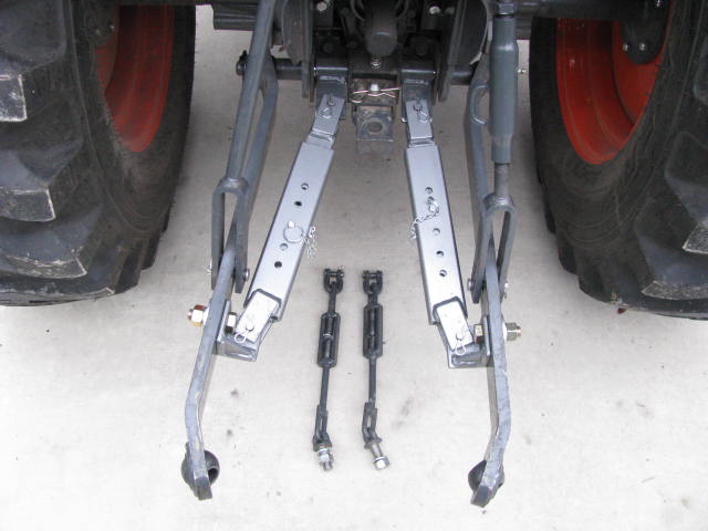

TRACTORS ARE DESIGNED TO PULL. You can reverse - push, gently, LOOSE dirt, IF YOU HAVE RIGID THREE POINT STABILIZERS supporting two Lower Links of Three Point Hitch. (See picture)
If you have "Turnbuckle" "check chains" you will bend them if you push. (Ask me how I know.)

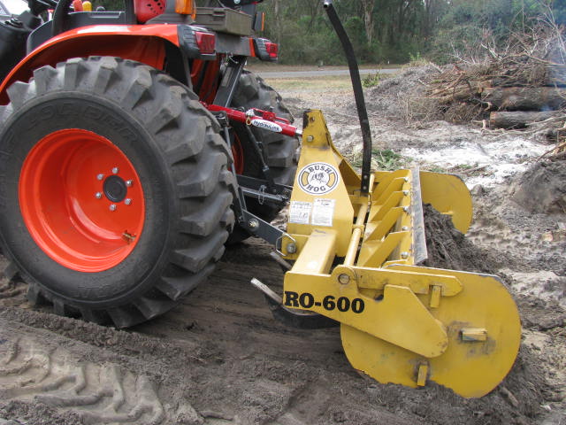

Stayed in the CCC cabins in Monte Sano State Park during early December. Nice. Quiet.

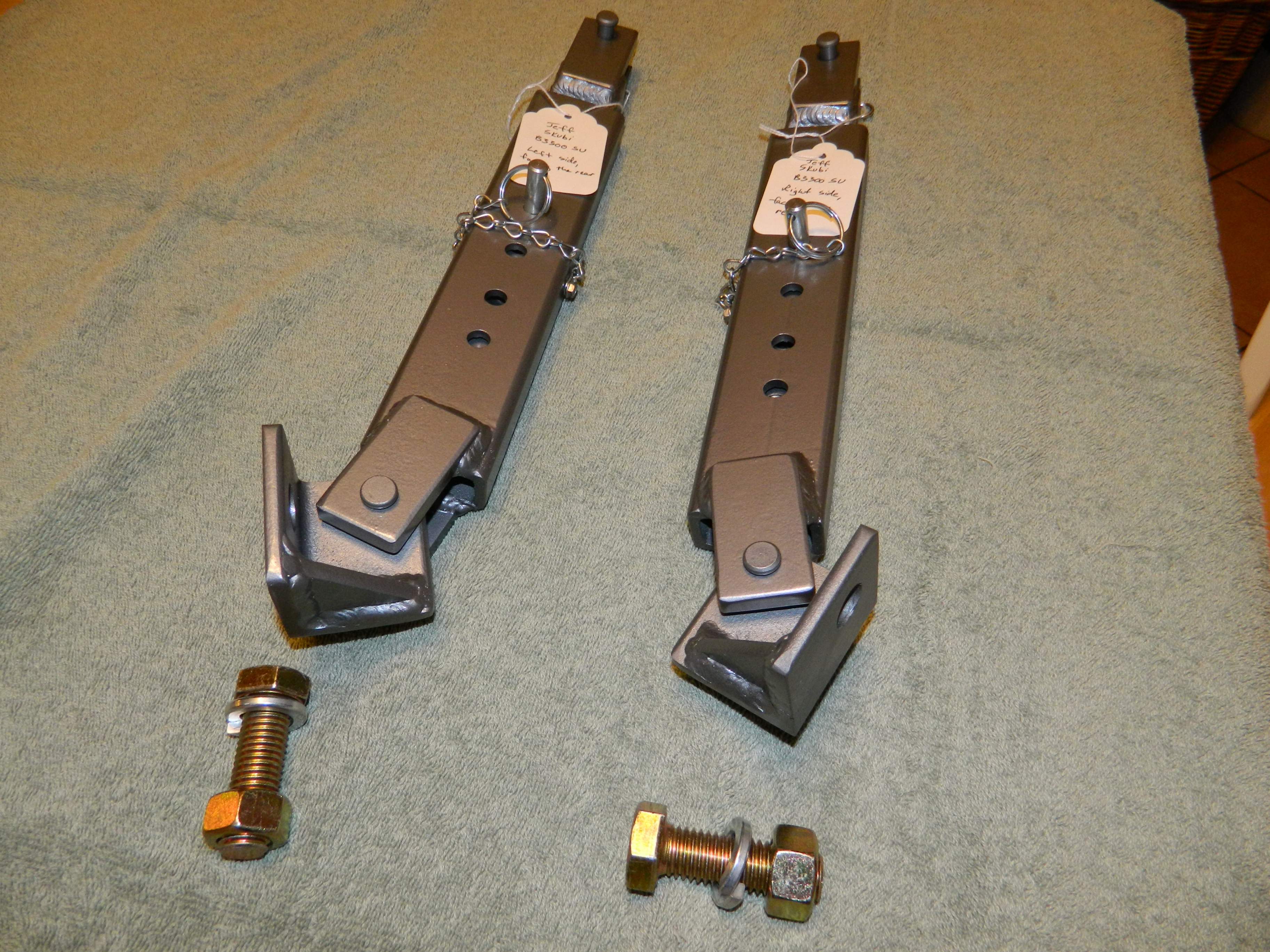

Jeff, thanks for the tip about filled tires, I do not yet but will soon. I have a FEL installed so hopefully that helps some as well. I do have rigid style pin adjust links like you show in your pics but they are on the outside instead of the inside and the go back to the axle mounts on each side. Great advice on the tilt to thank you

I do not have loaded tires on my 1,900 pound Kubota B3300SU and I pull a 560 pound Rollover Box Blade without difficulty, through rock free, sandy-loam.
With you rigid stabilizers supporting the Lower Links you can push SOME, LOOSE dirt, gingerly. You cannot compensate for the fact that tractors are fundamentally designed to PULL.
