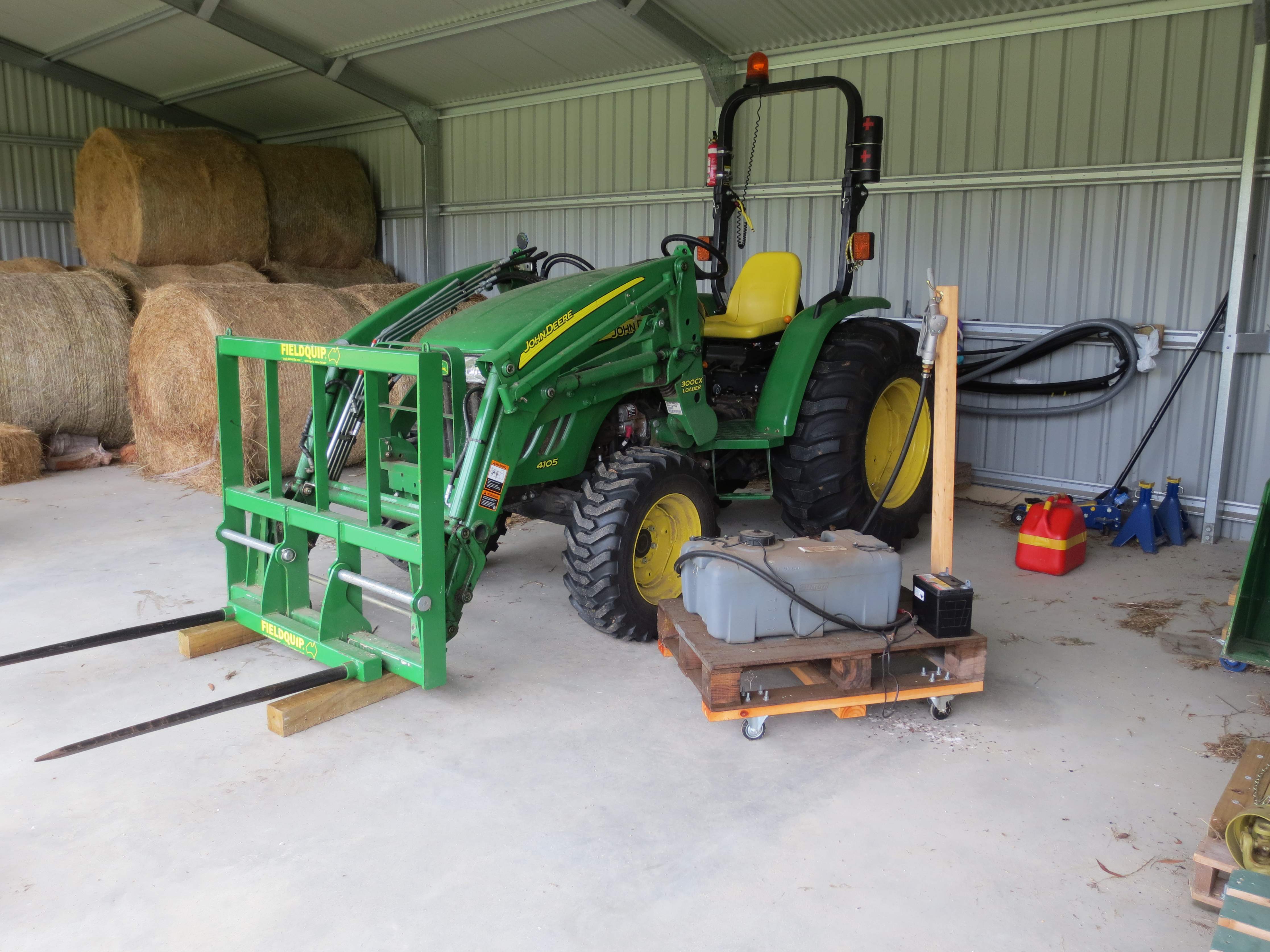

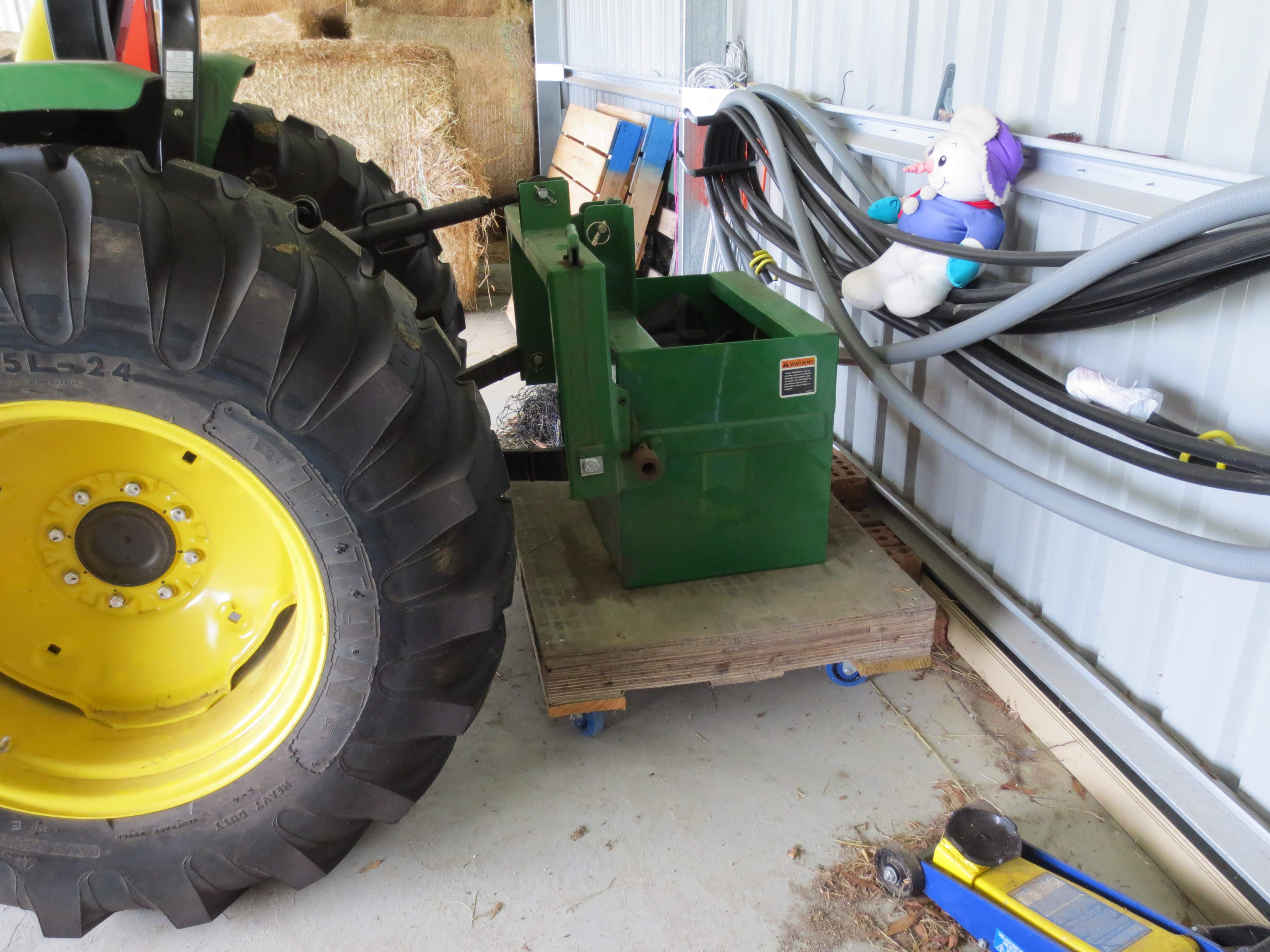

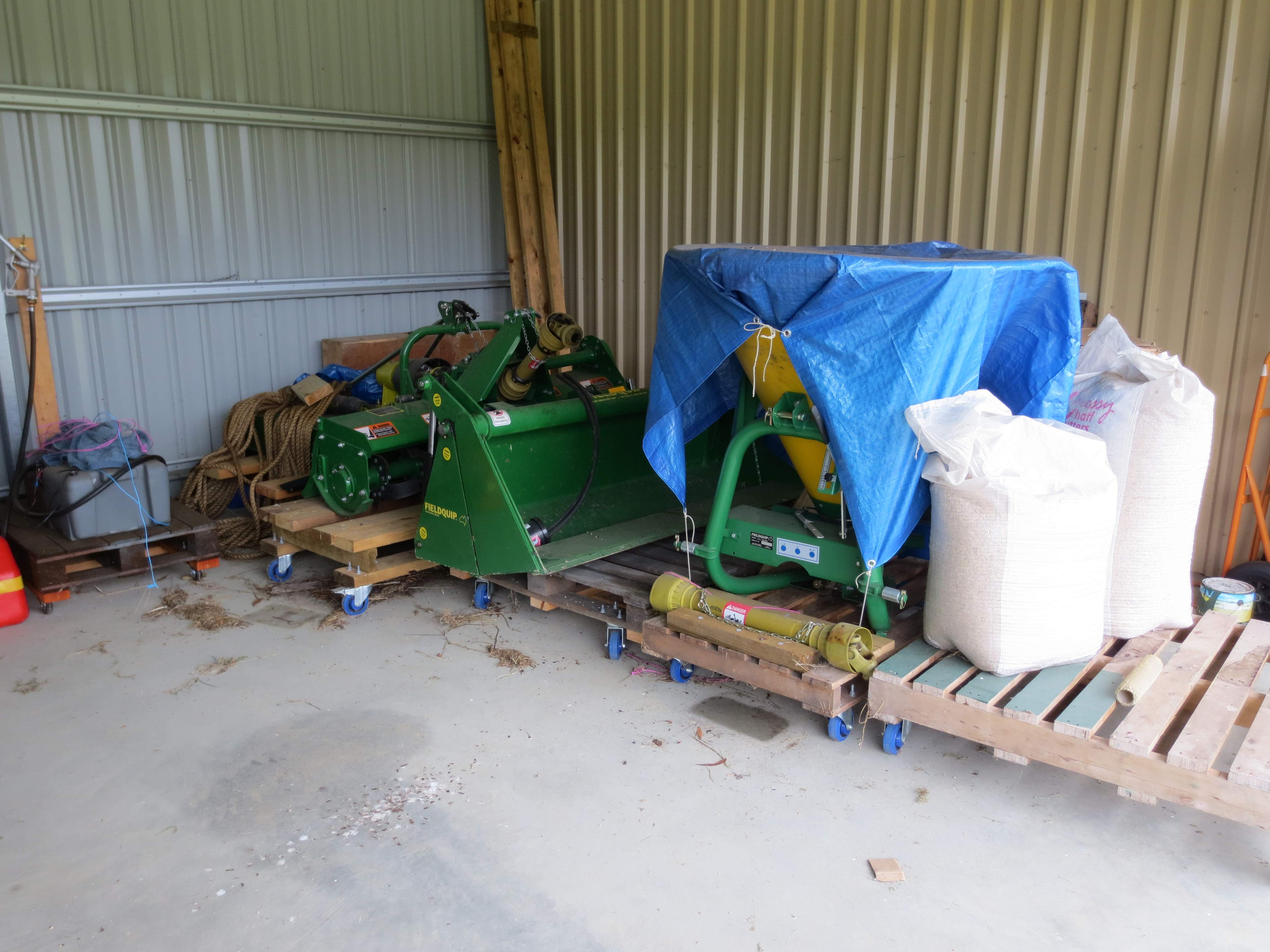

A quick word to the wise... PALLETS are your friend! Especially wheeled pallets. You can customise them to your individual implements using 2x4 or 4x4 hunks of wood.

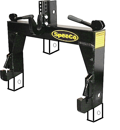

I think secret with using quick hitch is making each implement compatible with one QH setup.... Unfortunately the industry is all over the place on 3PH setups (due to long time adaptations of many, many years) and only now "some" manufacturers are adopting QH standards.....
My plan is to make all my implements compatible with my QH, do it once cry once, be happy for long time...
Only wrinkle in my plan is I have SCUT and in lower position lower hitch points are only about 8 inches off ground, and at full lift only 24 inches, that severely limits how much actual lift I have ( seems most implement manufactured have lower pins about 14-18 inches off ground for BIG tractors.... Am thinking I may lower attachment points of QH about 4-6 inches (weld on extensions) to give me more initial height of QH (on tractor arms) and therefore more vertical lift capabilities... Does this seem reasonable?
