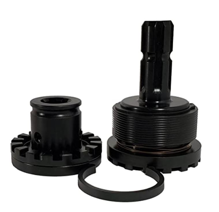

Pat's easy hitch extended my lower arms 4 inches. They may not be as good as the euro hooks but they were cheap and easy, good enough for me.
I made a simple extension for the top link and added an easy hitch PTO connection. It all works great for me.
