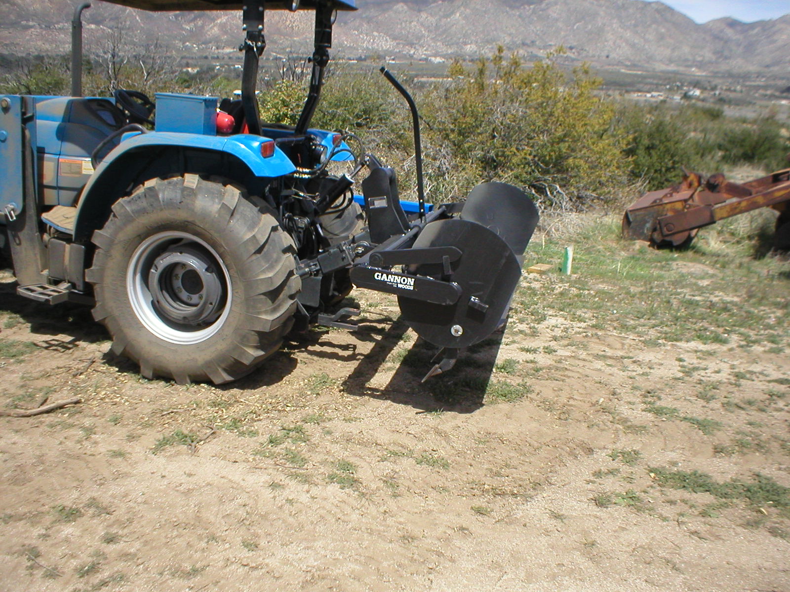

Most of the hydraulic actuated rippers go down flush with the cutting edges, so there is no need to be tilting the box to get the rippers to engage.
As far as your box, set the rippers to be down below the cutting edge and use your position control to hold the box up so that only the rippers engage, not the cutting edge. If your clods are big enough and not break up, then I guess you have a problem. The Roll Over Boxes do not have this problem at all.
So that is another advantage of a rollover box blade, if you just want to rip the ground, the rollover design has nothing behind the rippers to catch the large clods. Thanks Brian.

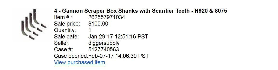

Oh really? For clarification, I'm thinking about this eBay vender who also sells these in sets.
1 - Gannon Scraper Box Shank w Scarifier Tooth & Clip - H92 , 875 , K136 | eBay
That link didn't work.
Also, if you purchase them, make sure that the notches are spaced appropriately. I know mine were not and I had to notch them. This could have weakened them somewhat, I recognize this, but I've had 3 snap. I've thought about just finding someone with a CNC machine, and having them cut out some heavy ones for me. Also, make sure you get the length you need. I know they have a longer set which might put the teeth too far below your blade.
This is a pic of the second 'set' I purchased. I have had a horrible time finding shanks for my Gannon 4X2.

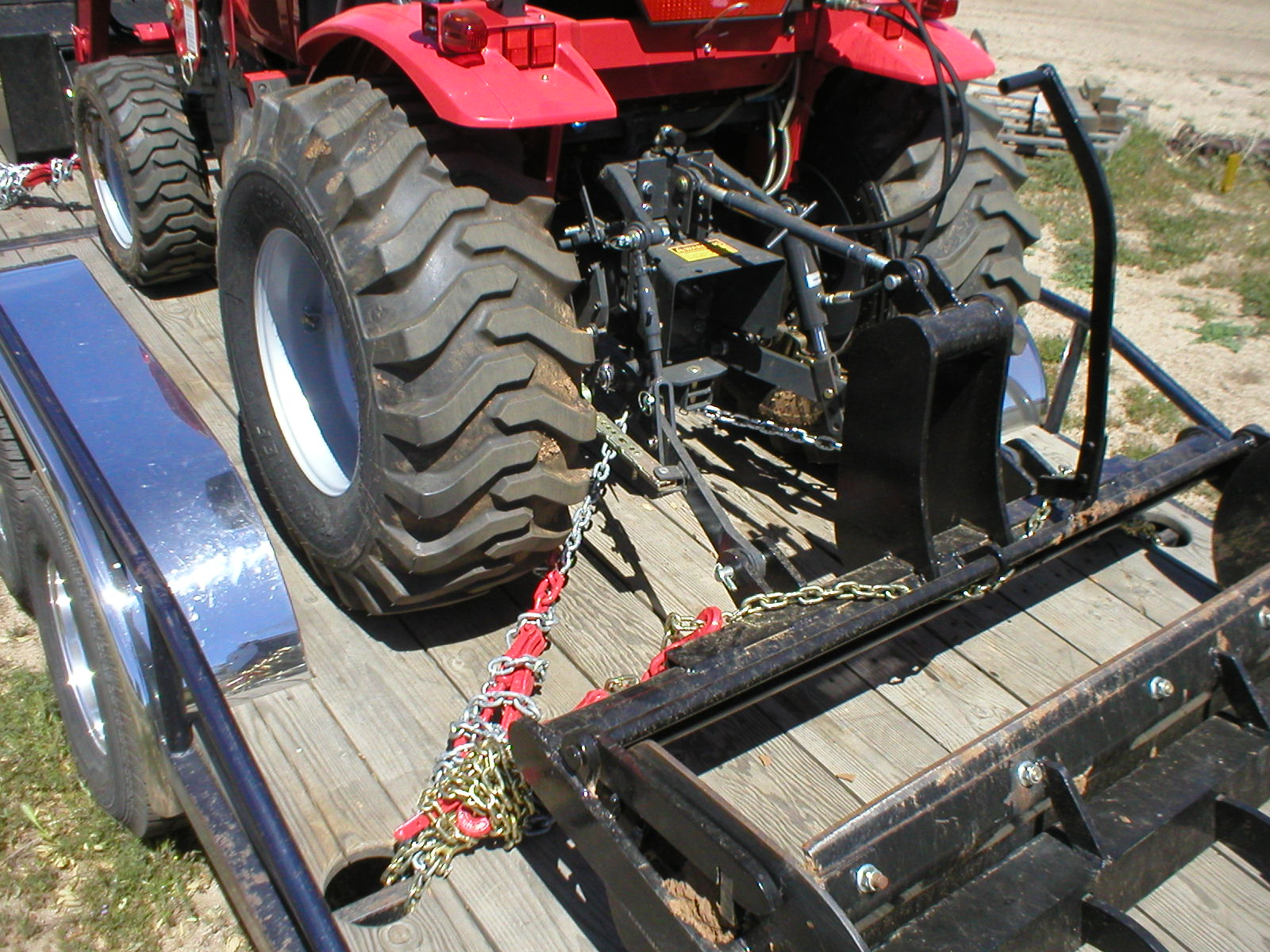

/ Box Blade Variations. #11

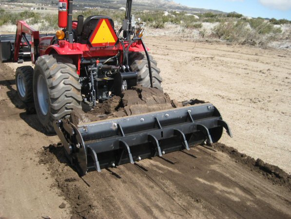

Eric, maybe you should say, "I have found very little use for my hydraulic side link" . People that grade a lot in varying conditions use their hydraulic side links all the time. I personally would not be without one, in fact I put my hydraulic side link on before my hydraulic top link as seen in the 1st picture.
Granted a std type box blade would require a hydraulic top link to be useful before a hydraulic side link.
I happen to have ROBBs for both of my utility tractors and don't really need a hydraulic top link when using them. ;)
