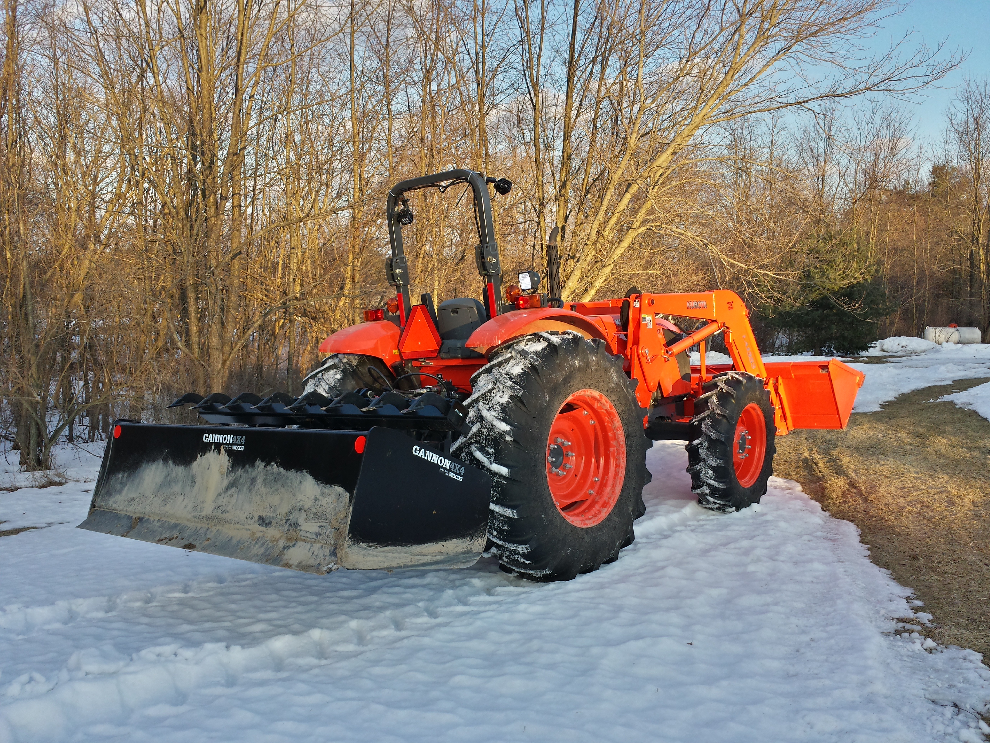

Knowing you want to end up with a 100 hp tractor the woods gannon hsd and hxd is top of the line and the benchmark others copy. Cammond 4c4 4c5 and FFC 440 are the others i would consider for a tractor of that size.
http://www.tractorbynet.com/forums/attachments/304549-gannon-88-hsd-box-scraper.html
