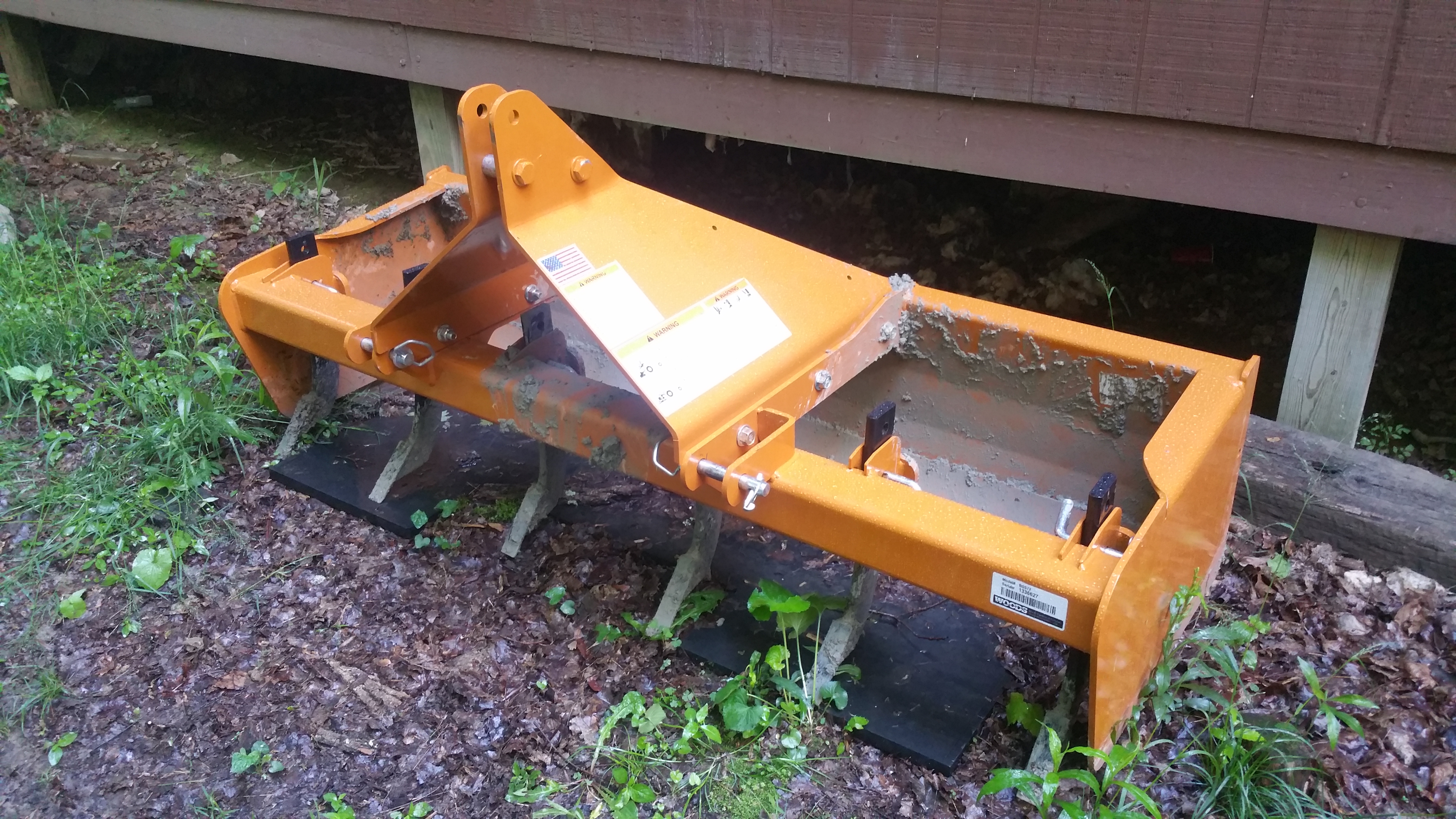

What痴 would be a good weight of a 72 box blade for a 35hp tractor? I read a few years ago that you would want it at least a certain weight to be able to dig into the ground on its own.
/ Box Blade Weight #2
I have a Bush Hog 720. Its a 72 inch roll over box blade. It weighs 710 pounds. Thats 118 pound per foot of width. I also have a hydraulic top link - almost MANDATORY if you want efficient use of this implement.
I recommend looking at your tractor OP manual and see what the manufacturer recommends. Most everybody - except me - says - - get a box blade or rear blade at least as wide as the outside width of your rear tires. My box blade is 72" - my rear tires are 80" outside to outside. Now my rear blade - Rhino 950 - 96" - 1050 pounds.
As with ALL ground engagement implements - box blade, rear blade, land plane grading scraper, disk harrow etc etc - - weight is your friend.
There will be a limit - you don't want to go so big that you will cause damage to the tractor or 3-point assembly.
With the hydraulic top link - I shorten the top link - the box blade tips down and digs in - I can very rapidly have my 64 hp tractor at a dead stop with all four wheels digging.
I would start looking for a box blade as wide as the outside of your rear tires and around 100 to 120 pounds of weight per foot of box blade width.

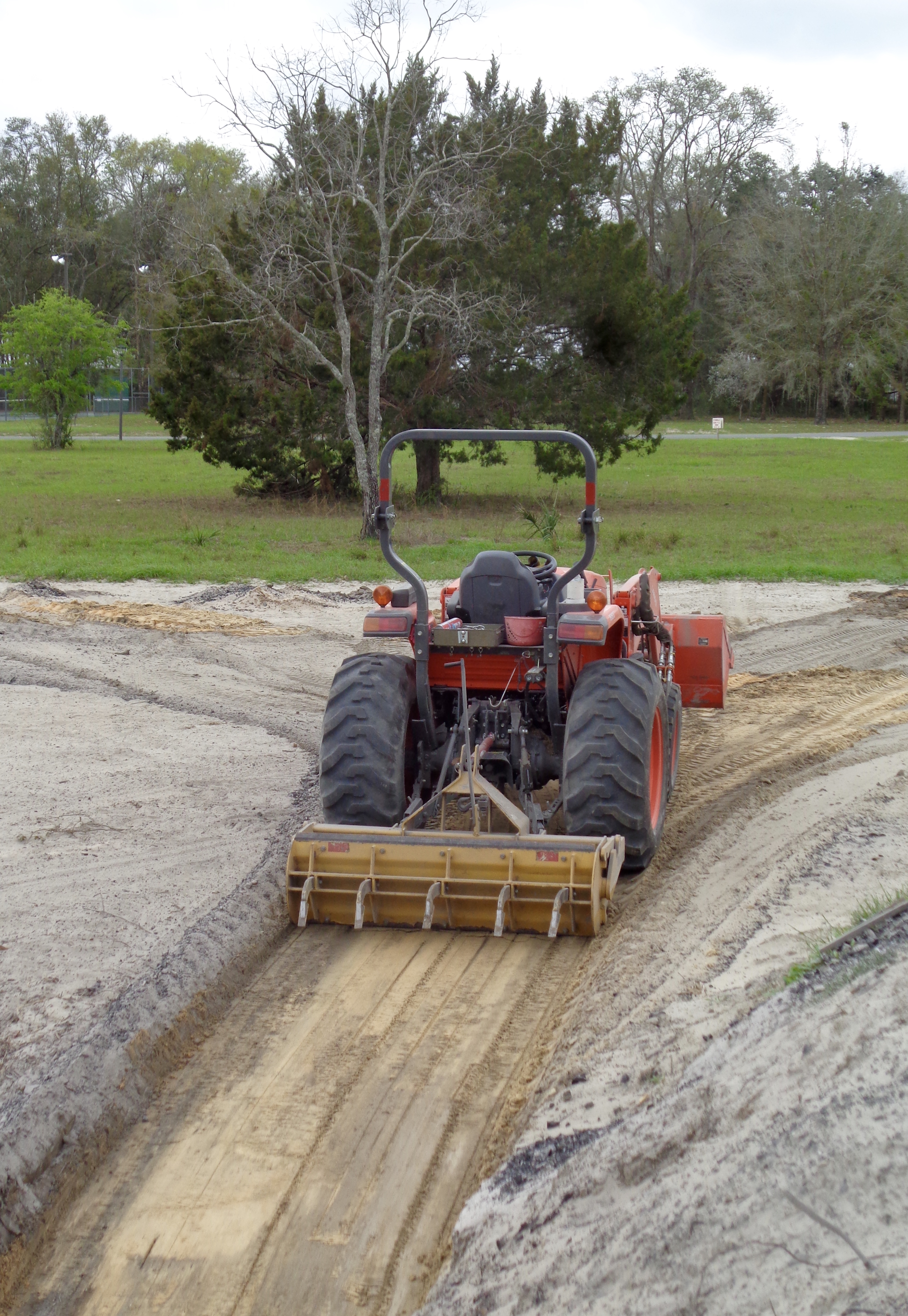

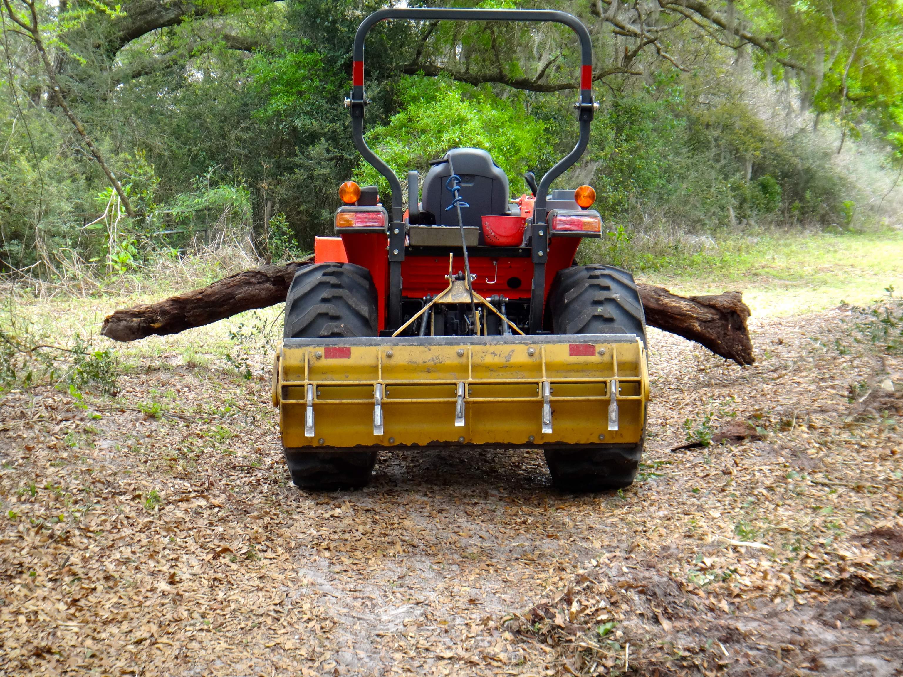

My tractor is a Kubota L3560/HST/4-WD, 37-horsepower, 3,500 pounds bare tractor weight. Rear tire width 62".
I use a 60" Bush Hog (brand) RO-600 Rollover Box Blade, 630 pounds, regularly = 126 pounds/foot of width.
Good FEL counterbalance for all except max lifts with my 1,700 pound lift capacity LA805.
Perfect match to tractor.
As picture illustrates, I have Florida sandy-loam.
If you enter a location more precise than USA into your T-B-N profile you will receive advice better tailored to your conditions. Your questions here is a good example.

My Woods BSS72 551lbs works great with my Mahindra 1533. 63 in. wide so it sticks out a little. Weights does help with a box blade but if your tractor is not heavy enough to get the traction needed. Then you will literally be just spinning your wheels. IMO anywhere from 500-700 lbs would do fine on a 35 hp tractor.
