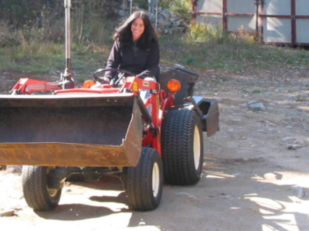

Of course nobody knows us like our wives do. Even after 40+ years of marriage, Ihaven't the slightest idea what my wife really thinks of my tractor hobby...my guess is that she thinks it was a basically good idea that has now gone a bit too far and and takes up far more space than she ever thought it would.
And I'm also guessing - or hoping - that she admits having the right implement at hand is honestly useful at the oddest times. Especially now that we are older it pleases her to have the tractor lift things that she would rather I not do with muscles alone.
Damage to yourself makes the most expensive tractor look downright cheap.
Pricewise, I think she figures that of all the nutty things that guys will do as hobbies, a tractor hobby is pretty much dollar-reasonable....maybe modified by some well-concealed shock at how many $$ a rusty piece of metal can cost and then mentally comparing a rusty - but usable - RO Box Blade to sailboats, racehorses, and monster trucks... But then like most girls she always knew that guys were crazy.
And there's no denying that tractors at least tend to be less expensive than a whole raft of other things I've gotten us into.
Plus there's the sheer fun factor. Sometimes tractors really are fun.
rScotty
