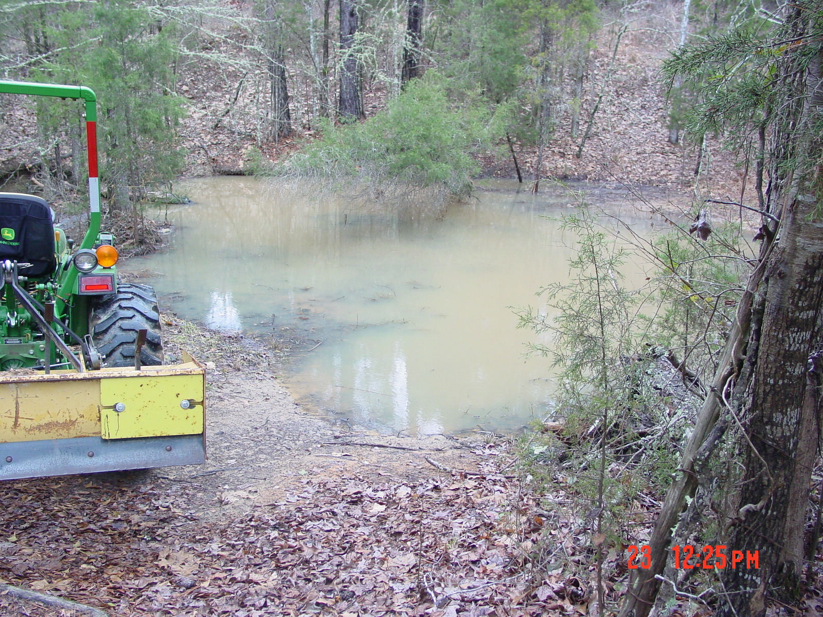

Here's what I did. To be honest, I am not sure what these weights came from, but they were bolted to the rear wheels of a JD 750 that I bought some years ago and then later sold, but I kept the weights. Sorry, this the best pic I have at the moment, but you'll have to take my word there is another weight on the other side of the box blade.
