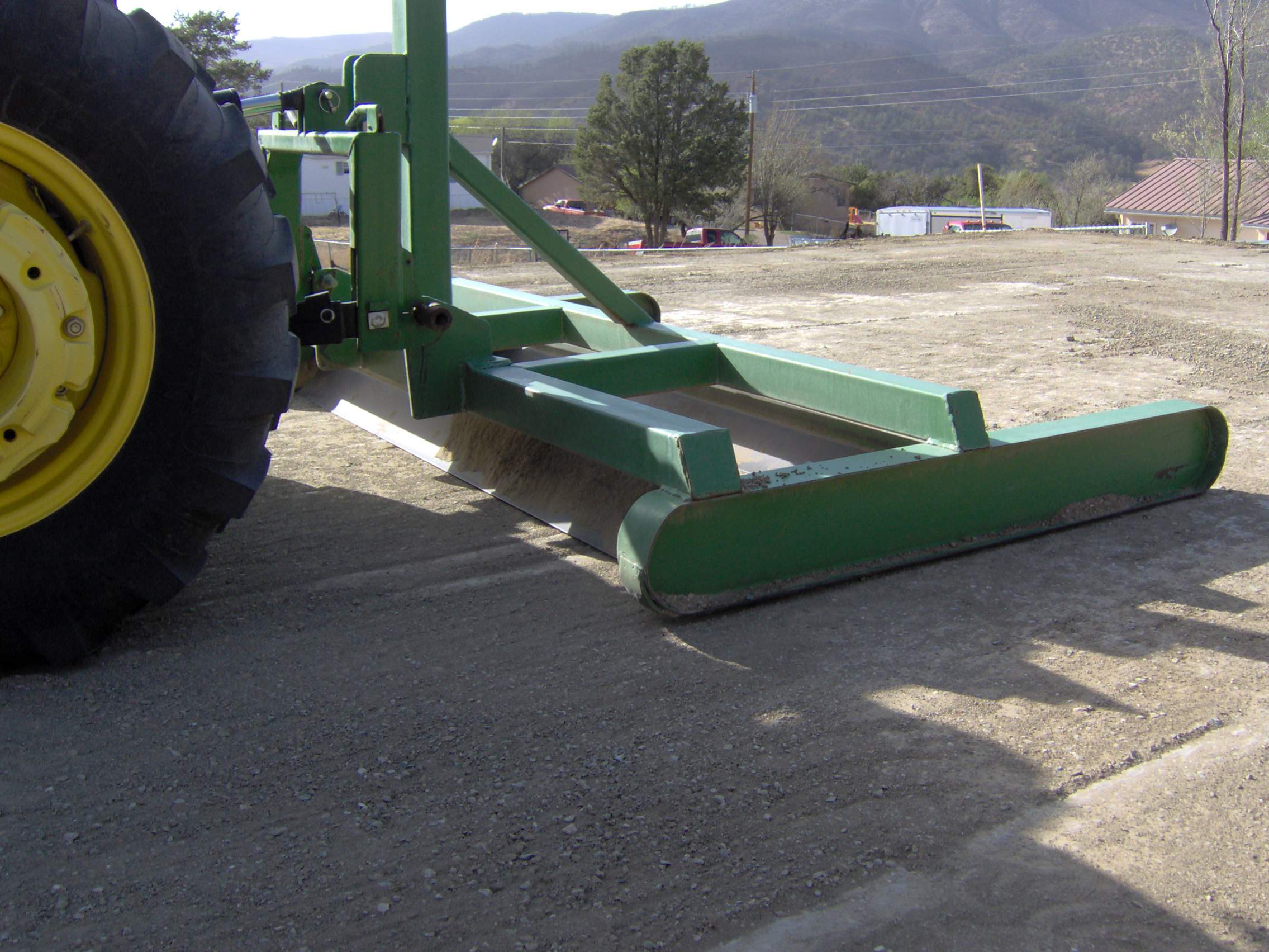

Just for S&Gs: Are there any good freeware plans here for a home built land plane grader?
Thanks,
/ Box Blades #52

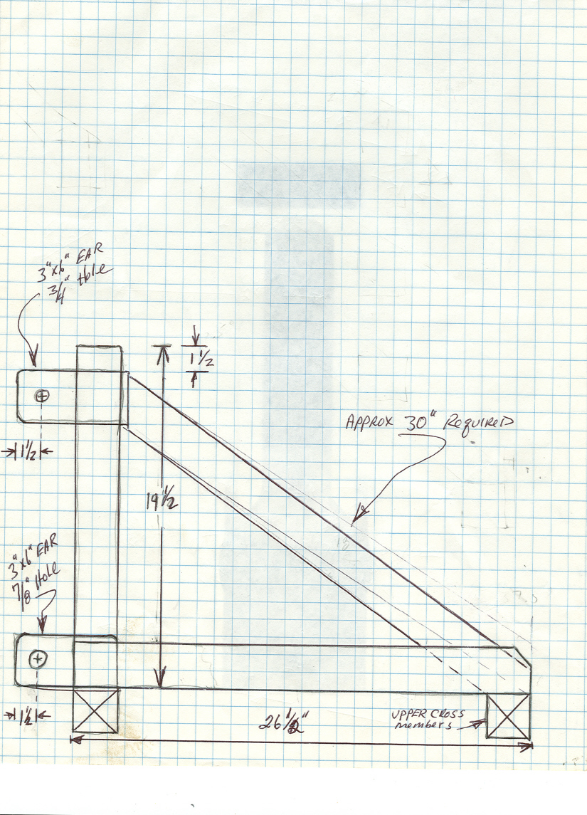

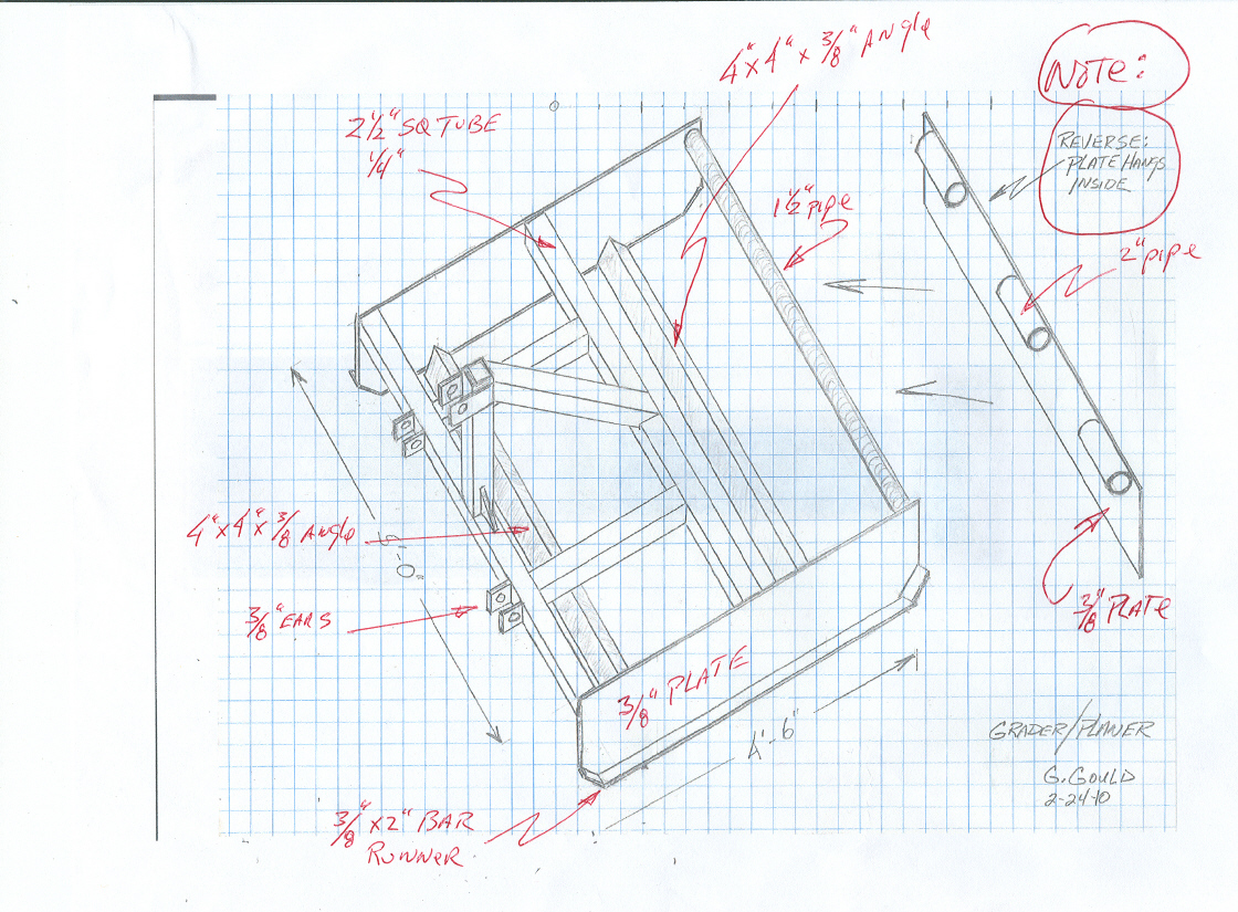

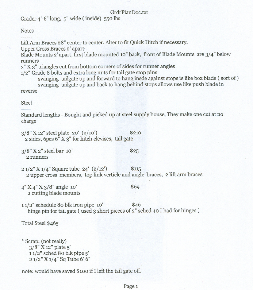

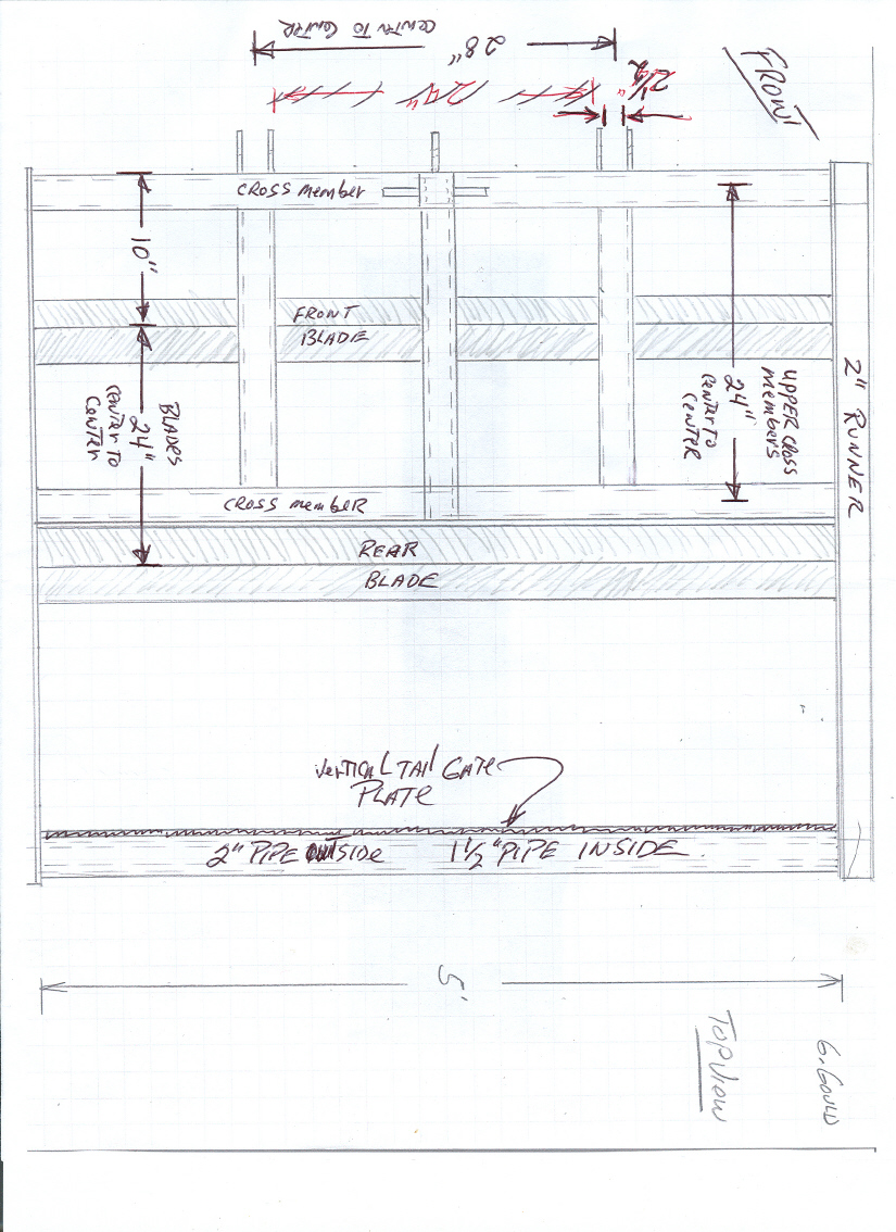

Here's one I've gathered, probably on TBN.
/ Box Blades #53
Thanks!
ETA: Question about the 2nd pic/drawing: Is the length of the grader 4'-6" " or 4'-6' ? In other words 4 1/2 feet or 4 to 6 feet long?
Thanks,
/ Box Blades #54

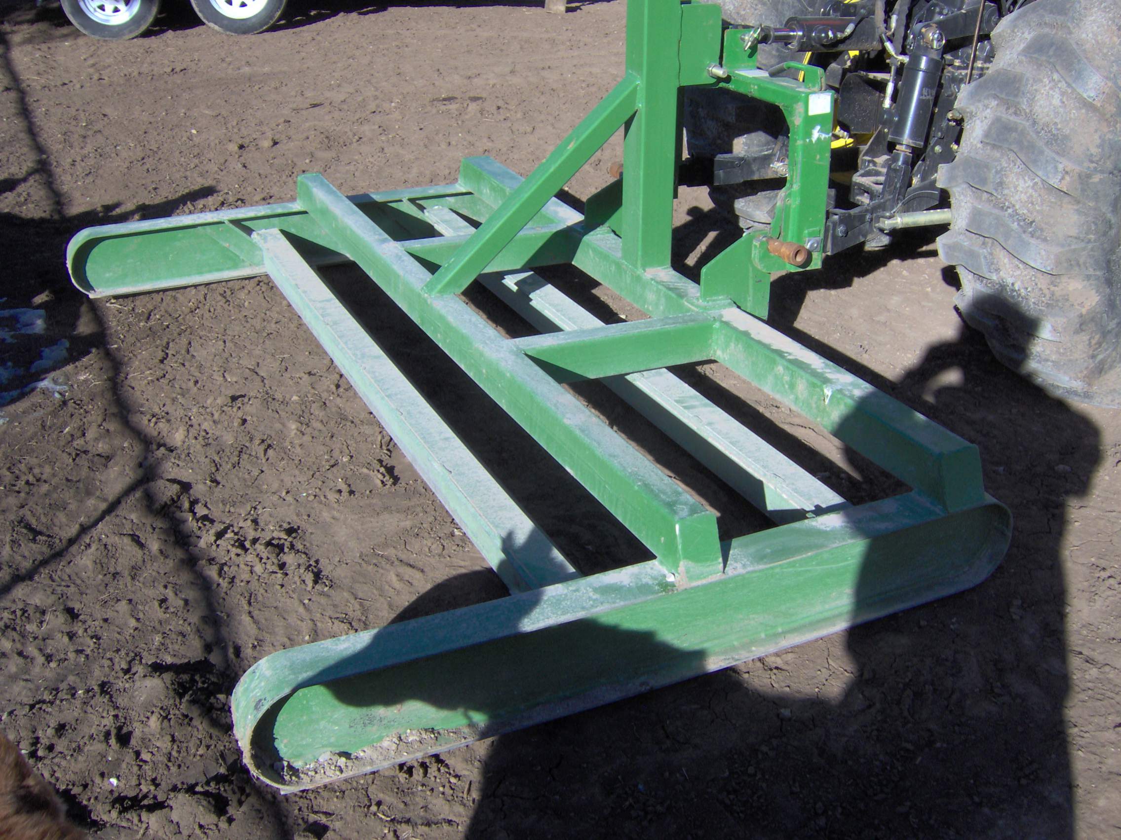

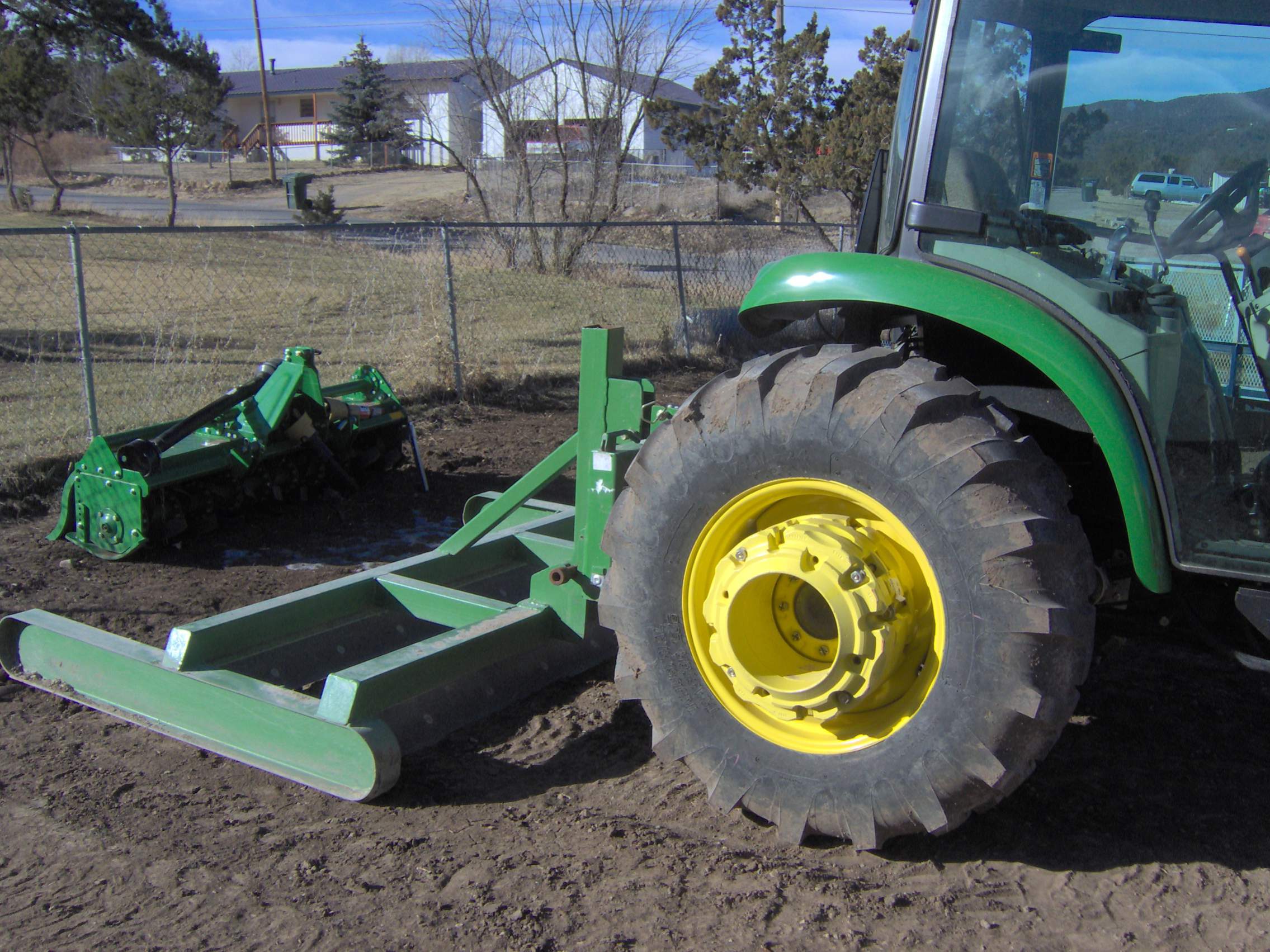

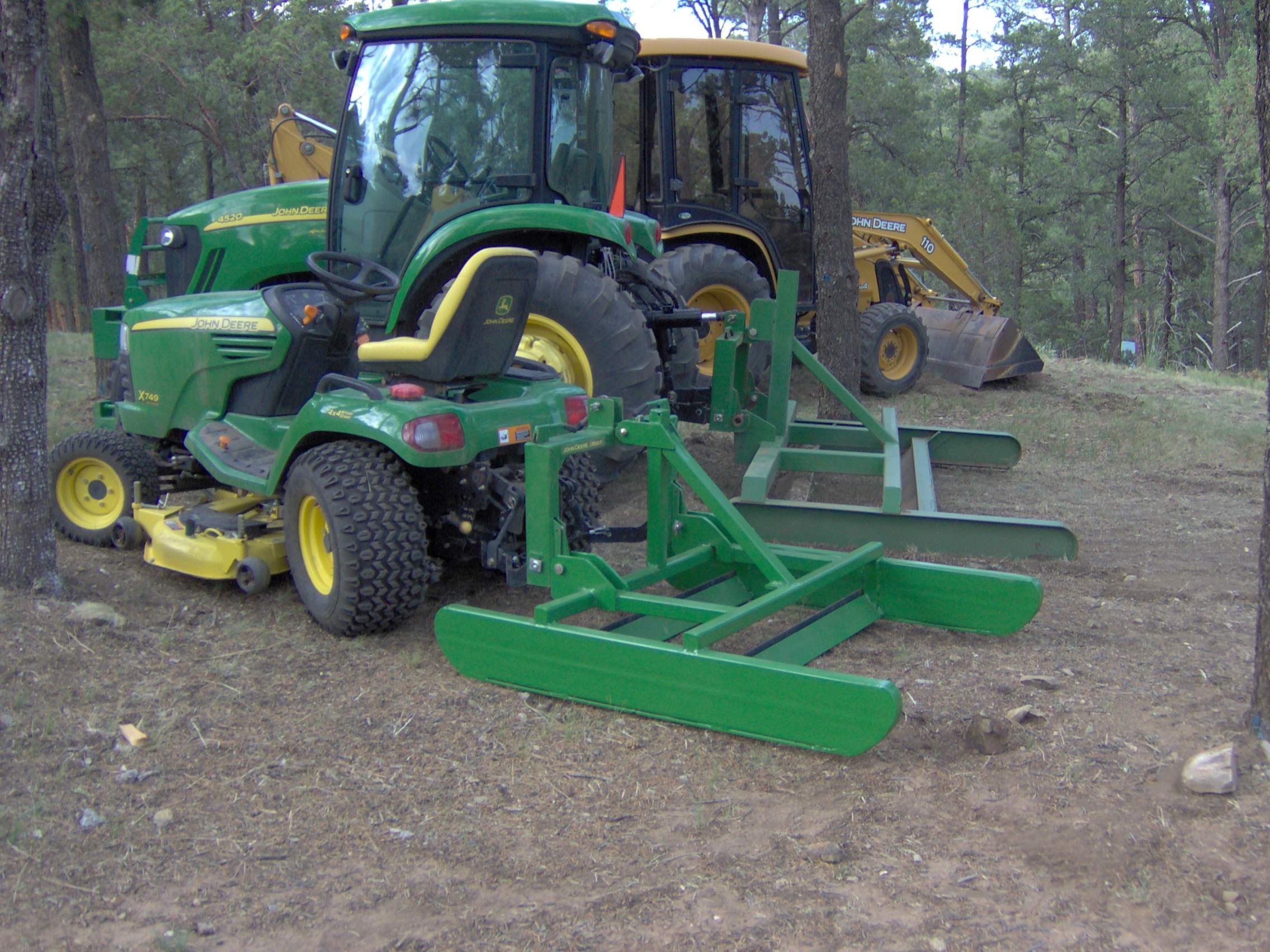

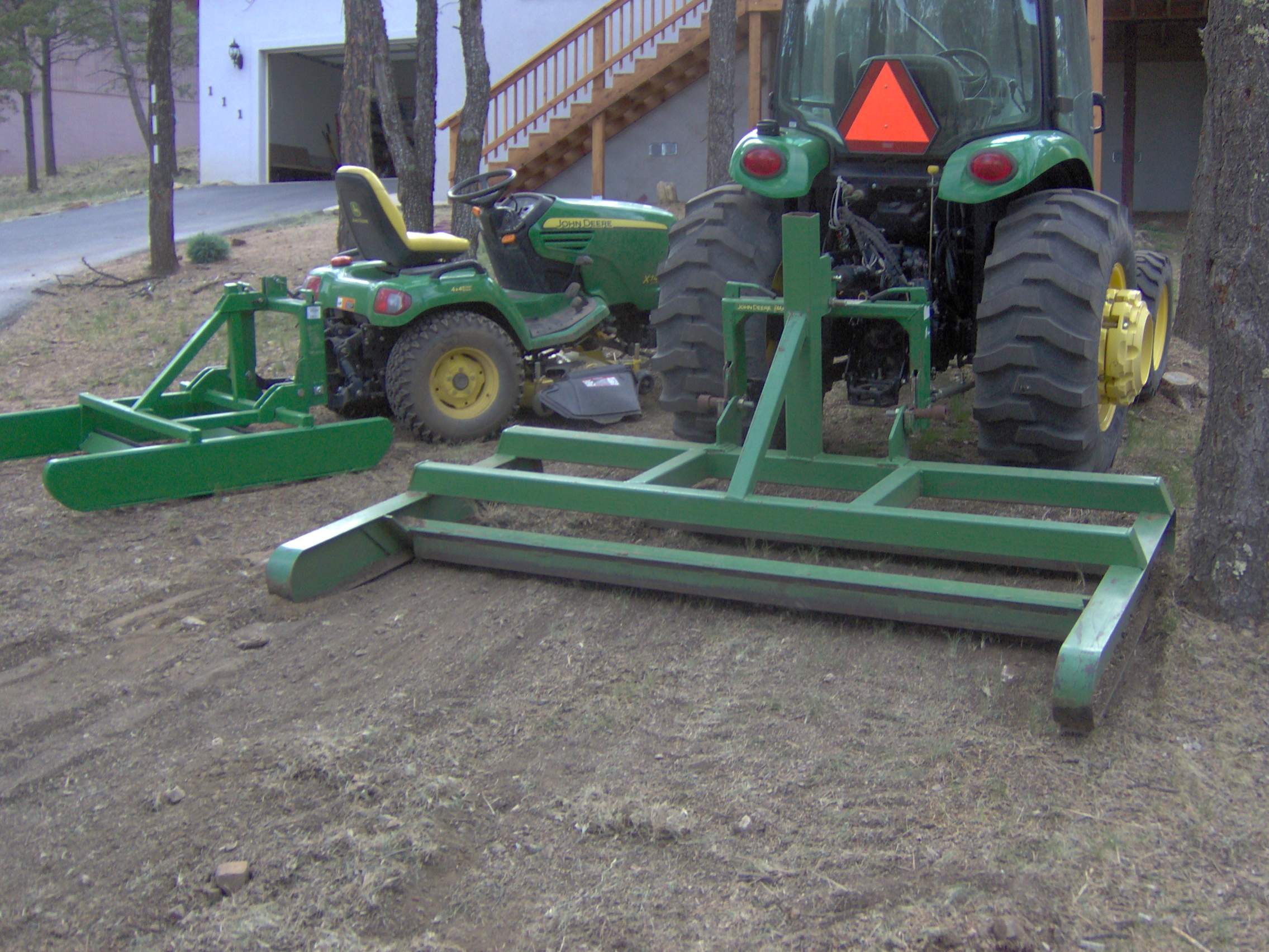

Gordon Gould is a frequent poster here and a good person to get advice from on grading too. Those are his plans for a land plane he has built and used for a few years with great success.
I have built two land planes so far, one is 4' wide for my garden tractor and is appropriate for the small compacts and the other is an 8' suitable for larger compacts and small utility tractors. On my land planes I use 6" wide x 5/8ths" reversible grader blades which are about half the cost of the build. Look for the steel drop piles at the large fabrications shops and steel yards to get a good deal on the steel. I rarely buy any steel at full price anymore but most structural steel I see is selling for fifty to sixty cents a pound. I have a steel yard that sells drops for half price and another powdercoater/fabricator selling two acres of steel for fifteen cents a pound. I am a regular customer at the powdercoater.:thumbsup::)
Here are pics of my land planes,

Mine are set straight and flush with the skids, works great smoothing out pastures with our sandy loam soil. With a straight blade set up tilting the plane forward allows for a uniform and even depth across the full width of cut, if the blades are angled then the leading edge will bite and the trailing edge is higher making an uneven cut. Might help with a crown but not what I wan't for pasture and lawn smoothing.
Not trying to tell an experienced grader operator what to do but I am sure you know the difference between having new blades on a road grader so why put old ones on a new landplane and expect good results? To my way of thinking the grader blades are the most important part of the tool.
