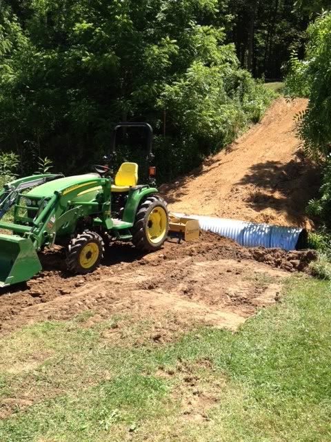

No I'm sorry it doesn't. MAybe if you are moving dry sand or another light material. Put the tines all the way down and start digging up fresh earth on flat or inclining ground and you will find yourself woefully undersized. The 1026 is much better matched with a 4' bb if you plan on moving the earth. My 3320 struggles with the tines down and a full load, so please don't tell me a machine half the size is "plenty". Others may take your recommendation and buy a 5' bb and find themselves scratching there head when it stops dead with a full load and the tines out.
Thank you Mr. Wizard. Could you post your phone number so I can get your approval on all of the attachments you believe I should be using on my tractors?
What is the picture supposed to show? Maybe if you added some weight to your tractor, you could pull something more than I do with my 1026R.
/ Box Blades #25
again, more great advice. I will add weight and put on flames so I can pull like yours. You guys must have lawns made of feathers and sawdust.
As the photo clearly shows, that is pure red clay, very hard to get out of the ground but very good for dams and bridges. Here in WV it's what we have to contend with when we move dirt. Please don't call me for approval, but I would suggest you have someone do your homework for you.
If any of you others need some more great compact tractor pulling advice contact the guy with the 1026 and the 5' box blade. The perfect set up. :laughing:
