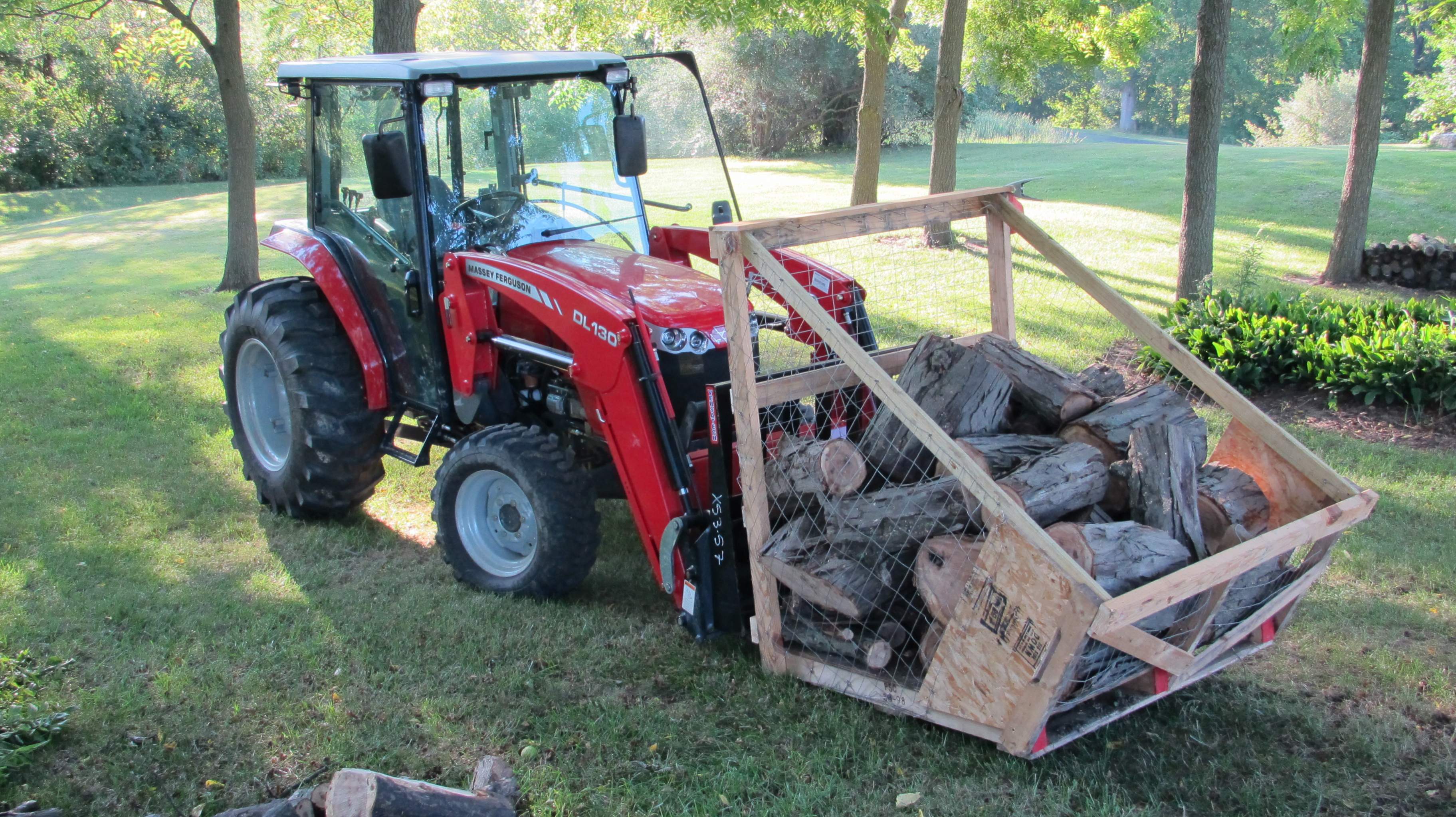

I just finished this box. It is built on a pallet. Only needed to buy some staples, had everything else on hand or it was free. Be sure you have proper ballast behind your tractor for your load, not so in this picture.
