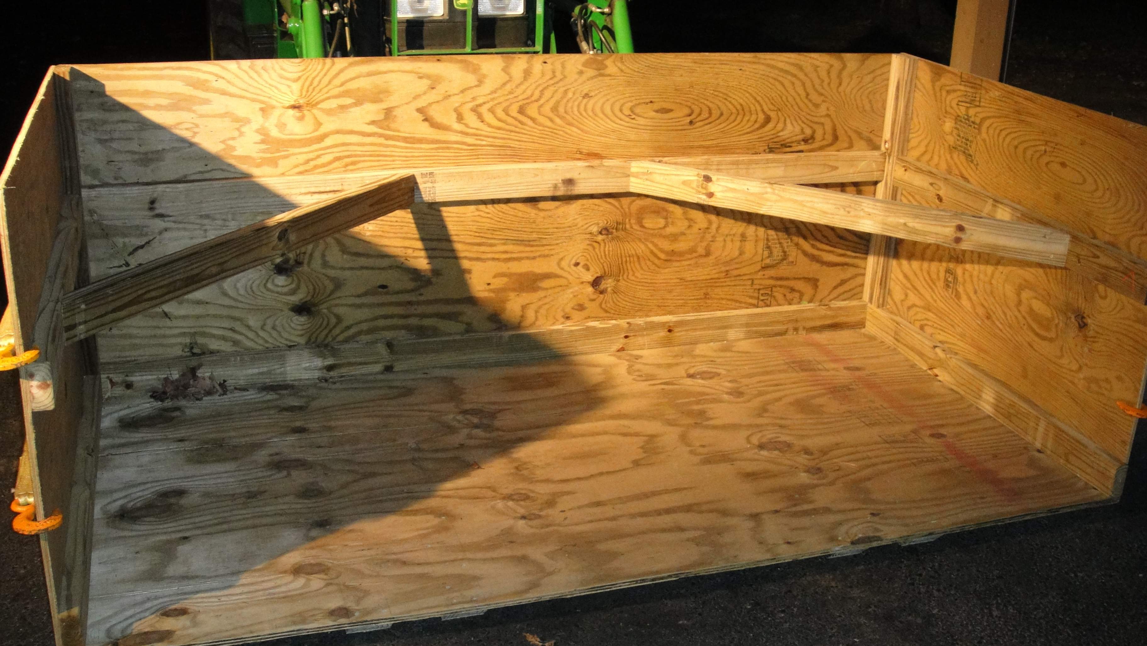

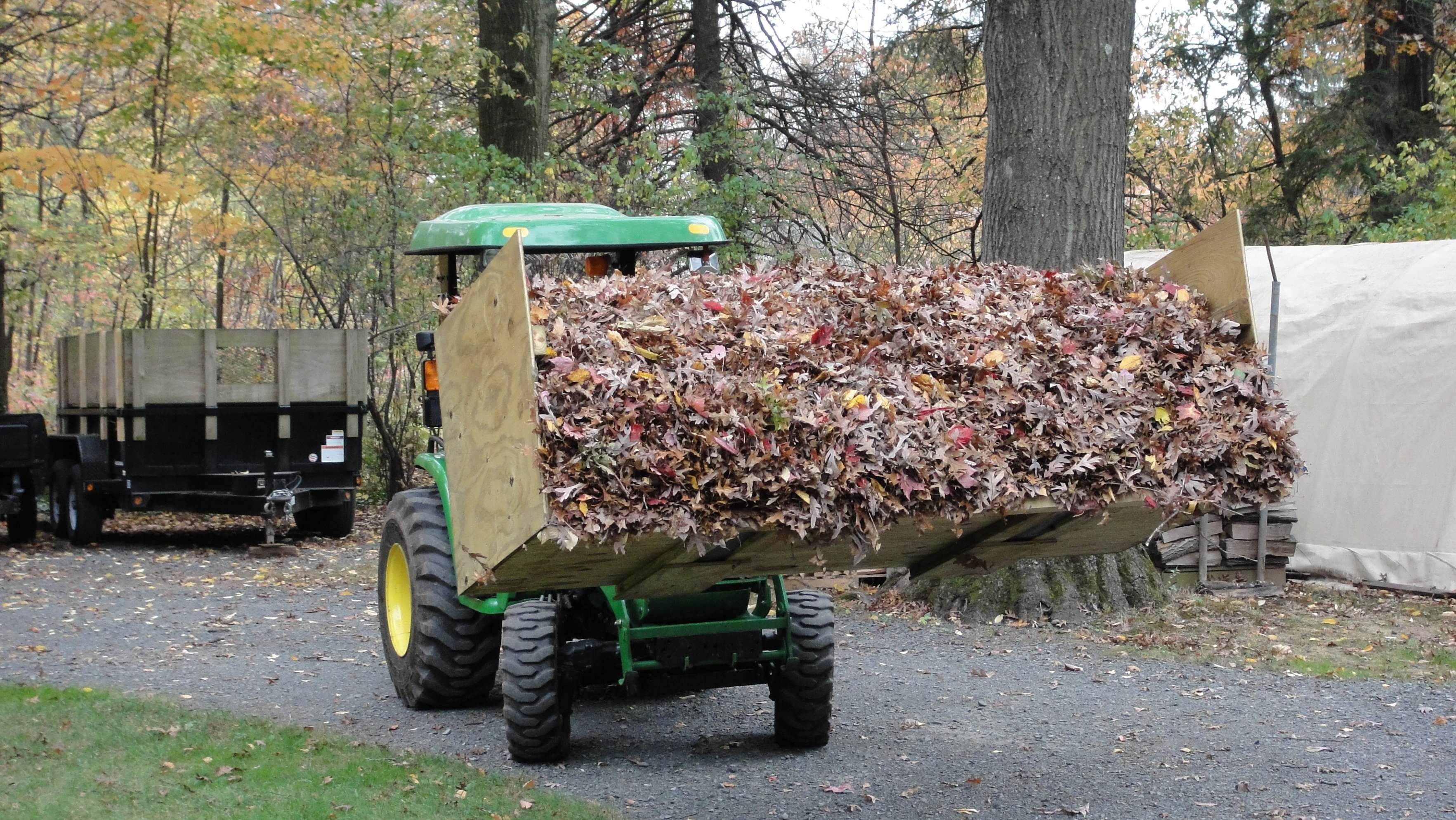

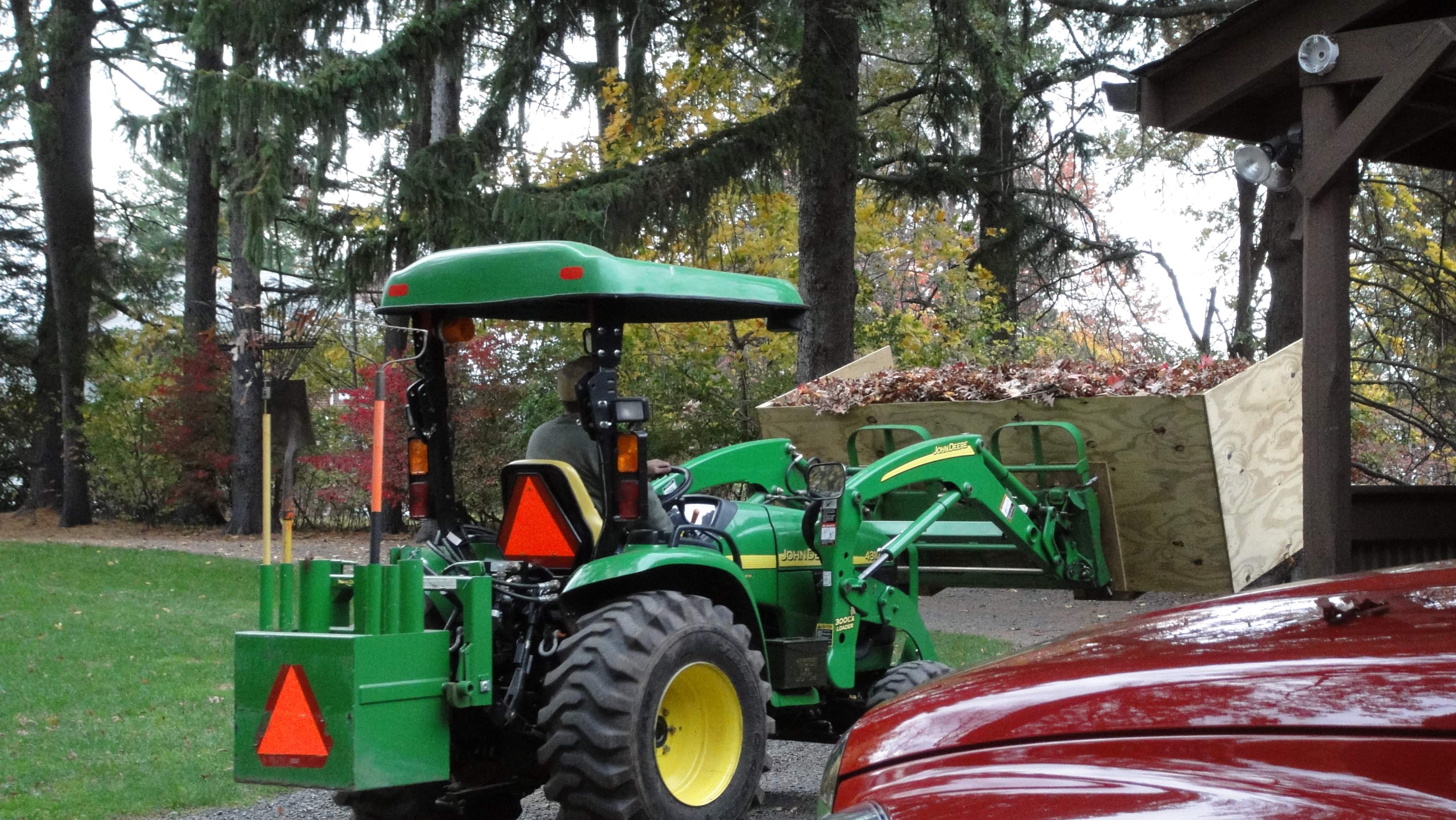

I made a box to handle my leaf collection, I just used the plywood and 2x4's on the bottom to keep it tight then a threaded rod bent into a J shape to grab the fork frame and pull the box in tight. It's basically an 8ft wide bucket now, I kept mine low by not using the pallet so I can drive it under a pile and scoop it up to make loading it easier.
Works great and saves time by eliminating handling the leaves as many times as other methods. One guy here on TBN has one similar and he added a gate on the front to hold even more debris.
JB

That's just what I was thinking about. It looks like it works great. Is that 3/4in plywood with 1/2 in on the sides and back? Good point on not using a pallet so you can get low. Am I correct in that it looks like you secured it with some type of rachet straps by the hooks on the side? Great design I think I will copy it if you don't mind. Imitation is the greatest form of flattery so consider yourself flatterd. Really nice job you did there. Thanks
/ Box on pallet forks #15
Yup, 3/4 and 1/2 PT. Having it low is more the reason I did it w/o the pallet than driving it under a pile, have to be careful doing that.
I tried it with the straps at first but it was not as secure as I wanted, so I used long bolts attached to the fork frame, 2 on each side, one is bet like a j-hook to catch part of the frame and 1 is thru bolted to a flat spot on the fork frame. Now it's as tight as a skeeter's tweeter. Very stable for dumping or using as a man lift.
Nice tool holder on that ballast box, too, JB4310!
