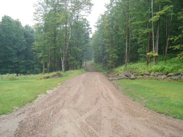

I just got a woods GB72 box scraper and I had a blast yesterday redoing my gravel road. I had a lot of good material to work with - several years of bringing in one or two loads here and there over the last several years. I was keeping things level with a JD1010 dozer which worked OK but took quite some time to do. The box scraper laid the crusher run out like a carpet.

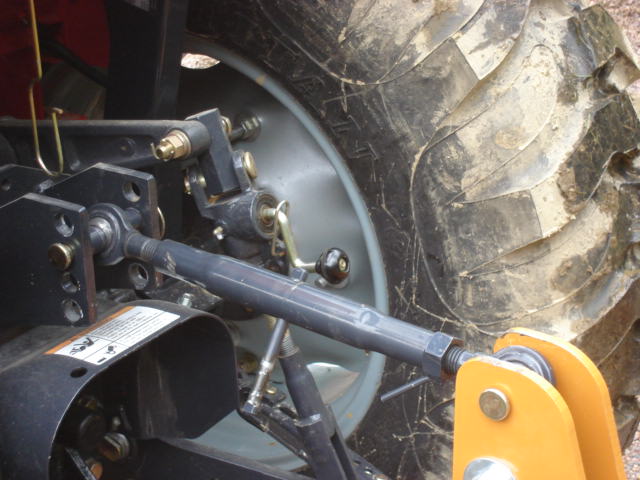

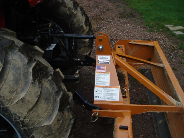

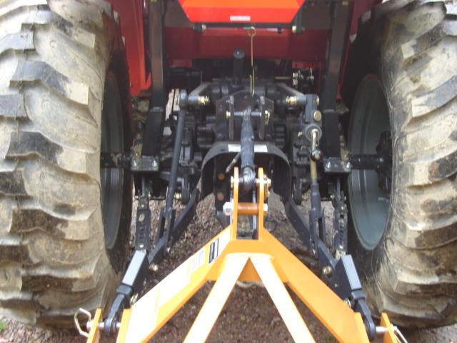

Now here is my situation: The scraper worked great on my road but I tried to use it on a section of land that I am looking to level and it did not dig in as much as I thought it should. It looked as the shanks were barely penetrating the ground and the box was not being pulled down towards the ground. I have shortened the top link as much as possible and set the shanks in the lowest setting. The box still seems to be riding over the ground and not ripping it up. What would the max depth of the shanks be if the 3pth settings were ideal?? I know I may have to add weight but I think the shanks should penetrate deeper than they are.

I was told to adjust the top link so the bottom edge of the scraper sides are parallel with the ground. It apears in the photo that your front edge is so high that the back "blade" holds the shanks off the ground-that is a strange condition if your top link is shortened. It seems you need a shorter link to make it level.

IMO, it looks like you could stand a shorter top link so that the front of your boxblade is dipped down more. That will keep the back blade from touching the ground and only your scarifiers touch ... leading to more pressure on them alone, and not the back of the box.
See how my box is tilted forward, with the rear blades off the ground?
If your top link is at it's shortest already, try using the top hole on your 3pt connection if that helps shorten the distance between the 3pt and the box blade. It might be just enough to tip it a little more maybe?
Another thing on really hard ground is to take every other scarifier out so only 2 or 3 are in the box blade. Again, the idea is to have whatever weight there is on only those 2 or 3 points. It might dig in better then. The other thing is to add as much weight as you can to the box, like has been suggested.

You need a shorter toplink. From looking at the pictures with the toplink fully retracted the rippers and the cutting blade both touching the ground equally. Ideally the cutting blade should be off of the ground letting the rippers penetrate the ground. (as seen in 3RRL's picture) If you have a lot of work to do a hydraulic top link will help a lot. I have found that a small adjustment makes a big difference in how well the BB will work.

Another suggestion is to add Pat's EZ change system. That would push the box back about 3" or 4". Then it would tilt forward more. Much easier on and off for all you other implements too. They are well worth it.

Looking at the OP's photo, I definitely would agree that the issue is with the top link not getting short enough to effectively tilt the box forward enough.

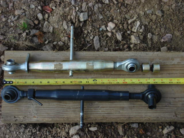

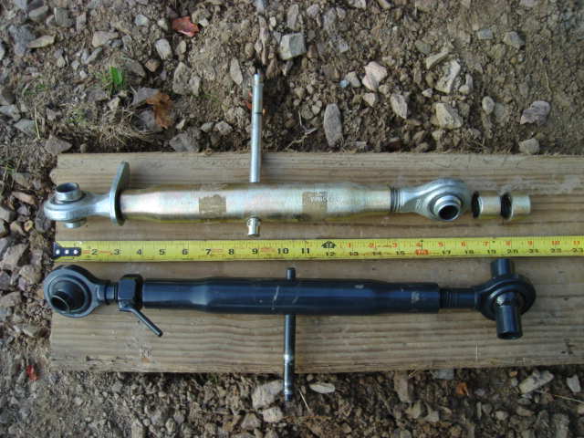

I found a slightly shorter top link, which I was able to make even shorter. The one I modified is now about 2 1/2 inches shorter than the original and it makes a huge difference! I am able to tilt the box forward (like yours 3rrl) and it grips and rips. Does a nice job.
I am also going to add more weight as suggested and eventually the Pat's EZ change system to cut down on the 3pt hitch up aggravation::D

I agree with the shorter top link for your tractor. This is a common problem with some 3 pt. attachments when using compact tractors with their shorter lower arms. I had the same problem with my JD 790 and solved it by making a set of hook attachments like Pat Greenwell sells. Beside solving the short arm problem, it is so much handier for everything else and you don't have to worry about shortening PTO shafts to keep from bottoming out the side and tearing up the u-joints. Don't make your own unless you really enjoy this kind of project or you're hard-headed like I am, buy them from Pat cheaper and they have a better warrenty than the stuff I make, which is none.
