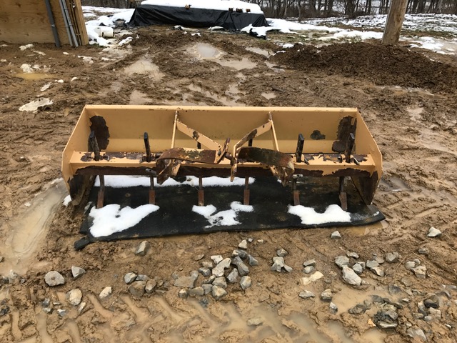

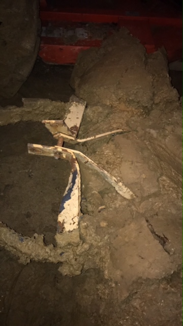

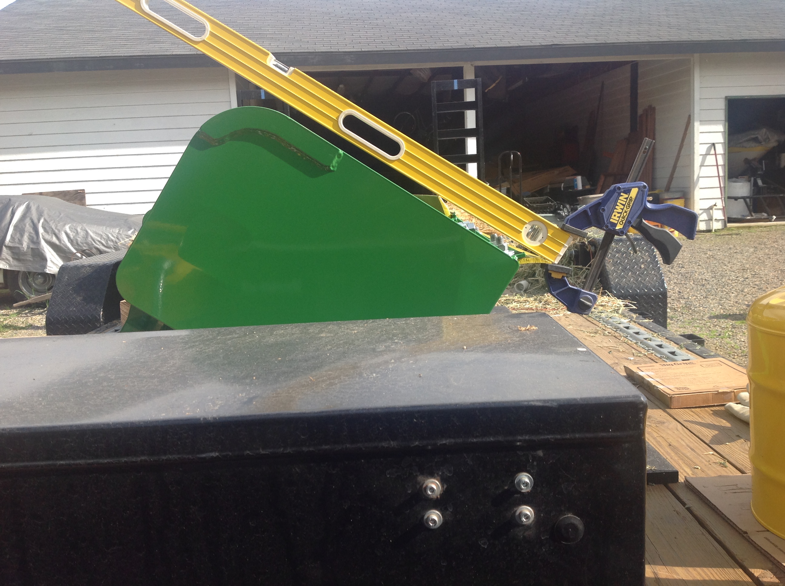

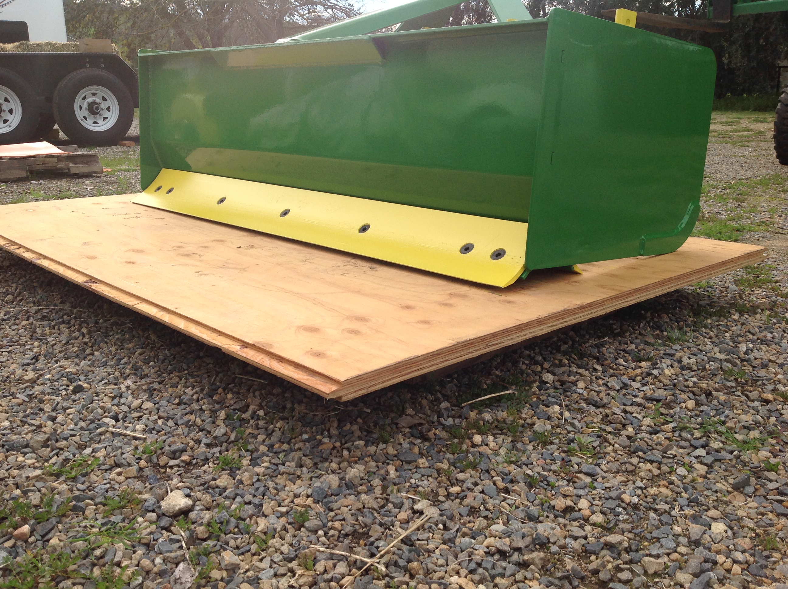

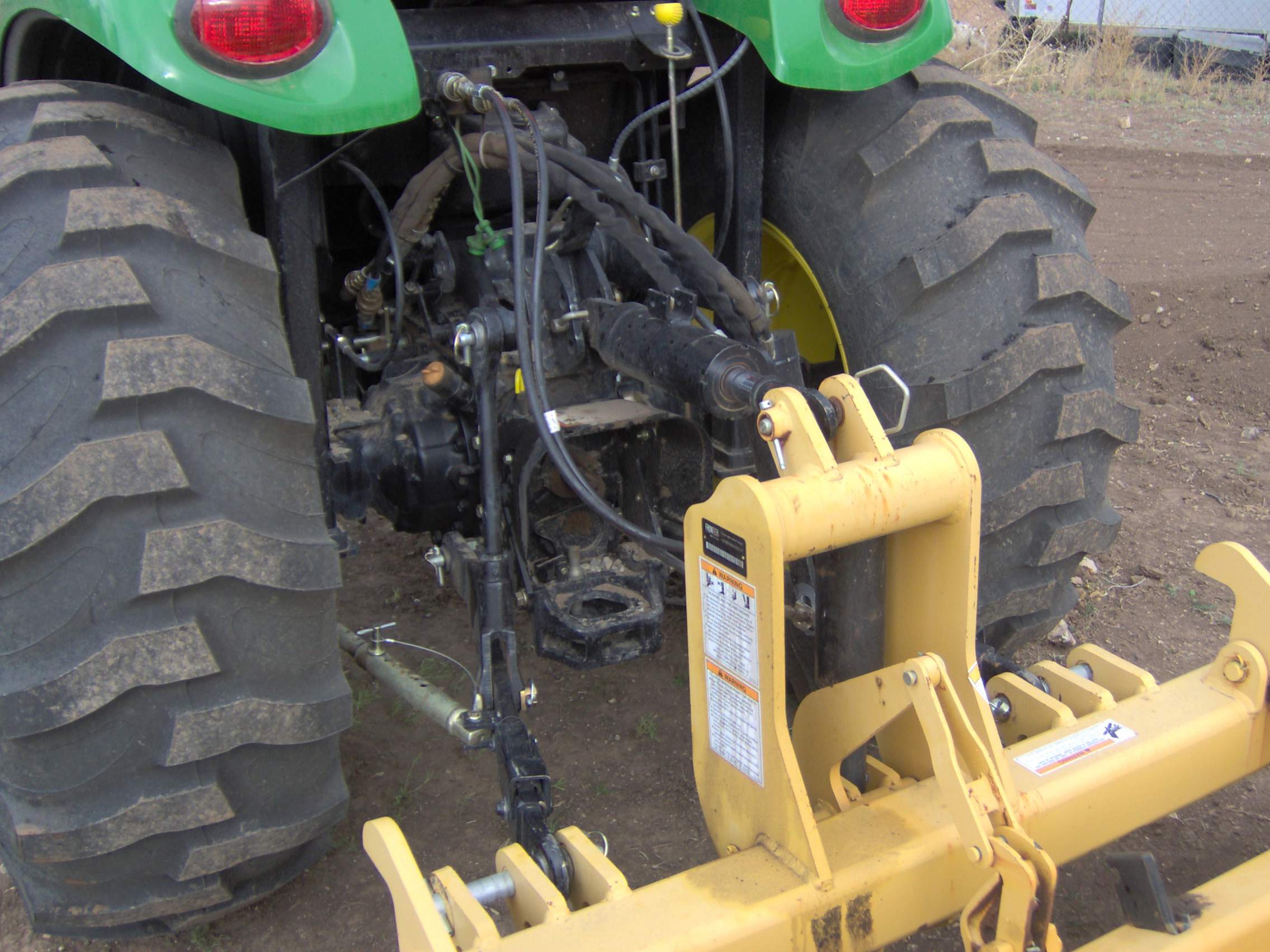

This is a great thread as I am currently kicking around getting a new box blade. Let me start with some pictures that may help others. I have a New Holland Workmaster 55 (55 HP engine, ~45 PTO) that is about 7' wide on the back tires. I have a King Kutter 72" standard duty blade I purchased used about 5-6 years ago for use on my last tractor which was 39 HP with a cat 1 hitch. It was fine on the smaller tractor, although the smaller tractor didn't have enough weight when the blade really dug in. It has been great on my WM tractor for grading a mile of gravel road 2-3 times a year, now maintaining my 1100' driveway, and general purpose grading. However, here's where the problem comes in.
The first time I was pushing snow backwards backed close to the edge of a small ditch where the bottom of the blade caught. It severely bent/snapped the metal going to the hitch pin. I had it rewelded and things were fine. Now in the past couple weeks I was doing some extensive grading trying to make a slope to allow water to drain away from our home site (we had a modular home set right before winter started in). The blade was holding up well until I forgot to raise it once when I went to back up, and crunch the hitch was destroyed again, worse this time due to the weight of the mud that was in the blade. The side that was welded actually stood up better. I was tired, it was dark, and I was in a hurry, and the mistake was my fault for forgetting to lift the lift arms before letting off the clutch. Here are a couple pictures of the blade, before and after I had to clean all the mud out of it:
So, that's what happens if you have a blade that isn't sturdy enough if you are pushing backwards. Granted, I've been warned you can break more than the implement backing into things like that. So I was probably lucky.
Pulling forward the KK has always been fine. One of the sacrificers is slightly bent at an angle I believe after hitting a rock when having them down about 3 notches a long while ago and digging in hard to grade an area in our horse pasture. Other than that, I have had the sacrificers down 2 notches regrading a mile of gravel road with no other issues with the blade.

Because of my debacle with the KK blade, I am looking to get something with a clevis style hitch, preferably cat 1/2. I'm not sure about the Land Pride, since I'm unfamiliar with the brand the BB35 series I believe is new, so I haven't seen one. The Woods looks attractive as the upper part of the hitch looks sturdy and is bolted on, so it could be more easily replaced if damaged. The only thing I am hesitant on the woods is how the sacrificers are behind the frame instead of through it like most of the blades are built. I'm not sure why they chose that design. The Kodiak seems too lightweight for me, but I did get quoted a great price on it from one local dealer.
Decisions decisions... I primarily wanted to post just to share my experience with the KK blade. I paid $400 for it used and it has stood up well pulling but never pushing. I've always avoided pushing backwards with it intentionally unless I was pushing something extremely loose.

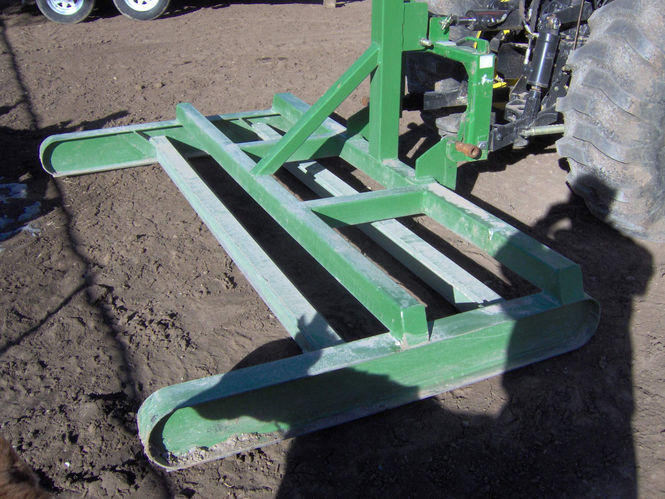

Is that second picture showing the frame detached from the box, or is the box completely submerged in mud?
   / Box Scraper / BoxBlade Choices? #47
The box is completely covered in mud. The bottom right pin where the arm connects bent to the right, and the bottom left pin where the arm connects bent to the left to the point of breaking. The a-frame above is mangled.
The mud froze in it the next day as the temps dropped again, so I had to chisel the mud off to see what I had. I had to wait for the temps to rise, use a post hole digger to make a hole down to the frame, get a chain around the frame, lift it with my FEL, and then hose it (not spray it) until the mud became saturated enough to slosh off the box. I then brought it closer to the house, pressure washed it, and sat it on a rubber mat until I have time to take it to a shop. It was a real pain. I was moving some serious weight with it at the time, and it was doing fine until I reversed with it down.

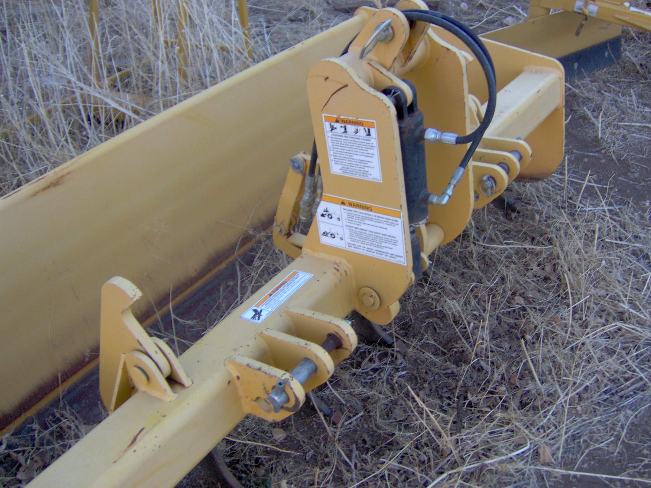

Well we all make mistakes if we are doing anything. That said I would suggest taking smaller bites no matter which direction of travel. Work your way up and down the ditch from end to end and then repeat in successive passes.

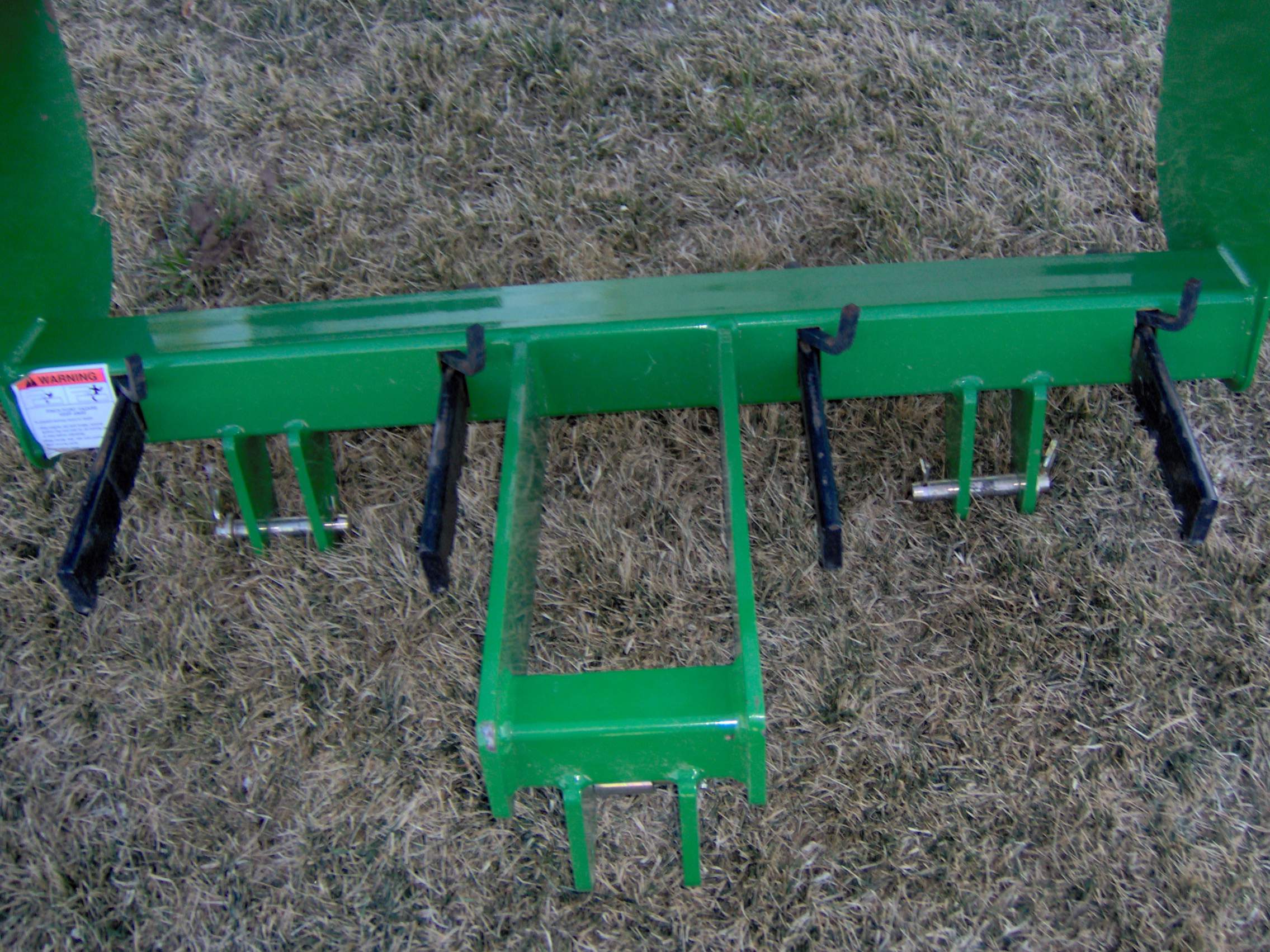

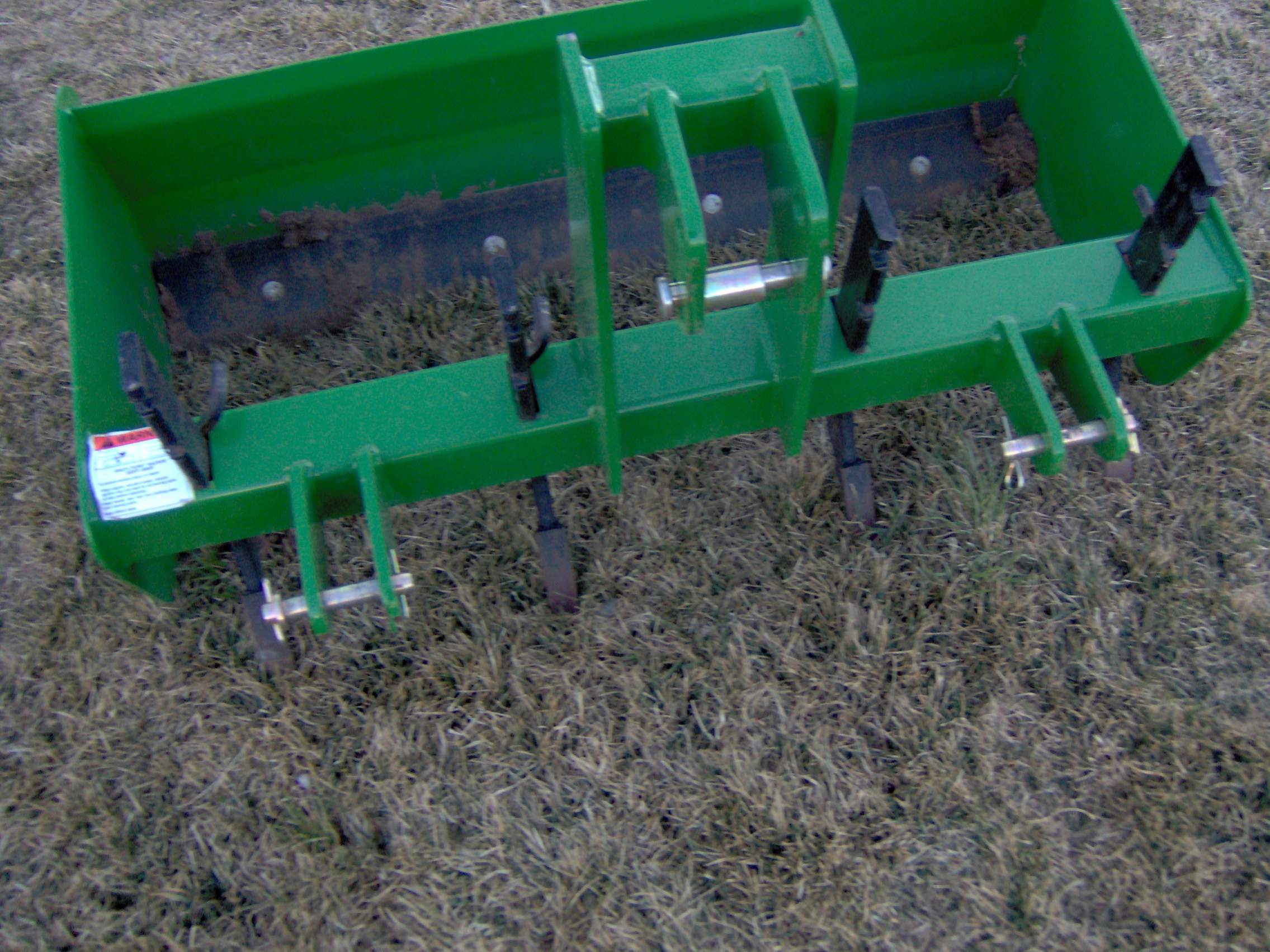

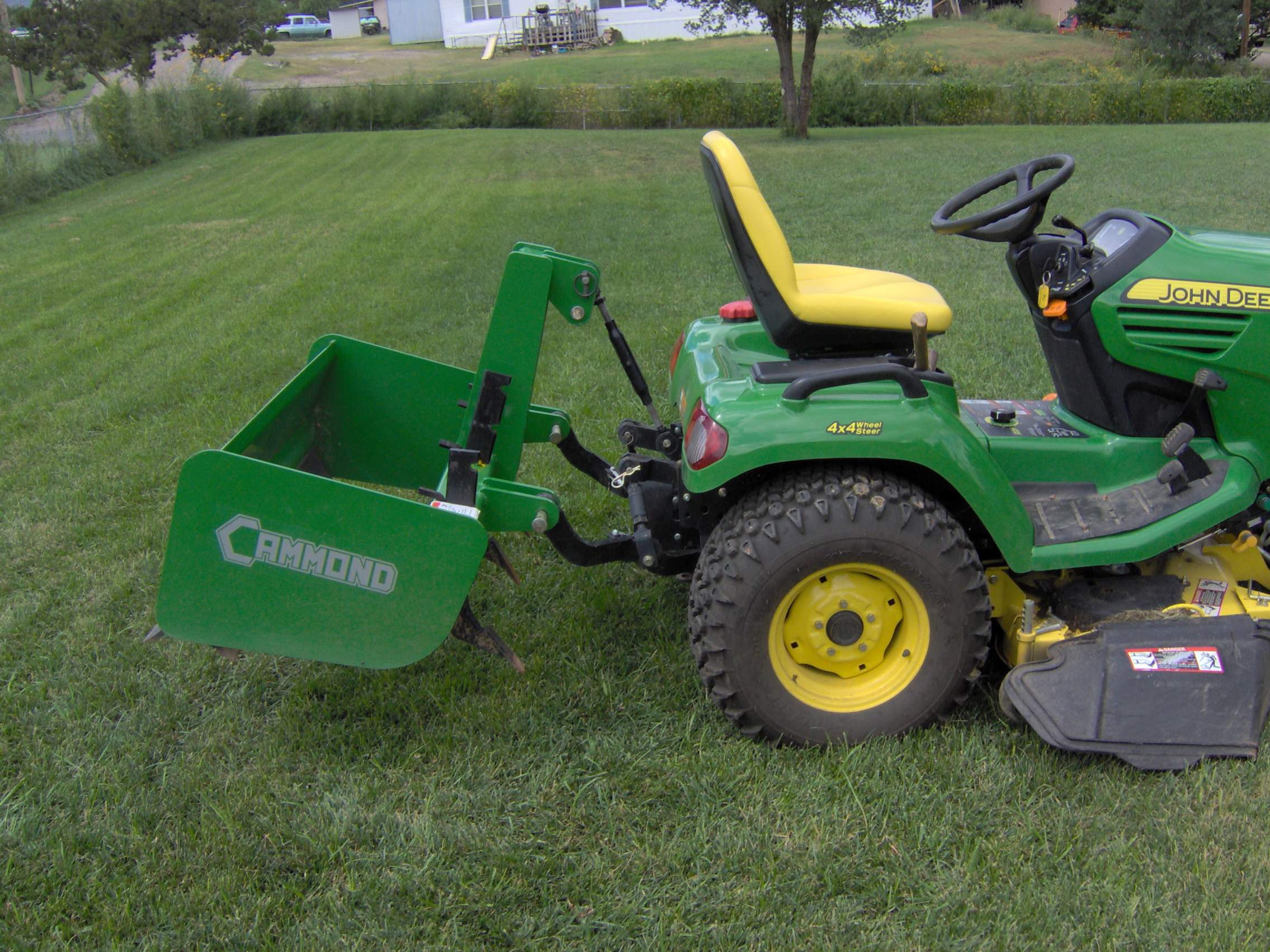

About the box blade hitch, half the metal bracing is to support the hitch from moving left or right. Since the top link can move freely from left to right that is not effective use of the iron. You need more support perpendicular to the blade, the two rear supports are doing 90% of the work. Not a good design imo.
Gannon and Cammond both use a center mast that is securely fastened to the main cross beam and will transfer the loading of the ripper shanks to the top link. On this box blade you will still need to brace the rear mold board. Most of the implements I have built use a front column that is heavy duty and provide good support to counter the rotation forces about the main cross beam.

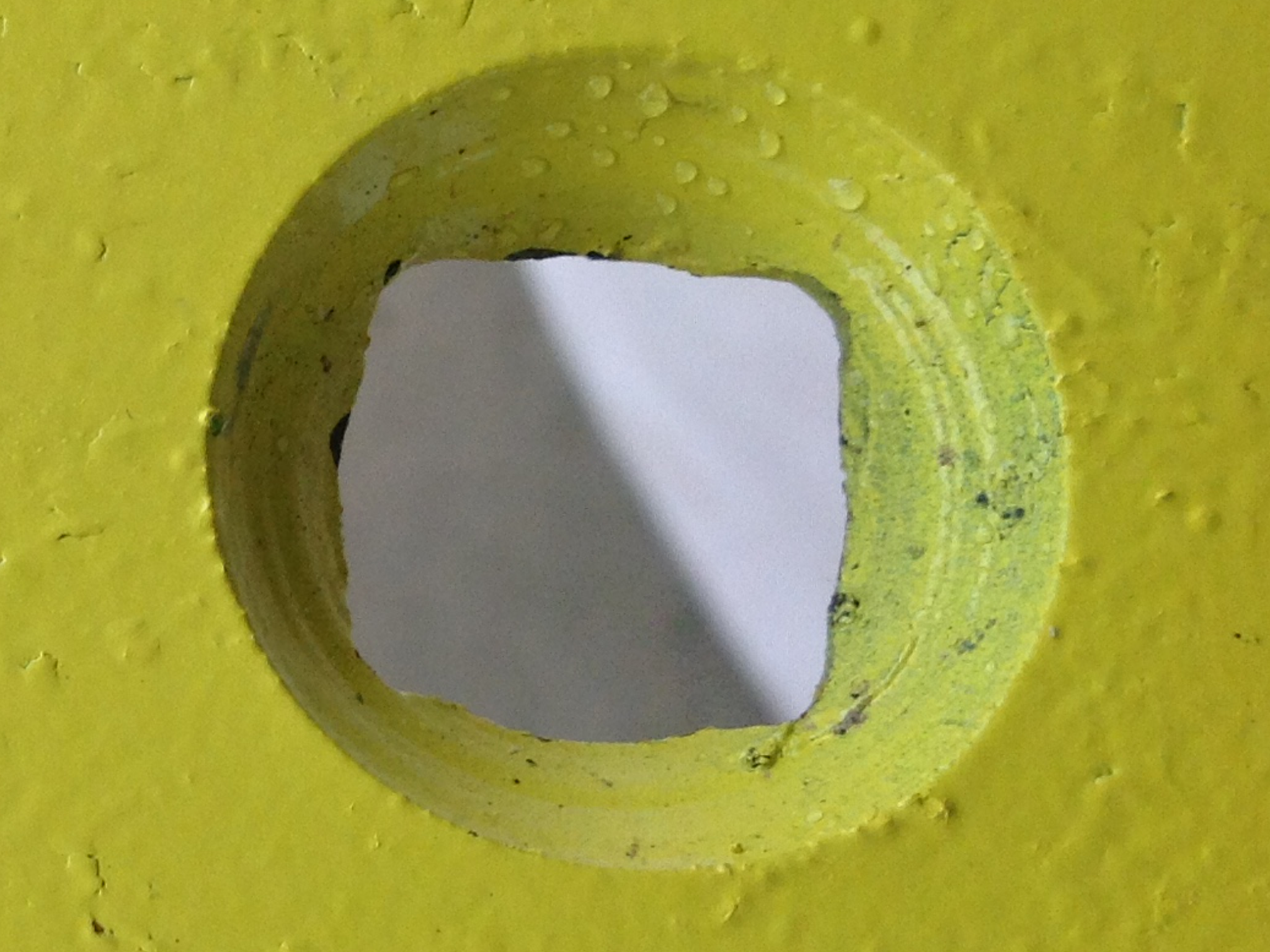

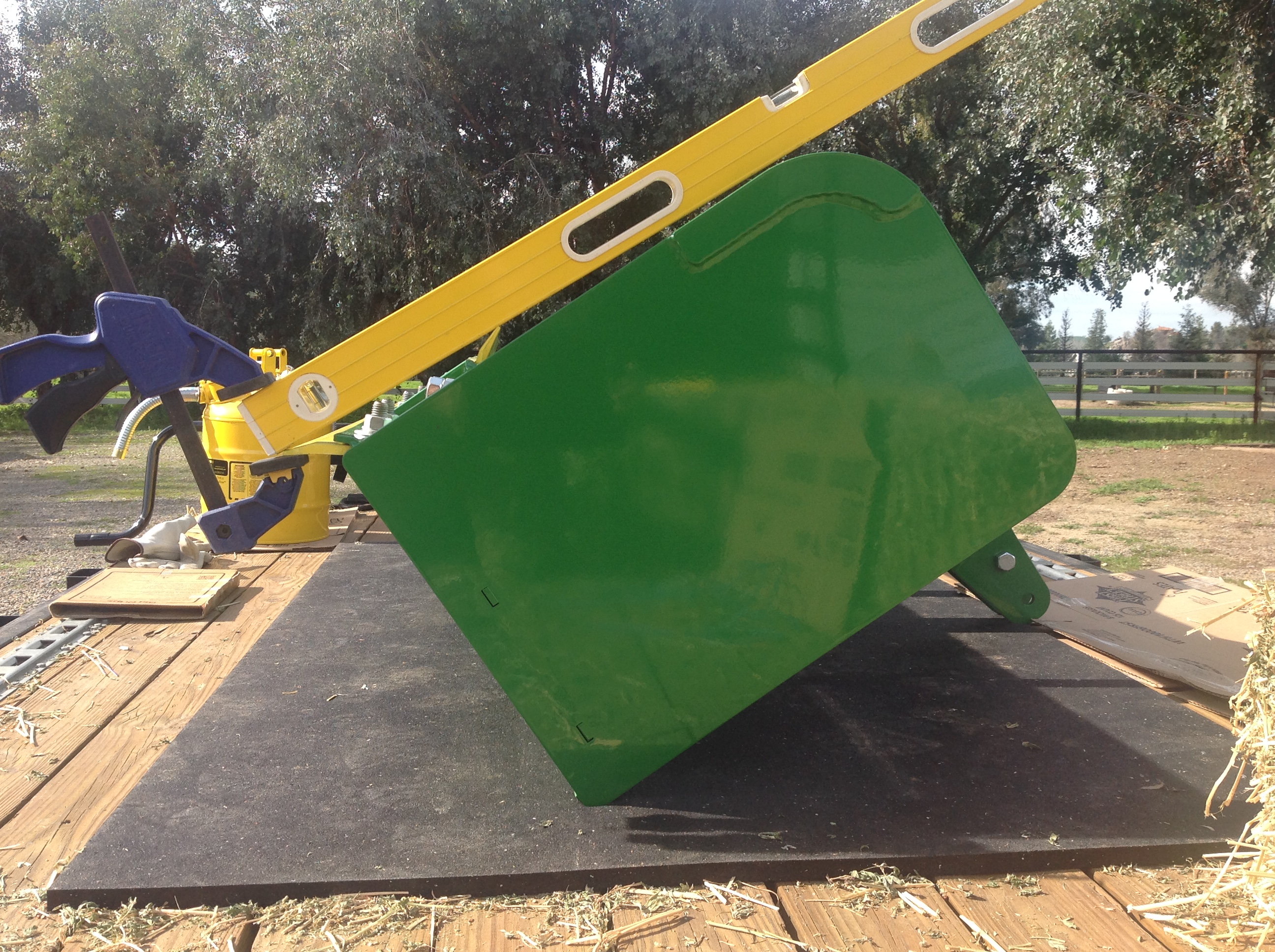

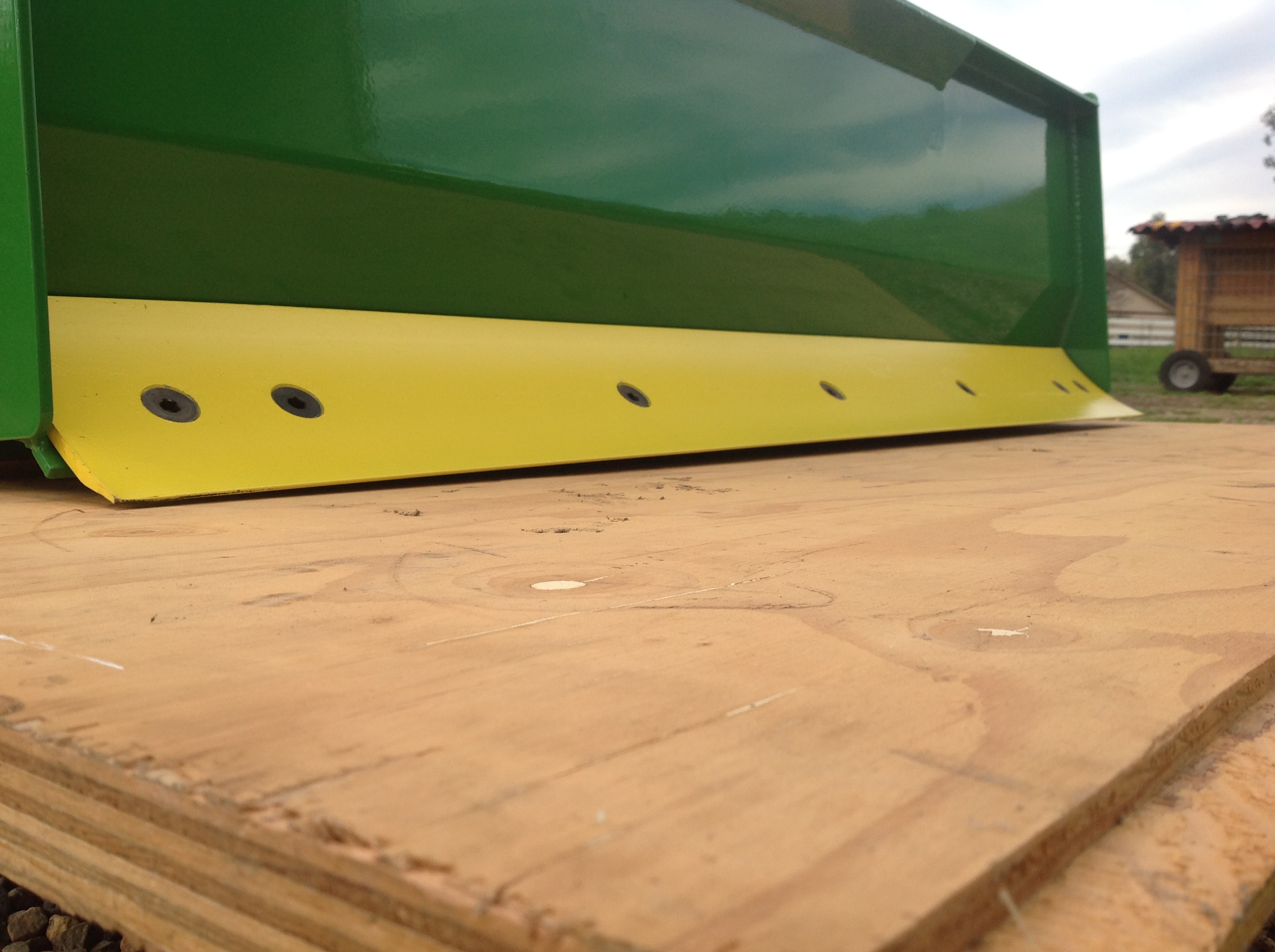

I just purchased a Everything Attachment 60" box blade and I personally would not recommend buying this brand, when comparing implement you need to look past the specifications and extra features that they are adding to their implements and factor in the experience behind a company building them. Known brands who have been in business for decades have a ton of engineering experience and patents and testing behind their products, so just don't compare specifications, factor in the support and experience behind the known quality brands like Woods and other well know companies.
The Everything Attachment 60" box blade I purchased was welded so crooked and warped and the blades plow bolts holes were so over drilled that the square shoulders of the plow bolts extended past the back of the blades into the back plates. The blades are not even parallel to one another, when the front blade sits semi flat on the ground the back blade is on an angle to the dirt,and Vice versa. All the extra reinforcing they do to the (v) where the blades mount is overkill and warps the heck out of the (v) resulting in curved blades that are not flat to the ground. I was thinking I could shim the blades to make them straight but after mounting them and setting the box scraper on a flat piece of plywood it appears that will not fix the problem.
I recently went to the World AG Expo and looked at many well known brands of box scraper and they were all straight and parallel. If I could do it over again I would gladly of spent an extra $300 or $400 and bought a Woods and have an implement that would be functional as it was intended.
