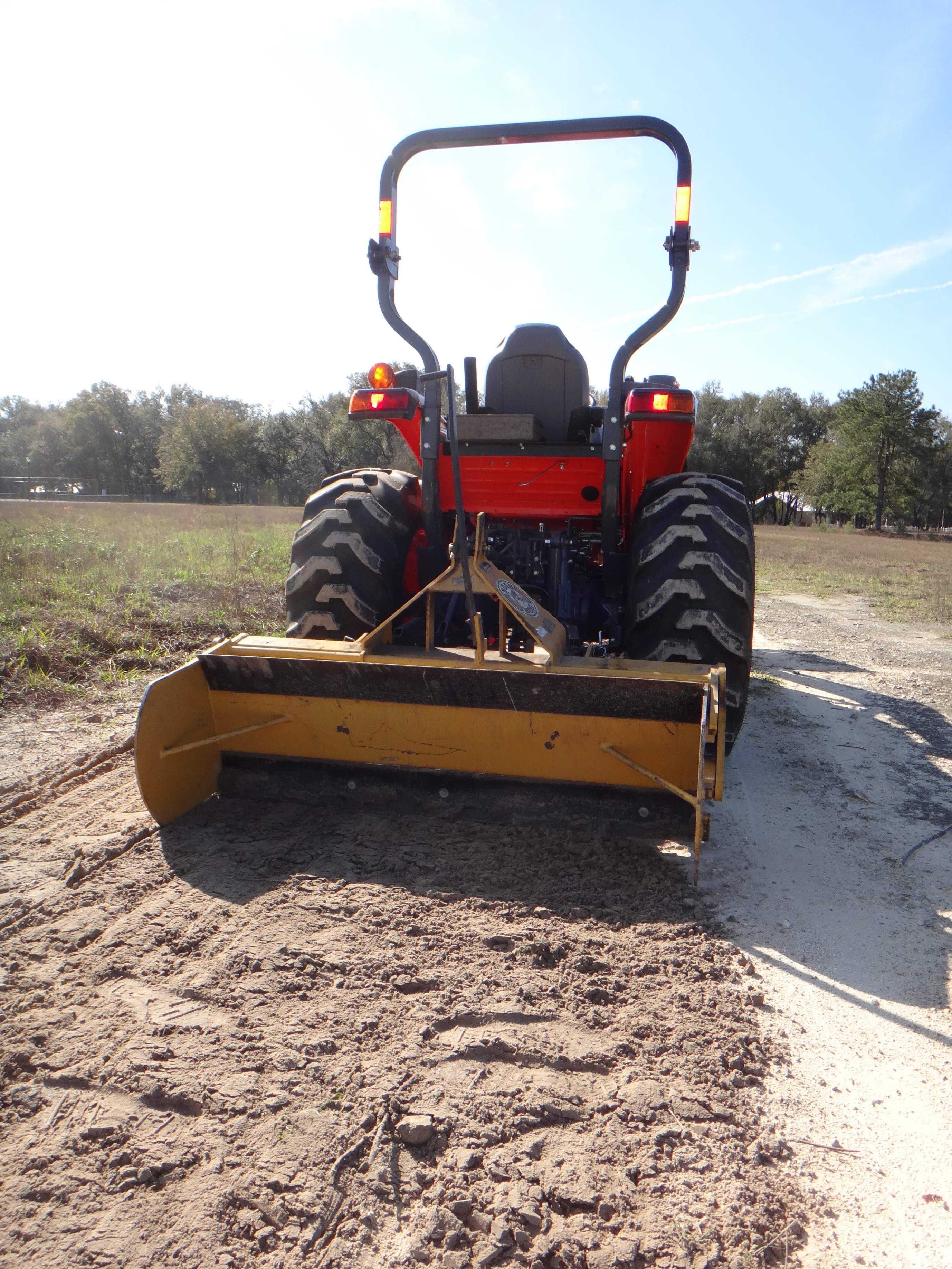

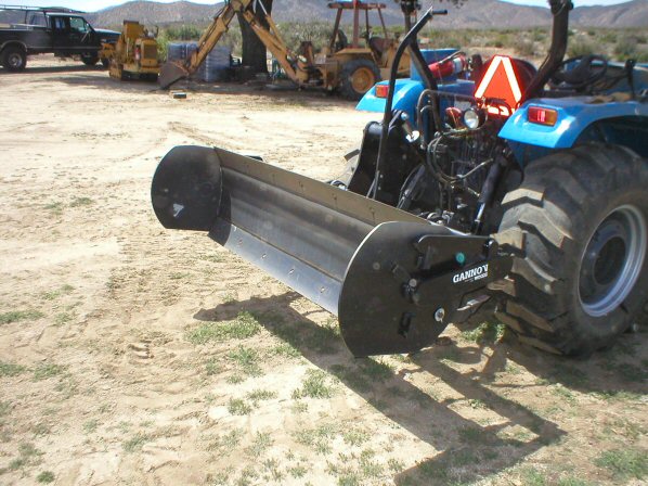

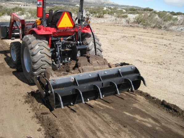

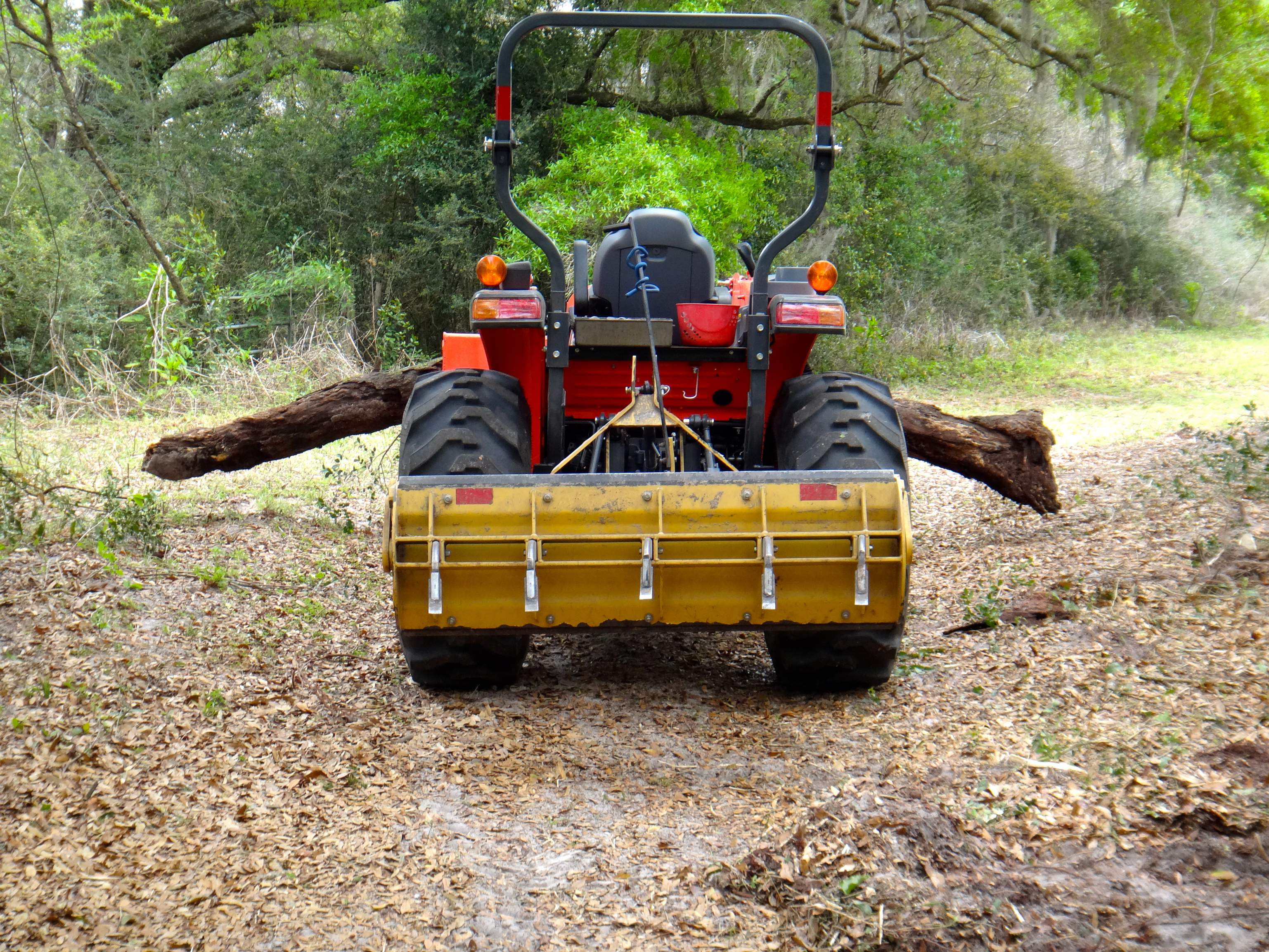

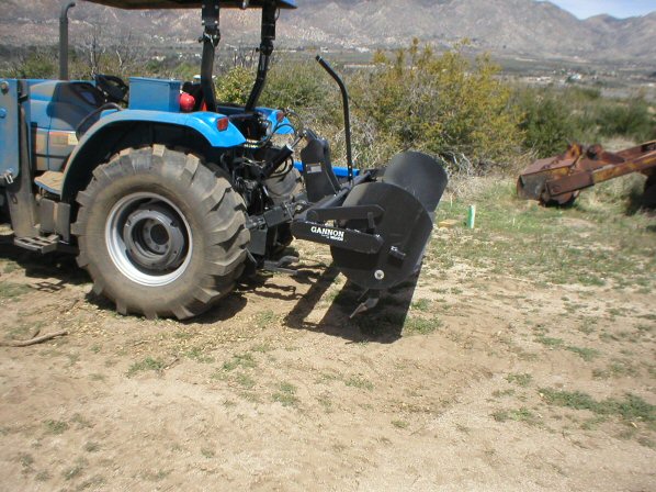

/ Box Scraper #5
My recommendation would be to get a ROBB. (roll over box blade)No hydraulics needed, heavy and hold up well. There are a couple of other manufacturers as well, none currently quite as good as Eagleline though.
Mine are Gannon, but are no longer made. :( I have a 65" @ 800lbs and an 81" @ 980lbs.
If you get a std type box blade, plan on getting a hydraulic top link at a minimum.
Good luck with your search and final decision. ;)

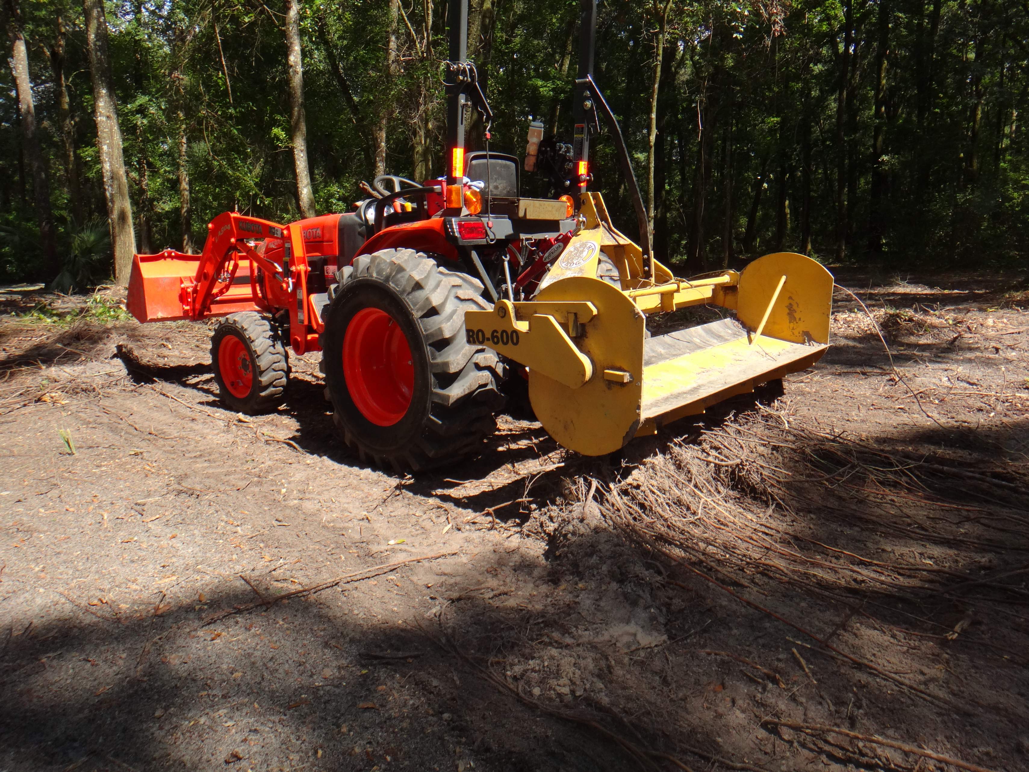

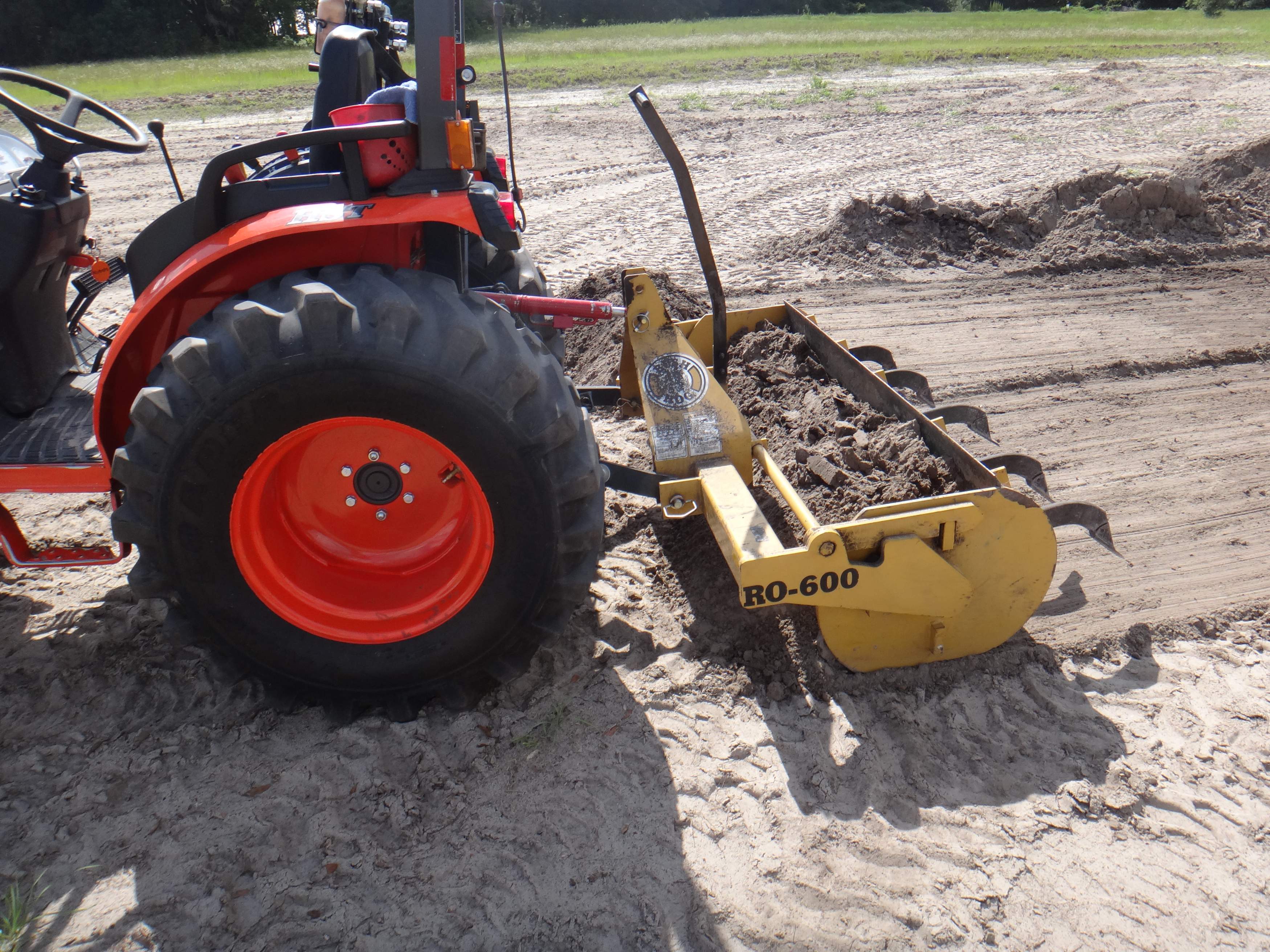

100 pounds per foot MINIMUM. Working in clay, you will be happier with 125 pounds per foot. Consider a Rollover Box Blade as well as standard Box Blades. Consider your potential Box Blade not just as a dirt mover but also as rear counterbalance/ballast for the FEL.
Also, consider a Land Plane Grading Scraper (LPGS) for gravel driveway work. LPGS will "bring up" existing gravel, which a Box Blade will not do.
If you do not have a hydraulic Top Link, consider a 'Hyraulink' Top Link which makes operating a Box Blade easier.
HYDRAULINK: HydrauLink Category 1 Cylinder - For 45 HP Tractors or Less, Model# HL-11 - YouTube
rollover box blade versus conventional box blades - Google Search
Any Land Pride dealer can order a heavier Land Pride Box Blade for you.
PHOTOS: 60"/630 pound, Bush Hog (brand) Rollover Box Blade

32HP, HST and weighs 5000lbs. ALL tires are loaded on both of the pictured tractors. 75HP tractor weighs 12,000lbs.
Keep in mind, the heavier box blades cost some $$$. Anywhere from $1500-$4000. The ROBB that I have recommended should be around $2000.

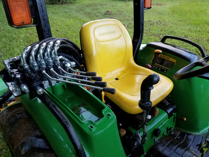

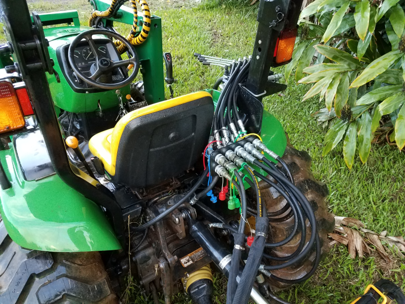

Pictures are of a 5 valve set I did for a 4400.

I'm seeing all these pics of loaded box scrapers and it has me again wondering how anyone gets anything done without a hydraulic top link! I shorten the top link to cut high spots and then extend the top link to deposit the loaded box evenly and smoothly in low spots.
I learned with hydraulics so I assume I'm spoiled. Lots of better men than I!

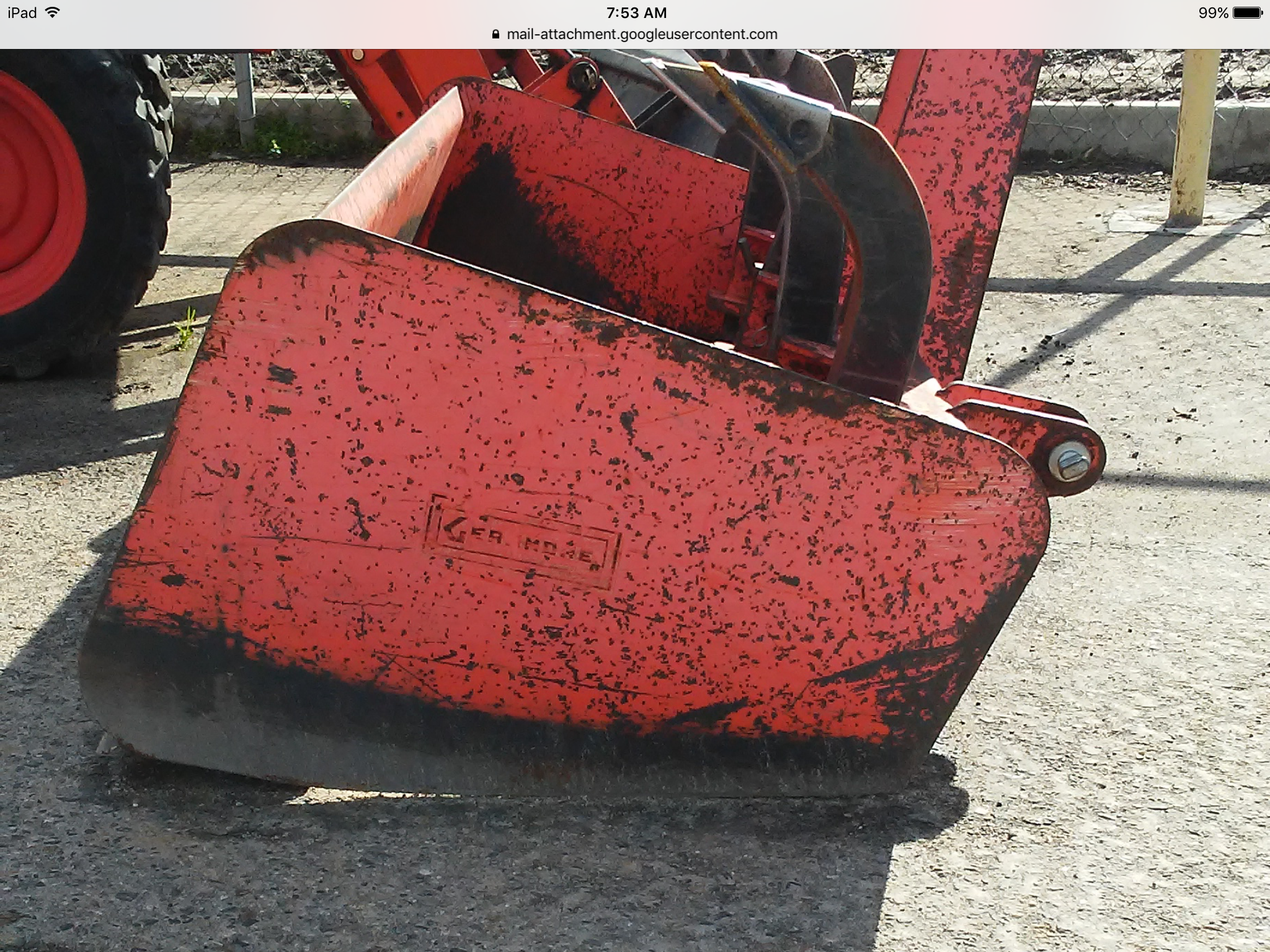

/ Box Scraper #18
I just bought a Box Blade and have no experiance using it yet, and when I was at a rental yard I noticed how warn down this one was. So when does a box blade become unusable, and if they get ground down this much why don't they have replaceable edges or hard facing on the bottoms.

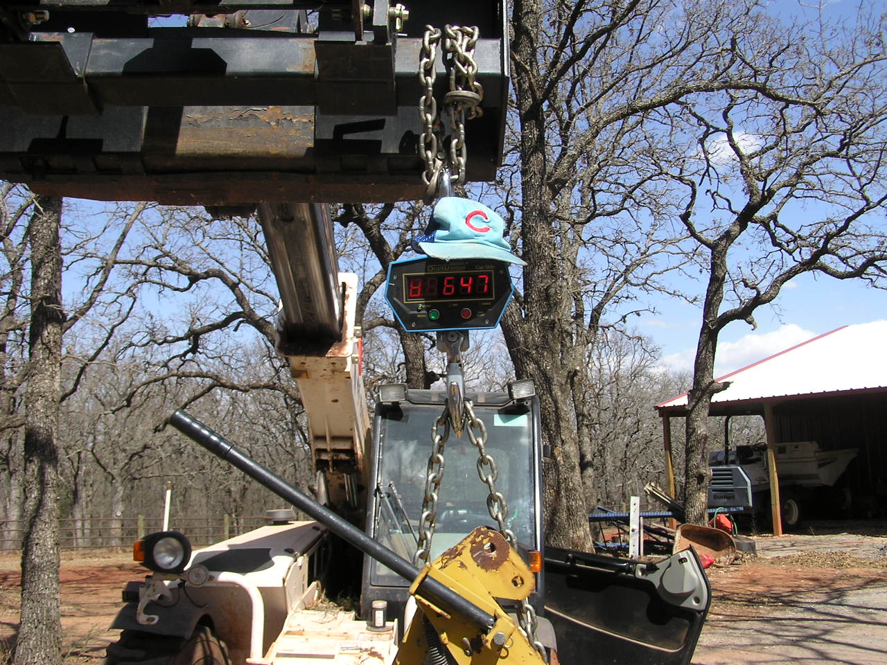

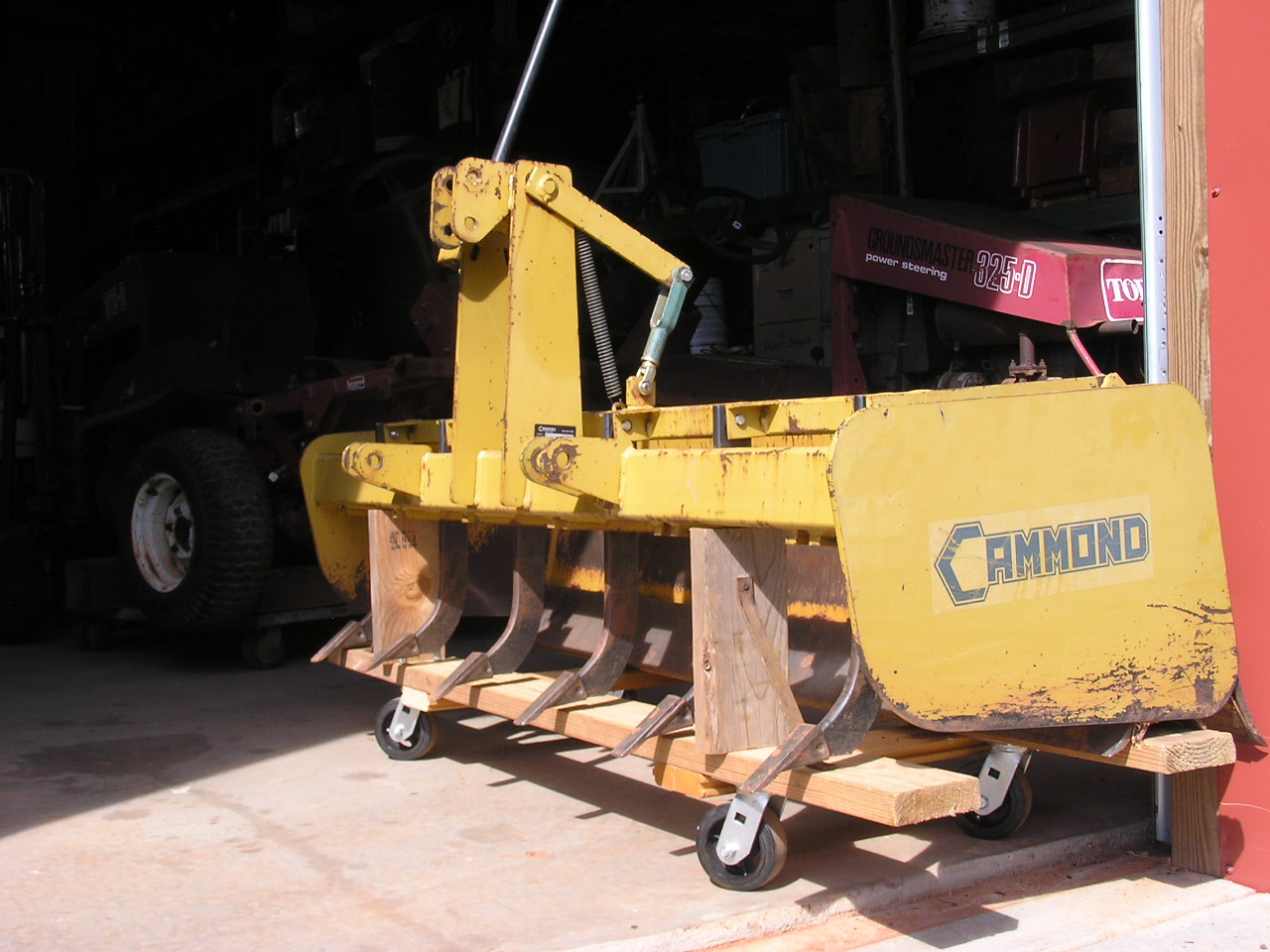

/ Box Scraper #19

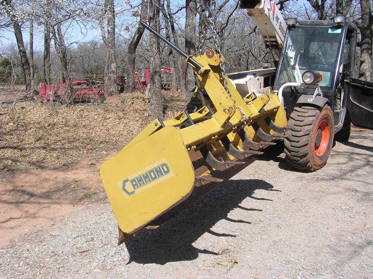

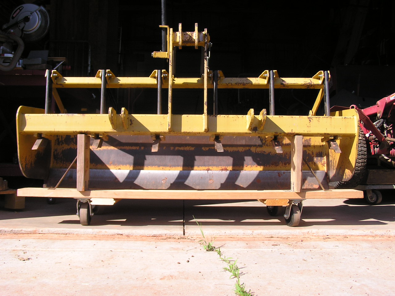

This six footer with a hinged rear blade, weighs 647 pounds and has a lever to raise or lower the scarifiers.
Got it at an auction about five years ago.
