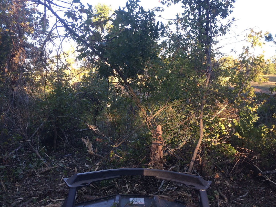

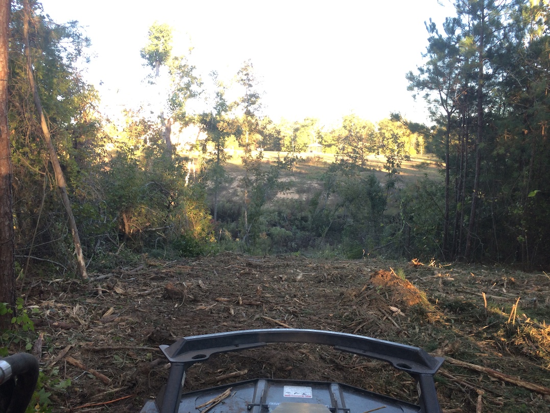

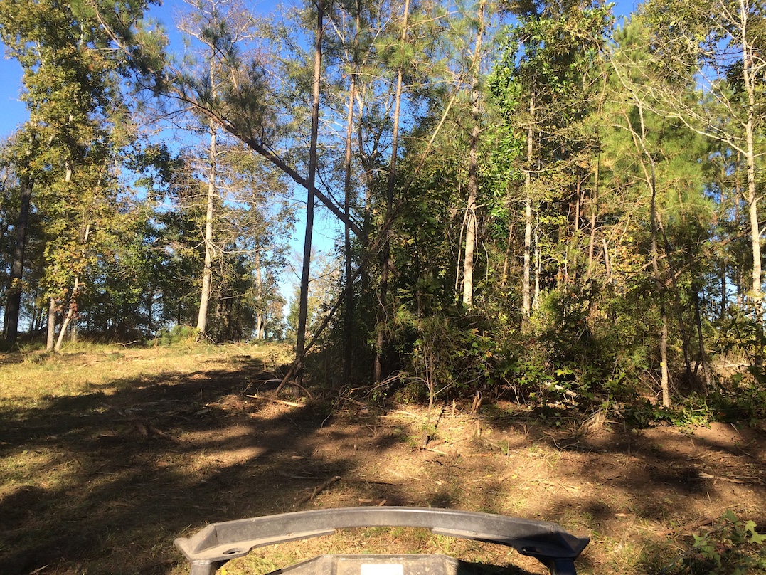

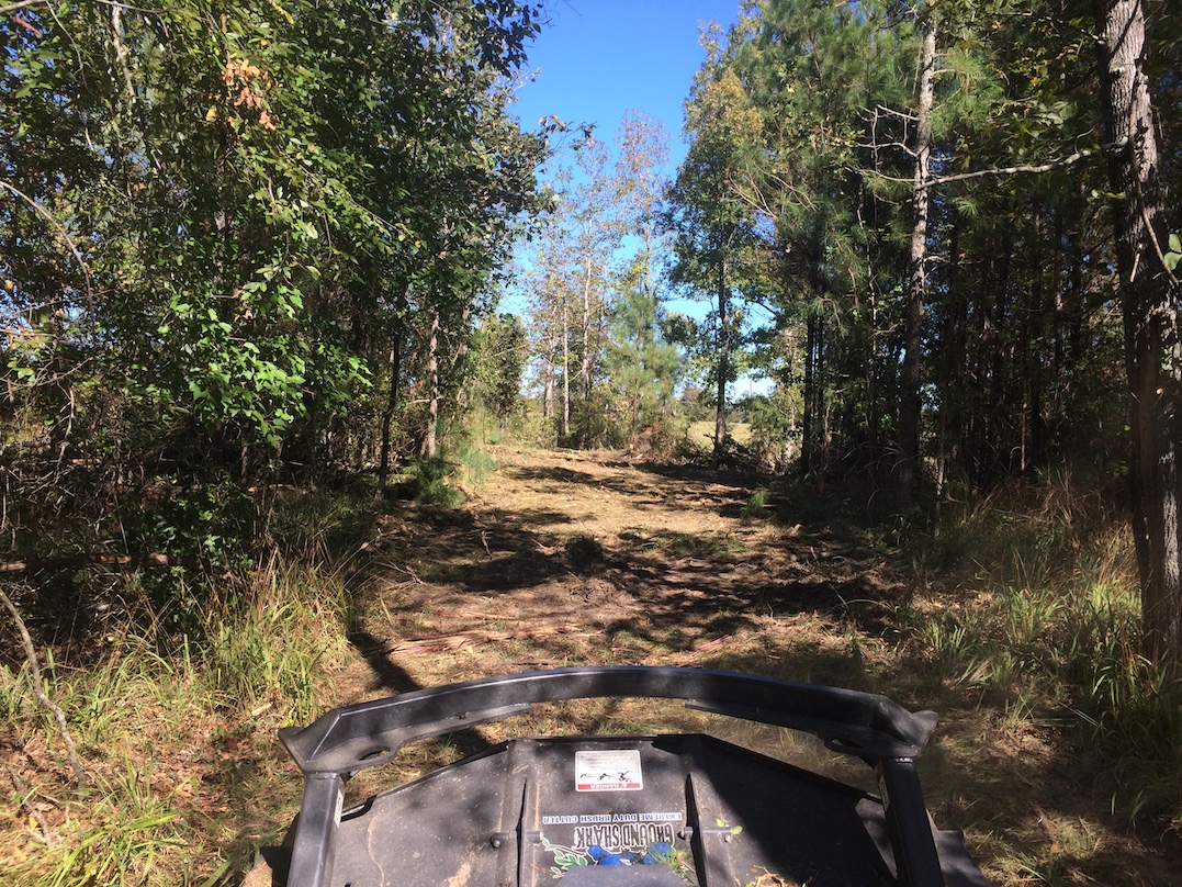

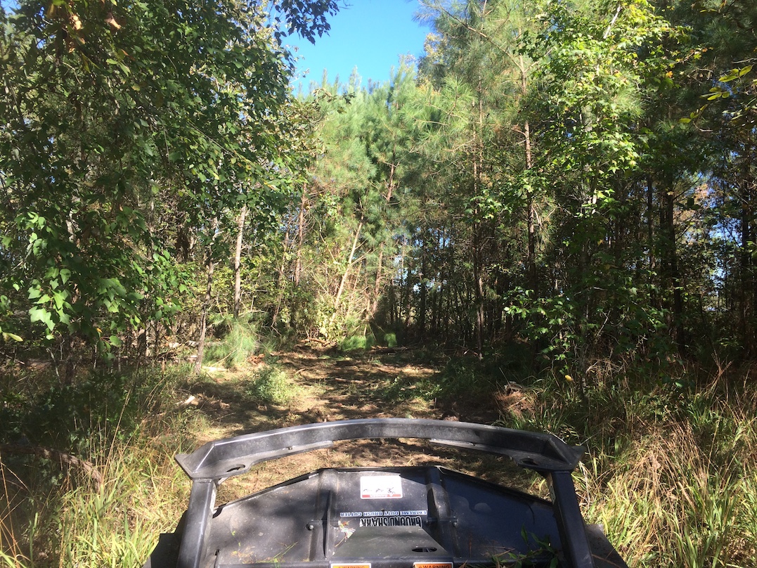

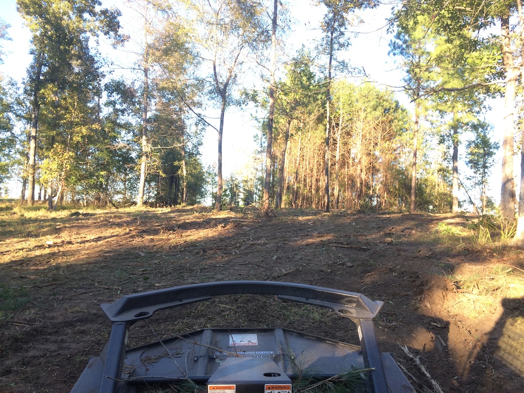

Some mowing before and afters from today... I'll go back tomorrow to wrap it up.
   / bradco ground shark #43
Looks good! How are you liking the 90?
   / bradco ground shark #44
I'm liking it. I always want more, but it has done well on a myriad of tasks.
