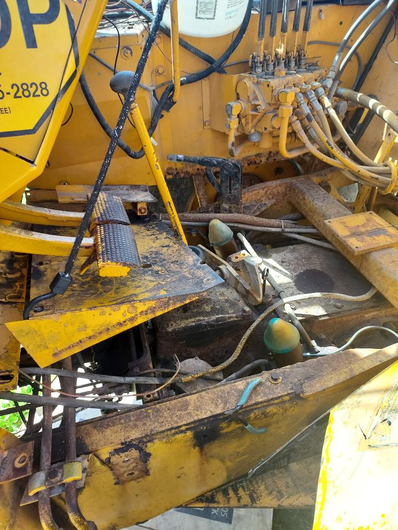

Just picked up this Case 480F and was told a brake line was leaking. If a brake line is leaking wouldnt you have a low reservoir? I Finally got the covers off and looked and both were totally full, but i have no brakes or any pedal. Anyone have a clue what might cause this. Another note, who ever designed this brake reservoir location and the way in which the covers are held down should have their head examined... What a joke. I wasnt about to pull the whole dash out, so i cut a access panel in the side of the dash and will put a piano type hinge and a lock to keep it shut. Meanwhile, besides the brakes and alot of the wiring, she runs awesome. Rebuilt one dump cylinder and replaced 4 hoses and now im onto the brakes and wiring. Also repaired the Hour meter since a new one is 2100 bucks. I hope someone out there can give me some input on the brakes. You tube tells you nothing really.

Yeah Roustabout. Im learning alot as i go. I do know one thing. Changing a simple brake line is a royal pain in the ass....lol. It took be nearly 5 hours just trying to get to the line nuts and getting them loose and off. I actually ended up cutting the damn lines . Went to Auto zone and bought at 6 ft section of steel line and spent another 2 hrs trying to get the nuts in position to get started. There is literally no room. Im not happy with the line i bought though because even using a tubing bender, it still started to kink. Was able to save it though and finally get it hooked up without using the rubber line that was connected to the slave cylinder. Another fun job was bleeding the brakes by myself. Since i had the floor out i used my left forearm to pump the brakes and my right hand to loosen and tighten the bleeder. Guess what, I have god damn brakes....woooohoooo. They still werent the best so i checked on how to adjust the brakes and did that by feel. I couldnt lift the tractor and do it the right way, so im praying that worked. If i have to do this job again i hope its not to soon. What a pain.

I wish i was that fortunate to be able to wait, but i need my tractor for pushing snow. I finally after busting my ass, sweating my balls off and swearing every curse word under the sun got the line replaced and my brakes now work. Not a job i ever want to do again because there is just no room under there to work. I think i found out my back can contort in many different positions and i already have a bad back....lol
