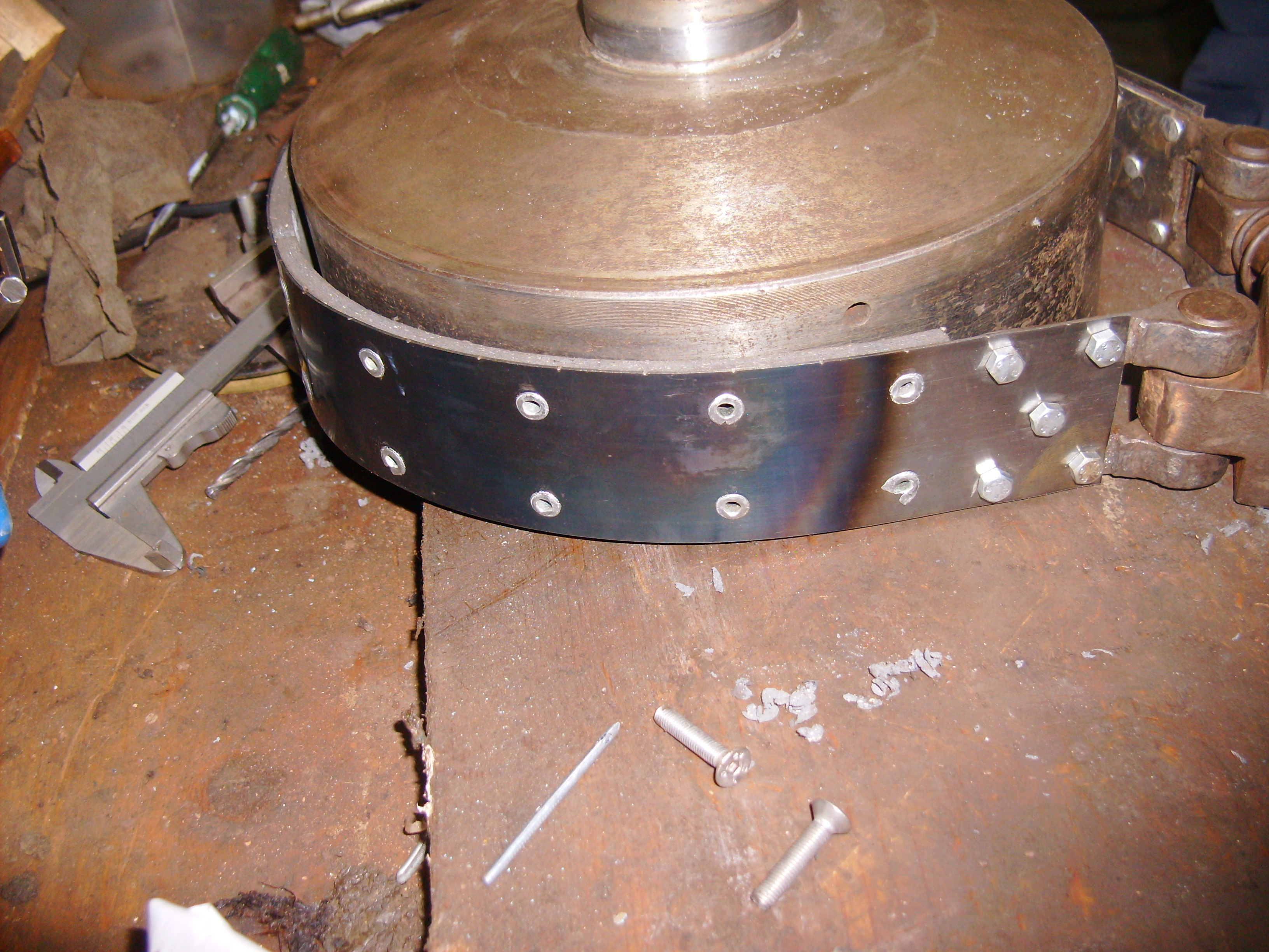

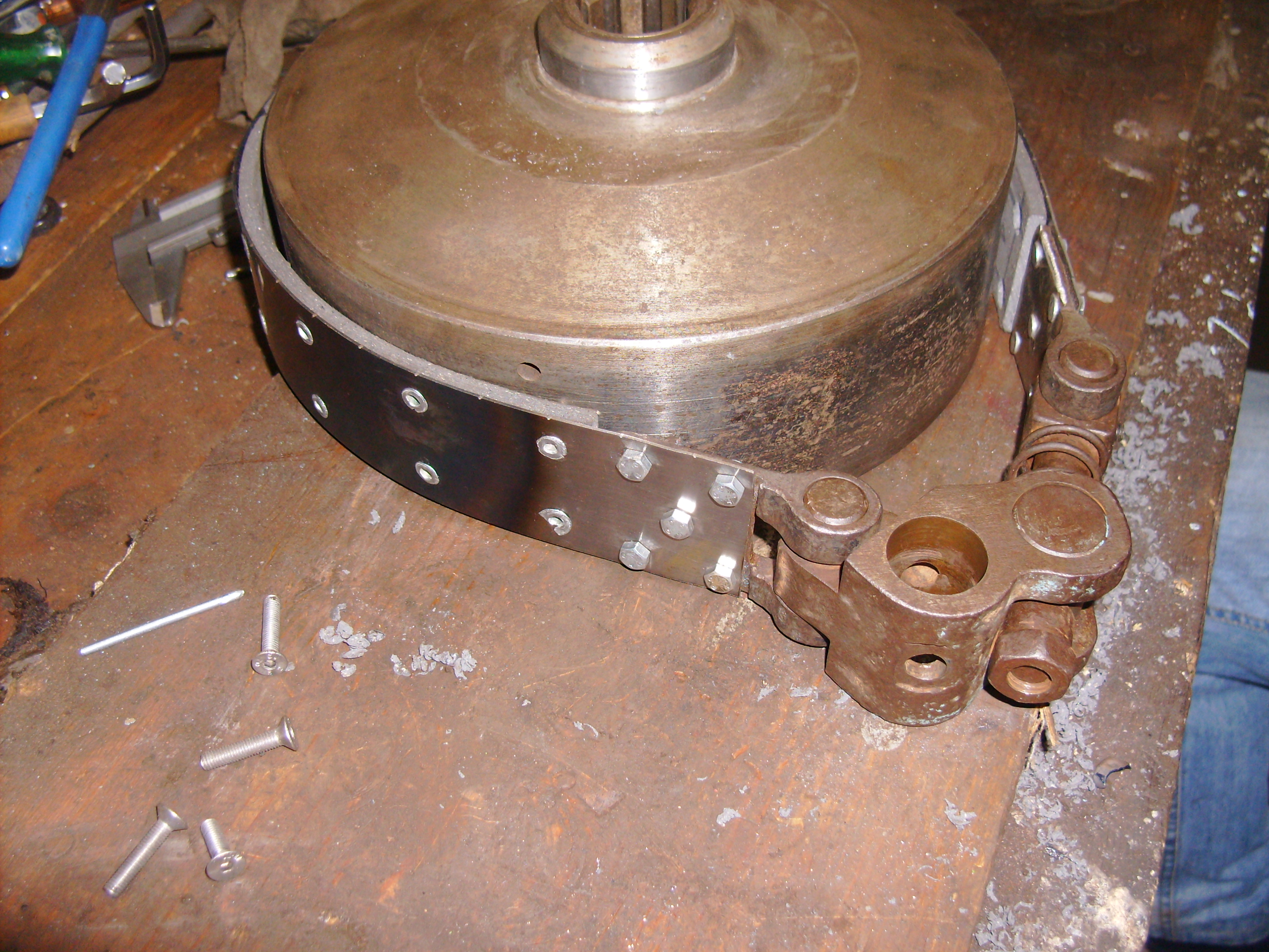

I've remade new brake bans for an old crawler tractor by riveting the brake material on the bands and it went well. I was very pleased with the results and worked perfectly.
A bit tricky to drill the brake material as the drill will grab just make a mess but doable.
View attachment 668427View attachment 668428
I used a 3/8" Forstner bit. No grabbing at all. $10-$12. Glad to hear someone else has re-lined their brakes !!
I had no choice. No parts available at all for a 1962 Toselli 28hp crawler tractor, whose company was bought by two or three other companies.
Thanks for the tip on the bit. I'll keep that in mind if I ever need to work on brake drums or band again.
