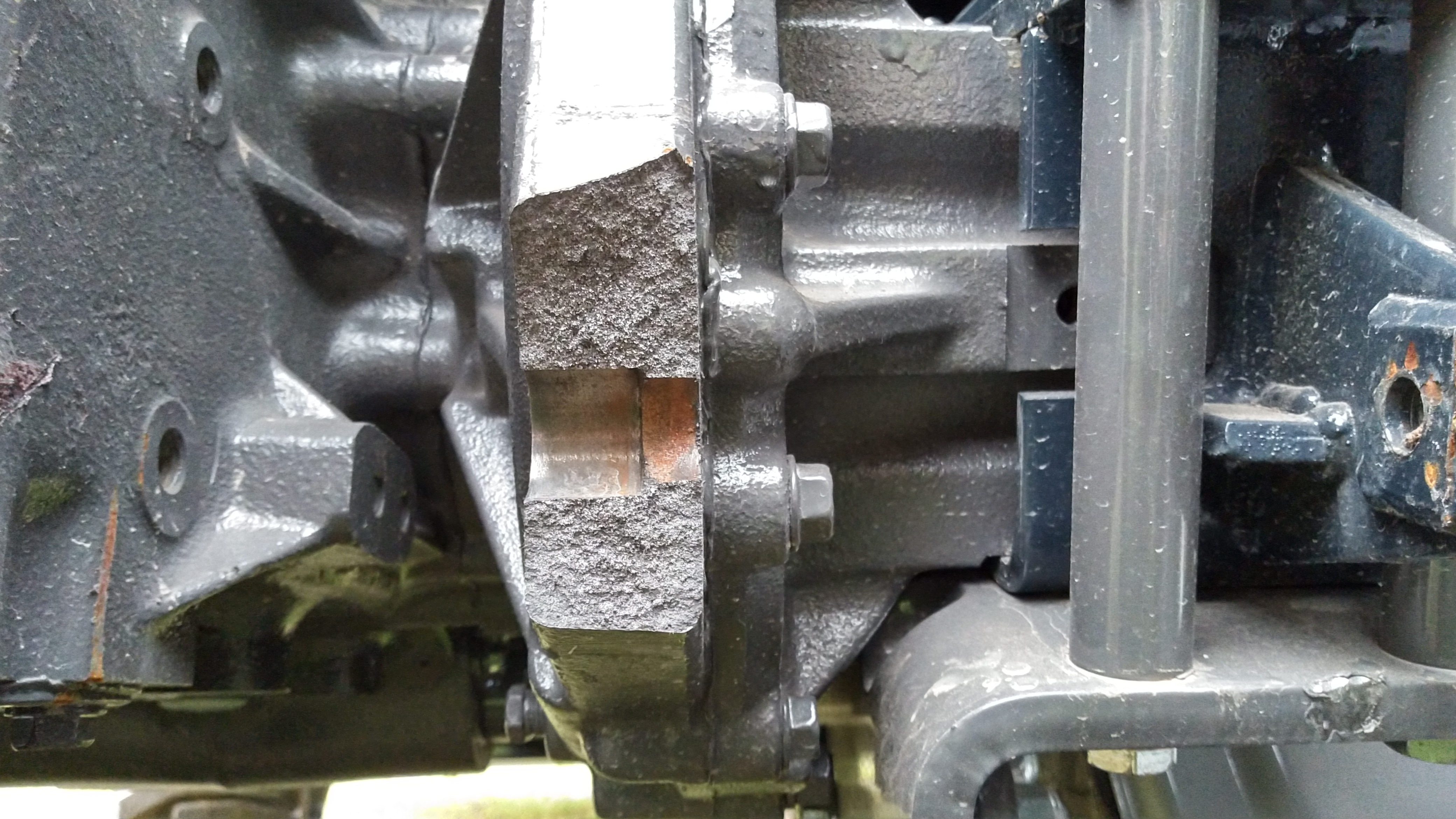

I'm reading all these replys that it will be a warranty claim and make the dealer do this or that or change out to a new tractor, good luck.
You may get told that you overloaded or abused it and nothing is covered, I would hope not but be prepared.
That attachment point may well be a cat 1 type pin which would have been tightened with a lock washer

Just observation but ... IF bolt was to tight it may have causes strain on cast iron main body and cause it to crack, not that you hit anything too hard to snap casting....
And why is there lock washer under nut (or so it appears) when it shroud be loose swivel connection... IF that is setup as it came from dealer, it's dealers problem....
Dale
Yeah, everything you see is how it came from the dealer. Now that I think of it the small broken piece is still attached to the lower arm.

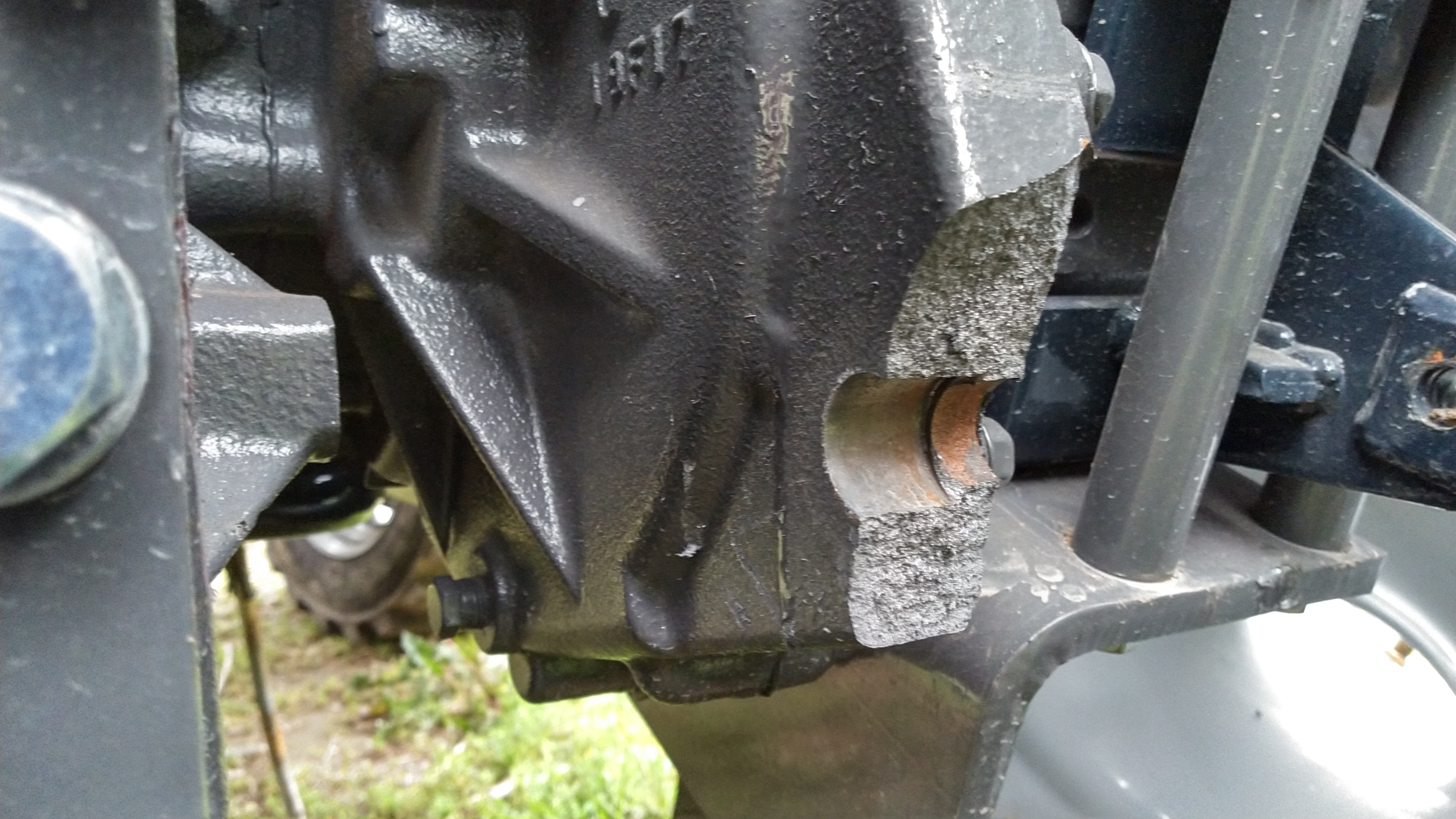

I've seen that failure before when one of the lower link extensions was not set and the locked one was overloaded and over-traveled sideways. Does yours have the link extenders? That looks like a twisting failure, not a rearward overload. Where's the 2nd part of the broken eye ? Aren't there 2 ???

That's the flaw of that setup. The pin is only supported on one side, then the cast iron ear just broke because it's just to much.

On the tractor side, the hole where the rust is showing, am I seeing a crack that appears to go around the circumference of the hole?
Better pictures.

Both of the lower extension were set and locked when this happened.

OK, so that's a shoulder I was looking at.

JB Weld. Its even the right color. (What's the other side look like from a few different views ? [assembly issue]). That ear does not seem like it would be strong/massive enough to carry any sort of side loading. I REALLY like the extendable arms, though. I sometimes had to use my loader bucket to 'walk' the tractor into position to hook up a heavy attachment.
