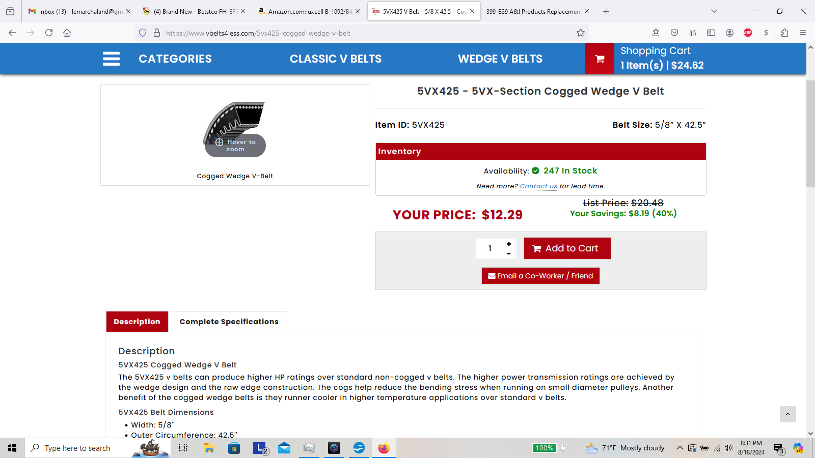

Before wasting the money to have someone machine the pulleys to get the belts to sit lower get another set of belts.
Check your pulley alignment with a steel square or ruler or 2 ft level to be sure of the alignment, wood is not straight enough.
Then either raise your cut height or reduce your ground speed. Also on some of those the rear door can be opened to eliminate the "recutter" action many flails have.
V belts are designed to grip on the wedge action on the sides of the belts they should not bottom in the belt groove.
Your belts the B-991 is a B series metric belt so 17 mm wide on top, then they throw in a wrinkle by using 991 or 991mm "inside" circumference, so the B-991 is a 17 x 991 inside circumference belt.
That should also correspond to a metric B series 1067 belt with the 1067 being the outer circumference.
The on top of that an American SAE belt of the spec of B39 or a 5/8x42 inch belt is the same belt,
Another option would be a cogged V belt this might be a good fit.
