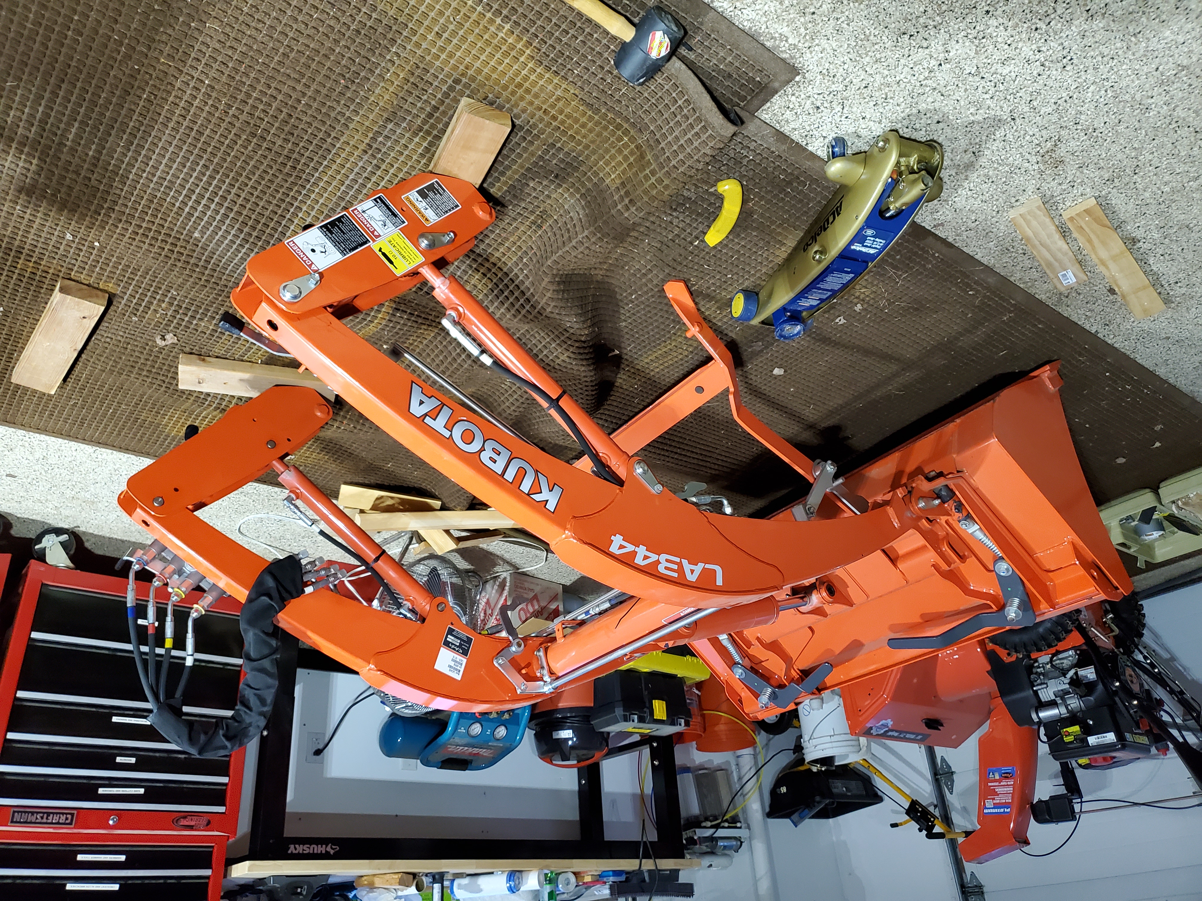

   / Brand new BX2380 Front End Loader Issue/Damage #62
I recently had a similar issue with this tractor. After it happened, not being able to get the loader connected or disconnected right away, I consulted the internets, found this thread and decided to stop and think a bit before causing more damage than a few minor scratches. I have a call into the dealership for service, but they are backlogged right now. I disassembled the pivot points on the left side to get the loader completely disconnected from the tractor. I had to use a 2x4 on the right side to keep the loader arm from resting directly on the front tire. Meanwhile, I got the wife to back the tractor out from the loader while I lifted it over the wheel on the right (she also backed over my foot; no injuries other than a sore back from the lifting). I reassembled the left arm of the loader, but the bucket is not flat on the ground after all of this, and the stand won't deploy rigidly, so the loader arms are resting on the floor. As such, I cannot move the tractor close enough to connect the hydraulics, because the the arms rest where the wheels need to be, and I cannot flatten out the bucket such that the connection points will sit high enough to drive under. Any advice? I jinxed myself taking the snowblower off. I wanted to use the loader to move some of the snow piles away from the house while the ground is still frozen.

I'd say you are going to have to lift the back of it up somehow and get the stand setup correctly. A jack or something similar would maybe do it. As you have already read, be careful.

It would help if you would post some pics.

BX1880 owner here. I think some pics will help as well. What I can tell you is that if you back the tractor up to be along the side of the loader (assuming no other stuff is blocking your path to do so ) the hydraulic hoses are long enough to be connected to the tractor. This should allow you to curl the bucket, etc. and hopefully get the loader re-positioned. FYI I know this because I did it at the beginning of the winter so I could curl up the arms and the bucket so that the cylinders would not be exposed all winter while I was storing it.

That is what I would do, if you drive up alongside the loader (so that the tractor is heading in one direction and the loader is headed in the other) instead of trying to drive into it like you were trying to attach it to the tractor, you should be able to connect the hoses and move the loader.
If that doesn't work, remove all four quick connects (over an empty bucket) and move the loader arms to where you want them.

I thought of that. It's on the wrong side. I'll get some pics tomorrow (3/14) before I leave and try and post them during the day. I have to work all week, and I'm on call, so time is not mine. I'm thinking I need to go back and take both the right and left arms apart, which should lighten it up enough to move, then I can turn it around and/or take the bucket off and really lighten it up. Anything I think I can jack it up onto will just get in the way of the tractor in the current location. I appreciate the input.

20190314_073905.jpgPictures taken with a Galaxy phone always end up upside down when posted on the webs, for some reason. If you click it to enlarge it, it appears correctly oriented.
