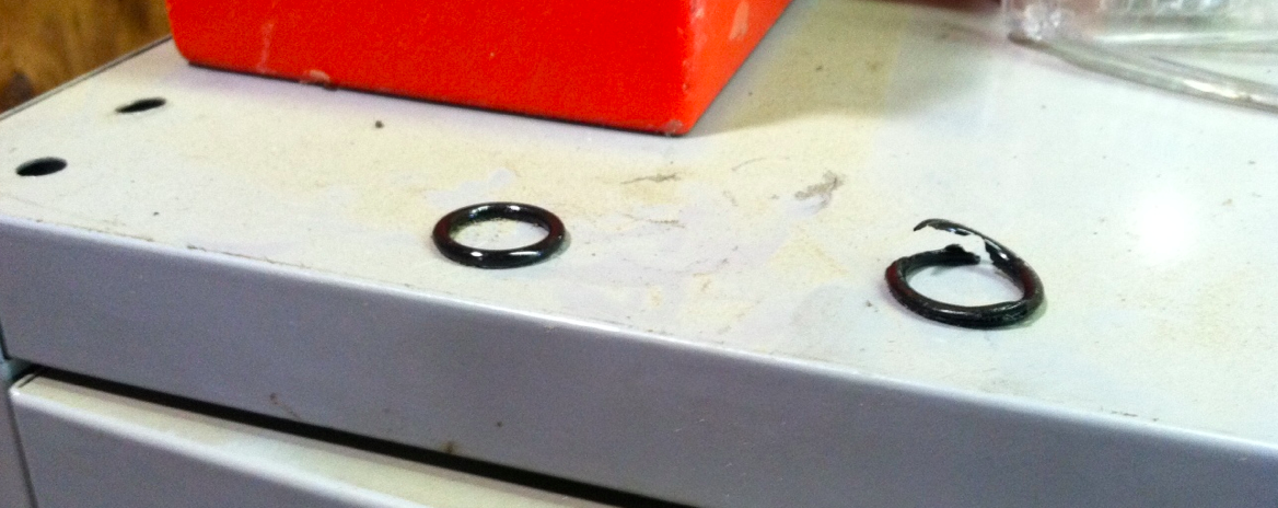

Think they found the source of the leak. They had to split it tho.
I got a CK20S HST delivered on Tuesday, and on Friday I realized that it has been leaking (presumably from the start). I've only put 8 hours on it that consisted of grading 2000 square feet of yard (moving dirt, box blade, etc).
I've troubleshot to the best that I can and it appears to only leak when in high range with the pedal applied. It leaks at the rate of 1-2 drops per second! While I've never used a Kioti before, even before observing the leak, I didn't think the high range was useful (no power, very slow to accelerate even w/ no load on flat ground).
The dealer is coming to pick it up today, but I'm not happy that my brand new tractor is going to the shop. Any idea what it can be?

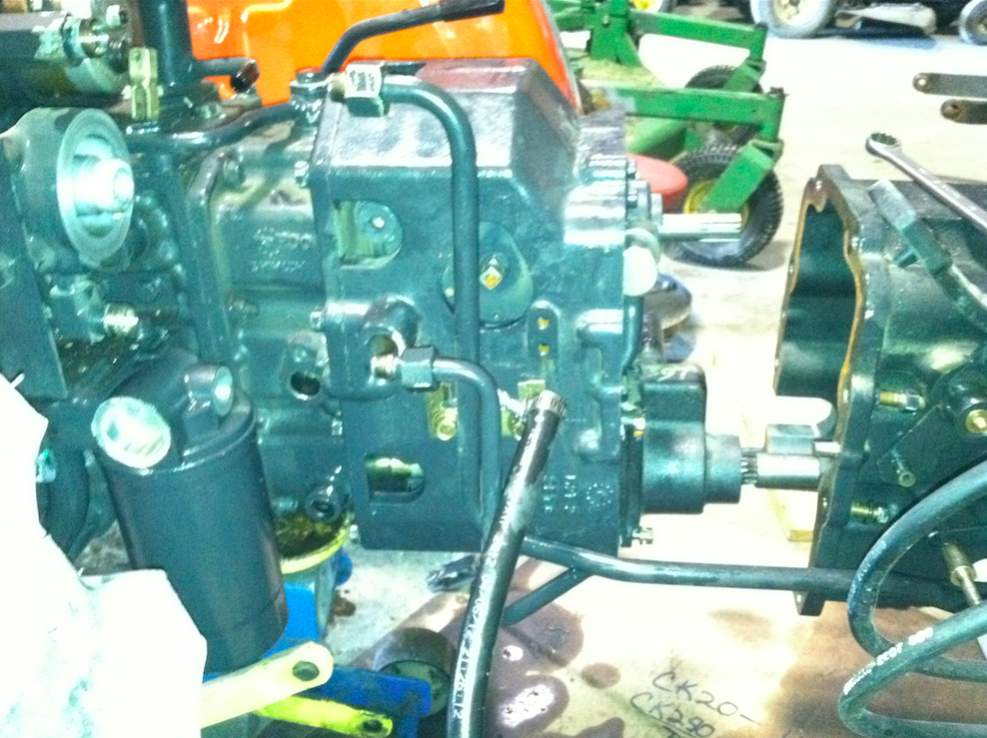

Here's my brand new tractor...
