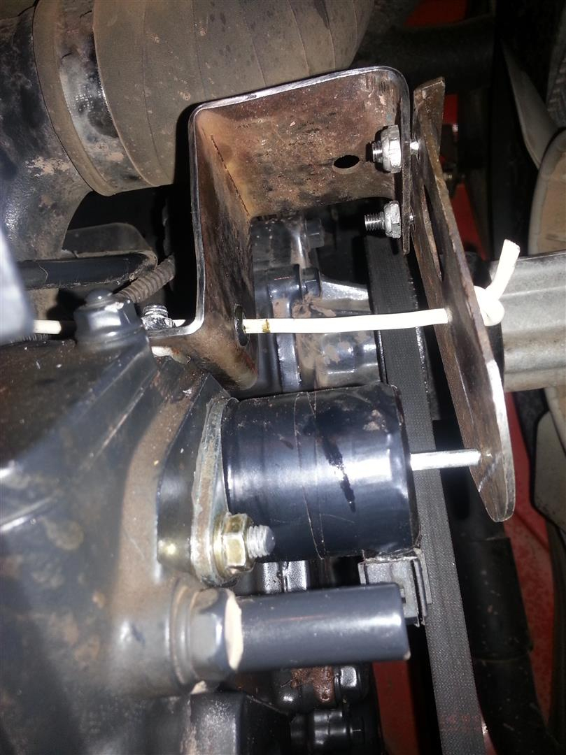

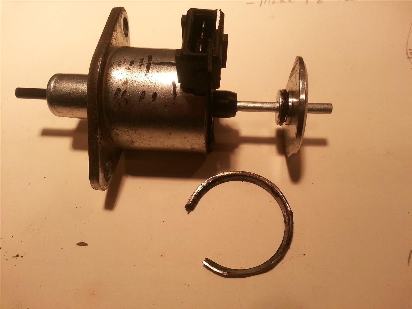

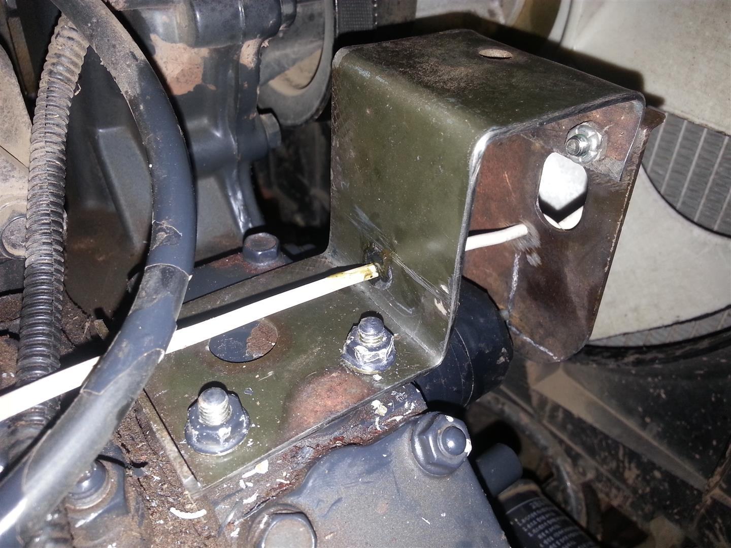

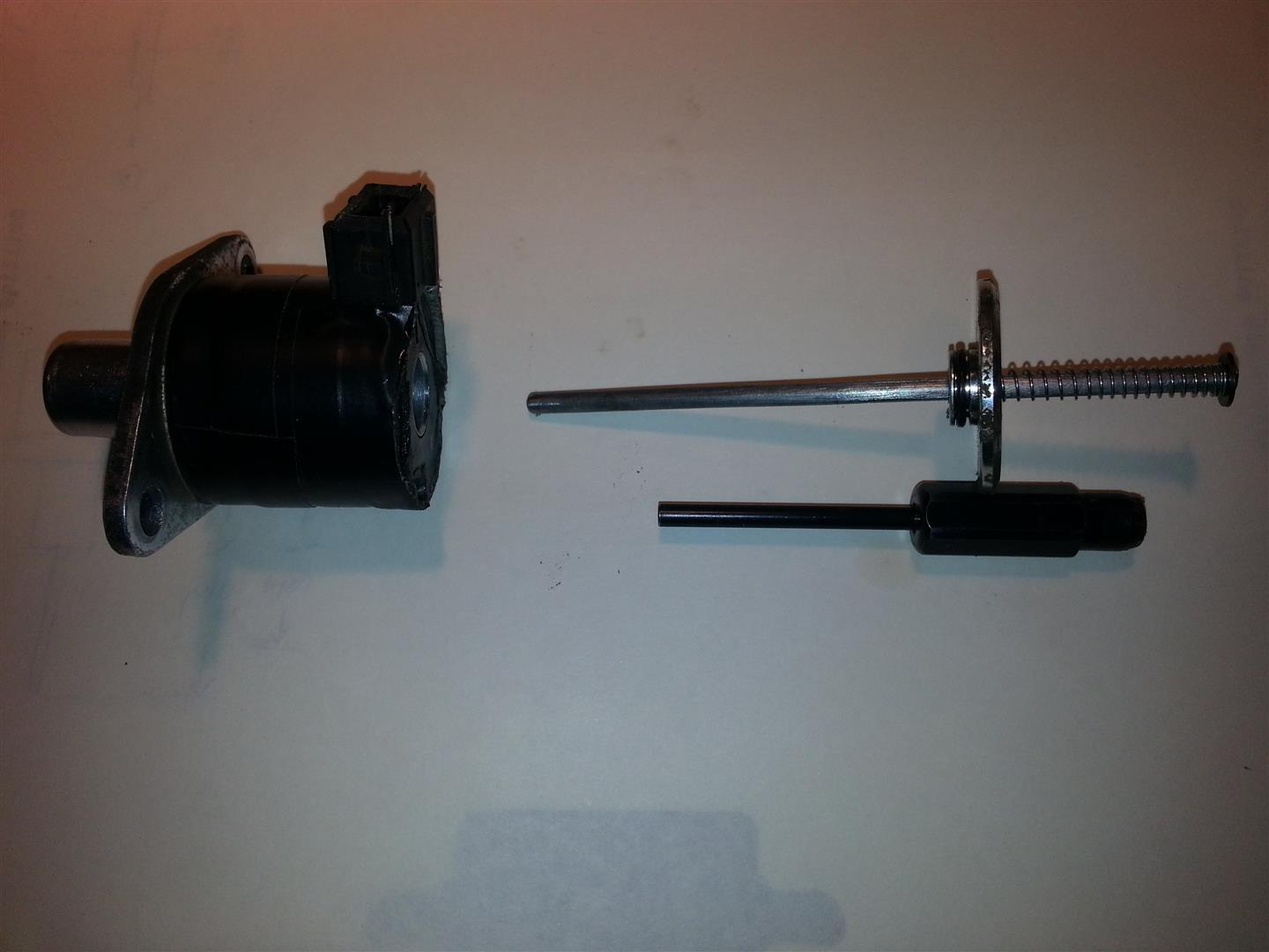

When my "used" DS4510 was initially delivered, it wouldn't start to get the tractor off the delivery trailer. After many attempts if finally started but it continued to have starting problems. Long story short, I got the dealer to replace the "Kill Solenoid" under warranty and it worked fine for a year. Then the intermittent starting problem began again.
This model has a design whereby the fuel flow solenoid is closed until the ignition switch is turned to the crank-engine position. This energizes the fuel solenoid with a few amps of current to override an internal spring and pull the solenoid in to allow fuel flow. After a few milliseconds the power to this energizing coil is dropped but a smaller coil holds the energized flow solenoid open so long as the ignition switch is on. When the ignition switch is moved to the off position this holding coil loses power and the internal spring pulls the fuel flow valve closed to stop the engine.
Your problem is likely the same as mine. I ended up replacing this kill solenoid twice over a 2 year period but it happened a third time. At this point I cut the end off the kill solenoid and discarded the solenoid plunger, installed a new longer shaft through the solenoid, then installed a spring directly on the fuel flow valve to hold it open. Then installing a pull cable to close the valve briefly for shutting the engine off fixed this problem permanently. Most old diesels worked this way. It's simple and reliable.
If your engine won't start, locate the kill solenoid and pull it on manually while cranking the engine. If the engine starts, this solenoid is your problem. Your Kioti may be similar to the 4510 shown in the photos? Modify at your own risk!
Pic#1- Kill solenoid with end cut off and solenoid plunger removed.
Pic#2- New shaft installed
Pic#3- Spring added to hold fuel valve open.
Pic#4- Bracket added to support kill cable that runs through firewall.
Pic#5- Cable pulls loosely mounted plate that pushes flow valve closed
Good luck.
