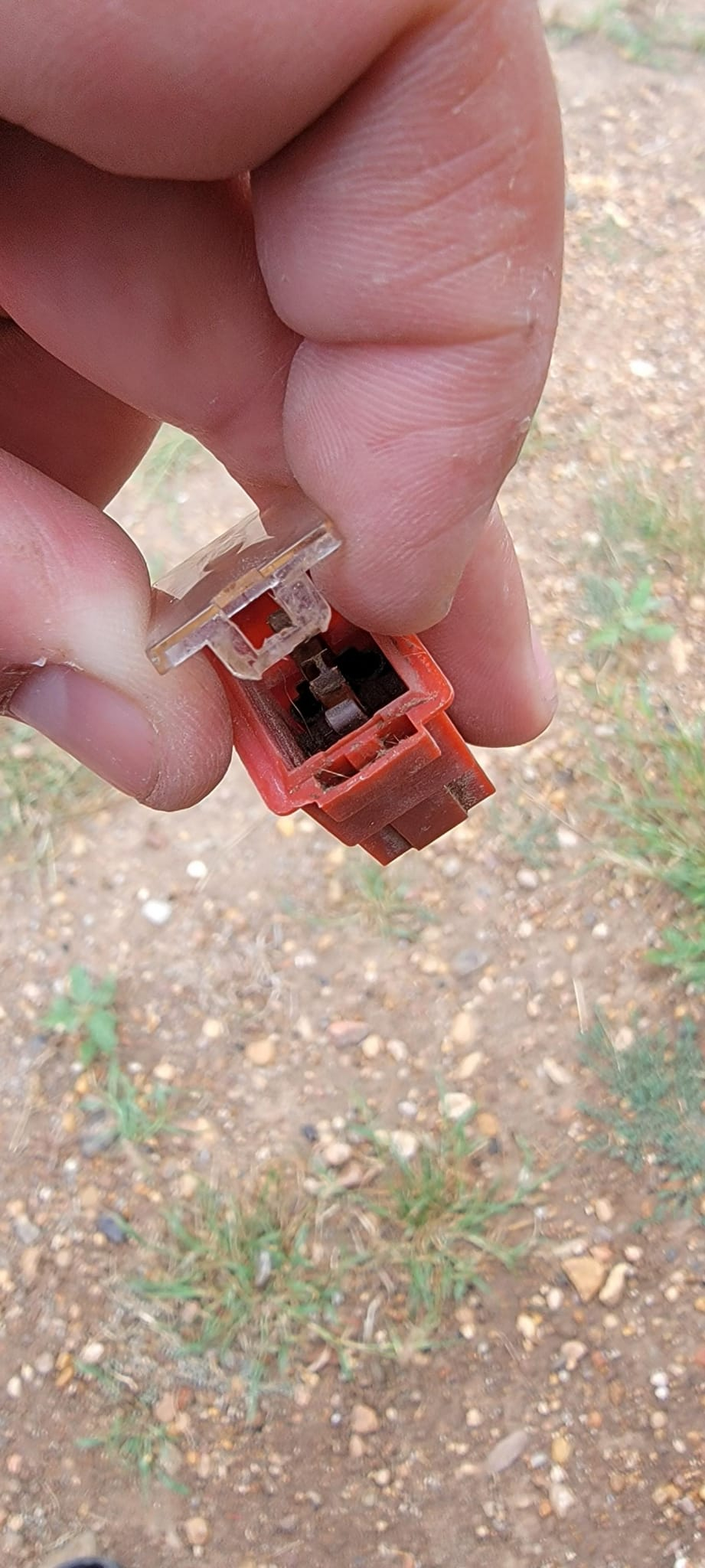

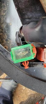

I checked the wires with a pin light today and you were right... The pull wire isn't getting current and it might be those fuses that I was telling you about... I'll post pics of two different fuses, they both look like the wire isn't broken but one fuse does show more signs of use (I guess)... After looking at the pictures, you think I need new fuses?
Going back to the solenoid wires, there are 2 wires on top and one in the bottom in between both (kind of like a household wall outlet with ground). The pull wire seemed to be in line with the wiring diagram (pill also post a screenshot) but what is weird to me is that the pull wire is white, the hold wire is black and the ground wire is blue and red striped. Thing that's odd to me is usually ground is black. Does that seem normal or am I seeing it wrong? Either way, I checked both the black (hold) and the blue and red striped wire (ground) while turning the key to the off position and none of them had a connection. Maybe it's kinda extra info but I'm trying to give a good explanation as to how I came to the conclusion that you were right

I'll do that when I get home, what can you tell me about the fuses in the pictures? U think the wire on one of those is running thin? Or is that normal?
