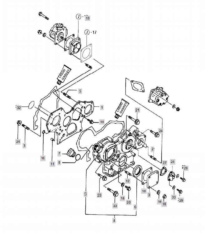

Pump doesn’t want come out, in the diagram ptsg posted it shows a gasket or a spacer numbered - 4. I have a spacer that is about 3/8” thick shaped like diagram part # 4 this spacer doesn’t want to separate from the pump. When I try to pry the pump out a cylinder about the size of the inner diameter of the gasket/spacer (it’s probably 3”) is coming with the pump. I don’t think this is right and am afraid it is a cam or drive sprocket for the pump. I am definitely not seeing a small shaft like the posted diagram. I’m afraid the pump shaft isnt separating as it should. Throwing in the towel for today.

Back at it early today, that pump was he!! To get off, results pump is out.
I now know why I had metal shavings in the hyd. fluid
the drive shaft of the pump showed a bit of wear but didn’t look too bad. The mating drive ”sleeve“ that the pump shaft inserts into is trashed. I pulled the front pump “power-steering“
which came out easily, it’s shaft, and that part of the drive sleeve is in good condition.
I think this job just got a lot bigger.. I also destroyed what I’d describe as a bearing retainer which is between the hyd. Pump and the housing that drives the pump.
Does anyone have experience replacing this pump drive part?

Interesting. All the manuals, mention the A1700 engine, which is a 1.7 liter displacement, for the 3510 model. The 1.53 liter is the engine that's used on the Branson 2810, basically the 29hp version of your tractor.
From the parts diagram, looks like that bearing mount (#7 on the picture below) is removable without taking the timing cover off. What exactly did you damage?

I was surprised to see the HP/liter too, it even says 28hp on that tag.
I destroyed the flange (?) called “ cover HYD pump gear”
part # HK02350000A4
i have everything apart, timing cover is off and I drove the bearing/drive gear out. This would only come out by pulling the cover. Another long day, but I’m about half way through I guess.

In The diagram you posted (ptsg) the part I destroyed has a 7 with a circle around it and - 18 I believe, it’s sandwiched between two gaskets highest part of the diagram.

Oh I see. Yes, that's indeed the bearing housing/support or whatever they call it.

ptsg, your right I goofed the part number, should be HK02340000B3
