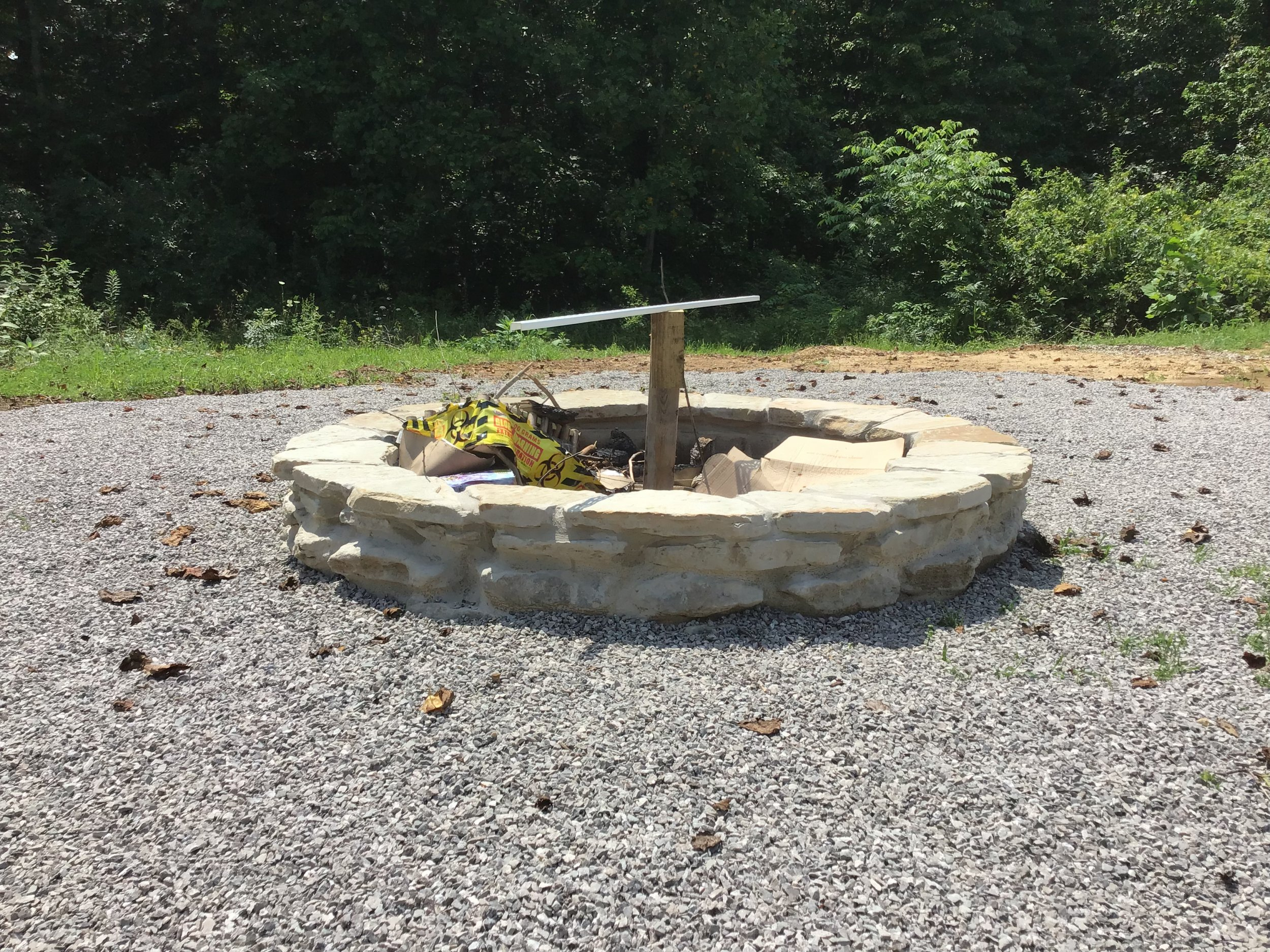

Tractor only has about 320hrs. I’d consider very low for its age. I just use it for Bush hogging, running my log splitter occasionally plow/disc, gravel drive work, chores around the house. I wouldn’t say I’m hard on it, but I do work it and don’t baby it (Yes, it’s dirty) I‘m currently, or was when this happened building a stone fire pit and a stone area around it for seating. The gravel is the base for flagstone or something similar (haven gotten that Picked out yet).
