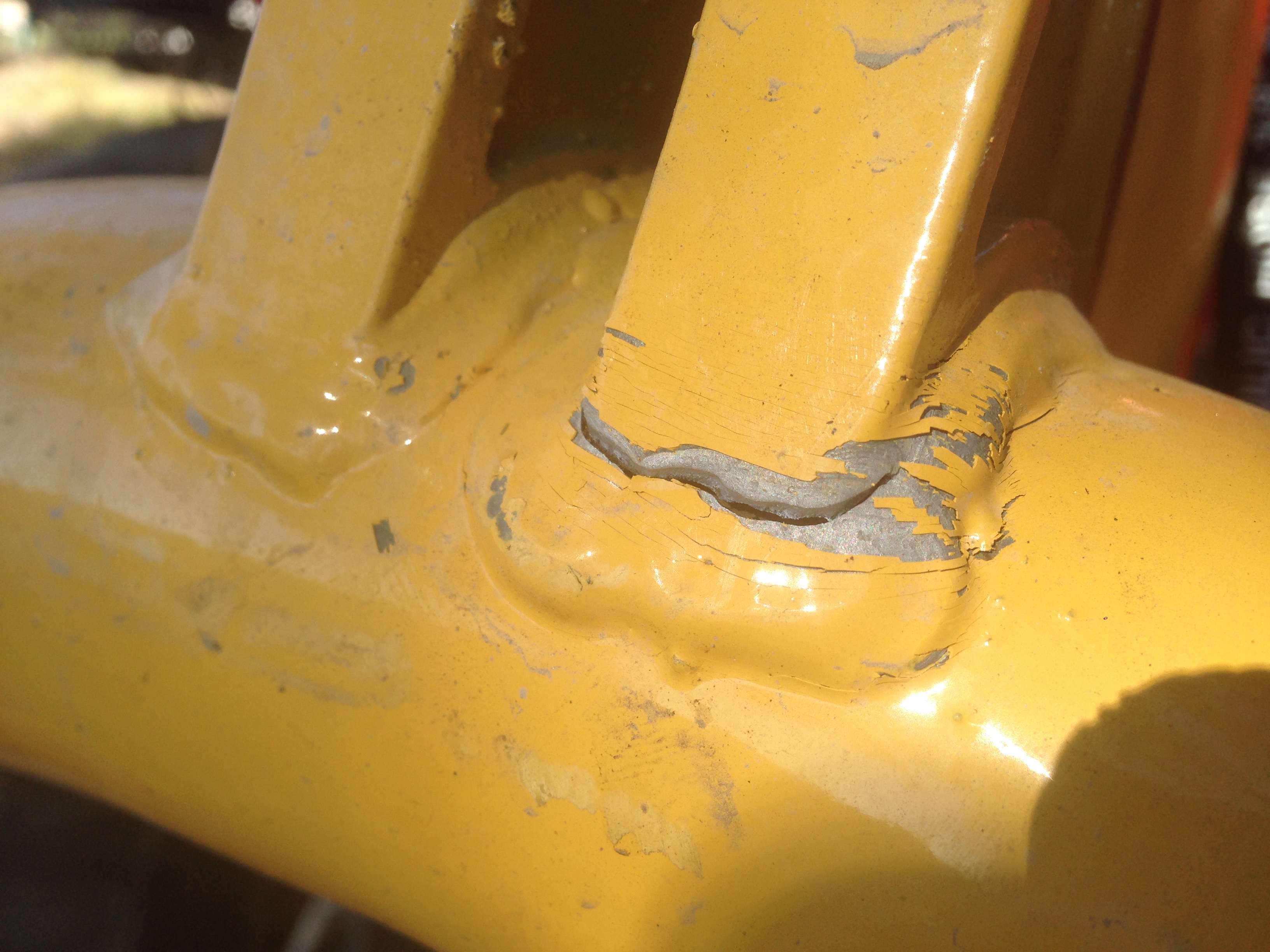

LOL.. funny guy. I have tried to adjust it, but a gauge is the only way to know for sure. Auger holding up well.. Hmm..1st picture is inside your shop. 1st job I did with it, it cracked. It wasn't worth a 3 hr drive up and to get it welded or replaced and then 3 hrs back.
So it's doing ok since..

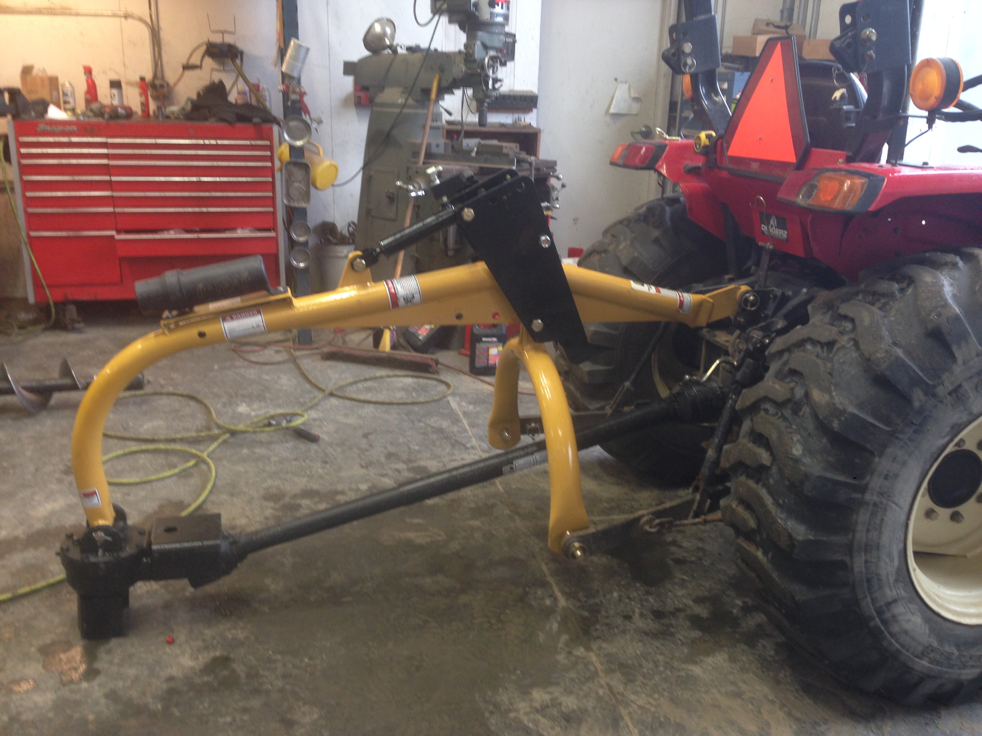

What does that black thing on top of your auger do (with what looks like a hydraulic cylinder on it)?

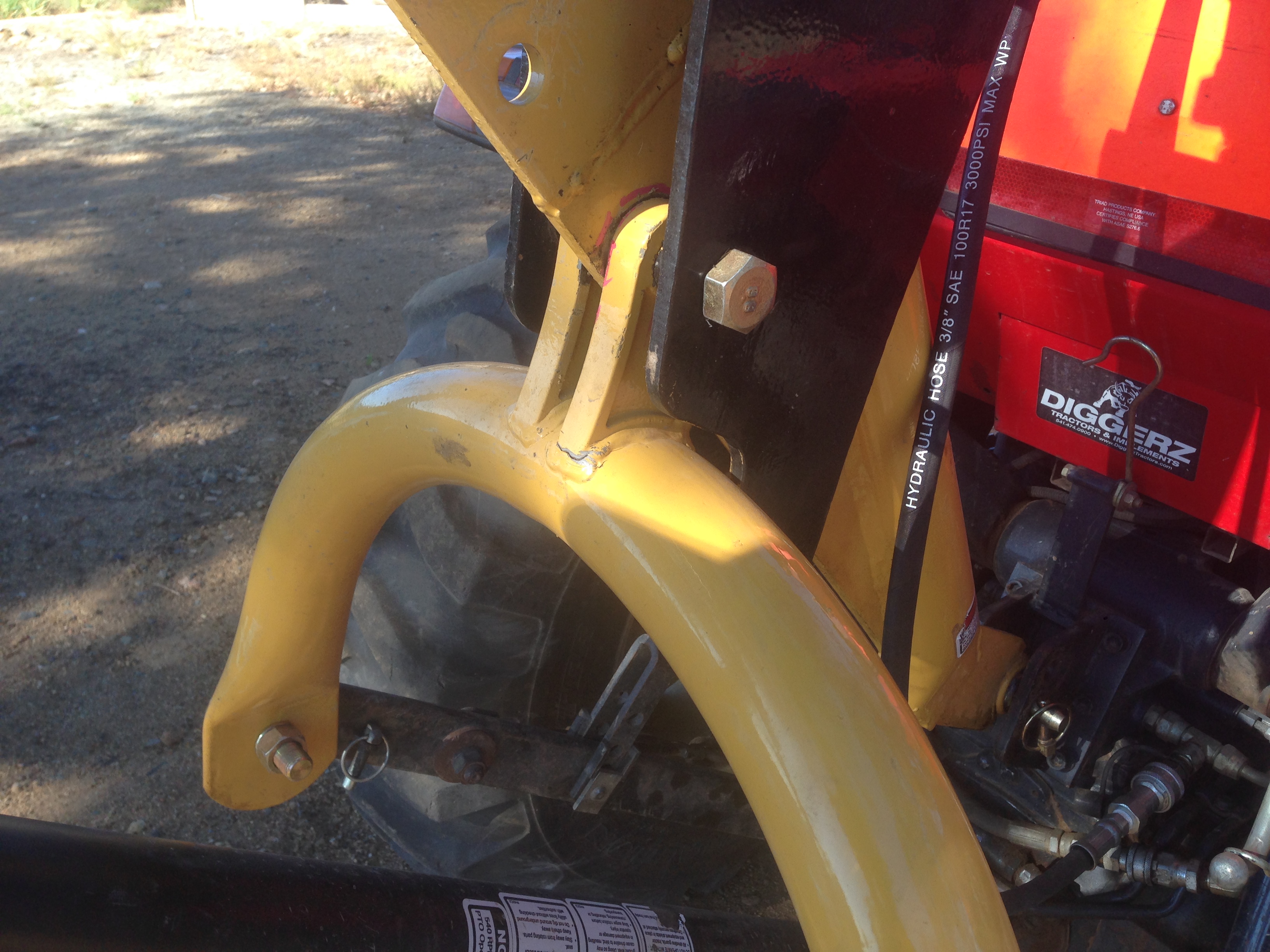

That's a shame that factory weld came loose. I agree it would not be worth driving 6 hours to have a half hour of welding done. The down force kit does apply quite a bit of force. But you don't have to use all the force all the time. You just need enough push to keep the bit doing it's job. But you know that. That weld should not have done that in any event. I'm sorry you have had this problem.
It's a hydraulic cylinder. It's for putting up to 800 lbs of downforce on the auger tip.. Bought it from Dave's Tractor.

Ok. Never seen that before. Sounds like a neat feature. Sure explains why you wear out auger tips while mine have lasted for for years and years, even going through some fairly rocky ground. But I'll bet you can drill a post hole a lot quicker than I can in rocky ground. Getting that frame re-welded should be pretty easy to do.

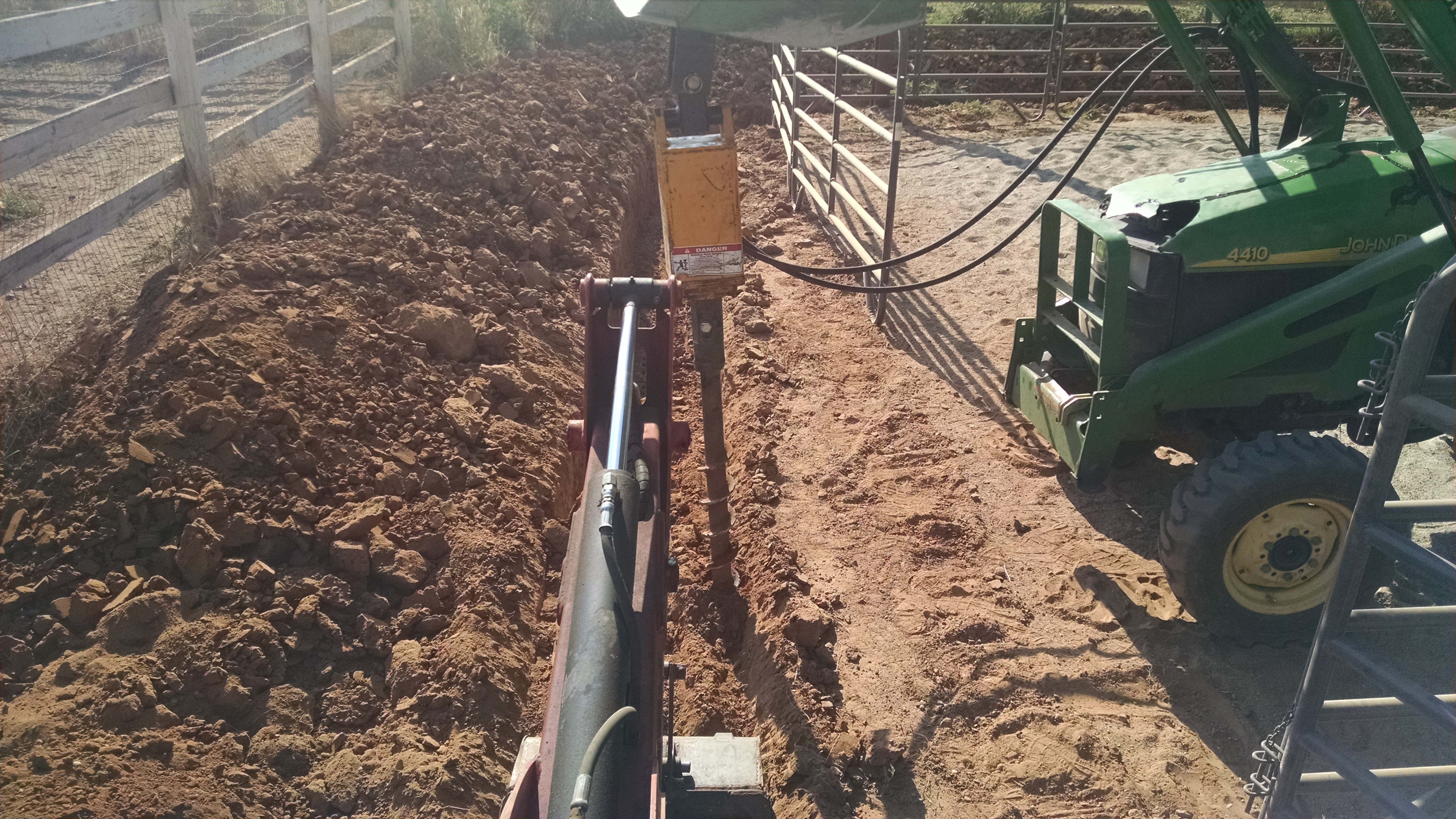

Yep.. it's tough on the tip and cutting edges, but gets it done. I was digging a trench around the outside of a big covered horse arena last year. and when I couldn't dig, I recruited some help. Hard pan isn't fun..
Good days and bad..

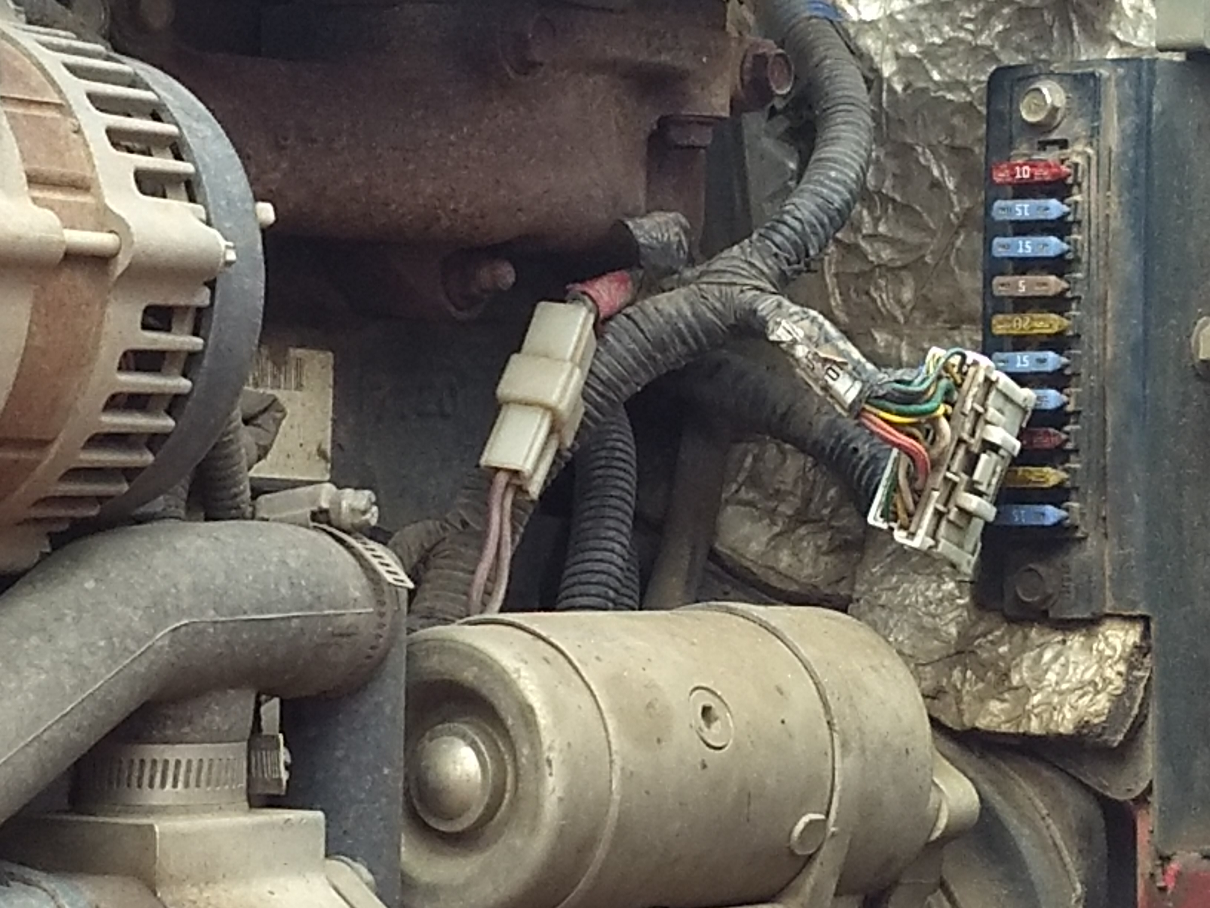

I have a 3510i. Bought it new almost 11 yrs ago. It's been my self employment ever since. This is the third time it's stopped on me. Very frustrating the first time.. So now I know to open the hood and remove the left engine cover and wiggle this plug. Well now it's not even making connection. I have replaced the factory fuel pump with an electric one.. so if the culprit wire makes a connection, I hear it. Well.. Without have the wiring schematic.. I'm guessing this large white wire is the problem. I don't know how to remove the metal plug\spade from the main plug so I can solder it and hope it fixes the intermittent issue.
View attachment 548134 View attachment 548133
So my 3510i just stopped cranking the other day. 226 hrs on the tractor. I checked the neutral safety switch, the clutch safety switch, and key switch.
Then I'm reading these forums to maybe find a wiring diagram and read this tidbit....
I go out to my tractor, jiggle this wire, and it cranks!
What is this wire connecting??
