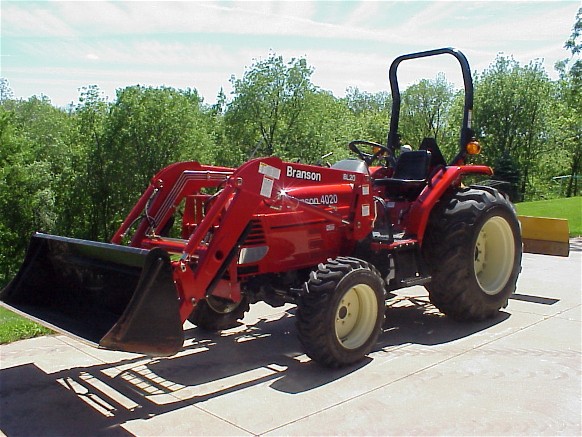

Your hoses are 3120 psi? Mine are 2610 psi. The replacement hoses are 4000 psi.
If yours are 3120 psi I'm wondering if my loader might be a BL10 instead of a BL20 if thats possible. It has a BL20 sticker on the loader but it looks identical to a BL10 that I've seen pictured on the internet. It doesn't look like a BL20 I've seen pics of. For example "sassafraspete" who has posted pics of his Branson 4020. His loader is heavier looking than mine. His has 2 cross supports on the arms...I have 1.
Just trying to get a handle on what's going on here.
Thanks again for all replys.
Ron

Yeah, he has the newer mount type specifically from the center of the tractor. Mine has 2 cross members at the bucket but is supported from the center and the front grill. His is easier to service the engine, mine has more protection I think. I'll check to make sure about my hose psi, I know the bucket is 3120 but not sure about the loader itself. /forums/images/graemlins/grin.gif

You are right...I looked again...hoses on loader are 3120 psi but the hoses from control valve to loader are 2610. I had one of each blow.
Pic I posted was of my tractor...not the other gentlemens.
