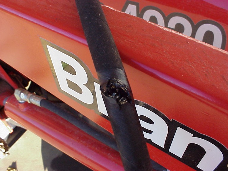

Anybody want to buy a "pos" Branson 4020 cheap?
I've about had it with mine. I blew another hydraulic hose. 3 total now. Fed up with the oil baths. /forums/images/graemlins/mad.gif
I only have 61 hours it.
After moving a pile of firewood... the bark, branches, dirt left under the pile... I tilted & lowered bucket to ground to scrape and push the junk back..."BANG" a hose blew.
I am so discussed with this tractor...wish I never would have bought it. I wouldn't recommend it to my worse enemy.
It needs to be replaced with a REAL tractor. Tired of it just being a pretty face. /forums/images/graemlins/confused.gif
   / Branson 4020 Hydraulic Problem? #26
Ron:
Something just does not seem right with the way the hozes are connected to the controller.
Egon

We've seen a few of the 2600psi hoses blow, but never one of the 4000psi hoses that we used to replace the failed hose. The 2600psi hose is working too close to it's margins, and a little shock load that occurs before the pressure relief can relieve the load is too much for it. I would suggest you replace all three hoses, but obviously you have done that at this point after being anointed with oil thrice. /forums/images/graemlins/blush.gif
Now this isn't rocket science. The dealer can measure the pressure created in the rollback mode or in the lift mode, and he can also measure lift capacity if that is a problem. These loaders are strong! If working right, you should be very impressed instead of disgusted. I don't know your dealer, but if he is savvy at all, this shouldn't be a big deal.
Deliver it to California and I'd be glad to buy it. An hour or so in the shop and the loader would be working great.
