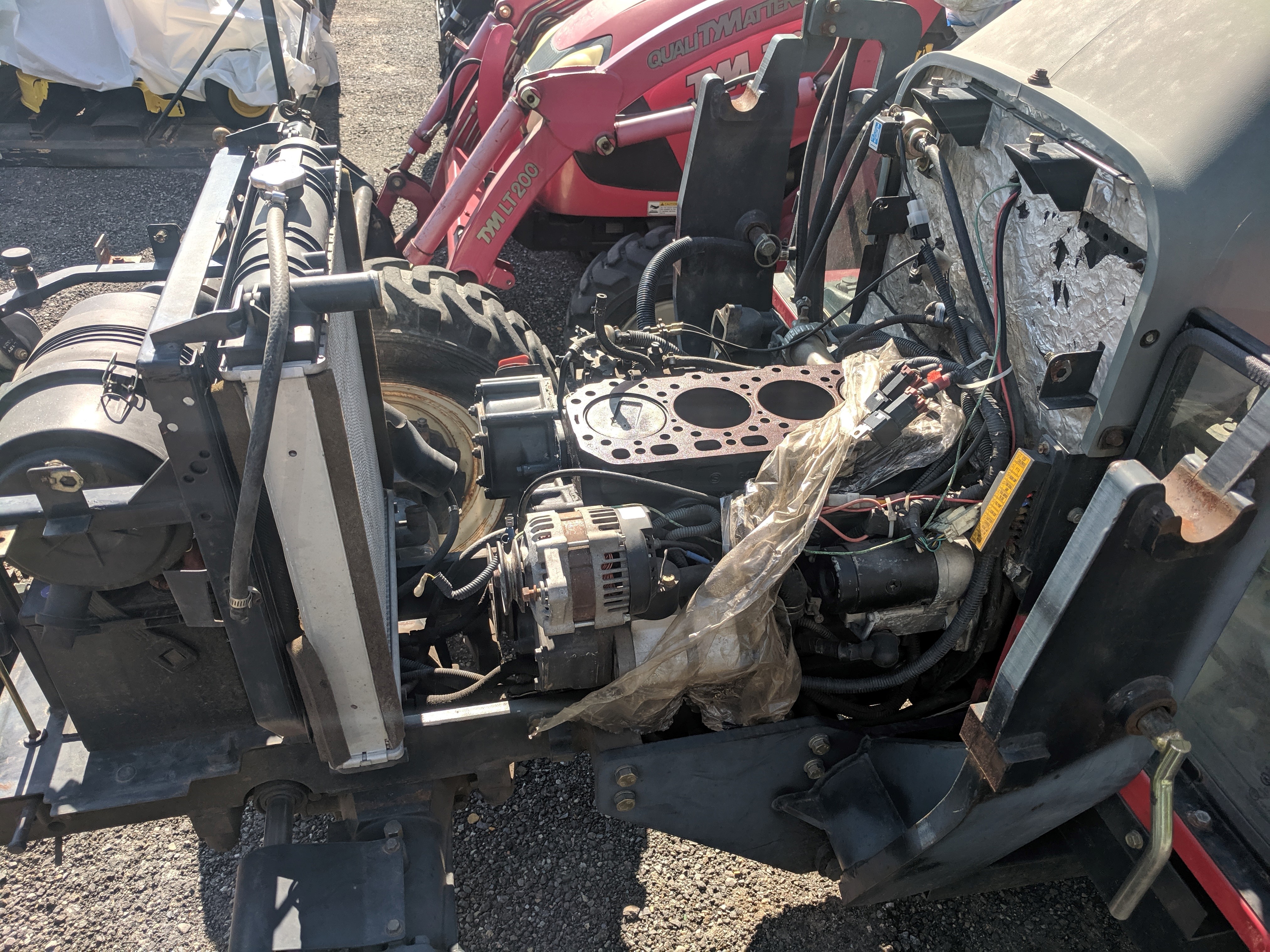

Quick story .......
Bought it for 2500 with cracked head
New new 2000
New head gasket 80
New GP 110
New starter 150
All new fluids and filters 300’ish
New battery 200
Did I mention I’m broke????? I was told “new head and fire it up”!!! Not the case ugh

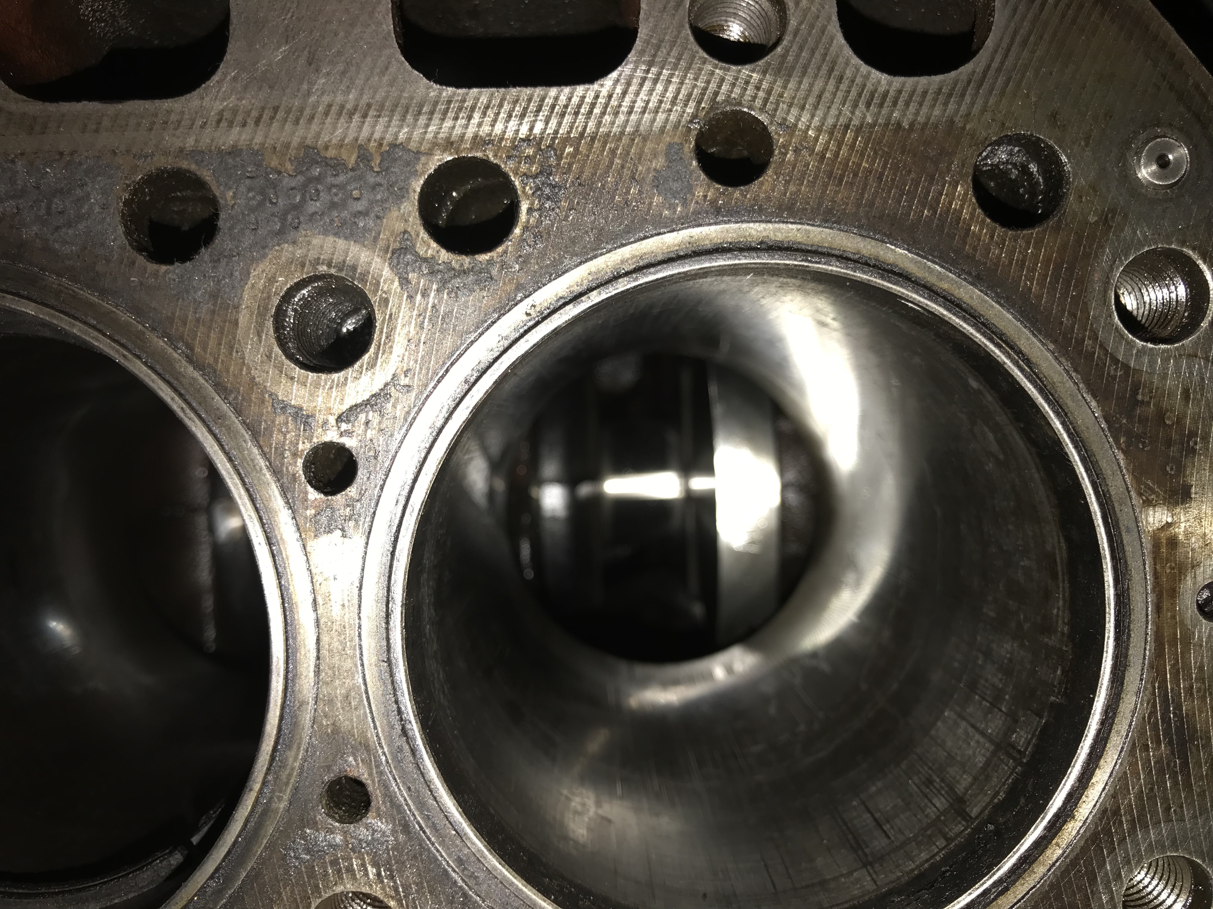

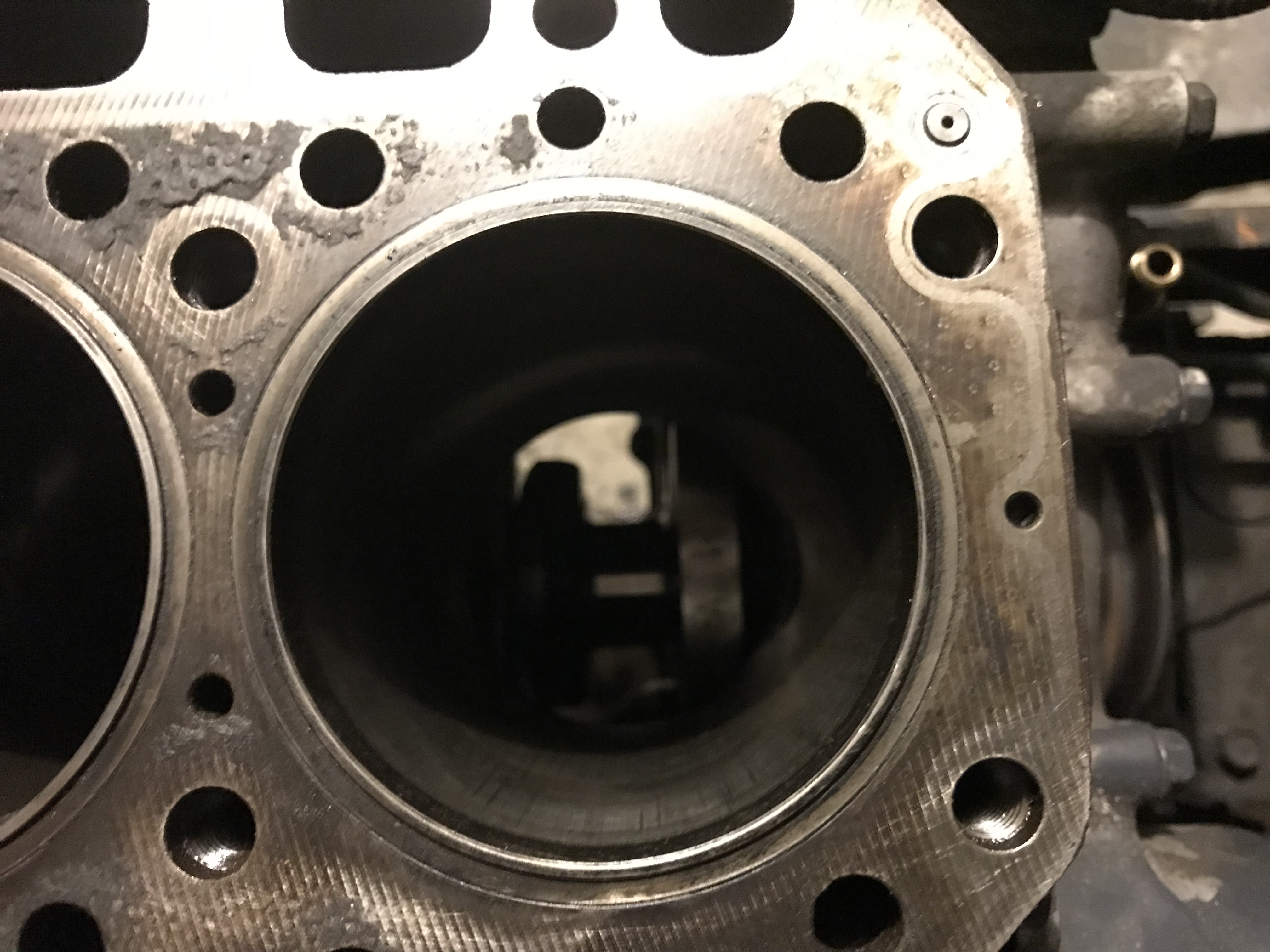

The bores look real good and they measure right around 3.309 so well with in spec for wear.
I plan on using the beaded hone tool too just break the glaze and a HF hone tool for the top ridges.
So my plan was to just replace with standard rings. That is why I would love to have specs for the original ring so I could see how much wear they have.
They are measuring.110” wide for top and second ring and Oiler is around .065”
