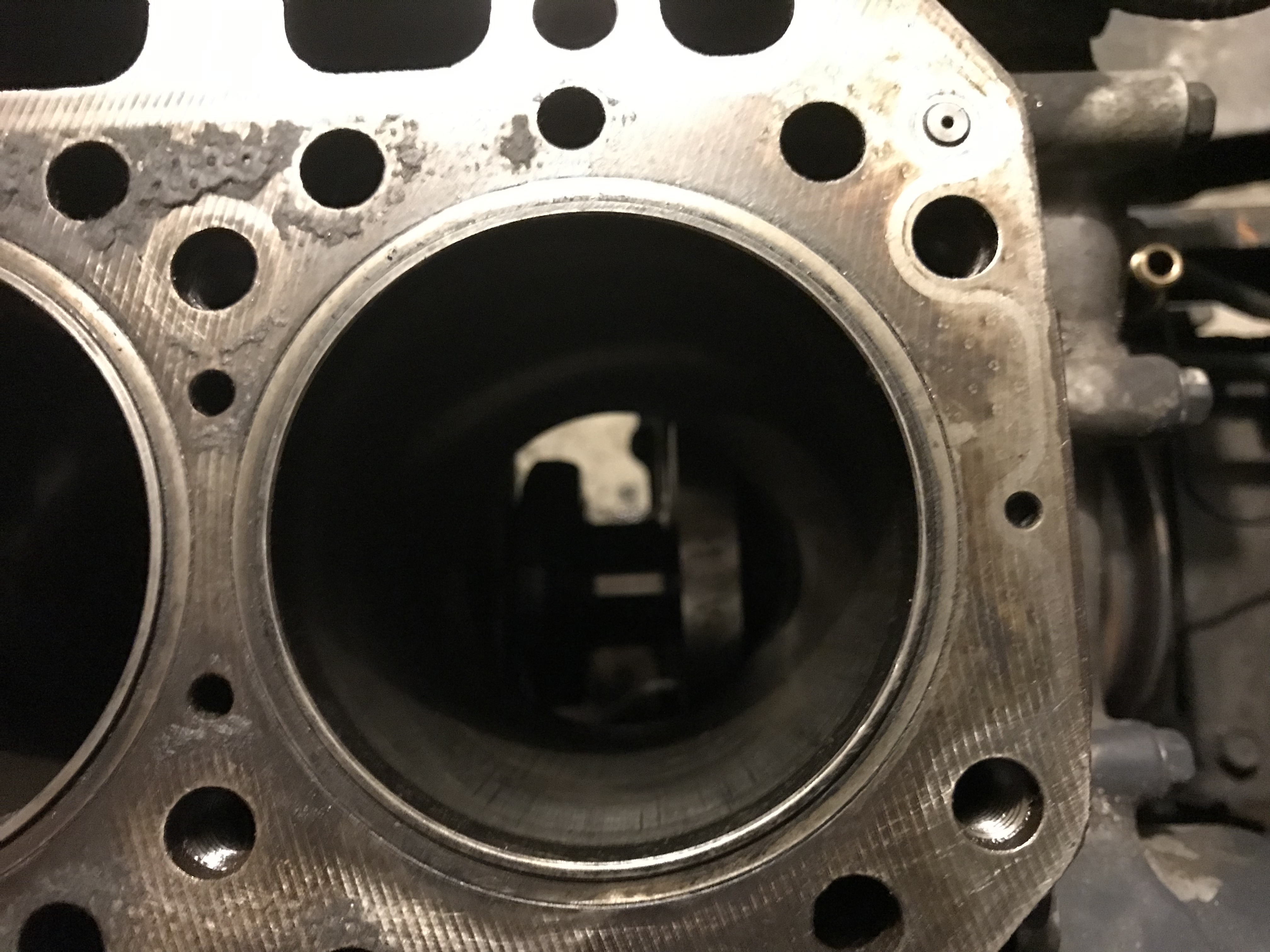

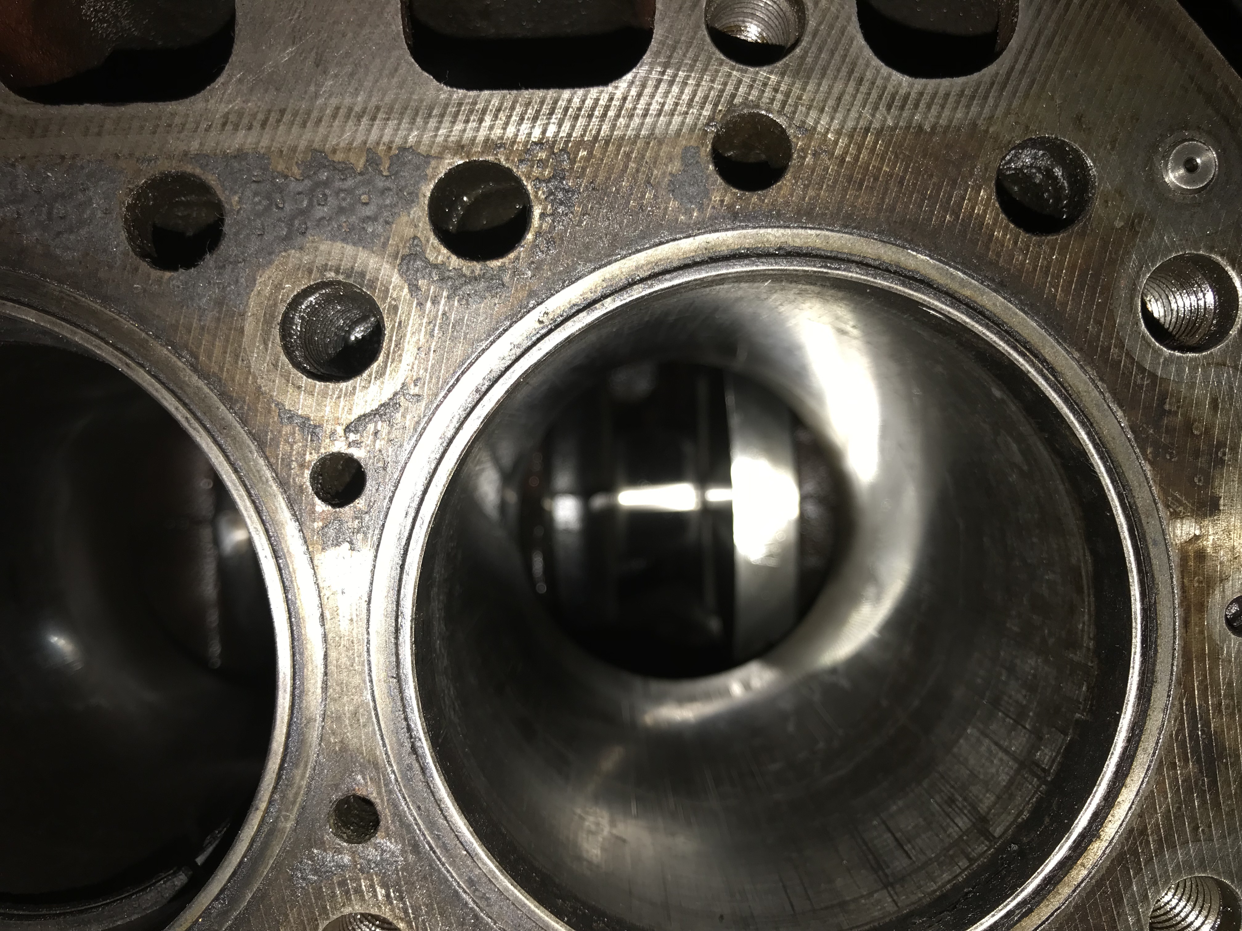

Looking at my block it certainly looks like liners but I have never had an engine this far apart before
0E11ADE7-F13B-4D83-8038-7A78E62CC29D.jpegE12B33E4-794F-4E96-8479-38507E1E2A61.jpeg0E11ADE7-F13B-4D83-8038-7A78E62CC29D.jpegE12B33E4-794F-4E96-8479-38507E1E2A61.jpeg
What are your thoughts do those look like liners??

It looks like liners though. Looks like there is a recess for the liners to go in.

Looking at those pics above they could be liners but I would lean more to it being machined for the head gasket having "fire rings" steel inserts in the gasket to compress into those valleys.

If those are liners the edge of the bottom of the liner is machined and may make it more obvious
looks like liners to me.

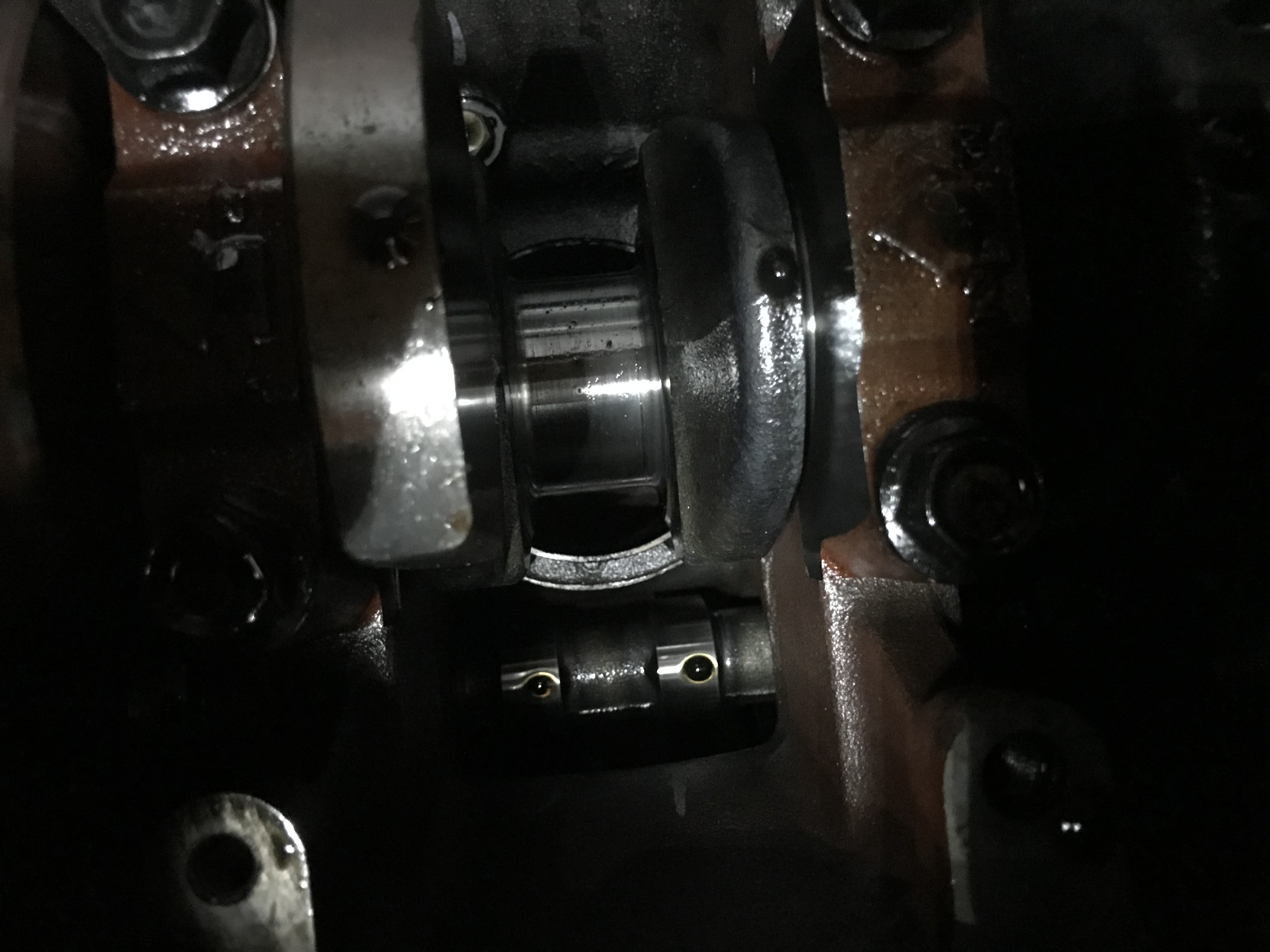

It may help to shoot a couple pics facing UP from under the crankshaft
The liners are machined on the bottom edge to fit into the machined block landing.
a parent block will just end in the castings shape since it just has to be finish bored and then honed.
Hope that makes some sense

although zooming in on #1 and #4 bore things don't look right- hopefully that is just the old head gasket pulled up

I am almost certain they are sleeved.
Not only can I see the sleeve but there are also casting grooves around the diameter which I assume are there to help grab the sleeve and pull it up.
