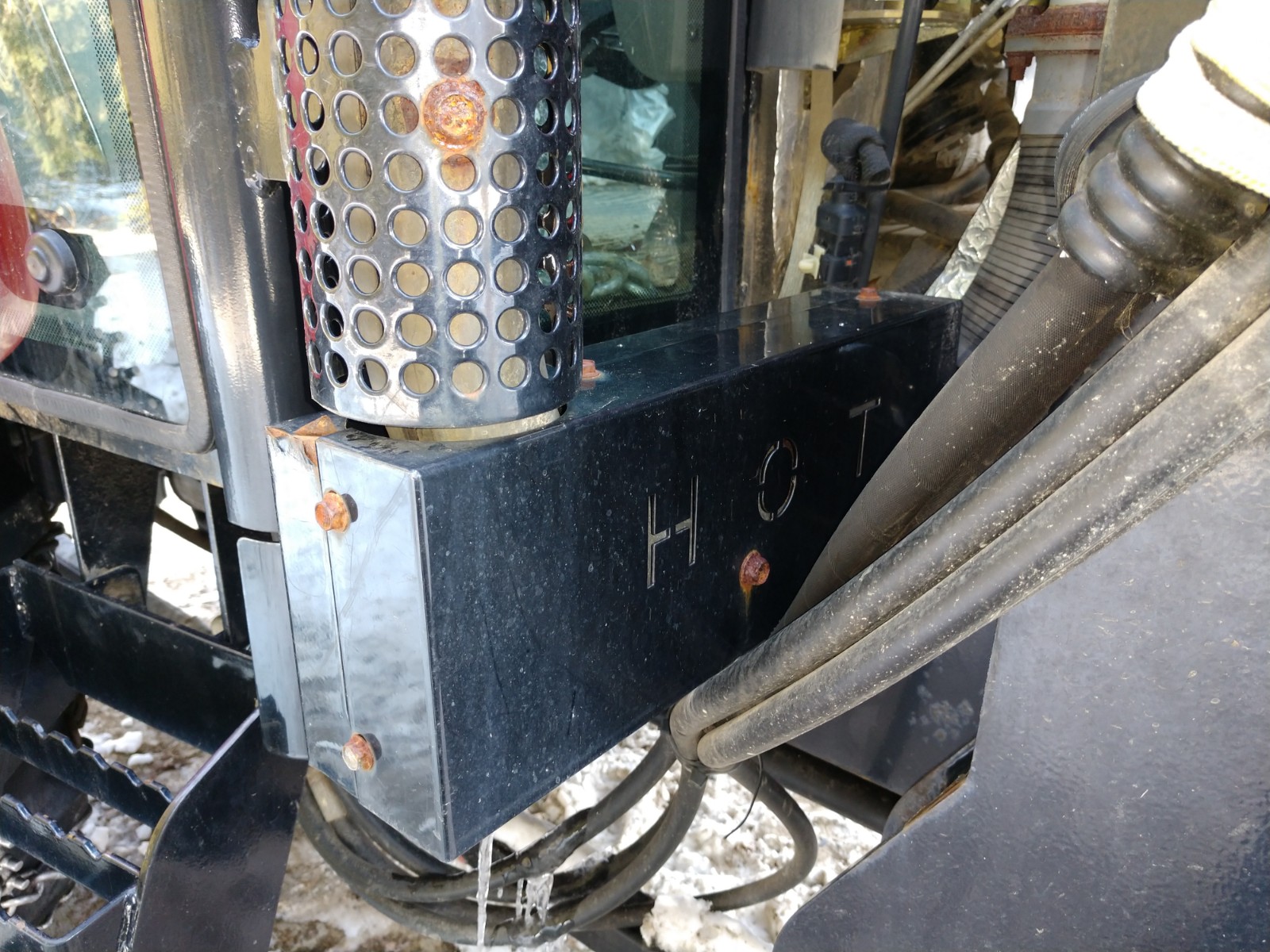

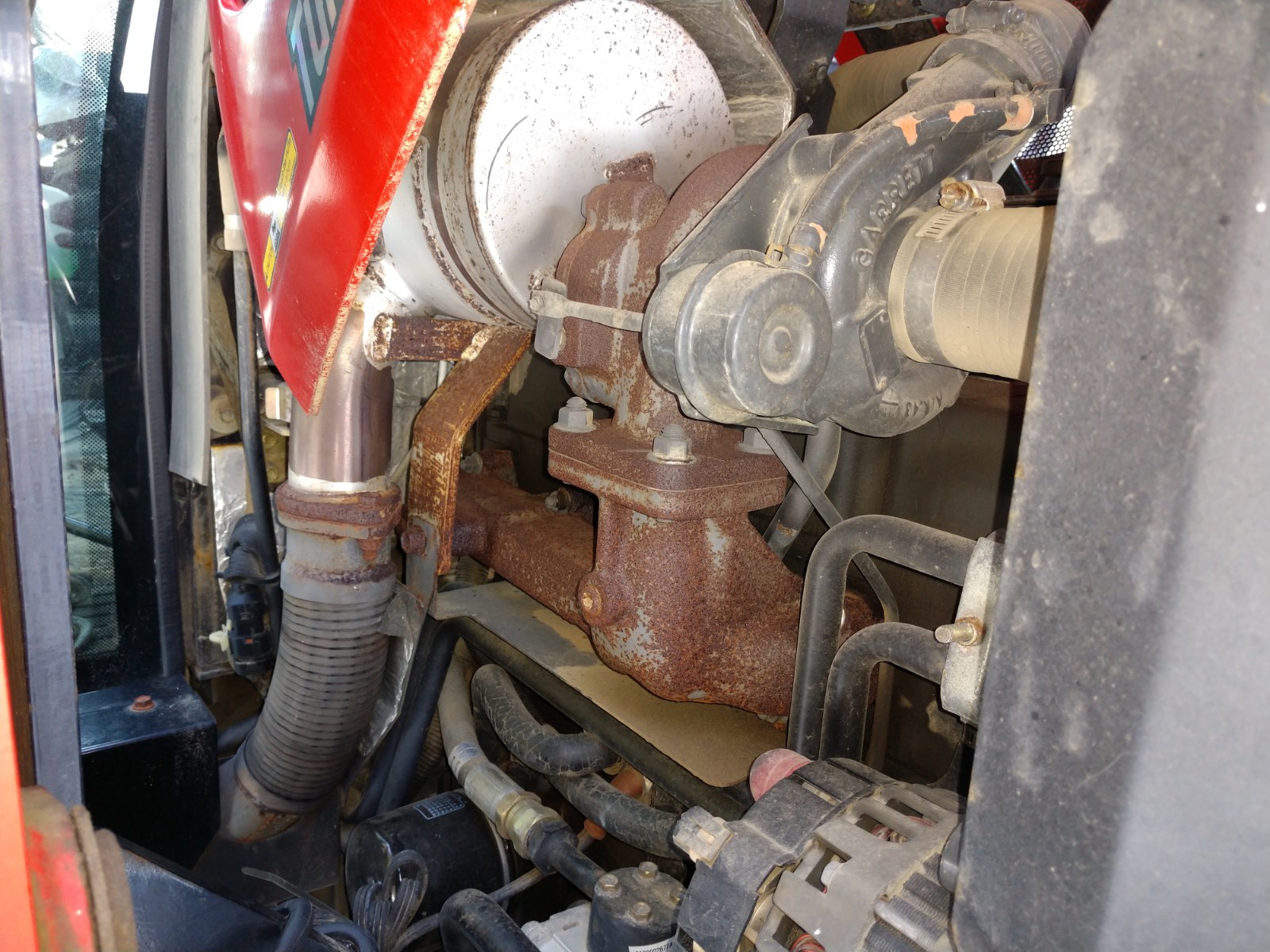

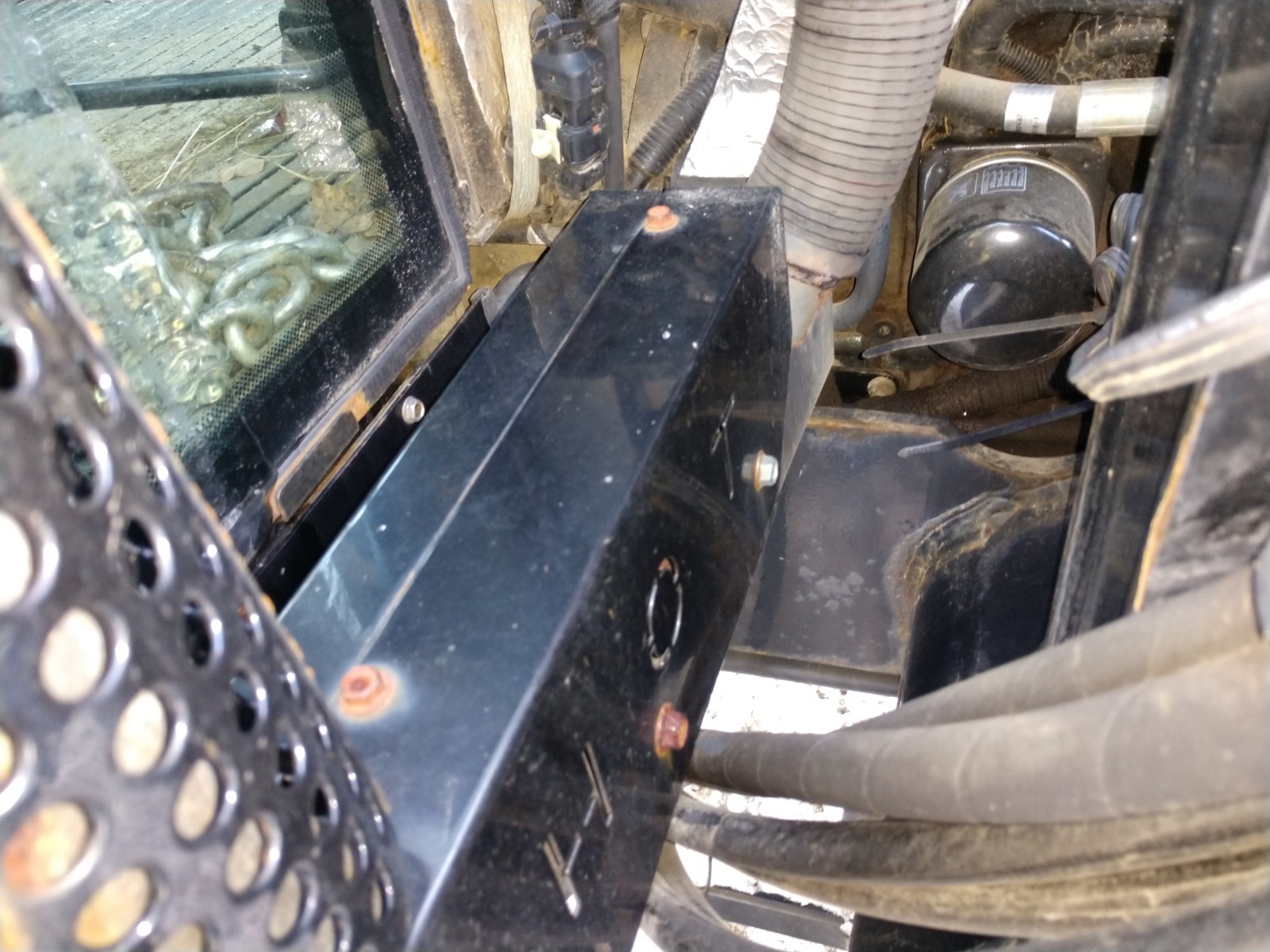

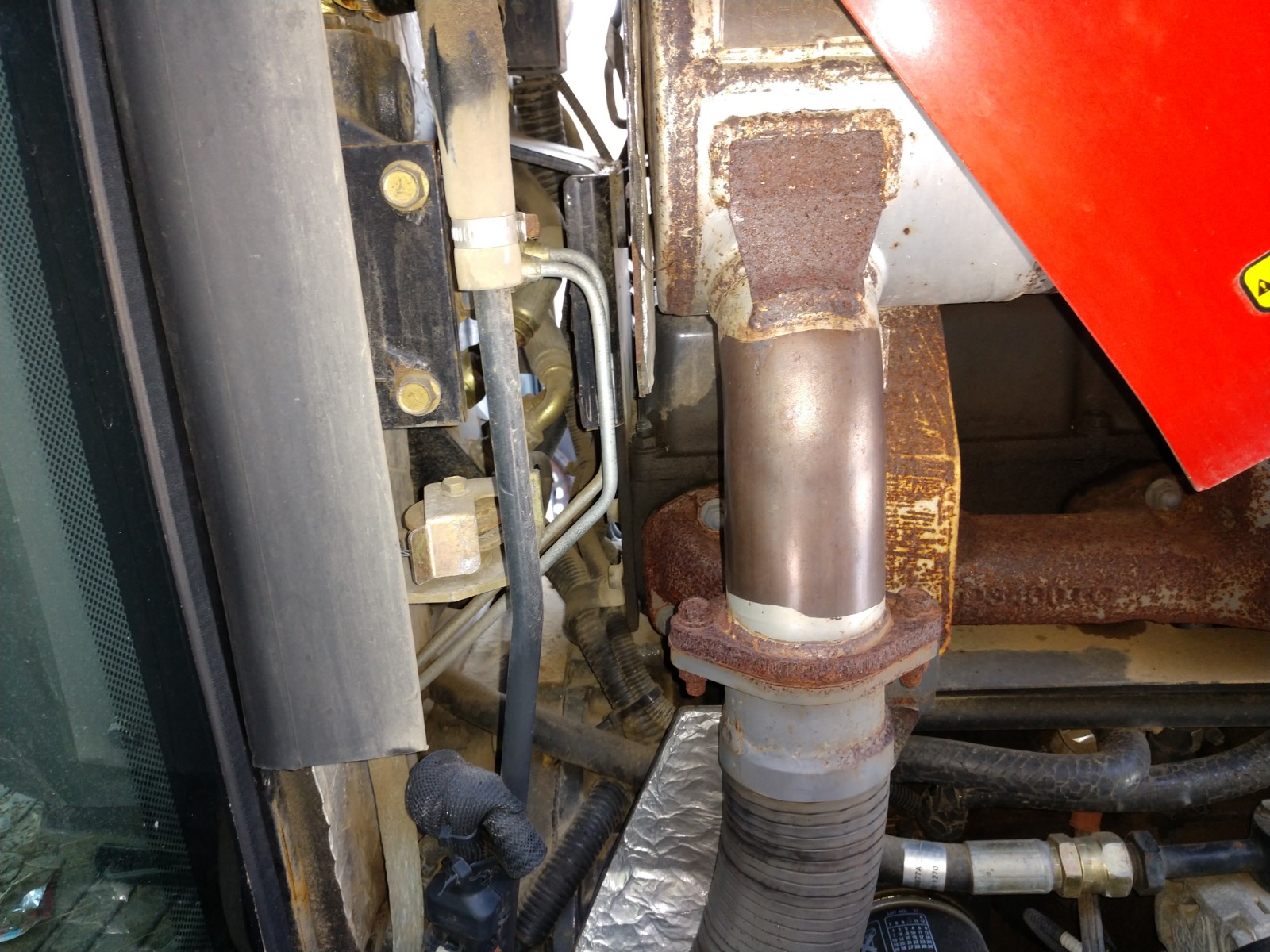

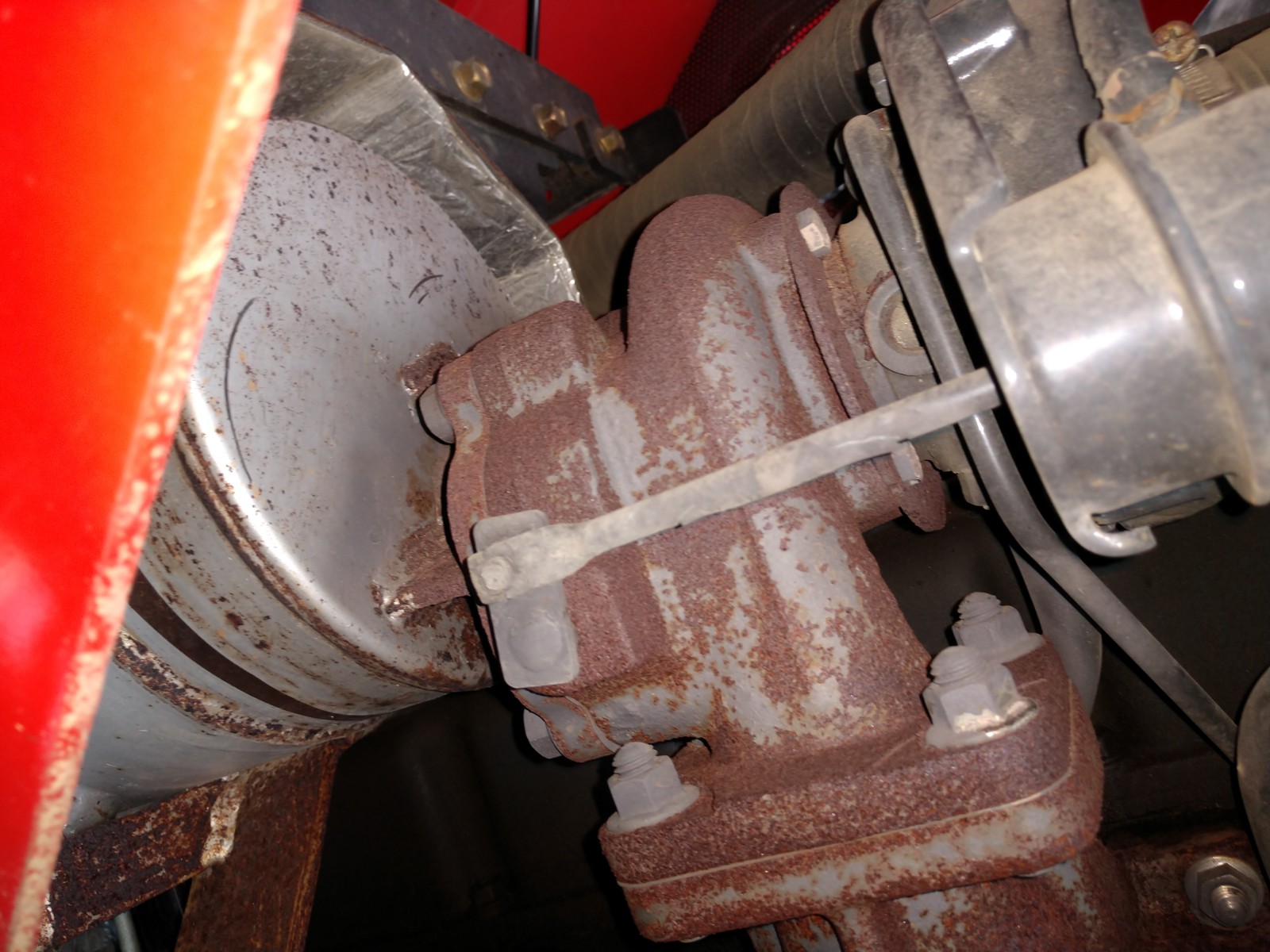

   / branson 4720h cleaning radiator #20
Morning Slim;
Not sure if these will help but here are some pics of my 8050 exhaust which come up the corner of the cab,
They came right off the turbo flange with the muffler,
from the muffler down to a flex,
made a long double 90, then up along the cab with a heat shield.
Lou
