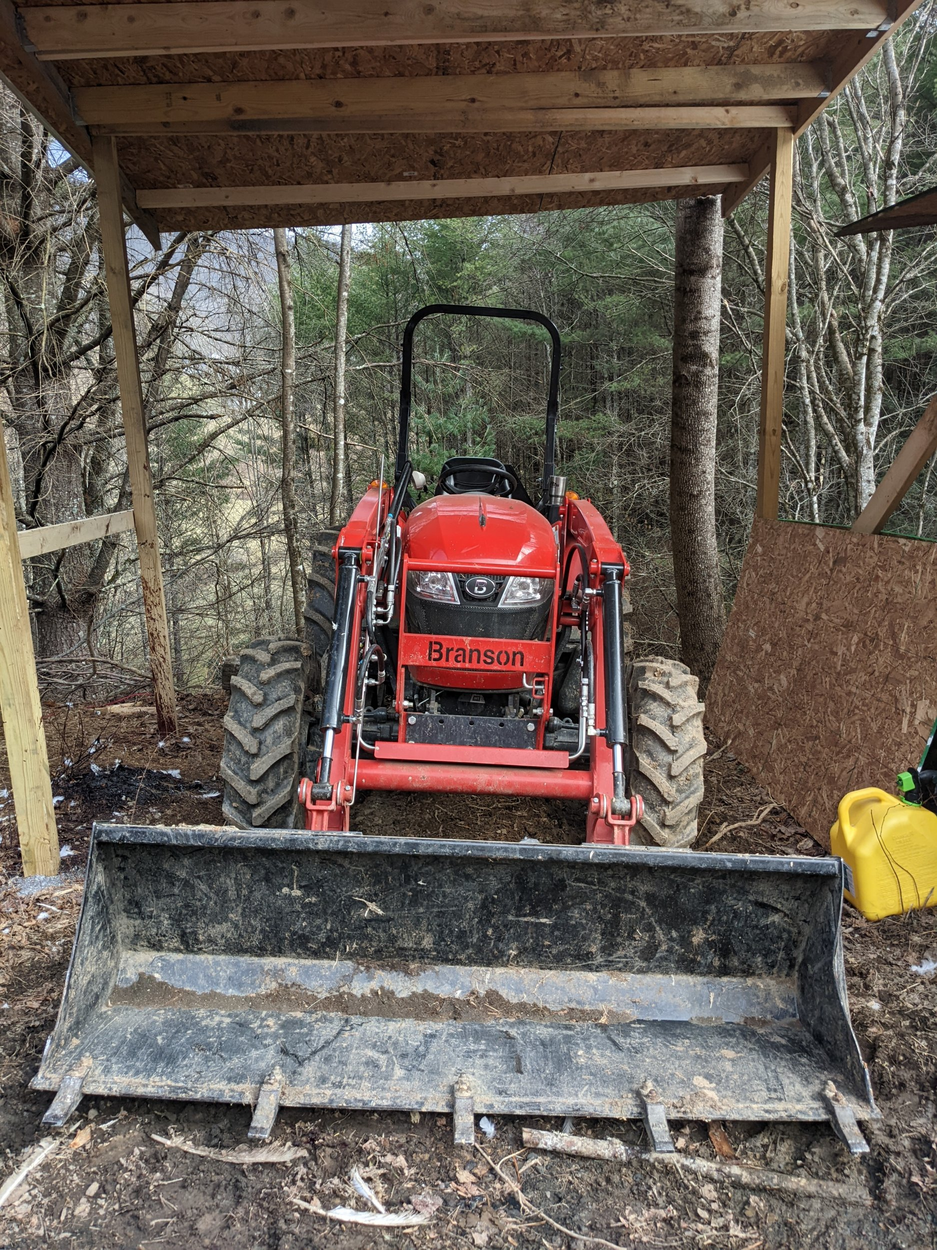

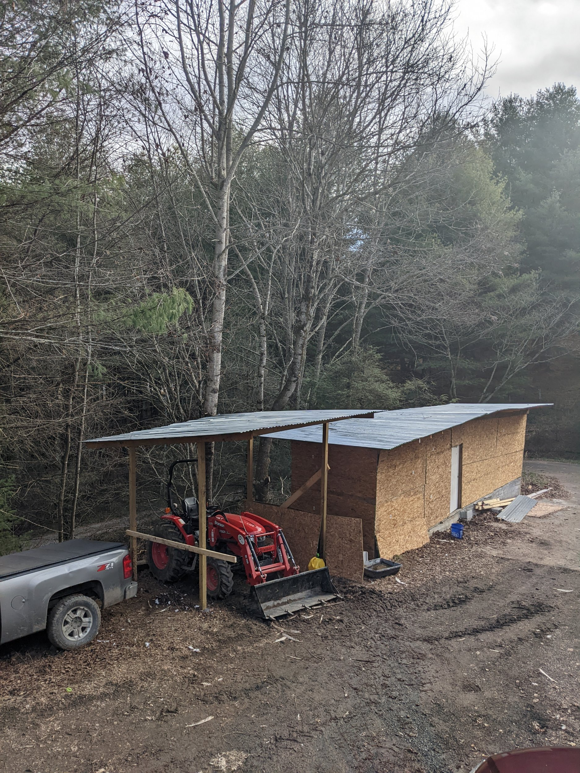

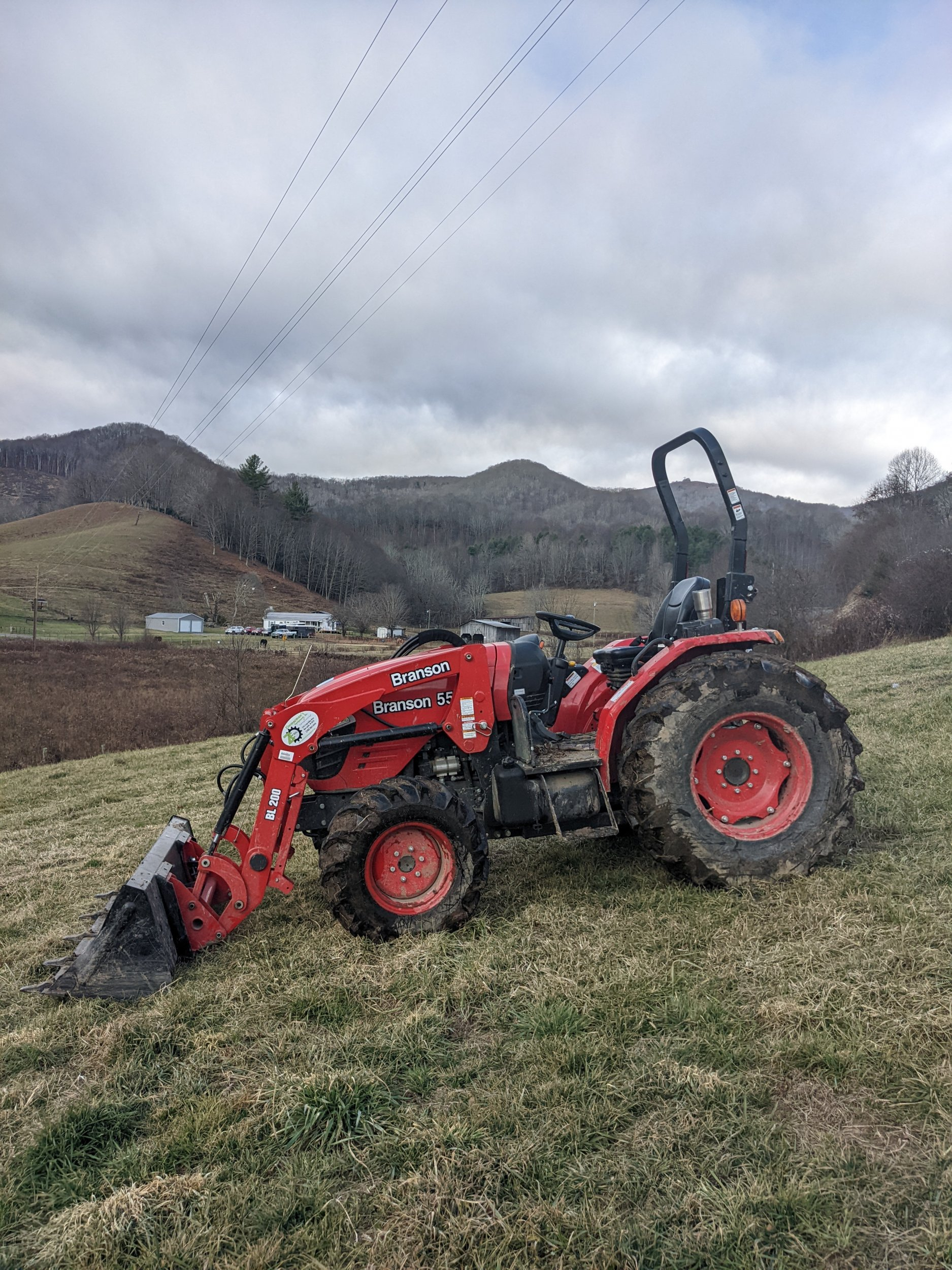

Here's some pics of my 5520H, as requested.
I worked her a lot in the summer and fall with our poultry operation, we raise and butcher close to 1000 poultry a year. I've hung deer and hogs off her too when we need meat.
We only have a few acres, but the grades are as high as 35%, so I needed that 55hp to drag implements and trailers up our hills.
