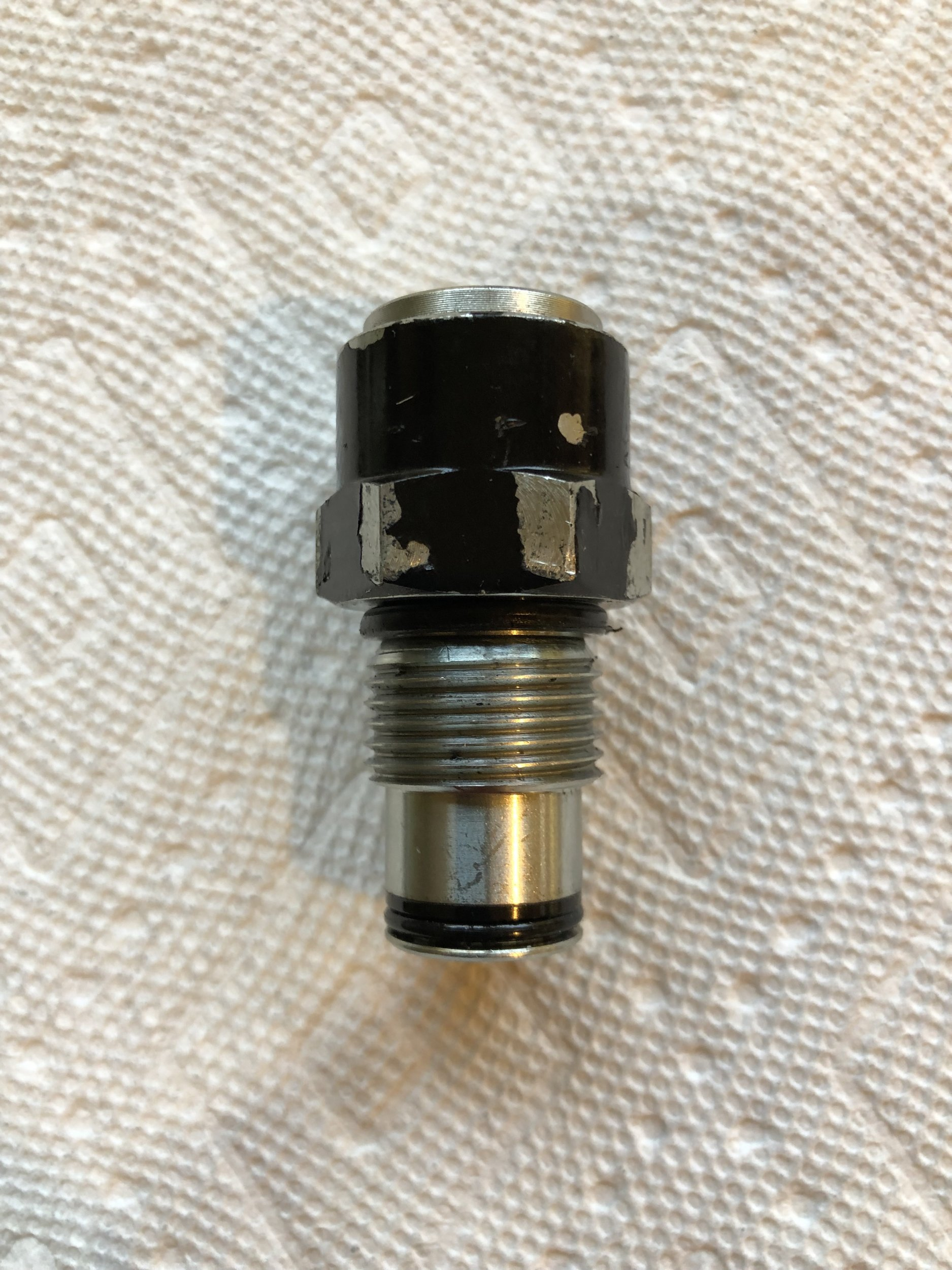

I removed the plug in the photo attached and installed the “regular “ plug. The loader and tractor now work as advertised. I have the pressure gauge on order and will reset the regulator. I greatly appreciate the help. I’ll read up on hydraulic systems to avoid these errors of ignorance going forward.

Great to hear! Save that sleeve! If you ever want to add another valve that will provide an easy way to do it. Getting the correct PB sleeve after the fact can be very challenging.

Yup, save that sleeve and use it for installing rear remotes so you can get a Top'n'tilt kit

You have an OPEN CENTER system. The pump is positive displacement. the output of the pump must flow thru the system constantly, from the pump back to the reservoir. When you move the valve the oil is simply directed to the cylinder or motor that the hoses go to. The returning oil from the cylinder is sent back to the reservoir.
An open center system MUST have a relief valve, if it does not or is set too high---Somethings going to break, a hose, the pump, the pump drive, the cylinder, or even the valve.
The control valve usually can be configured many ways. One way is as your valve is hooked up. That fitting you took out is what is called power beyond it is used to send oil to another valve such as a backhoe.
The pump does not create pressure, the load or restriction does, the pump only moves oil.
The valve "tells" the oil which way to go.
The cylinder or motor does the work.
It is all connected to together by hoses.
In a hydraulic system the pressure is the same throughout the system. If it takes 2500PSI to lift the load it will be the same at the outlet of the pump to the cylinder doing the lifting
