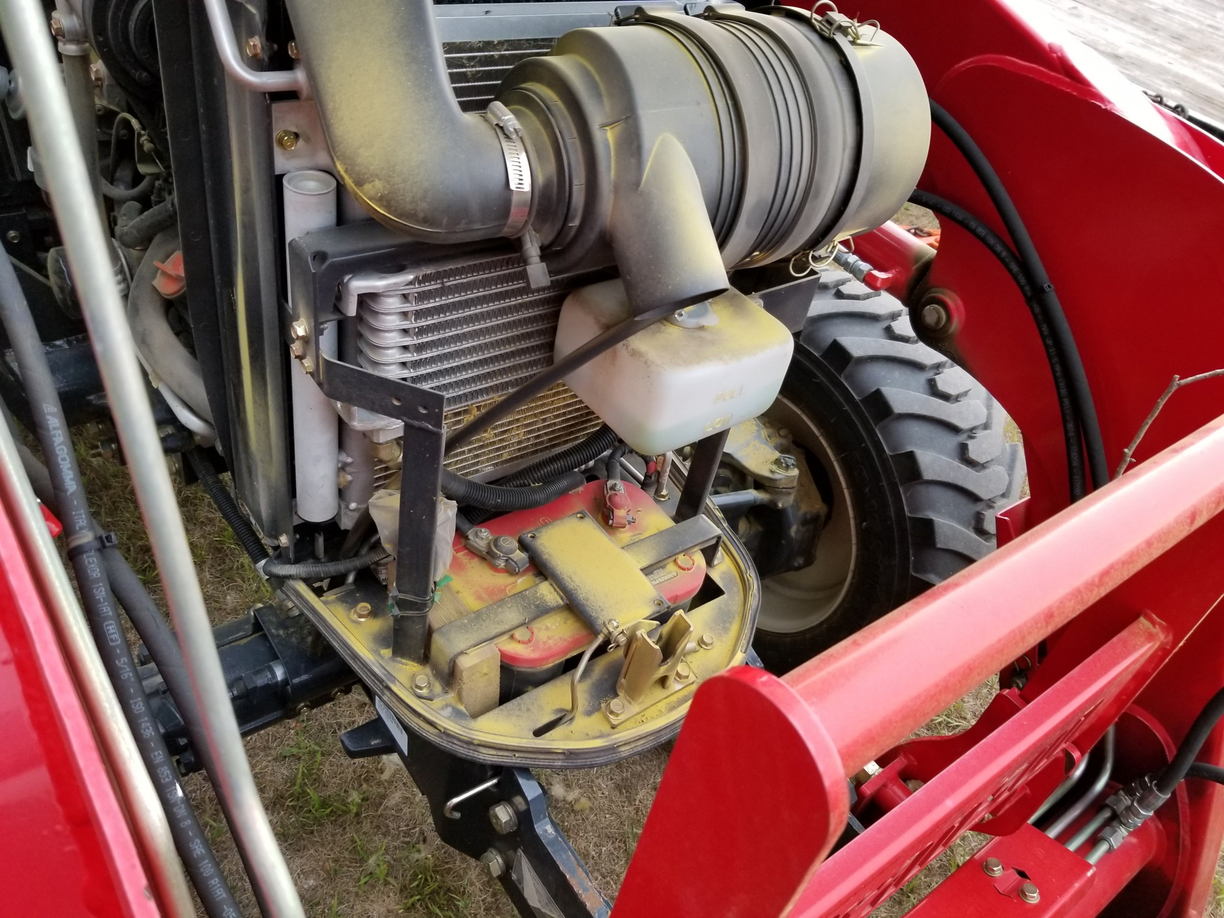

Just want to throw out there that after mowing and using my cabbed tractor with A/C, you really have to blow out your radiator and coolers every time you mow.
And if you're mowing all day, or several days in a row, you should plan on stopping a couple of times a day and blow everything out. Any new tractor I look at has a "modern" radiator and coolers, which means the rows and fins are *much* tighter spacing than tractors of yesteryear. They will absolutely fill in with chaff as you mow.
This was after only a couple of hours of mowing (and it started off clean).
When I mowed at home, I would pull up to the shop and use my big shop compressor and a handy air wand. When I'm mowing out at a remote site, I take along a pancake compressor and generator. The little pancake takes longer, as it can't keep up with the air demand from the wand, but it has to be done. Else wise you have overheating issues that can pop a radiator and cause your A/C to blow warm/hot due to poor heat exchange.

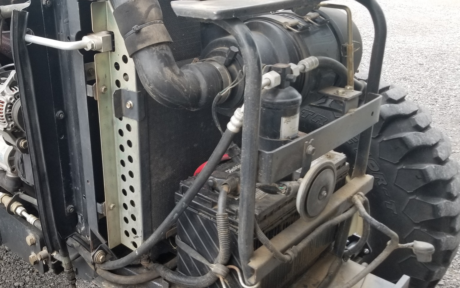

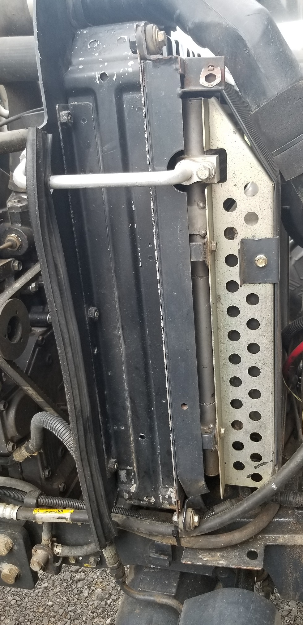

Hi Slim, I wish my tractor had the access yours does. For one to even get the front grill off, you have to remove the metal grill guard first, as you cannot lift the grill up, but have to remove it forward. Second, your battery is dropped down into a box, where the 6530C has it on a plate at the same level as the bottom of the rads. and then everything i behind screens. I will post a photo of this once the tractor is back home. It is to be looked at today to see if the AC system has any leaks.

Here are some images of the front of my unit, and you can see that it is not at all easy to get to any part of the system to clean, not without doing a fair amount of disassembly.
I will also have to watch the relays and fuse to see if they act up again.

Slim, is that yellowish stuff pollen or is it just dust?
That was all pollen. There were some seeds clinging to the lower area of the condenser, and a bunch of seeds clinging to the outside of the grill, but those blow out easily.
