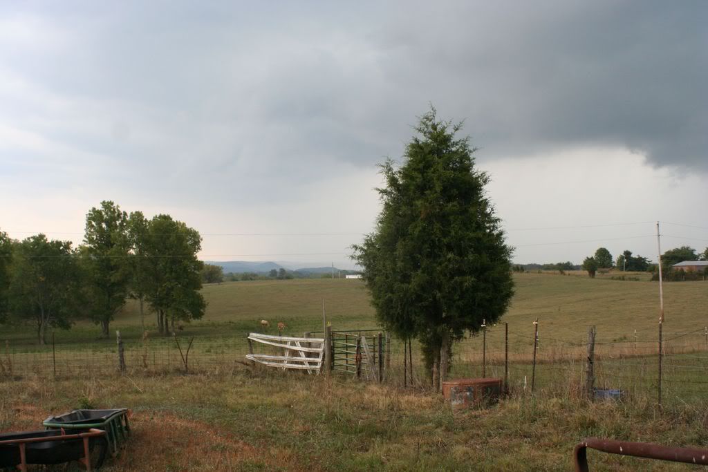

I decided I didn't like that set up, and there was the whole extension cord out in the elements issue. So, I cut out about 16 feet of the fence. Here's a picture of the pen beside the barn, the field where we graze in on the other side of the fence.
I had dropped that tank right in the ground on the other side of the fence there so the cattle could get it. But today, I took out that corner section and brought the tank up right next to the barn. The tank will be on top of the ground so I can deal with it if need be, and the cord for the heater will be under the roof of the barn, so no worries about keeping it dry. Not sure why I didn't do this before other than not wanting to just cut out a section of fence. The FEL came in handy there too with those teeth. I cut the wires on each end then used the FEL to grab the whole thing and rip it out!!! That was so much fun, then dumped it over into another pen where I'll deal with it later. It is so cool to have that FEL to do stuff like that. My tractor's never been that muddy before either. I was sliding all over the place in all the mud made by that leak. That's another reason I didn't get pictures, I was covered in mud too. My wife would have killed me if I'd mucked up her camera.
