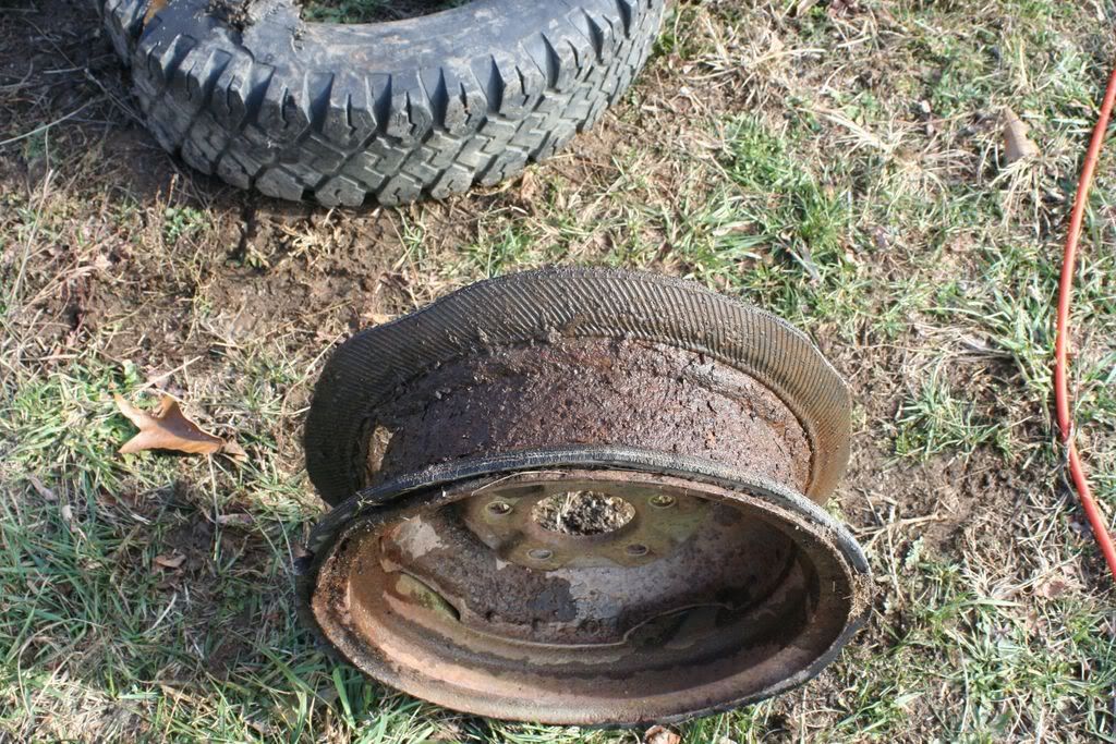

For those interested, a sawsall, is truly a sawsALL. It works on tires for sure. I finally got rid of all of the other tires not on rims, so I had to get back to working on those two on rims. After another feeble attempt at breaking it free from the rim, I gave up and got out the saw. I cut across it thinking I'd be able to just peel it right off. Wrong. That sucker was fused! So.... plan B. I just sliced the outter section off on both sides. :)
You can see the two rips on either side of the first cut I made where the FEL teeth punctured the tired. That was a bunch of pressure and the tire wouldn't release.
And the rim with remnant.
I'm convinced that thing never would have come off.

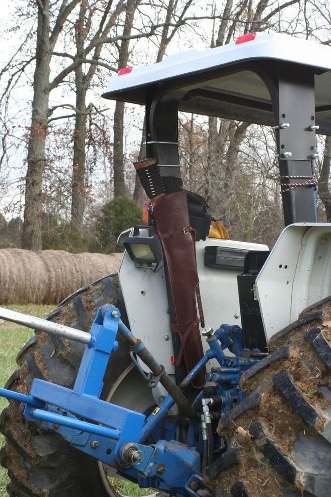

:D Just got it in. Works great. It wouldn't fit on my FEL arm, so I went for the ROPS. Thanks for the links. That's a Marlin 30-30 with a scope. It's a bit tight, but it was 29° out there and the leather was really hard. I'm hoping once it get's broken in it will be easier in and out.

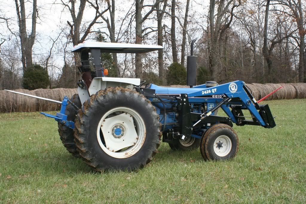

So back to the tractor stuff. Here's my tractor loaded down, with the iron, the filled 18.4X34's, and two big bales it's got to top 10,000 lbs. That is just cool. :cool: :D

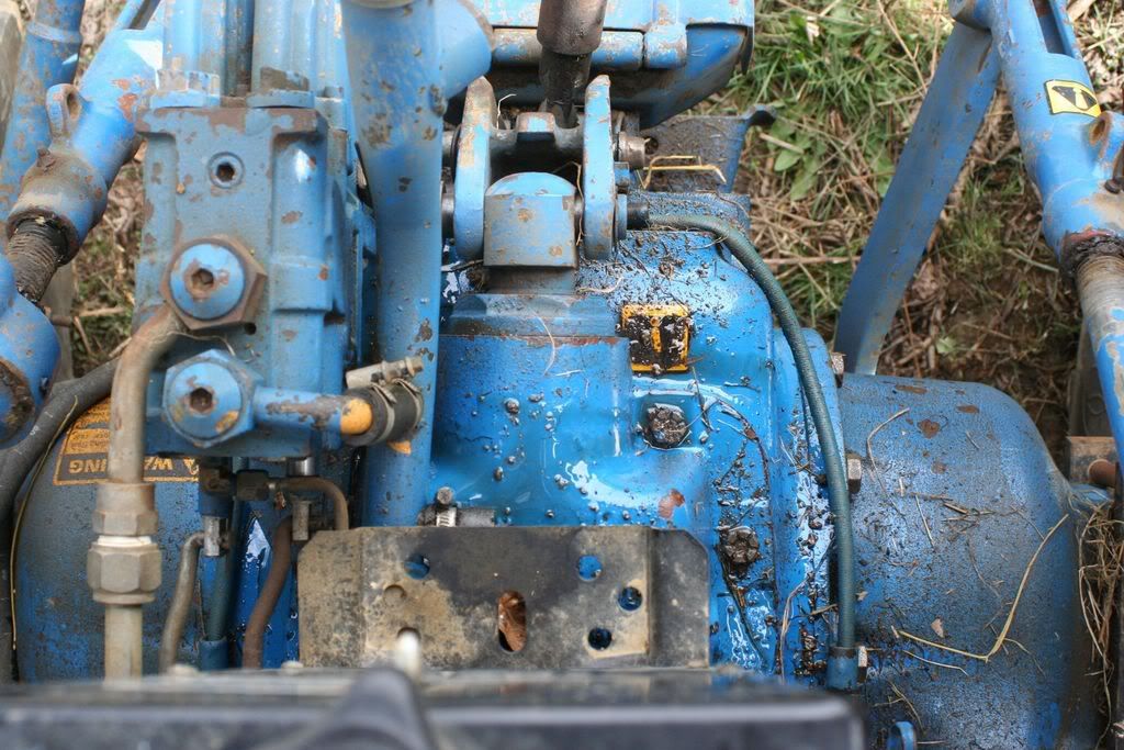

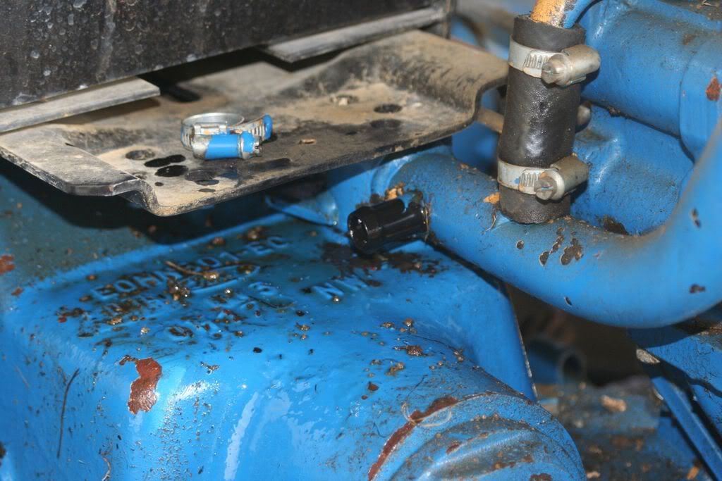

Happy cattle... :D ...sad tractor. :( I noticed while getting the hay that I was having an increasingly harder time steering. I'd mentioned this before here at low rev's I have a hard time turning. This time it was really hard though. I peered back over the seat at the hydraulics and saw this:

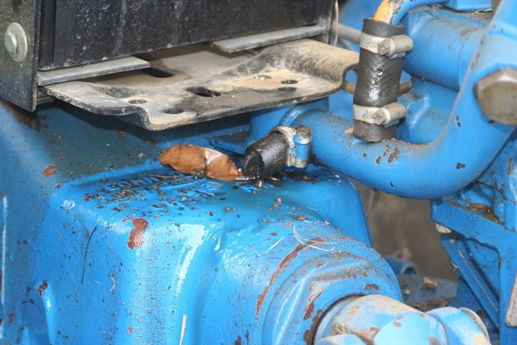

There was hydraulic oil everywhere. Not sure how well you can see it in that picture, but it was bad. Further investigation found this:

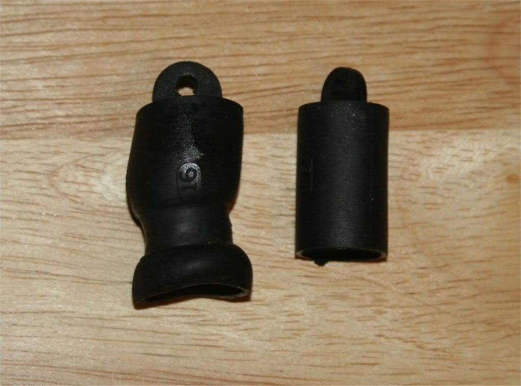

There was some kind of rubber boot covering an opening in the hydraulic tube thing (don't know the official names, sure someone will help me out there). There was a steady drip, and when I touched it oil spewed out fast. You can see it dripping in that picture. I drove on up to the barn and took the boot off. Here's the opening, not sure what this is for other than to spring a leak:
And sure enough there was a tear in this boot:
That pretty much shut me down tractor-wise for the rest of the day. I grabbed a chain saw and went out to the pond. I cut down about 30 trees including 6 large sycamore's. That was fun! I don't have pictures because I left the camera on the tractor, but I'll get some shots when I start cleaning up the mess, and I'm definitely using the tractor for that! :D
On my way home I stopped and got more hydraulic fluid and a new boot. Can you believe these are the same part? I guess 16 years of hydraulic oil can swell this rubber a bit:
Now for a question. I thought my tractor had a seperate pump for the steering (1991 Ford 6610 II). Is there any way that hydraulic leak would affect the steering? If they used the same oil then it's obvious, I think, but I fear that I'm going to replace the boot and oil and it still won't steer. :eek:
Thoughts???

My 7710 gets hard to steer when the power steering fluid gets low, and I don't have a FEL (yet). Still waiting on that call from KY, lol.
