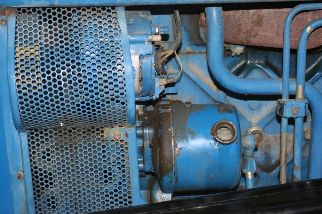

Second, sure enough the power steering and the hydrualic fluid for the lifts are two seperate systems. The manual directed me to the PS pump. It was dry, NOT low, dry! :eek: Of course the dealer told me they checked out all my fluids when they put the FEL on. They must have done it since the charged me for that, right? :mad: Anyway, I filled up the pump to the bottom of the inlet hole, then cranked her up, rolled the wheel back and forth a couple of times, then shut her off. Figured that fluid would have to fill the lines and such and I would need to add more. It actually hissed when I shut off the engine and when I opened it the fluid was really foamy. I guess it did that trying to pump that oil around and displace all the air.
You can see the foam in that picture. I repeated this a couple of times, took more than a quart to get rid of the foam and maintain the fluid level. Steers very smooth again now. Guess I'll have to check around for leaks. I could watch the dirt under the tractor for oil.... but.....

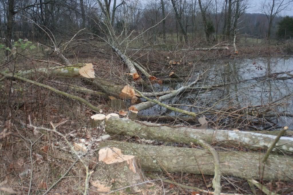

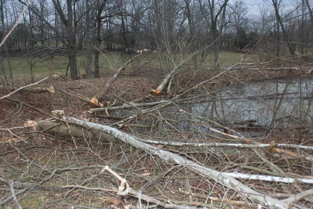

This was an NRCS pond, so it's built to spec. Here you can see the spillway on the left side of the dam, the low spot with the big stump in it:
Here I'm standing in the spill way, a good view of the trees I'd dropped.
Not sure if the scale comes across in the pictures, I should have put my saw on the stump there. I have an 18" bar and had to work around that first one there to get the wedge cut out and the back cut, so it was wider than 18" and very tall. There had to have been 20 or more good size trees, and another 30 smaller ones I cut. Also, when I cut them last week the water was about 5 or 6 FEET lower. There would not have been any water in those shots had I taken them when I cut the trees. So much for the drought, huh? I never would have dreamed that pond would fill up that fast or I wouldn't have left so many trees in the path of the water. I'll get 'em out though, just gonna get muddy doing it now.

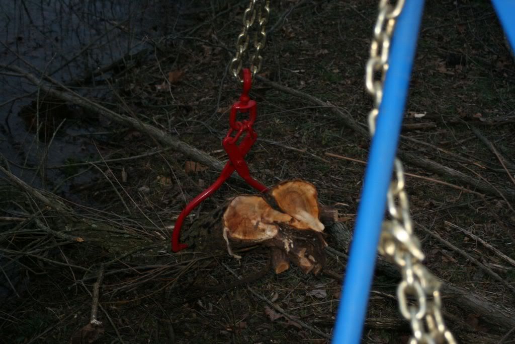

On to the real fun, getting the trees off the dam. Here's the new toy I bought for $25 in G-berg. Skidding tongs. :)

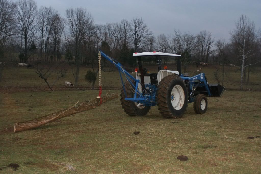

I used a log chain to attach it to my boom pole. By the way, that's a TSC boom pole, but not the one they advertise. It's a CAT 2 heavy duty one, 2,000 loading. Of course I had to alter one part of it, it wasn't blue. :D
That thing worked like a charm. Most of the time I could lower it from the seat and get it to bite into the logs. I usually had to get off the tractor to release the logs, but it was still way faster than wrapping a chain every time. Here's some shots with the only log that I had to cut the limbs off of:
That was a locust that was leaning about 45° across the fence, so on my first trip out I had the carryall on the 3ph, I raised it up so I could stand on it and cut the limbs off that were hanging across the fence. They dropped harmlessly to the ground, not destroying my fence. :) I then trimmed off as many as I could and finally cut the tree down in two sections. I was glad to get that sucker off the fence line.
