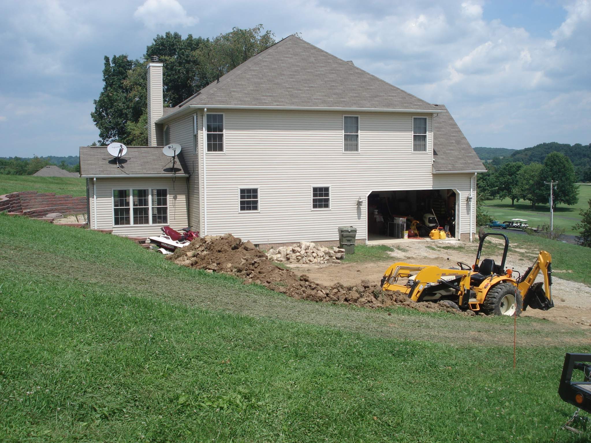

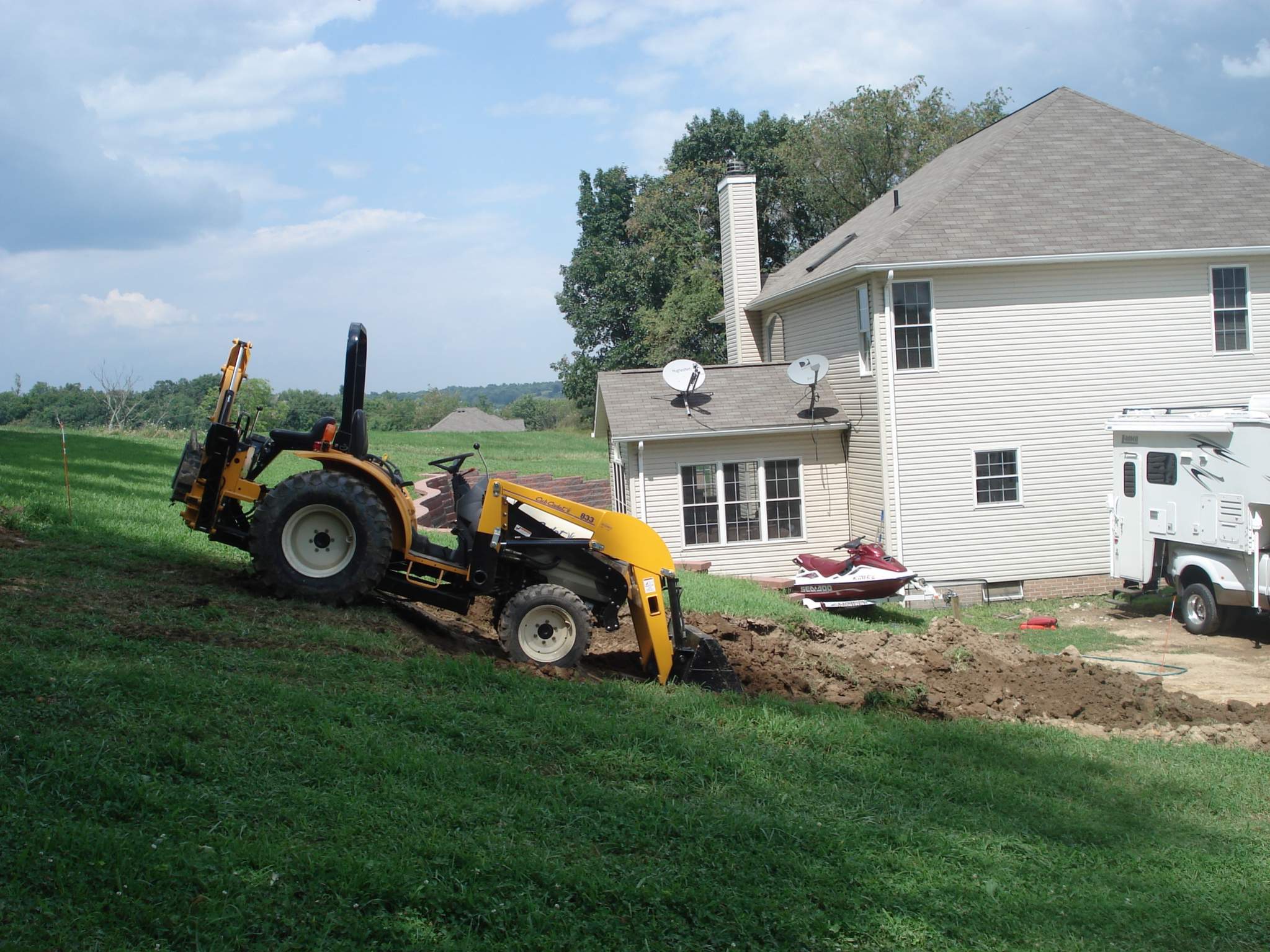

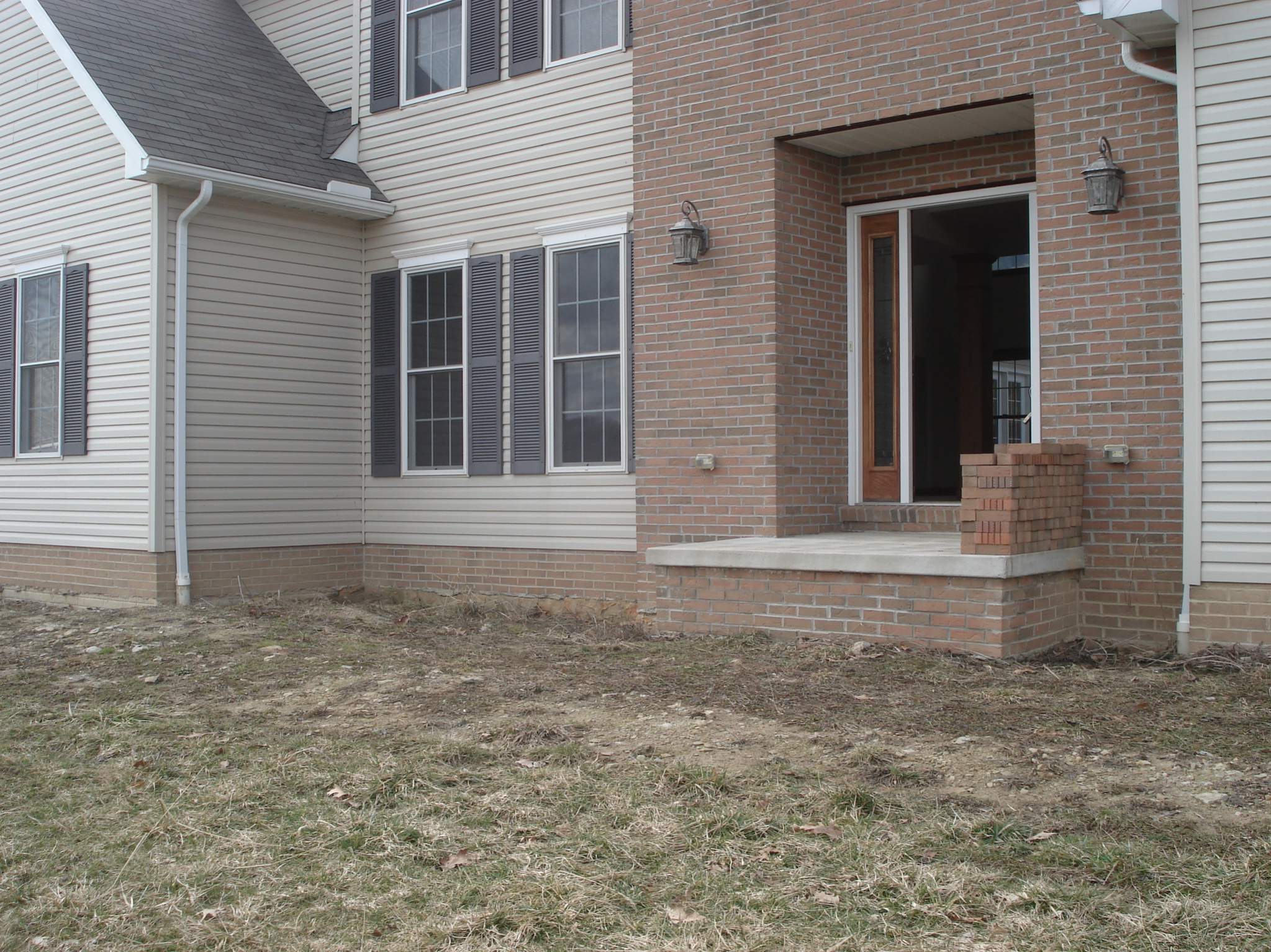

Well, finally my first project on TBN!

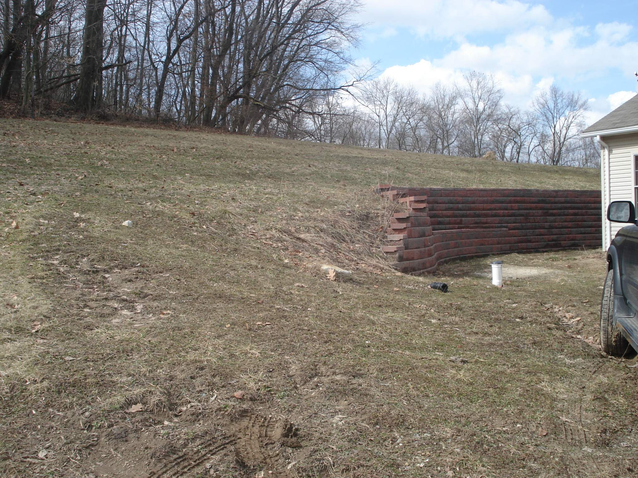

We just recently bought a house in NE Ohio, and the garage was woefully small....not to mention my 06 F350 KR has been sitting outside for the last 4 years.....so I picked a spot on the 1.4 acres that was (I think and hope) the best spot to put up a 30X32 garage. Now I'm certainly not construction smart as many folks on here, but I'm learning all I can as I go along and between myself and the block layer, we are sharing the duties of GC, and I'm trying to do all I can myself to cut costs. Doing it on a cash basis, and already sold one toy (camper - pictured later) to help fund it. I'll try to segment the pics leading thru the stages already completed....

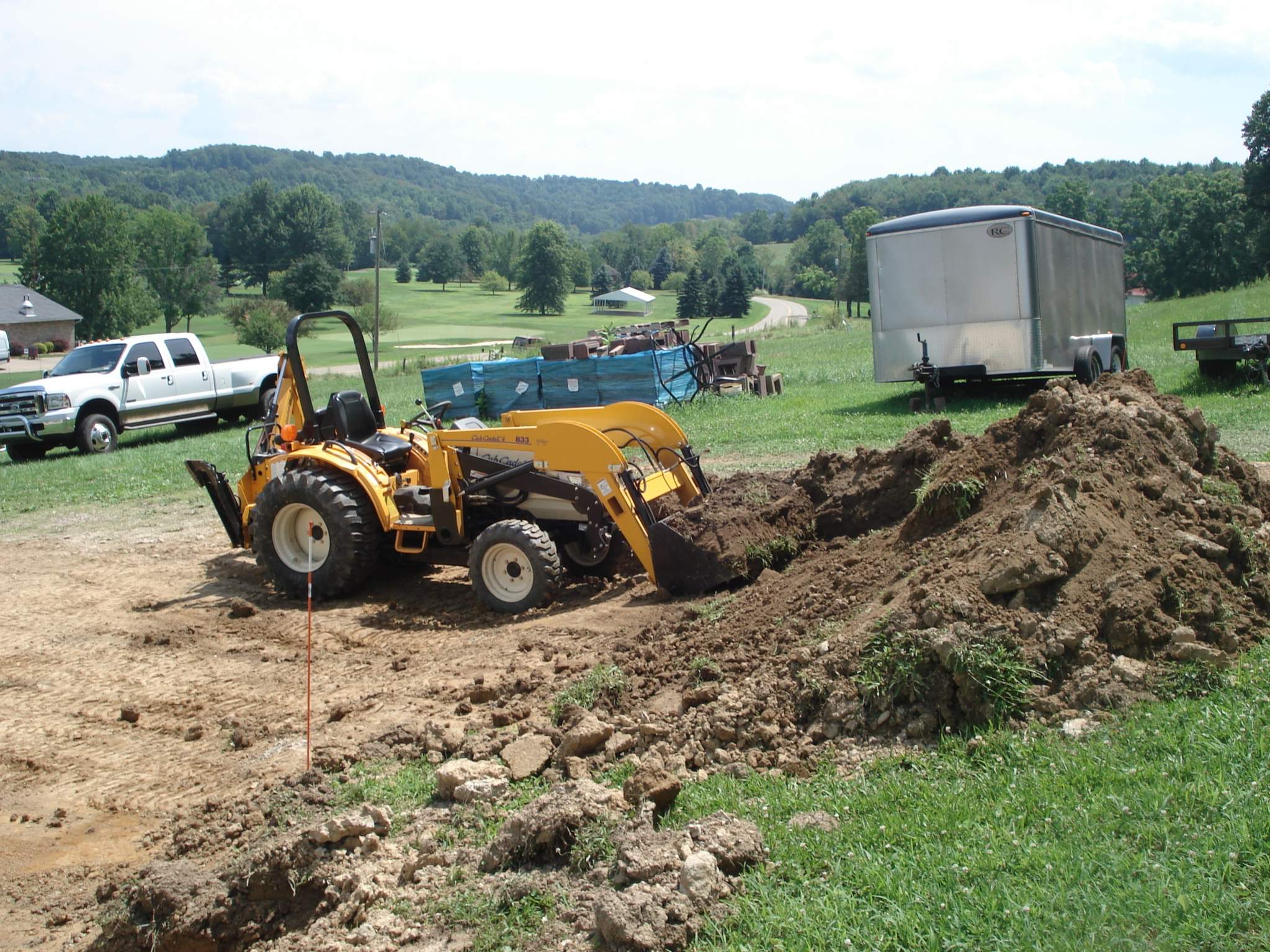

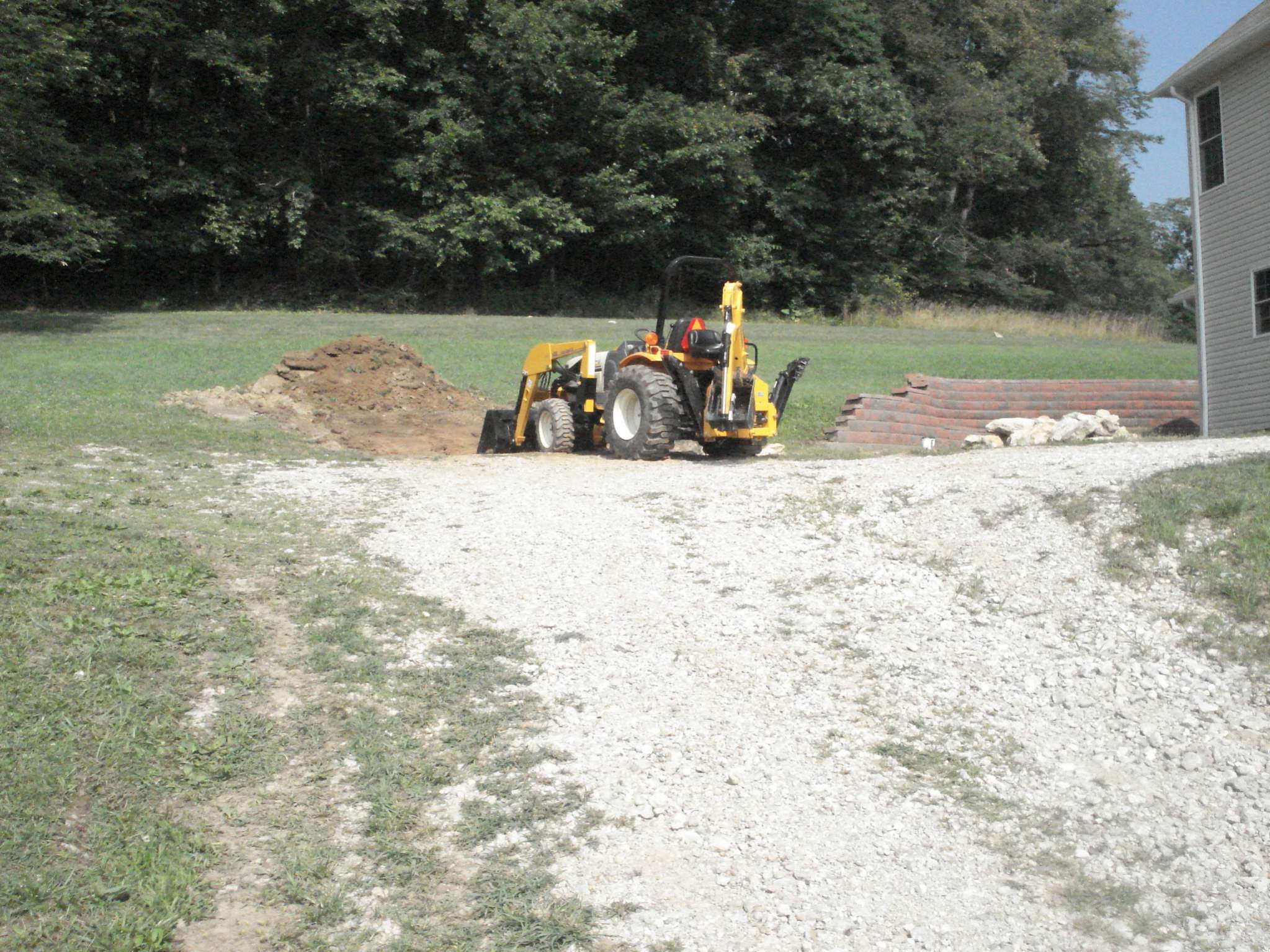

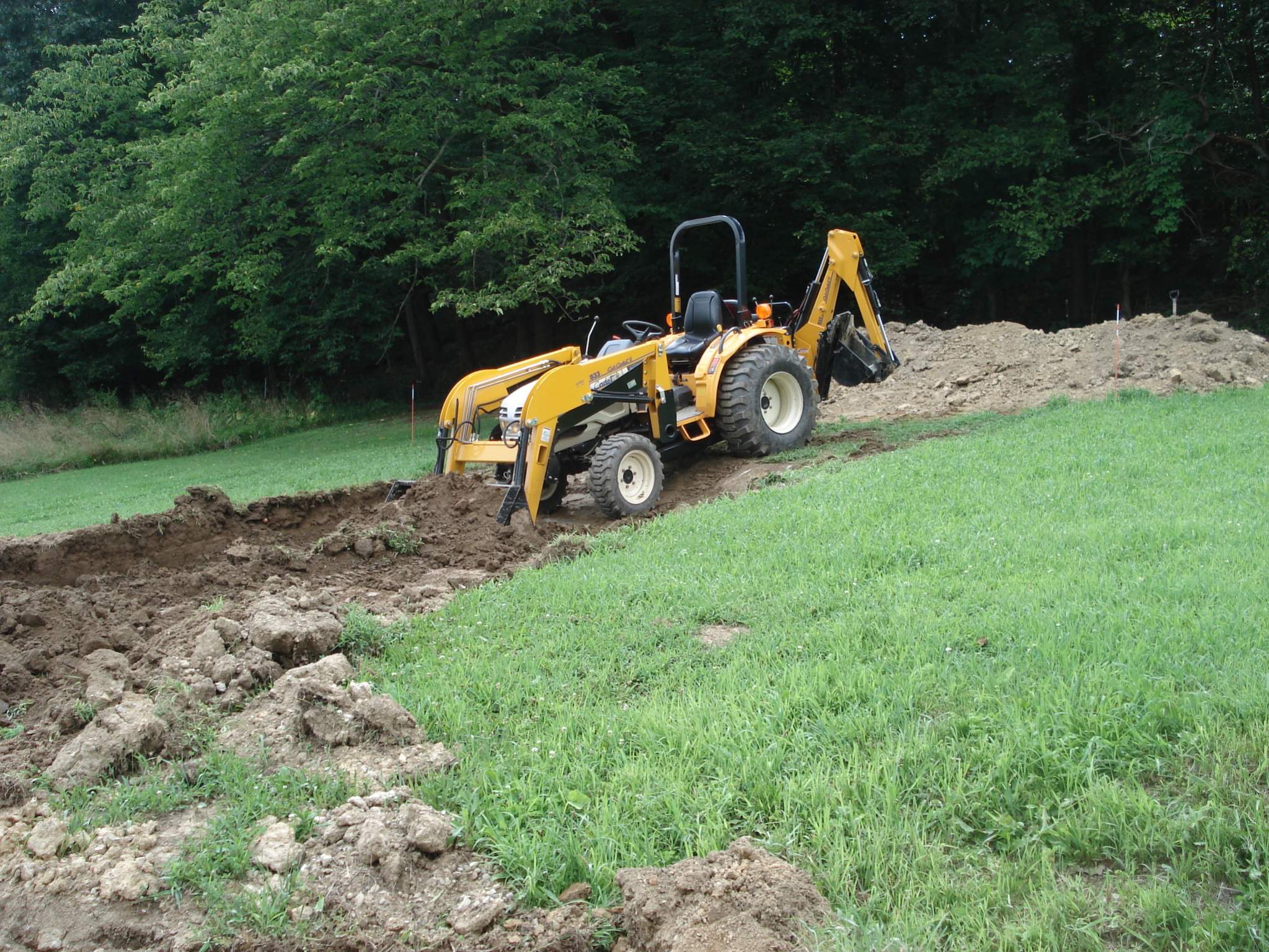

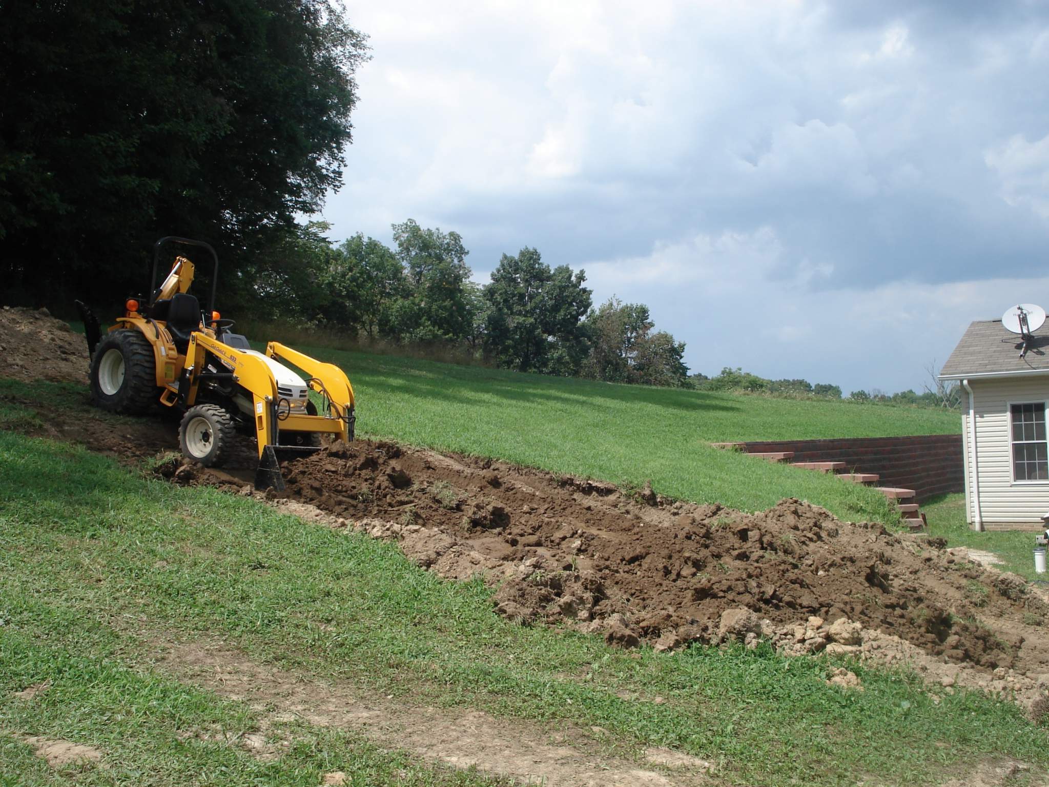

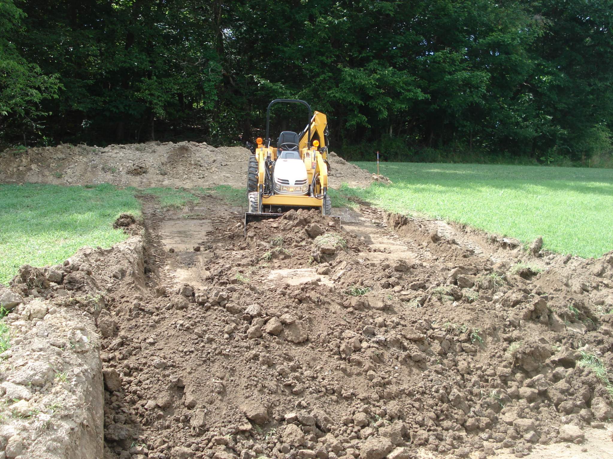

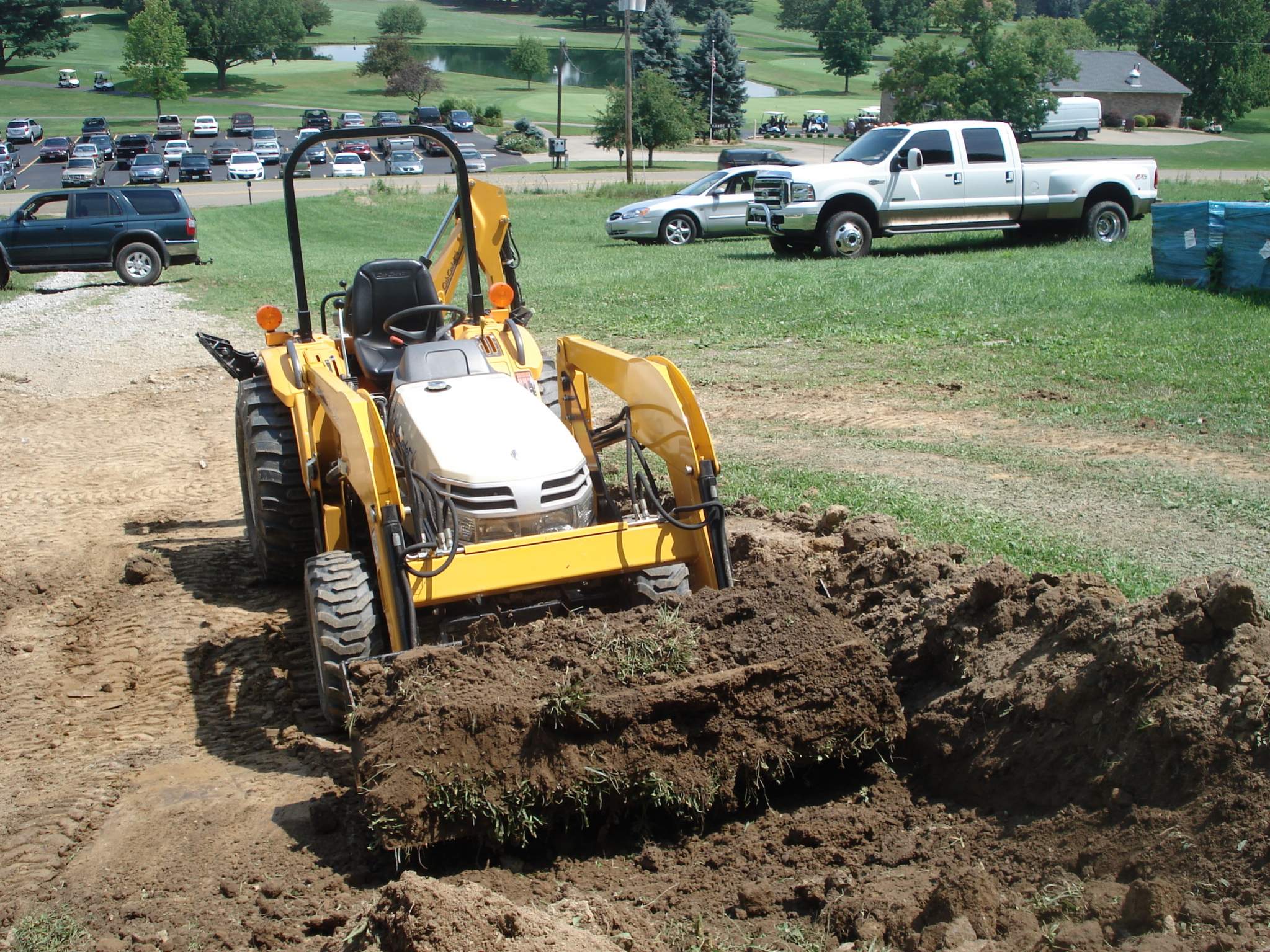

The bank is deceiving, it's over 10' high at the back of it. This is why I chose all block construction, with 12" at the back. My tractor did a great job digging, especially for 90% clay. I wanted to get a toothbar, but never had a chance to do it. I don't know how many yards of dirt, and I lost count of the dump truck loads that went out.....somewhere around 70 or 80 loads, with 3 different size trucks.

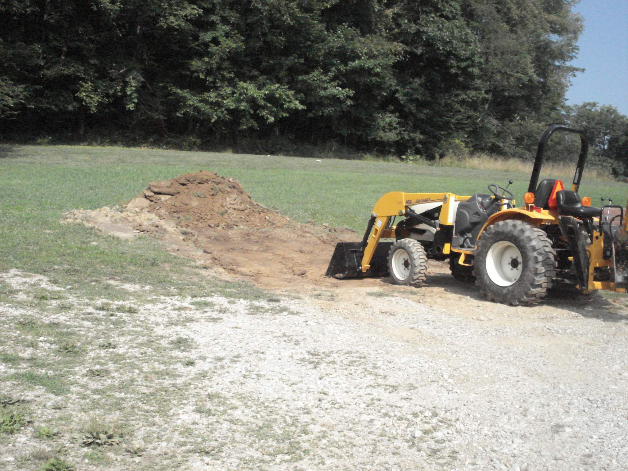

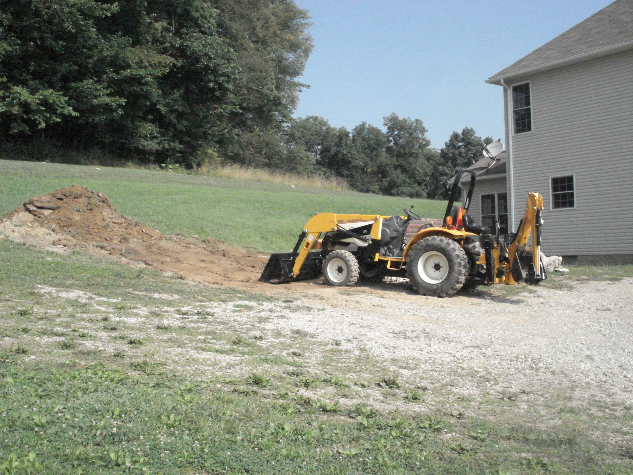

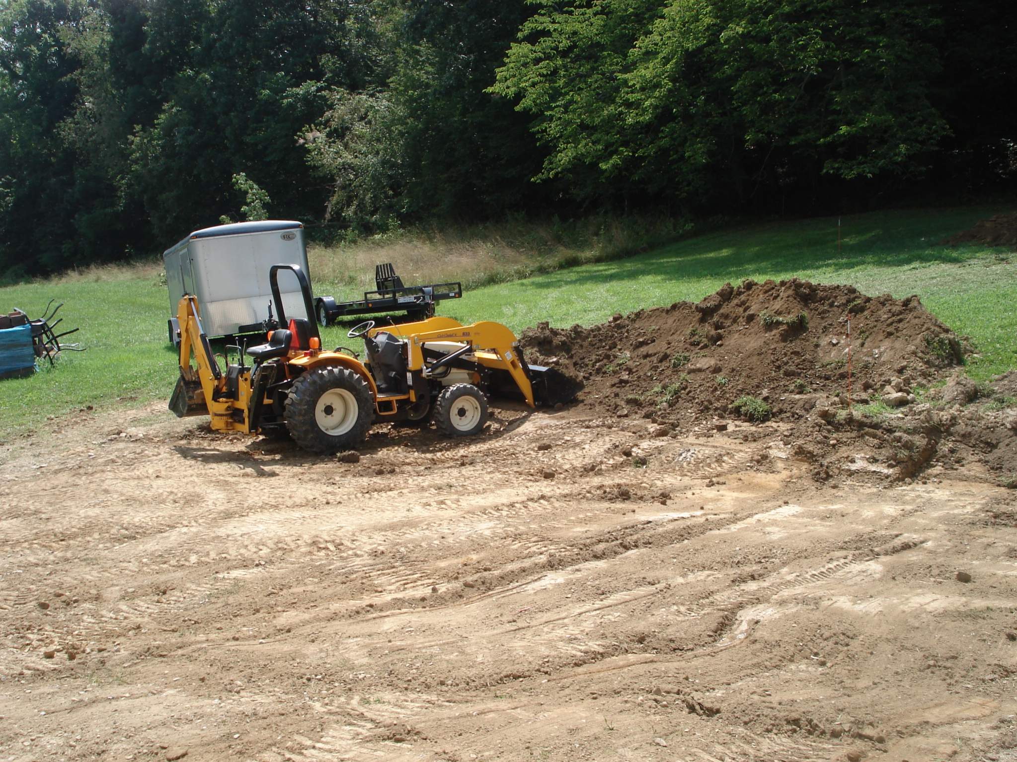

before I started serious digging, I had to level off the "apron" area, which will be surfaced sometime in the future.....

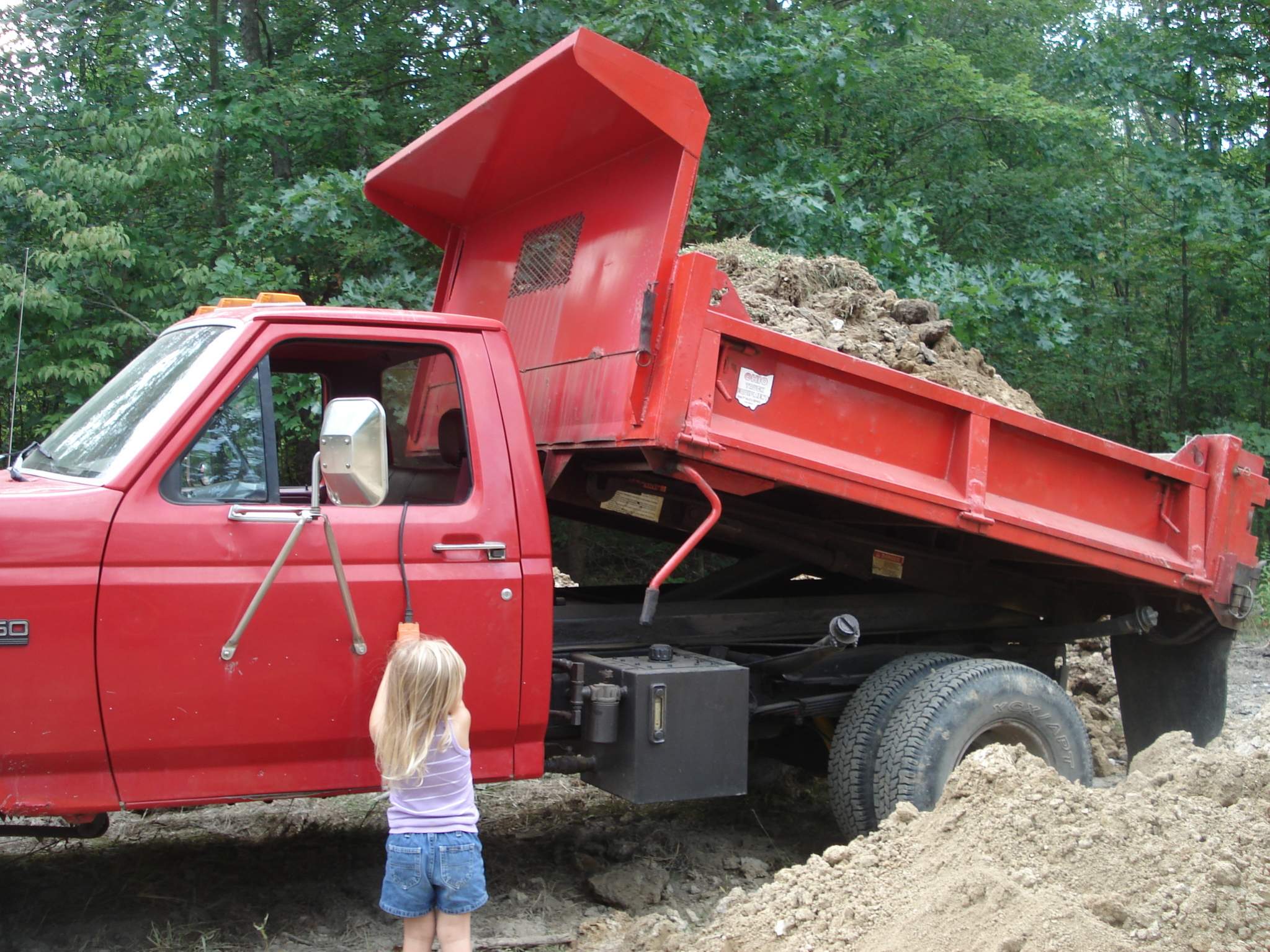

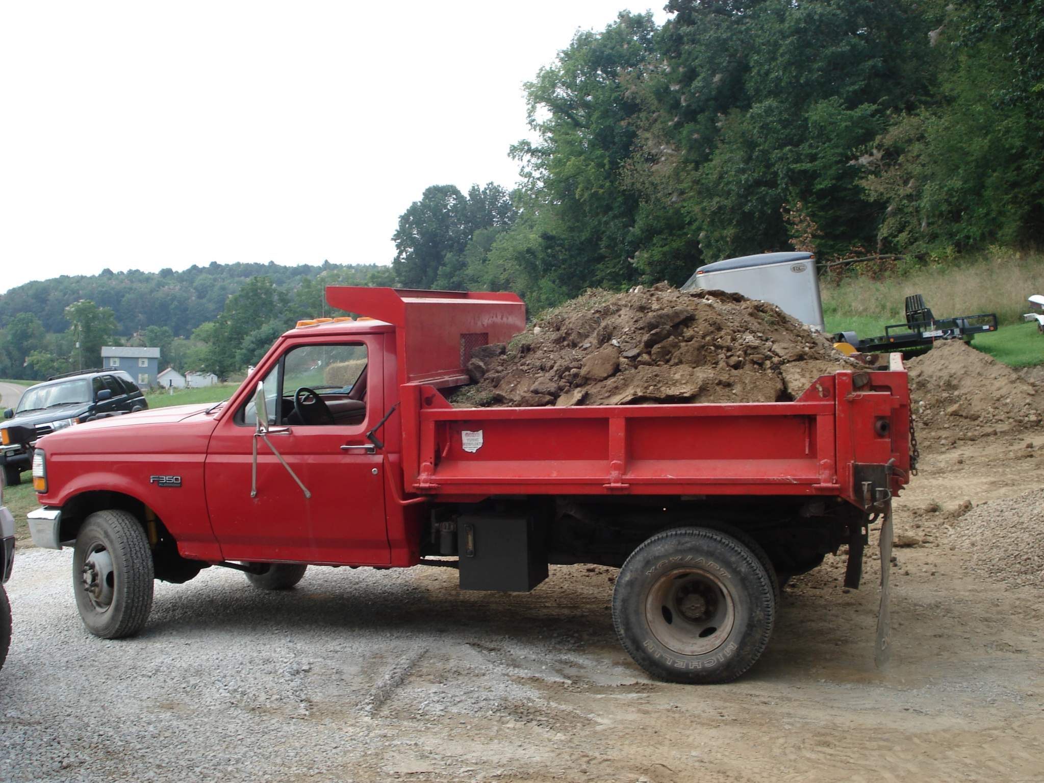

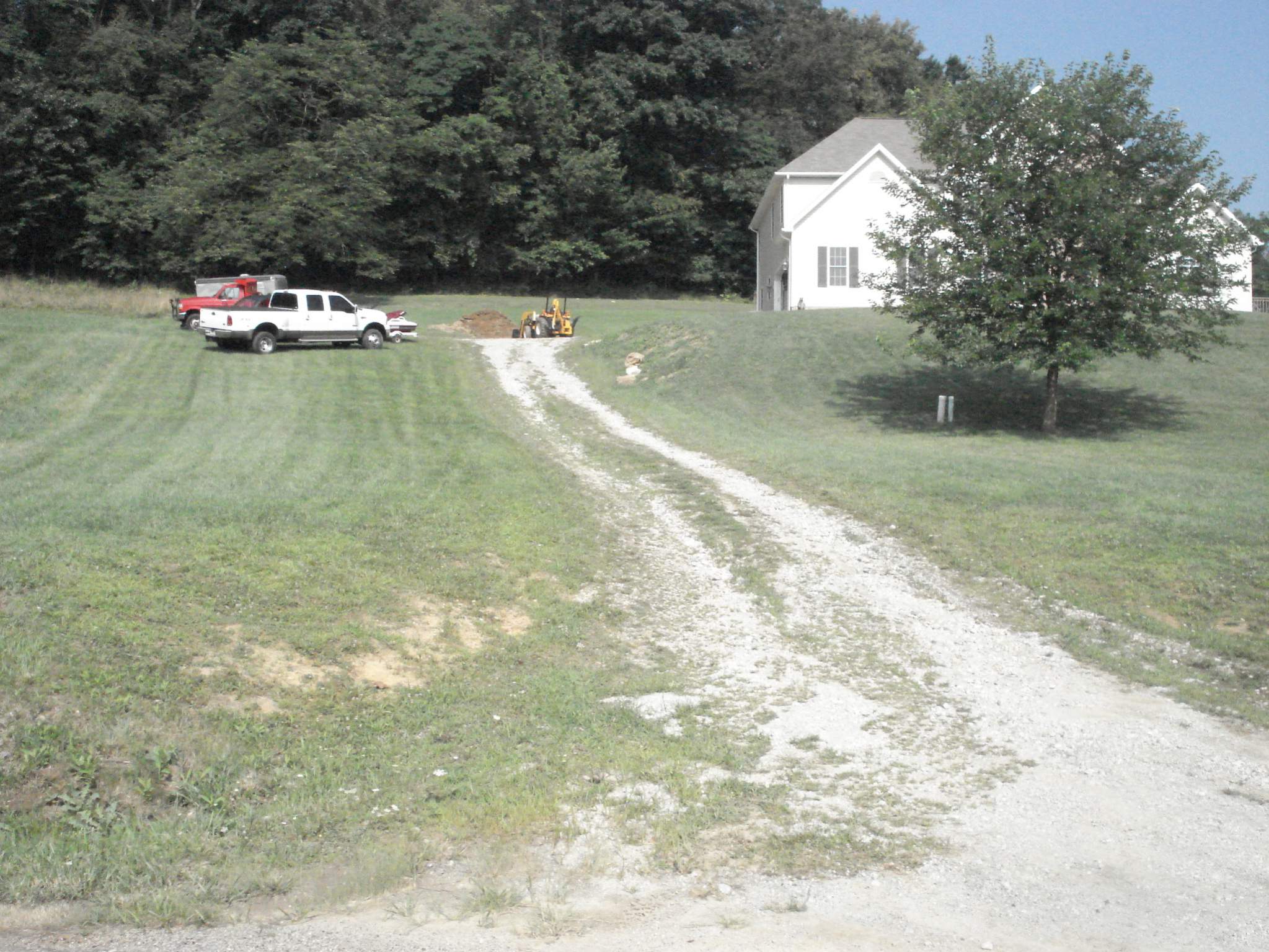

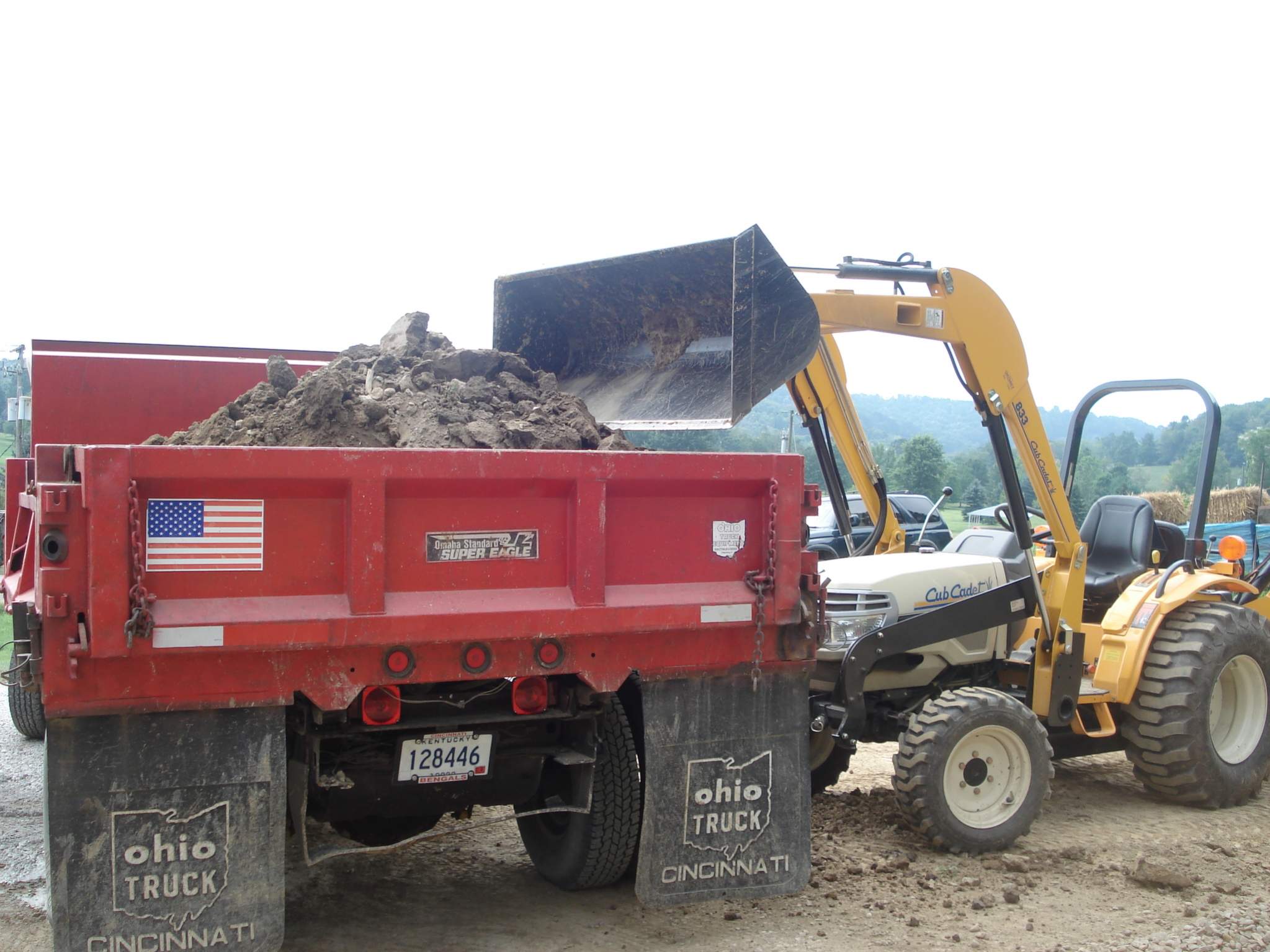

I've been debating buying a dump truck or dump trailer, went with the older 1 ton....it's been earning it's keep thus far.

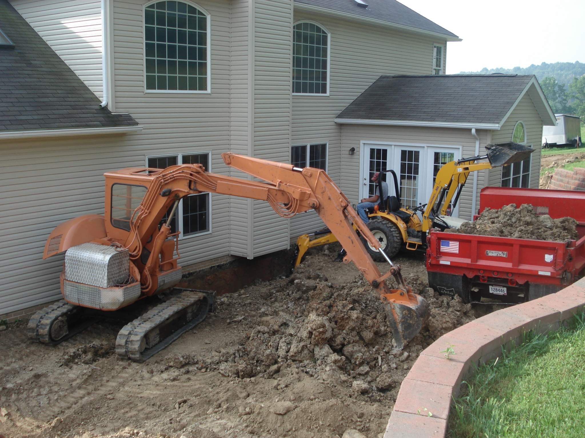

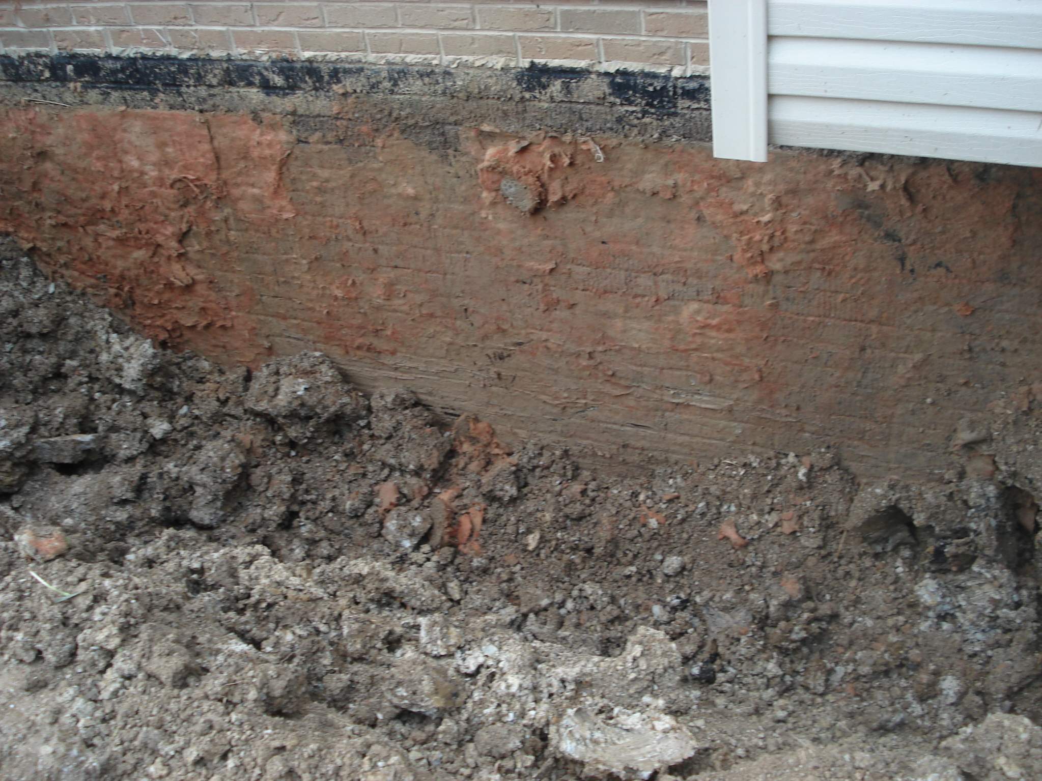

Here's my little helper. Also had a another "project" going on at the same time, the basement wall had a vertical crack that was leaking into the basement. We dug out the back wall, applied mastic, buttonboard, and sealed outside and inside. The ground behind the house sloped right into the basement wall, and there was just thick chunks of heavy clay that had to be removed, and gravel applied. The builder only had 1' of gravel around the footer drains...:mad: thus the cracked wall for a house built in 2007....
glad I got the 1 ton, it just barely fit in the back yard!

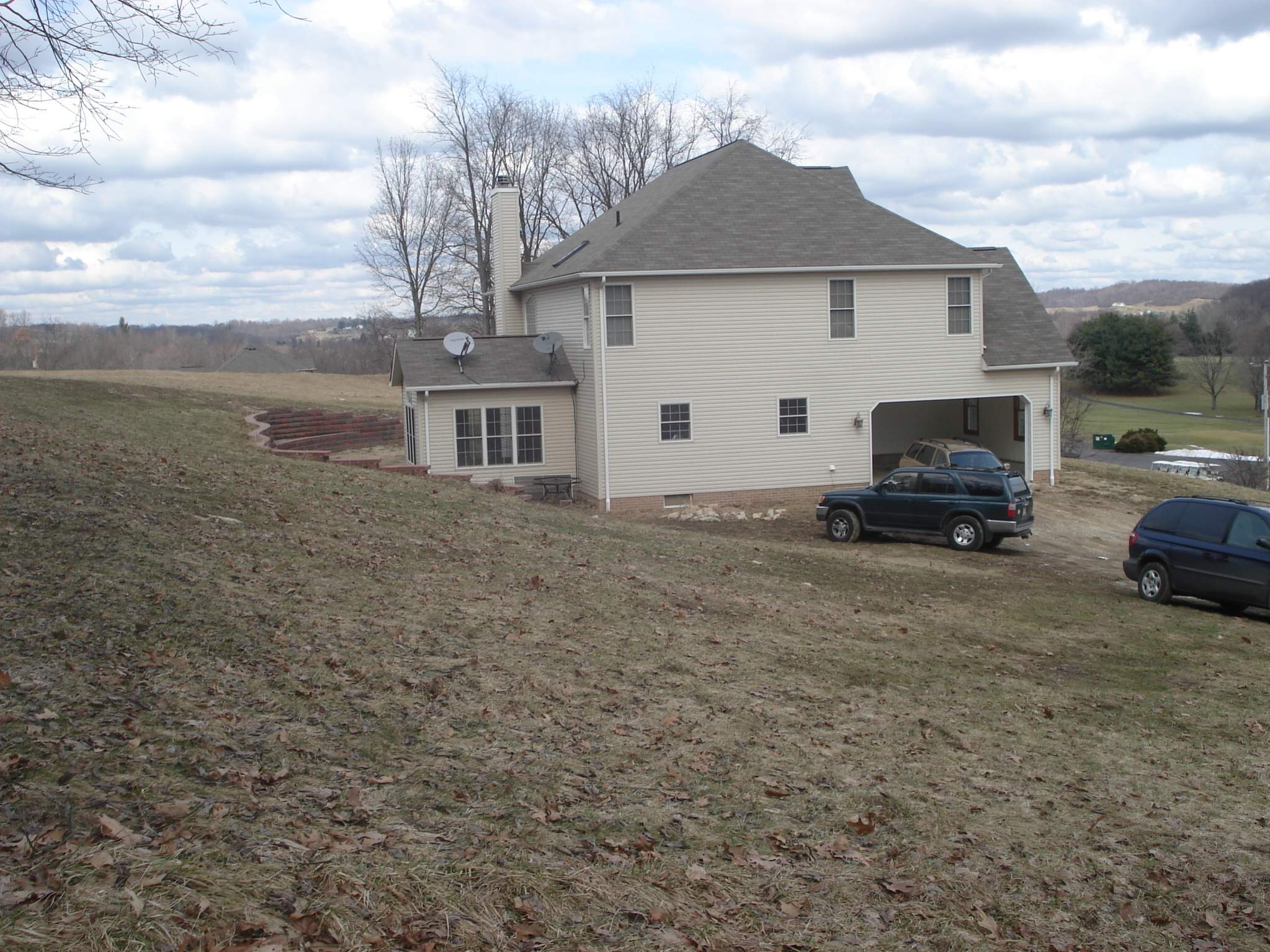

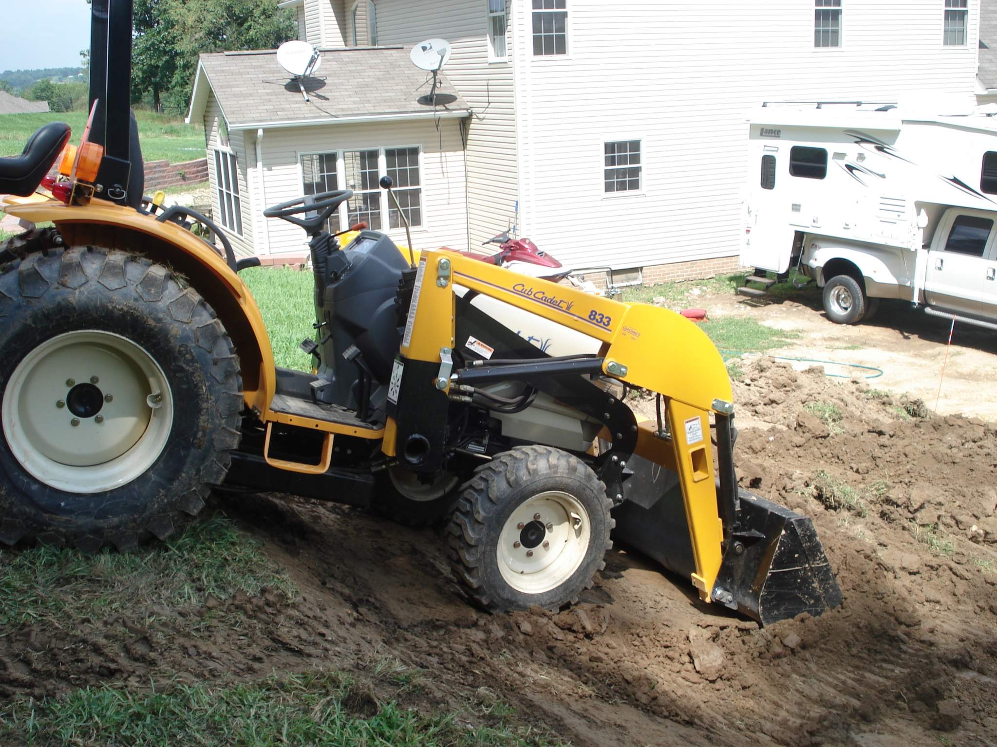

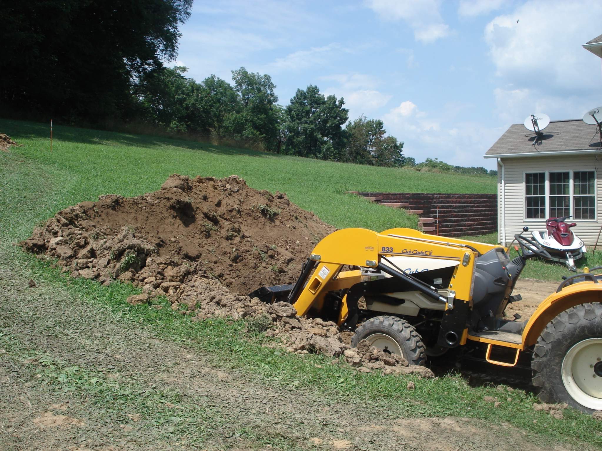

Once I dug so far into the bank, I couldn't get any more material as it was all packed clay underneath the topsoil, so I drove around top, and started pushing down......

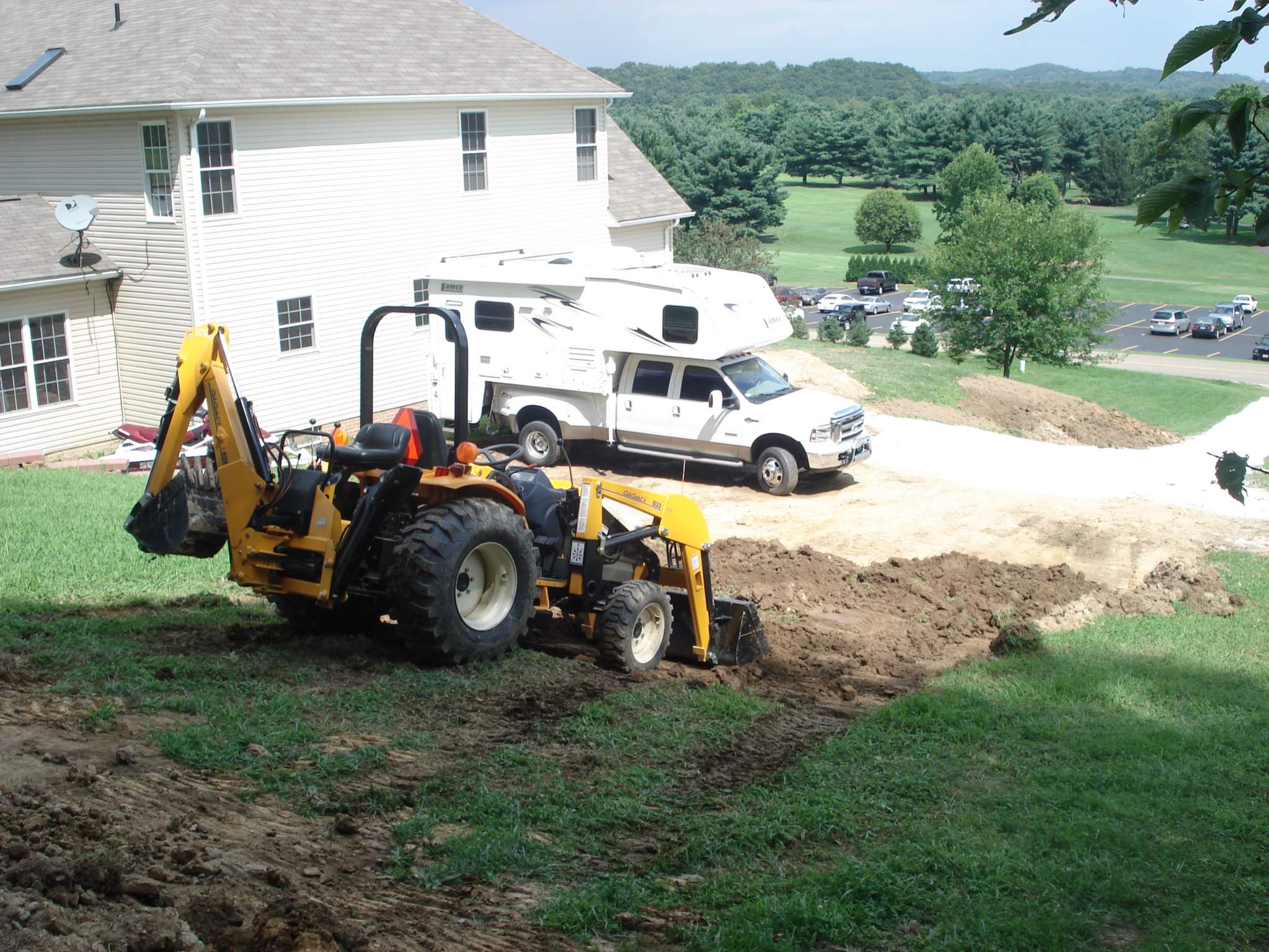

Not quite the angle of Jinman's avatar, but it felt pretty steep......
and in the background my camper I had to cash in for the garage.....(sniff)

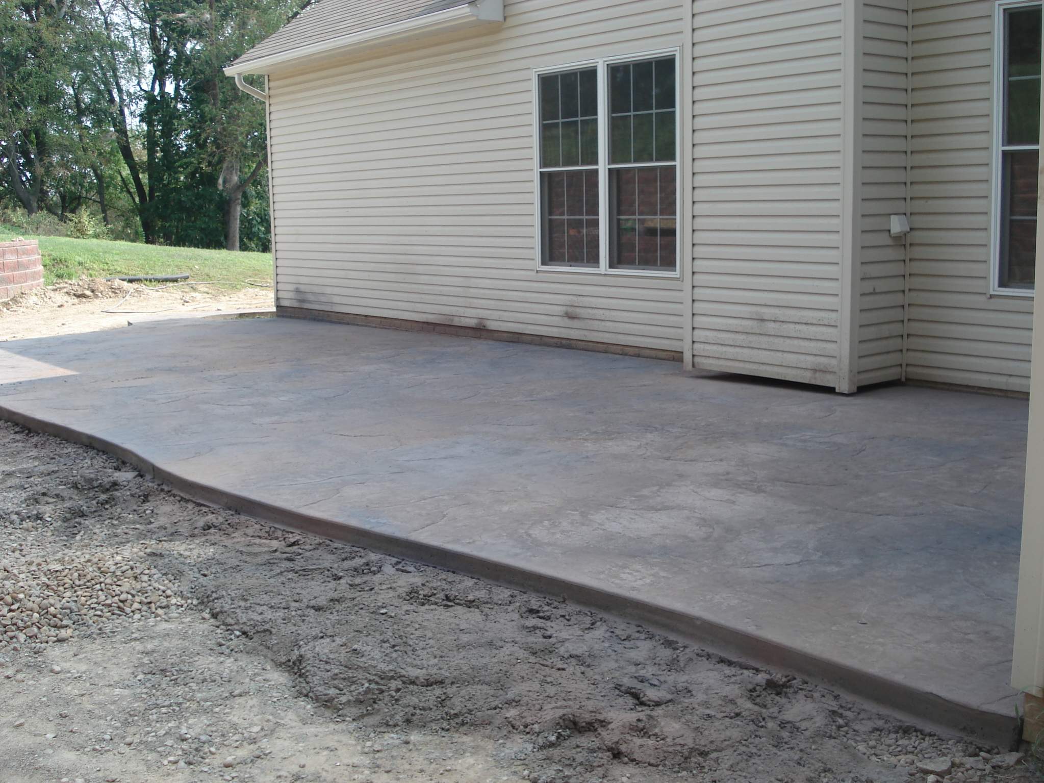

And patio behind the house.....
maybe I should consider renaming this "what I did with my summer vacation"..;)

More digging....I never had a full day to get it all done, due to when I could get trucks/drivers...the 42" bucket would fill my F-350 up in 3 scoops...the Dodge had a bigger box, 4-5 scoops....and the IH would take 7-8. It was fun when I had 2 or 3 trucks running at the same time, I just stayed in the seat....but one day I loaded my truck....then drive it to dump....then back to the hill....back on the ex.....repeat.....repeat....
