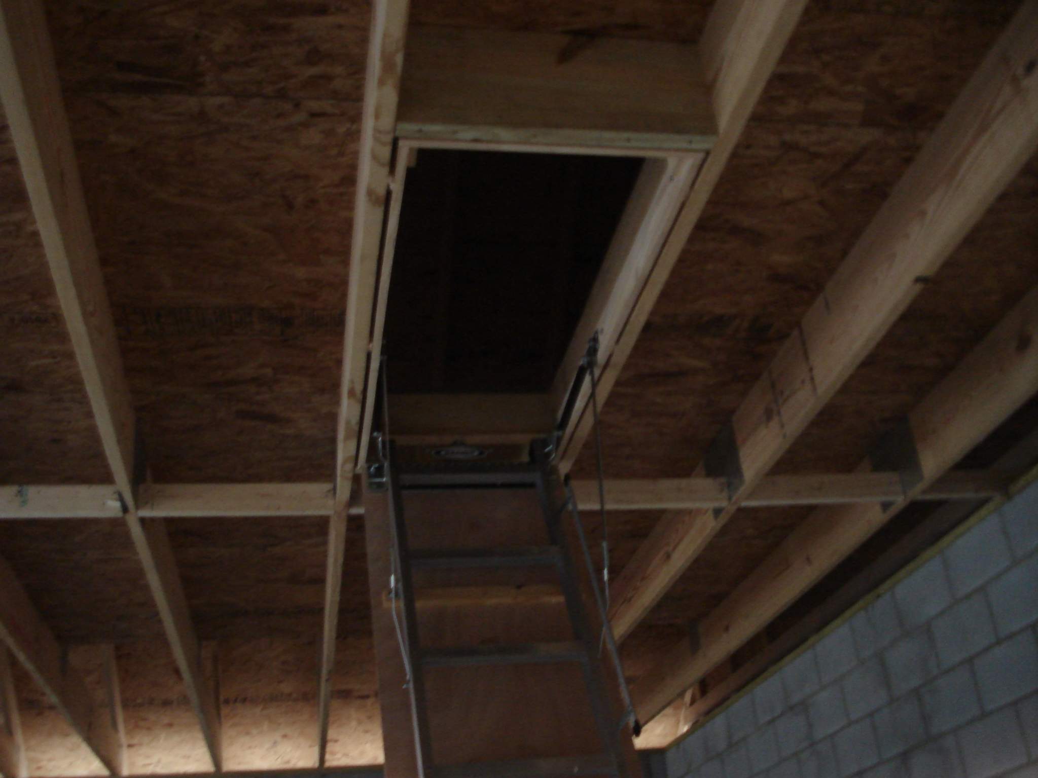

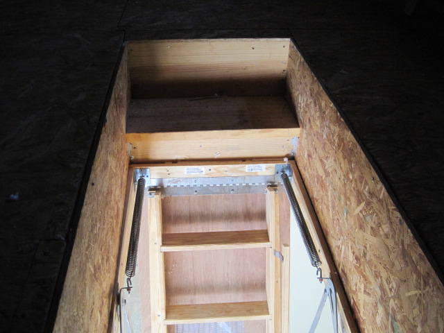

Frank,
I took a some pictures of our pull down steps in our garage. Our floor trusses are 18" high so the framer made us a step between the trusses at the top of the steps. Our steps were just nailed between the trusses with some blocking across in the trusses at the ends of the step assembly.
Obed

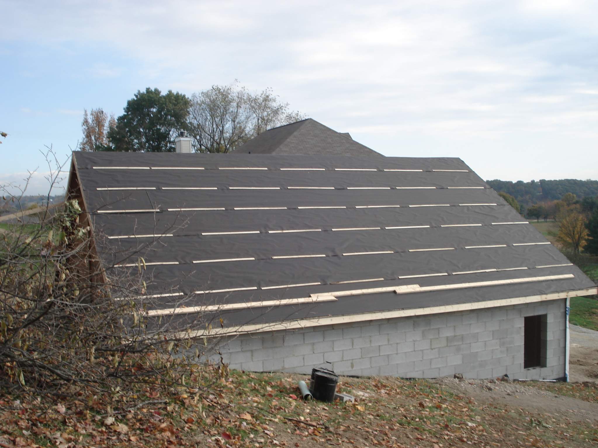

   / Breaking into the bank
#68
Roof and paper on. Ordered shingles on Saturday. Many alternate projects while waiting.....

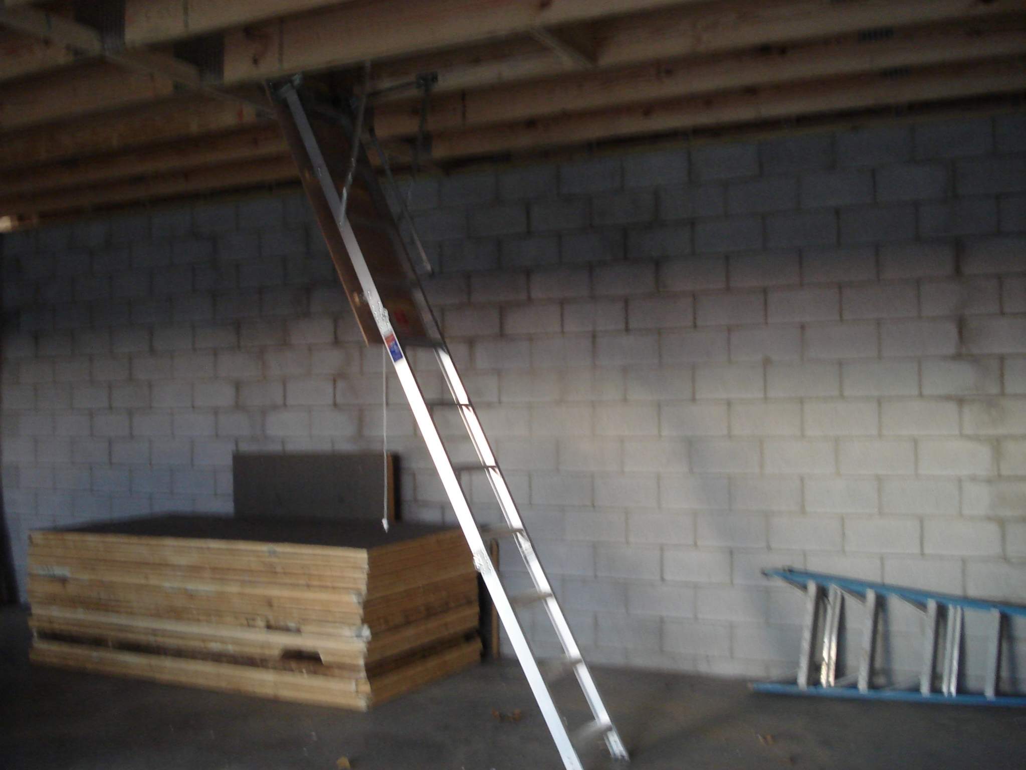

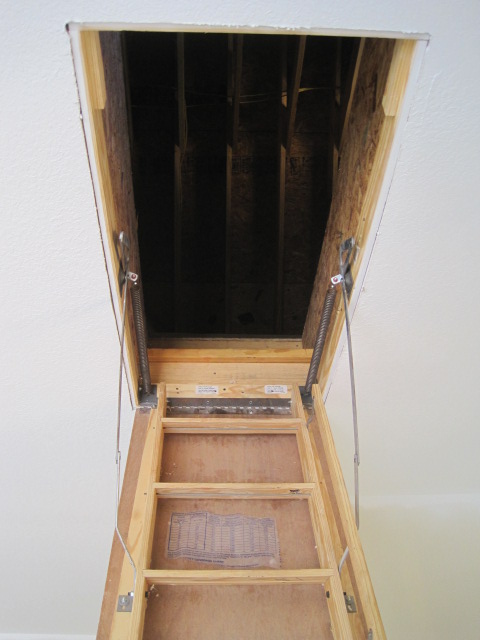

#69
Frank,
Obed
Obed -
I guess I got lucky on this one - my trusses are 24" O.C. and the stairs are 22 1/2 wide....so it fit right in, and works great! Now I can actually start clearing out the other garage and storage unit.....and put in windows and doors. (and shelves!)
Frank

   / Breaking into the bank #70
Looks like great progress! Your garage will be done and finished before we are able to move into our house. Great work.
