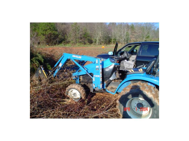

Jin, after the New Holland Rep looked at it the dealer repair the tractor and is holding it for payment. I had not giving permission to fix it. He said he just assume I wanted it fix.
This has been a very dissapointing experiance for me. I was shocked New Holland would not even come and look at it untill I insisted. He just told me over the phone it would not be covered. I appead to the North American Customer Service. They said the went by the locale Rep decission.

Kris, Another view.

The local rep did not make the desision in my case when I had a TN replaced. My dealer put me in touch with some higher up's at NH who I called and explained the situation to. The dealer, local rep and higher up's then got together and made the decision. The one thing I learned is that the minute you mention the L "awyer" word you better be prepared to follow though or quickly retract it. I was told that as soon as you say you are getting a lawyer they are all instructed to stop talking to you and refer all communications to the legal department. Have you had this tractor since new? Have all the bolts always been tight? Do you have a friend who is a ME who could take a look at the break. It will reveal a lot of things that I'm sure the rep who is im many ways a business person will not be able to see. Also stress how unsafe this made the tractor. As a product engineer I know how nervous companies get when safety comes into play.
Good luck. Andy

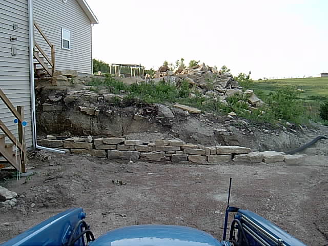

the first pic is one of the walls I have to build. the the rocks I'm using are mostly coming from that pile behind the garage there.

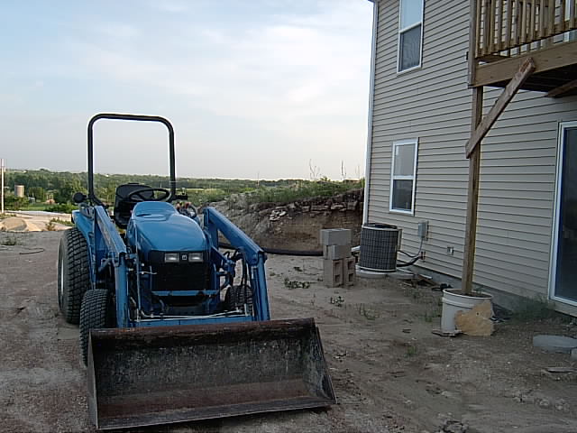

The other wall at the south end of the house that hase to be built. Keep in mind the picture following this one is of the rock pile that was escavated out of where the house now sits and that pile is just out of site to the southwest (left and to the front) of the house.

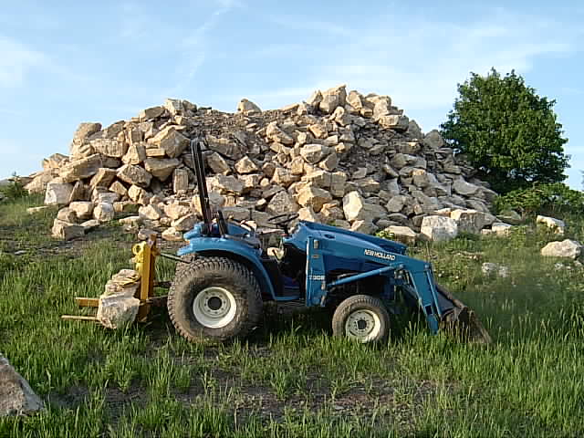

The house is up behind the pile.
This is why I use the name rockquarry

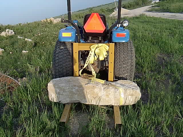

here my counter weight
I think its close to 500-600lbs
