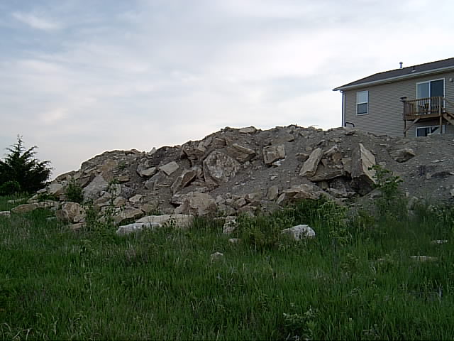

Last pic. more rock taken from where my basement is.

I wouldn't worry much about breaking it, just inspect it carefully where the halfs mate, if the flanges are good and thick, it should be fine.. IMHO, if this were a common problem (breaking in half) we would have heard about it more.

I see what you mean about all that rock. In my opinion, the last thing you will need to worry about will be the tractor breaking in half. I think you are gonna have lots of days with a sore back before you get that wall done. /forums/images/graemlins/tongue.gif Lifting the stones into place with the FEL will be a big help.
Keep us updated. This looks like a really interesting project. /forums/images/graemlins/cool.gif
