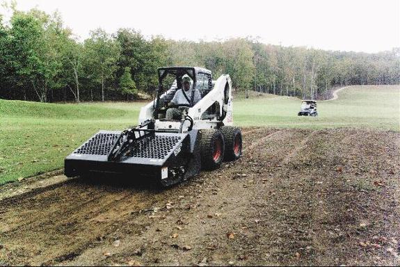

/ Breaking up clay & sod #13
The rotating drum is equipped with carbide-tipped teeth, which rip through clumps and penetrate the soil.
This is from the Bobcat soil conditioner and I agree, sounds like what you need. A pulverizer is an expensive piece of equipment and the two I've seen in operation were hydraulically controlled. I have zero idea of gpm requirements, but boy did they do a nice job. First run at an angle to leave a line of debris and rocks, then later straight, usually in reverse, to leave the ground like freshly vacuumed carpet.
I would just be careful not to overpulverize that clay, I've read here somewhere the downside of that but someone else can better explain it. Since you are in NY I'm assuming you are going to be picking up some granite, but how's your rock situation?

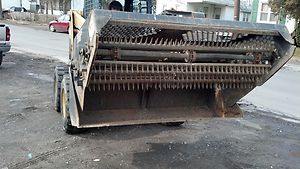

Landscape Rake will NOT work.
The flexible tines will just lift and ride over the lumps.
Just so everyone knows, a skid steer landscape rake is different than a tractor landscape rake.

/ Breaking up clay & sod #17
Guess I should have specified that for those who haven't seen or heard of one.
like me, thanks. Never had a skidsteer, though the quick attach implements can be interesting.
#18
I'm glad that you took it the right way sir. Many times skid steer and tractor implements aren't quite the same and I don't mean to insult anyone who is more familiar with one than the other.
