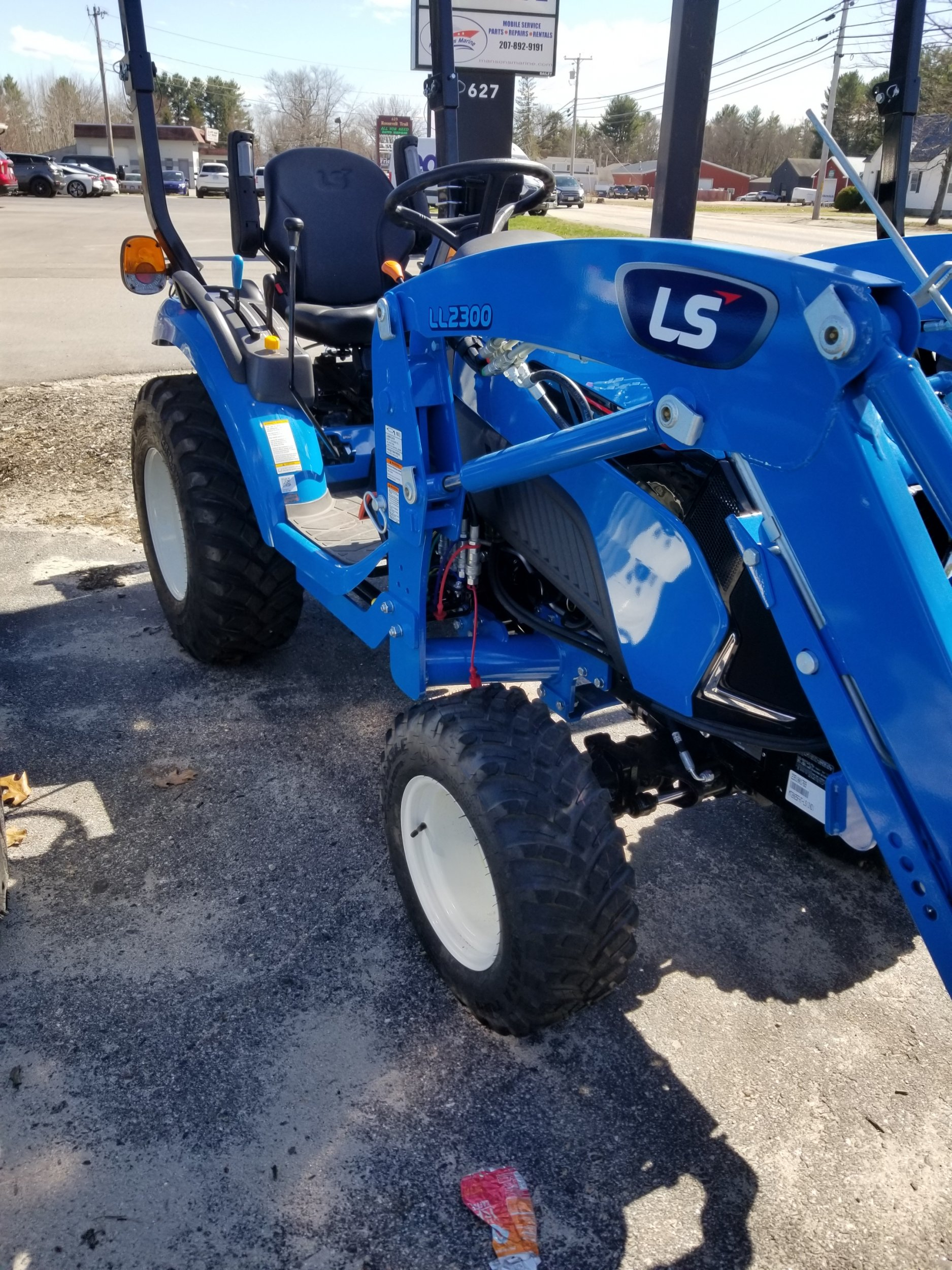

As far as LS goes, look at their MT225-S.... bigger than the NH 25s. Has a lot of features.... far more than the MT125, which is the NH25s
Are the loader controls still off the dash instead of the fender? I didn't find this placement as comfortable.
   / Looking to buy my first tractor #22
It's got it off the fender. The MT2 25S is a unique machine in it's segment; it's got a 3 range transfer case, split brakes, and a big comfy seat. Had I not gone larger I'd have made it a real contender, it's a machine that seems to punch above it's weight.

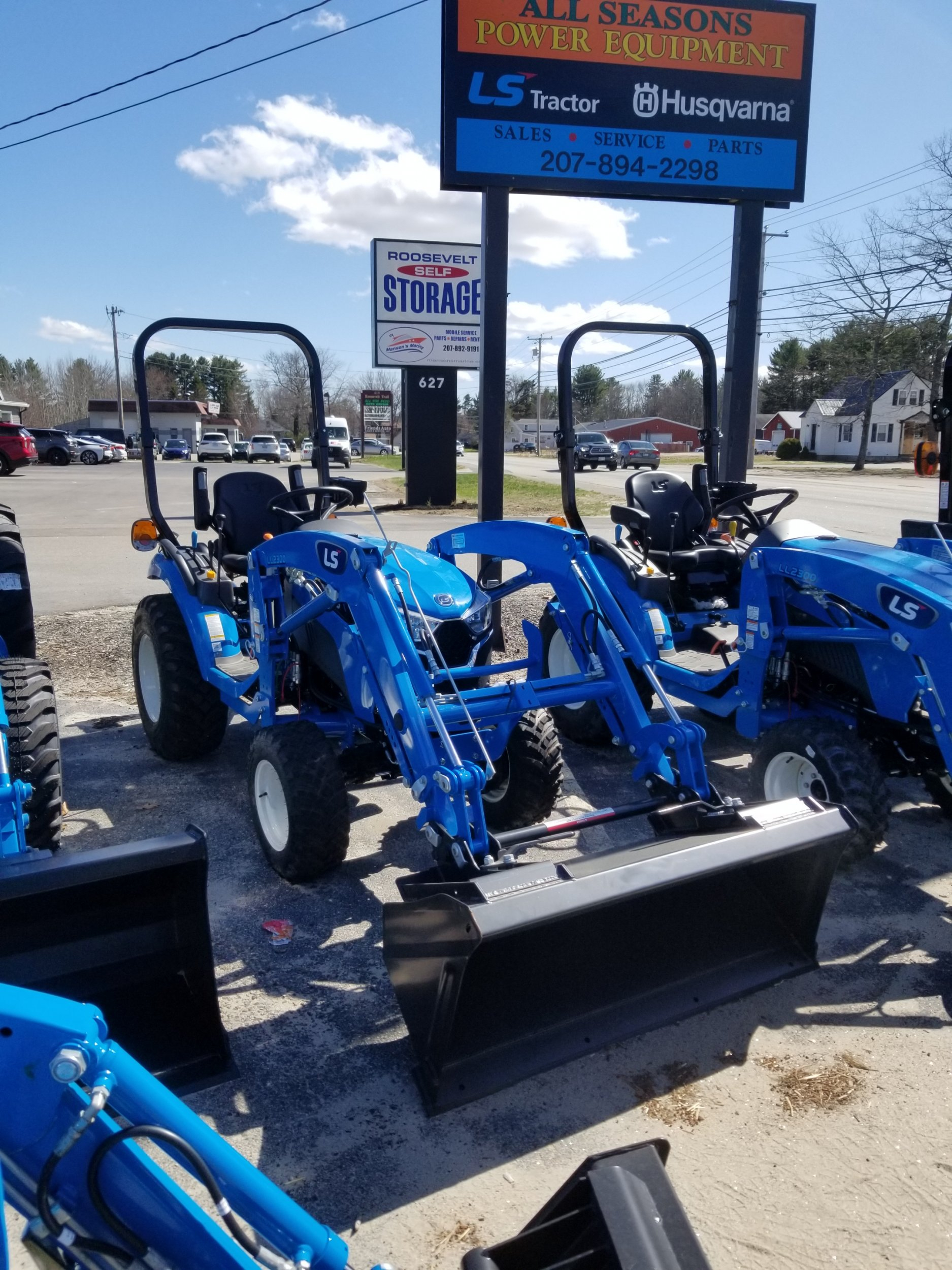

View attachment 783386View attachment 783387View attachment 783388View attachment 783389
If I have some time I'll have to go check them out. Nearest dealer is not one I would work with again, and next nearest is about an hour away at a 3rd location of the Yanmar dealer. They have 3 locations, 2 sell Yanmar and one sells LS.
